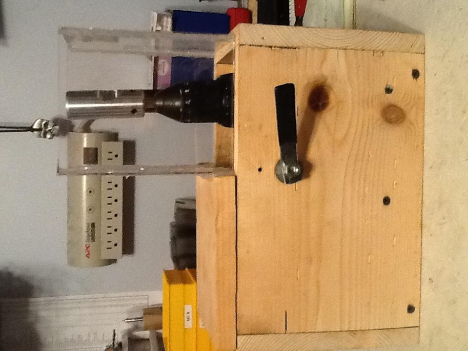

Reading the article posted by justinbaker is much easier than me re-inventing the wheel. I built a box to hold my cordless drill with the chuck facing straight up. When talking to Jim, he said putting the trimmer in a drill press would be a bad idea because some trimmings may get in between the cutter and case mouth. Turn the drill on low speed, trim cases, turn drill off. Saves the arms from constant turning!
Sorry the picture is on its side. I tried twice and I can't get it to turn over. I did not upgrade the bit. It is my understanding that if the brass is free from dirt, dust, lube and other garbage that the bit will last a long time. It does index off the shoulder, so careful sizing is a must.

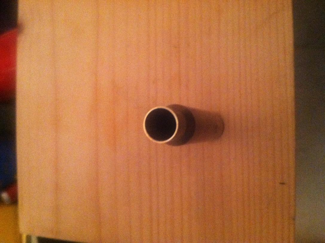

Ok, had a clean 30-06 case laying on the bench. I apologize for the iPhone photo. If you would like more crisp pics, pm me and I will get out the big camera and email you some. I am really impressed with this trimmer. Wish I would have had it a year ago when I trimmed 5000 once fired LC cases!image.jpg
