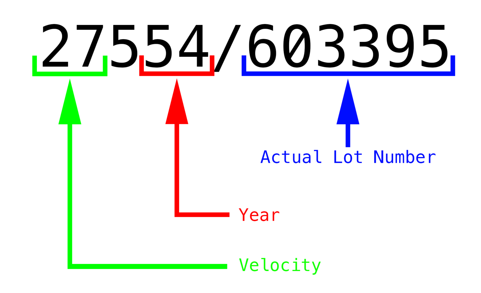

Add a “3” to the first two numbers in the lot # and multiply by 3.28. That will give you the average FPS for the lot. Run across a chrono for ES and SD.
OFG.
I'm not able to make this work out to anything remotely close to an acceptable velocity, can you give an example? I'm obviously doing something wrong.

Current Lapua rimfire ammo lot numbers are composed of eleven (11) digits, five (5) digits followed by a forward slash, followed by another six (6) digits.
The five digits before before the forward slash:
  • First two digits (digits 1 and 2): Prepend a ‘3’ in front of the digits to get muzzle Velocity in meters per second. Example: If first two digits are 27, then the muzzle velocity is 327 meters per second.
  • The last two digits (digits 4 and 5): Year of production code. 54 = 2019, 55 = 2020, etc.
The six digits after the forward slash is the actual lot number (assumed to increment sequentially).

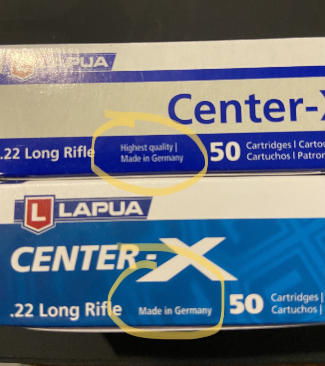

Anyone else notice the words “highest quality” has been removed?
My latest bricks had 321m/s and 323m/s velocity and didn’t shoot well at all. They were both produced on the newest machine as well, so it’s hard to say if it’s the velocity or the equipment....or something else.

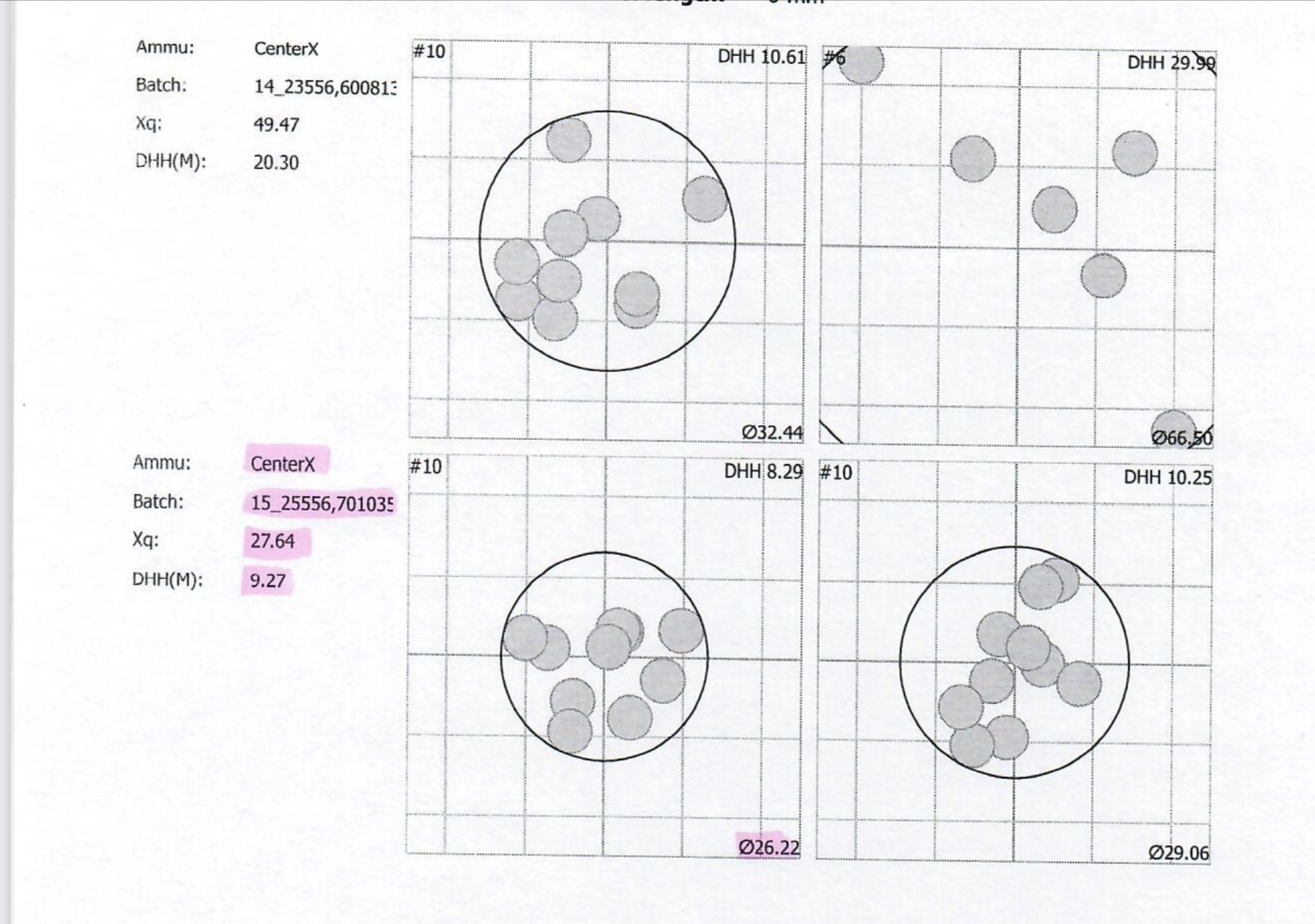

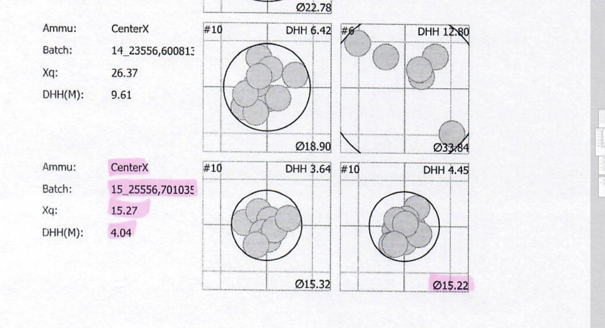

Just got my Vudoo results back from Lapua test center. Below is the best they could do at 50 and 100. Only one lot was acceptable. Midas + was terrible.
same for me. With the "old" center x at the test center some lots couldn't do 2" at 100m.
I’m in the same boat as OP and a few others. I recently had my Vudoo lot tested in Mesa, AZ.
My best lot# 700506 was 4.57/12.98, so I bought two cases. One brick came with the rifle and the rest are in route.
