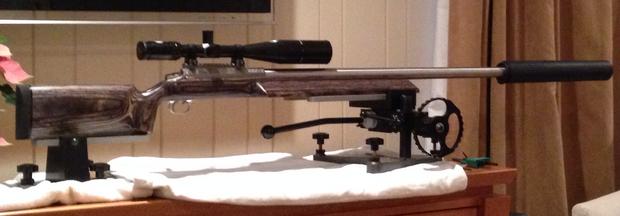

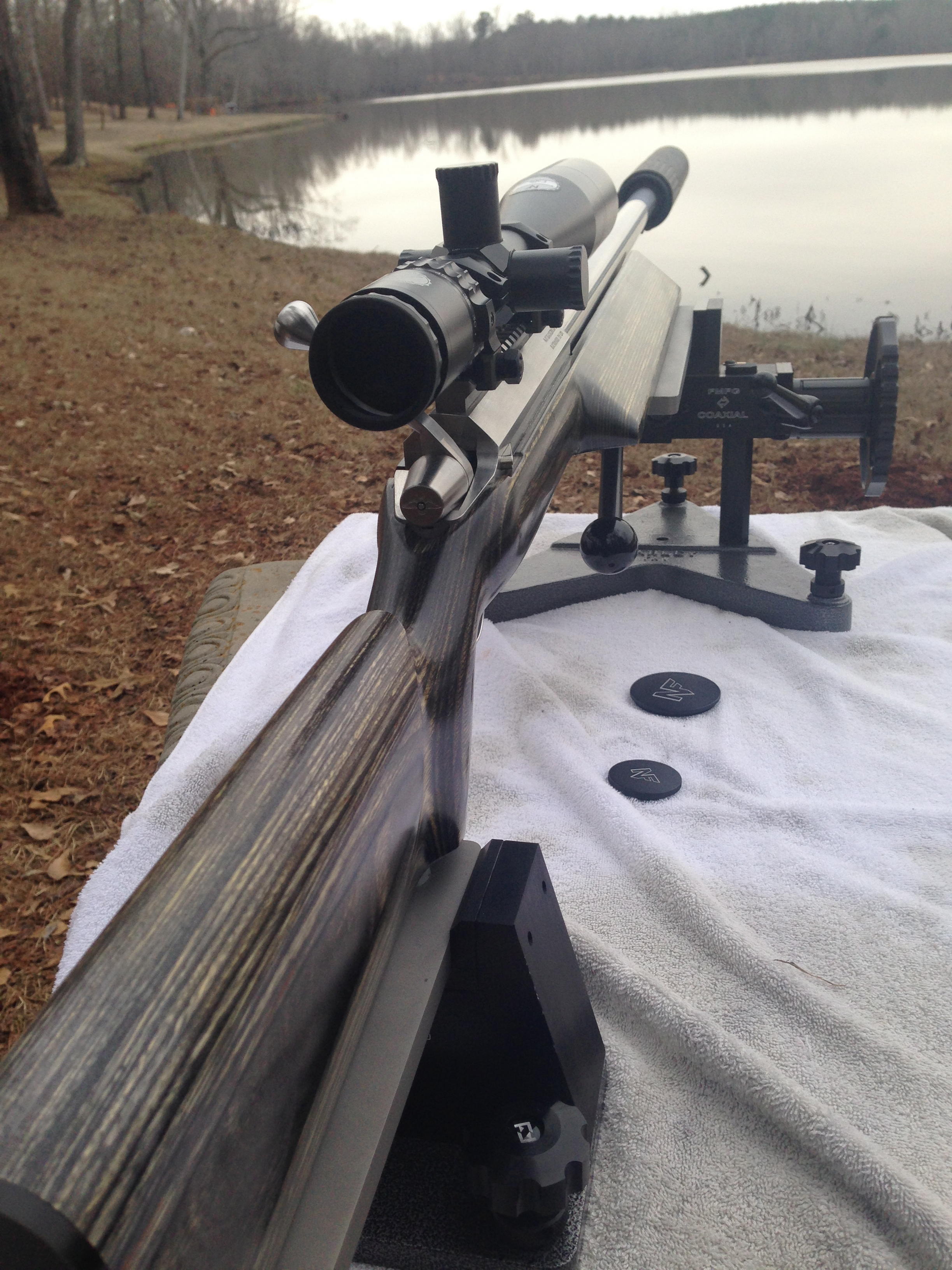

Well its finally here-
With a few new additions.

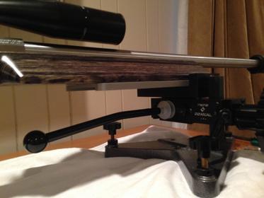

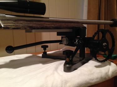

1-Farley Coaxial Rest.
2-Rails on a Big Gun.
Really cool to shoot

Details Mate!!! specs, who built it? loads, groups etc
What stock is that? Maxi tracker or???
By the way nice rifle, I was half way through building a 375 ST Heavy gun 10"Bat, Maxi tracker. When they banned anything over 8mm in Fly matches :(
Sorry for the quick post .....
Heres my best description
Dixie Guns - Winder, Ga - Doyle Anglin built it
350 SMKs with 138.5 grains of Retumbo getting 3250 through the Ohler P35
BAT Action 10" Model L
Custom Laminate stock by Dixie Gun
Farley Coaxial Rest - front and rear....my first experiance with Jim and Mike was great as well
32 Inch Kreiger Barrel
AAC Cyclops - Really does the job no hearing protection needed
Just shot ten rounds on Sat and decided I need a much better Bench so I'm building it now.
Love this rest system and the gun is a hoot.
I will post a target when the new bench is complete
