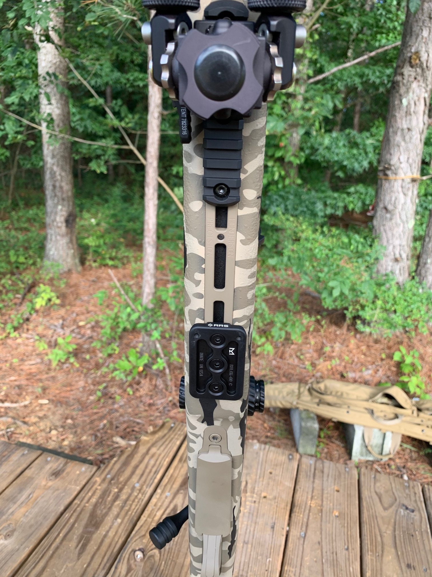

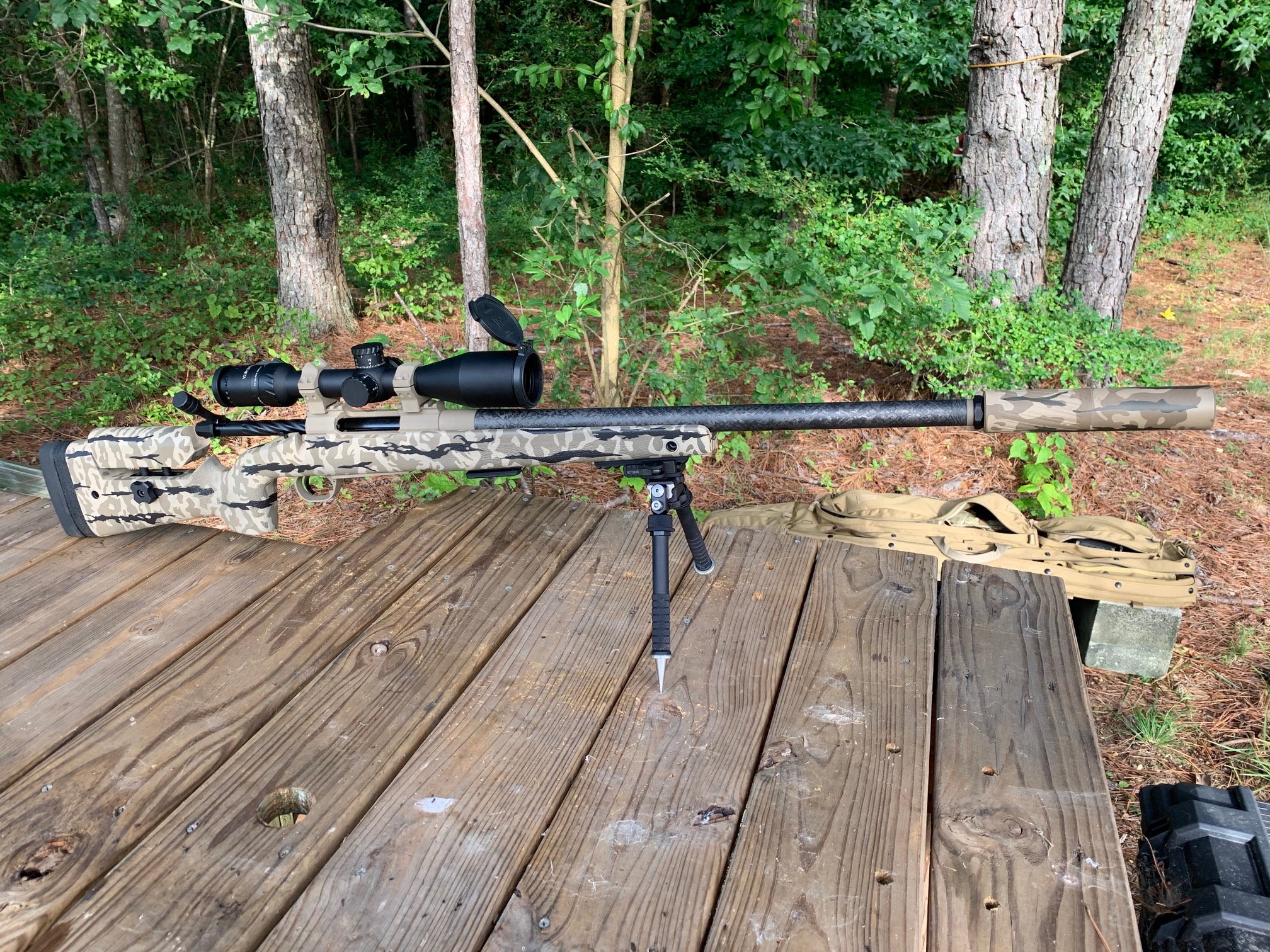

I built a Nucleus, Proof CF, TT Primary, AG adjustable hunter, Mesa Precision bottom metal, Hellfire brake, ARC M 10 rings and Leupold MK5 3.6-18. Under 11 pounds with empty mag.
