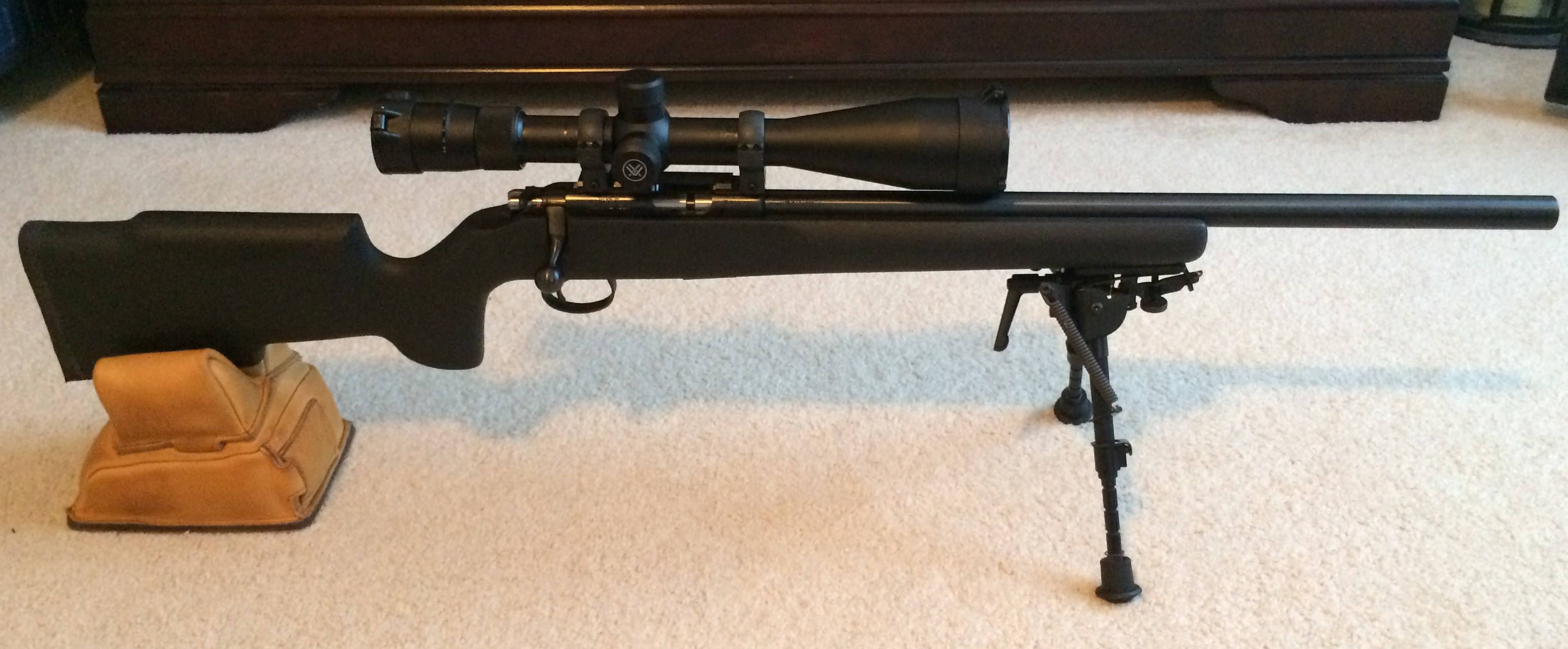

Here is my new CZ 455 Tacticool. So far I have installed the DIP adjustable sear and put a lighter trigger spring; DIP mag well and 25 MOA scope base. I mounted a Vortex Viper 6.5-20 in Burris signature zee rings and attached the Harris bipod. I'm ready to shoot. One thing I noticed is the stock has alot of contact with the barrel at the end of the forend. I don't know how this will effect accuracy, but we shall see. I have a set of pillars that I'm planning to install and do a full bedding job after that. I'm doing the work in stages because that is all I have time for, but I also want to see how each step effects accuracy. I'll post results when I can.

Looks good! I know my CZ doesn't seem to like any of the stock touching the barrel. But I know others have different results! Best thing to do I believe is to put some rounds through it and see what it does! Welcome to the addiction!

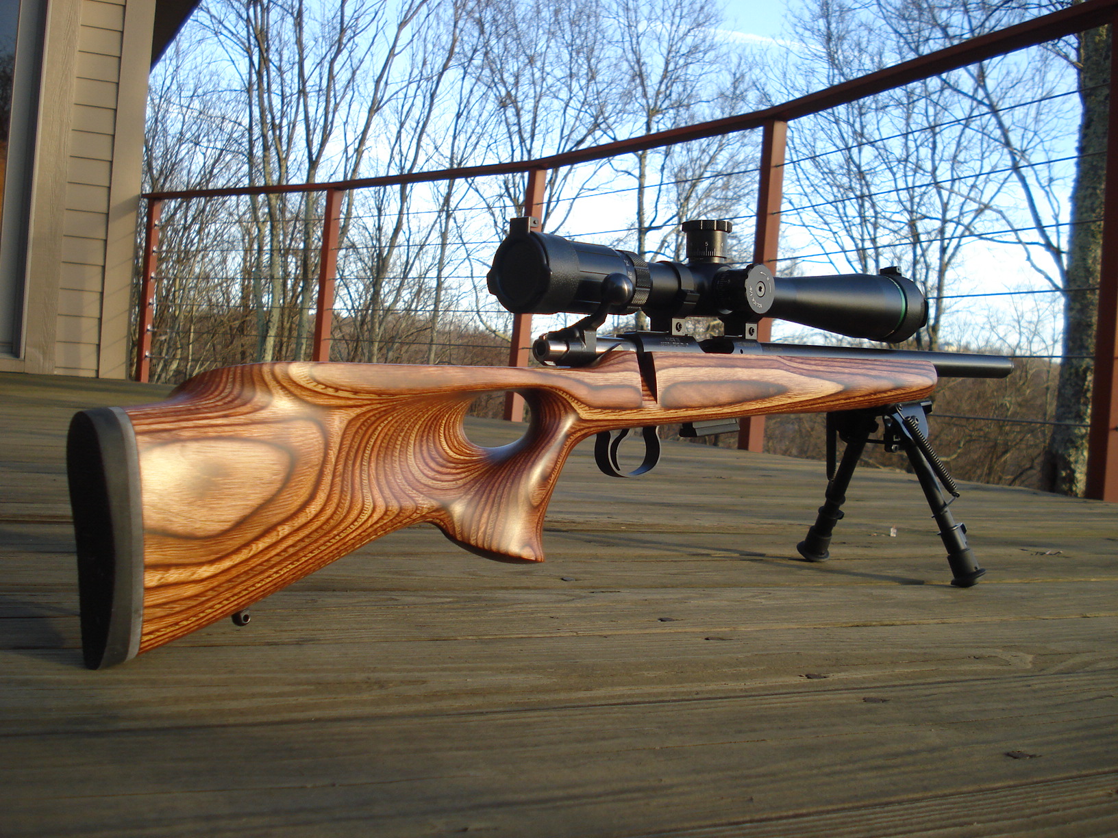

Which model Harris bipod is that? I just got a CZ455 Varmint with the thumbhole stock. It has a single post at the front, which I assume unscrews to mount the bipod? Obviously, I am a newbie at this.
Rockhouse - It is a 6-9" Harris with cant adjustment. It has notches in the legs to adjust height. (1st link below) It attaches to a front sling swivel (the post on the bottom side of the forend of the stock). You may want to look at the friction lock model (2nd link below) because it allows you to fine tune the height. I like to fine tune elevation with the slope on the butt of the stock. I push the rifle forward in the rear bag to lower my point of aim and pull back the rifle bag in the bag to raise my POA. Everyone is different though.

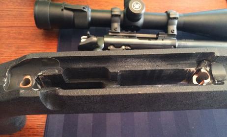

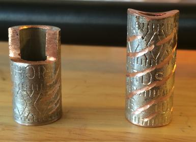

I finally got the CZ pillar bedding job done. Its not perfect, but we'll see how it shoots. I used Marine Tex epoxy putty and it ended up bedding the rear tang.

To avoid that I have the dry times down to a science. I'll wait exactly 9 hours and will remove the action. The bedding will be just soft enough still to be easily and cleanly removed with a wood gouge so when your done it will look like this.

I went ahead and completed the bedding job on my rifle to include the first 3" of barrel. I was going to try to shoot again in less windy conditions before if finished the bedding, but I got bored last night. The bedding job is my first, so it is not perfect. I'll post pics later.

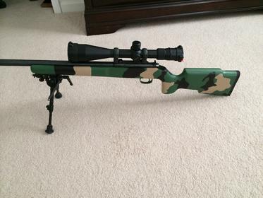

I also painted the stock in a camo pattern because I got bored. The green is a little lighter that I wanted it to be, but other than that I think it is ok.
