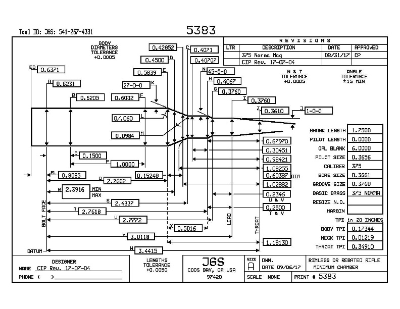

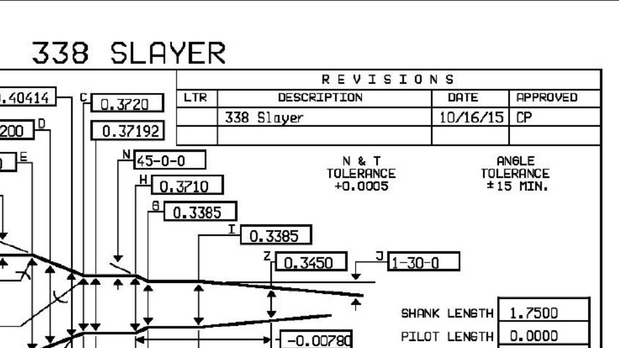

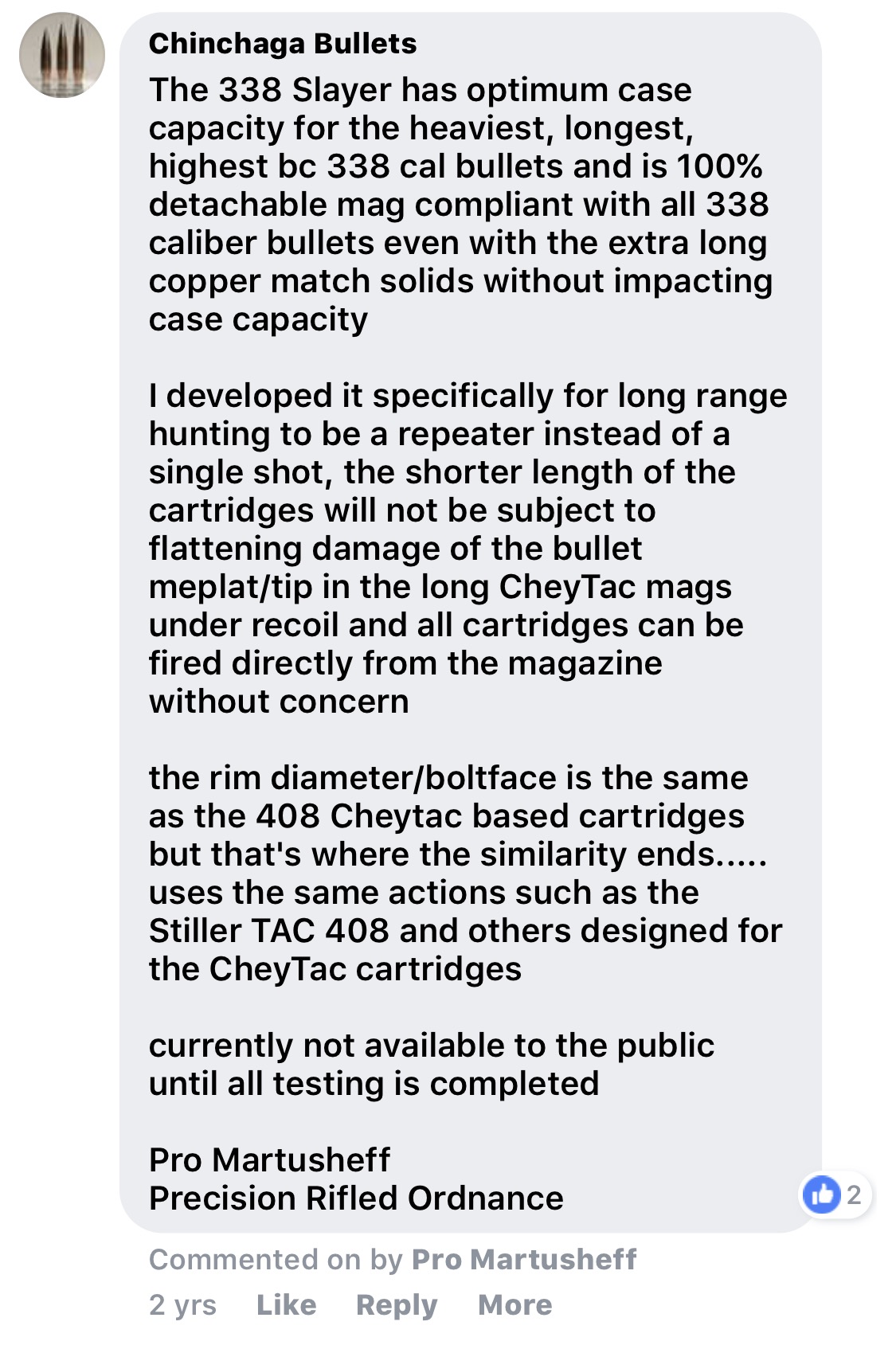

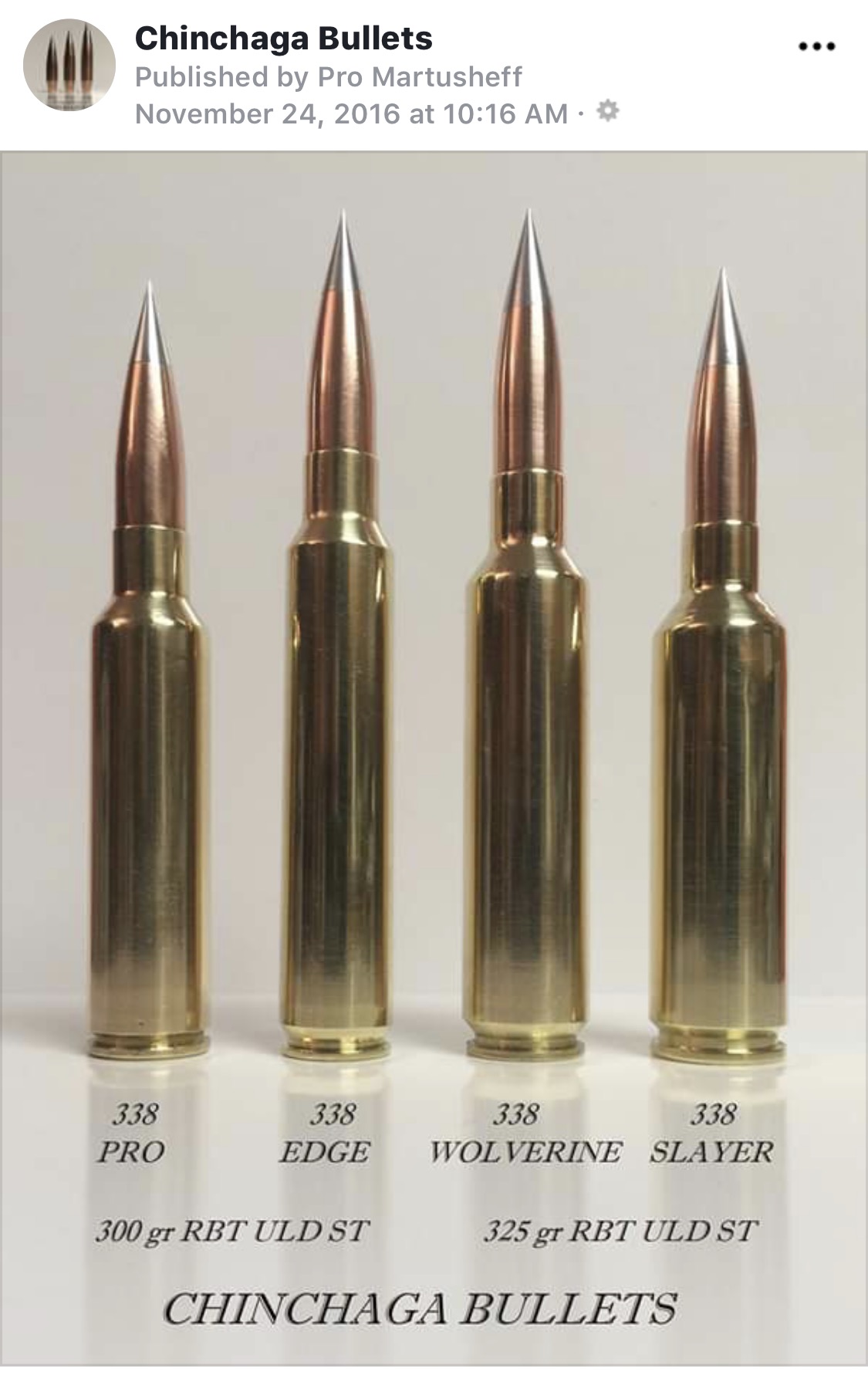

So from reviewing the 338 Slayer and the 338 EnAB in some dimensional software (I could be wrong, but doubt it) it appears there is barely .2" difference in OAL case length and the web area of the EnAB is exactly that of the 585 Nyati.
Looks like a whole lot of:
Sincerely,
Theis
There have been a few revisions to the 338 Slayer since that post two years ago, along with the addition of the 300 Slayer
Nothing wrong with more of the same, good quality brass for me to improve in my chamber is a good thing, necking down 585 Nyati brass to 338 cal is a lot of farking work

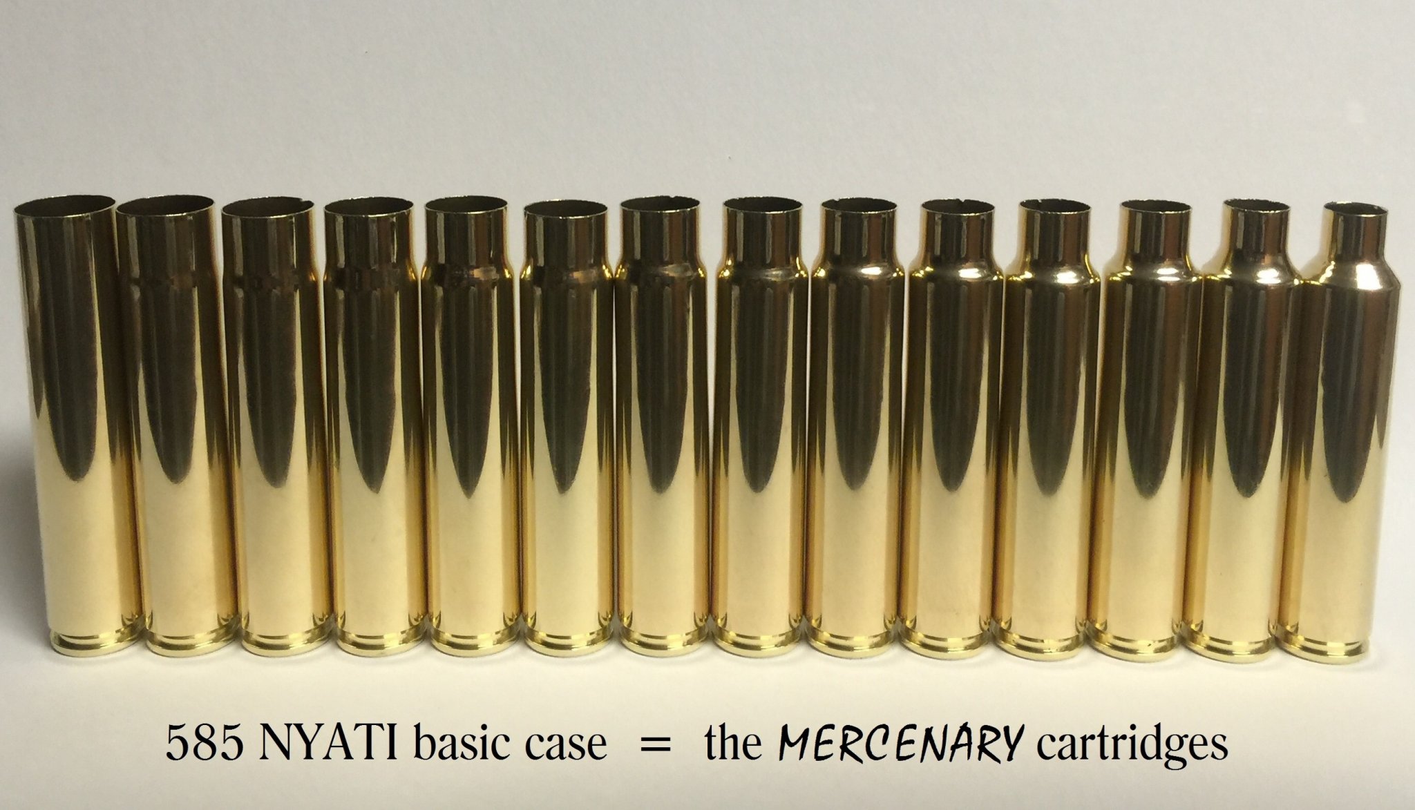

The Velocity Migration for the 375 Lethal Magnum graph is basically showing that the response to the shot-to-shot vel dispersion is, essentially, hardly a linear fit, just see the Rs values (Excel 101) so, how in hell they wind up on the 20 fpsf Extreme Spread...is a clear mystery to me.
On the other hand, the paper makes the case for the 375 Lethal and where is the much needed comparison of the same velocity dispersion of the "new" case? Wasn't this "paper" goal to make a point for AB new cartridges or not?:oops:
If you say A is bad and B is good, well, even a 5th grader kid is aware of putting up front the evidence of such claim .
And the so-called Ballistic Performance Comparison chart is tricky to put it kindly.
They compared different cartridges with different bullets and surprise...the highest BC bullet was only used on the "new" case. Call me paranoid, but such chart is just too much biased... to the hell with technically-wise honest comparisons! after all who needs them:LOL:
All in all, AB don't disappoint when it comes to sales pitches and deceptive marketing.o_O
Nothing wrong with more of the same, good quality brass for me to improve in my chamber is a good thing, necking down 585 Nyati brass to 338 cal is a lot of farking workView attachment 7011544View attachment 7011545
