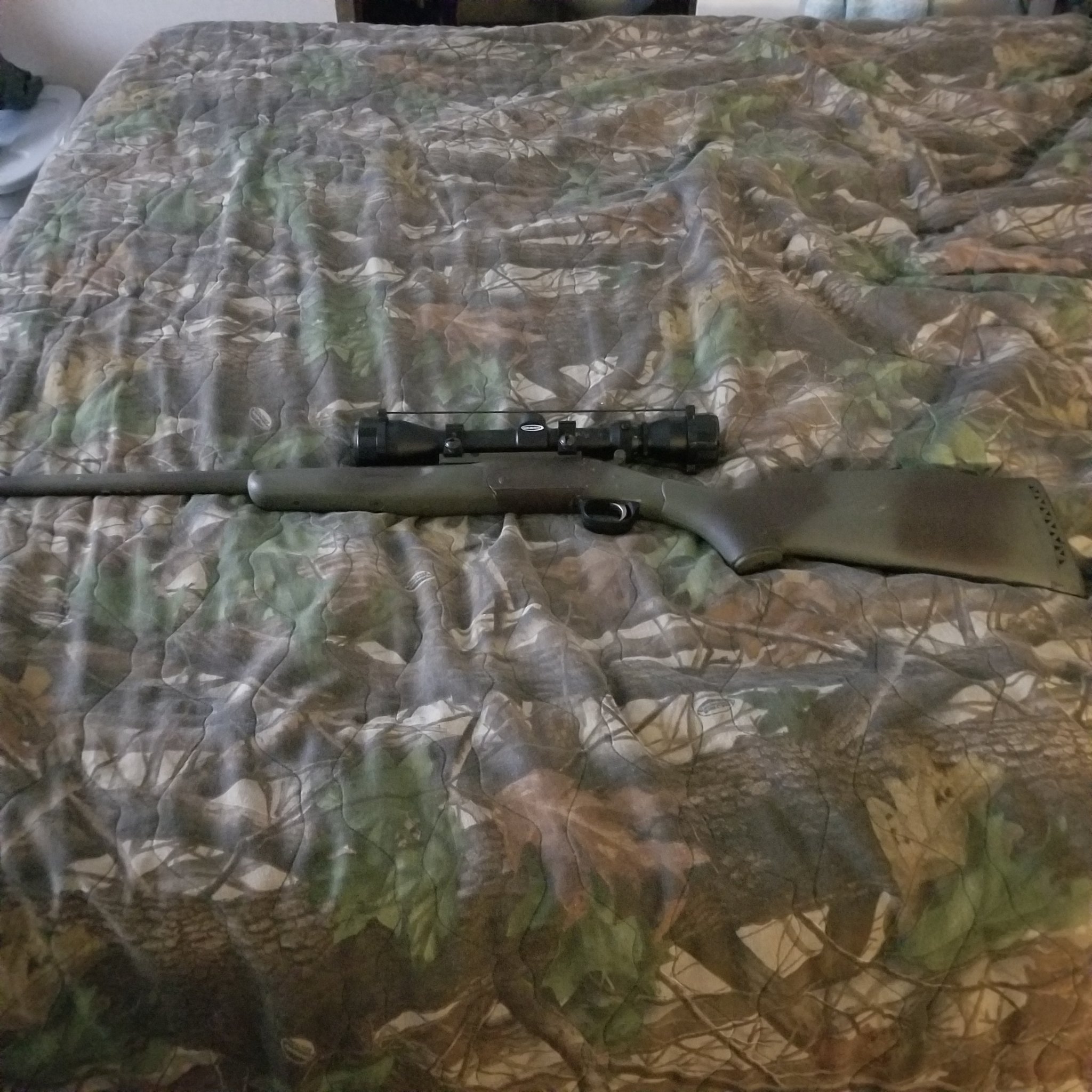

Wasn't sure where to put this one. So if it needs to be moved go ahead and move it.
I was recently given a New England Arms firearm in .223 caliber. It has a serial number beginning with NT. It also has Handi Rifle stamped on it. It also has a stainless barrel. Any idea of the year it was manufactured and possibly the barrel twist? I have yet to have a chance to take it to the range yet. Thanks gun gurus.
what no pictures for people to look at no chance to drool over your gun if its nice .
does it look like either of these ?
Yes it does look like the one without the sights. Only problem is everyone will chew my butt out because it was given to me camouflaged. Nothing I can do about that except break it down and try to remove the camo paint on it. Any suggestions for removing the paint? I will post a picture of it.

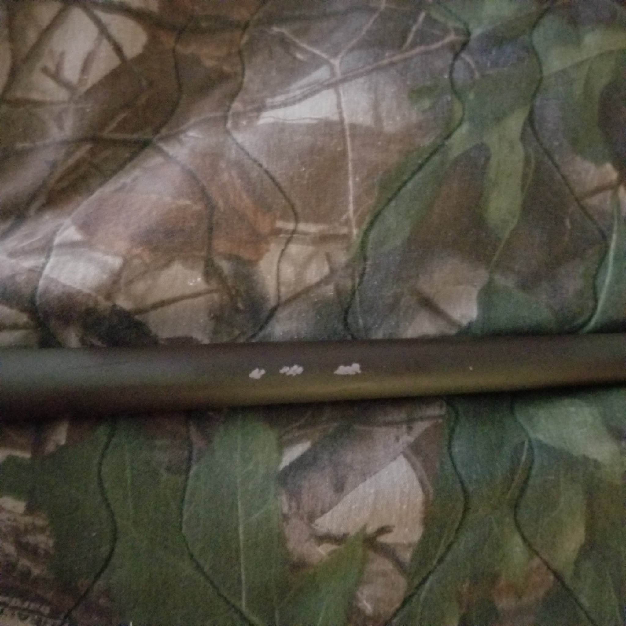

The only reason I could tell about the barrel is because there is a shiny place on the bottom of the barrel.

I guess I can either try to clean it up or leave it camouflaged. Just can't wait to get it out to the range

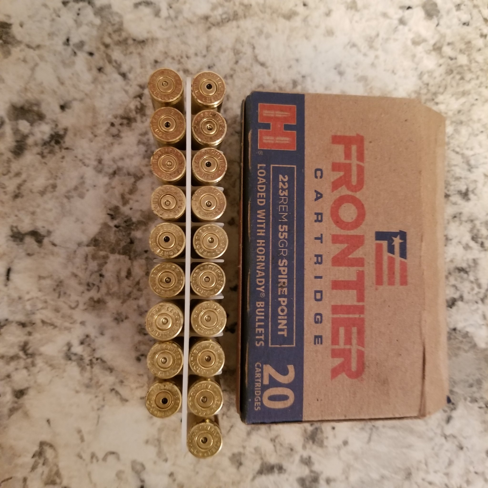

Ok. So I finally managed to get some .223 factory ammo so I shot a little bit this afternoon. A few of the primers got punched all the way through from the firing pin. Just a little bit of pressure sign on the head of the case. But it's hard to see that in the photos.
If you’re piercing primers, you may well have more than “just a little bit of pressure...”
Reactions: Bwhntr53
Can you please explain? I started doing some reading that it could be the firing pin.

I bought 5 boxes of these.
Pertinent section...
pierced Primers
If your firearm is in good condition, you should never see a pierced primer on a fired case. This pressure sign in particular is unmistakable: If the primer is pierced where the firing pin hit it, the pressure was too high. If you experience a pierced primer, stop firing the rounds immediately. This problem is more than a minor inconvenience; it can cause serious damage to the firearm. When a primer blows out, a high pressure jet of super-heated gas blasts out of the hole. This can cause erosion of the firing pin, breech face, or any other part of the gun that gets in the way. After piercing a primer, you should have your firearm inspected by a qualified gunsmith before firing it again with any kind of ammo.
I bought 5 boxes of this same ammo. I am not going to be firing any more of these. I do have 2 boxes of Hornady 55 gr vmax that I am am going to shoot just a few rounds just see what happens. 1 round at a time.
