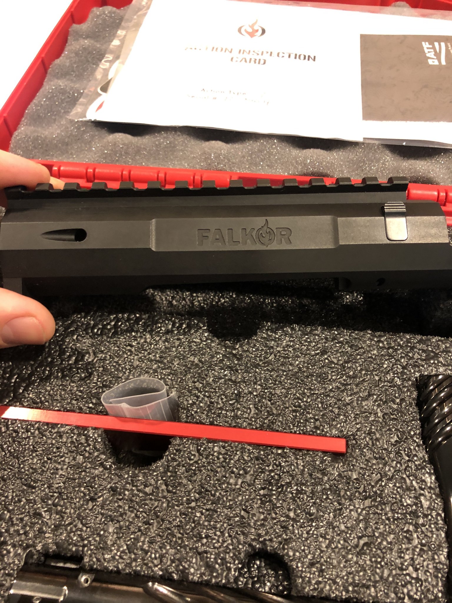

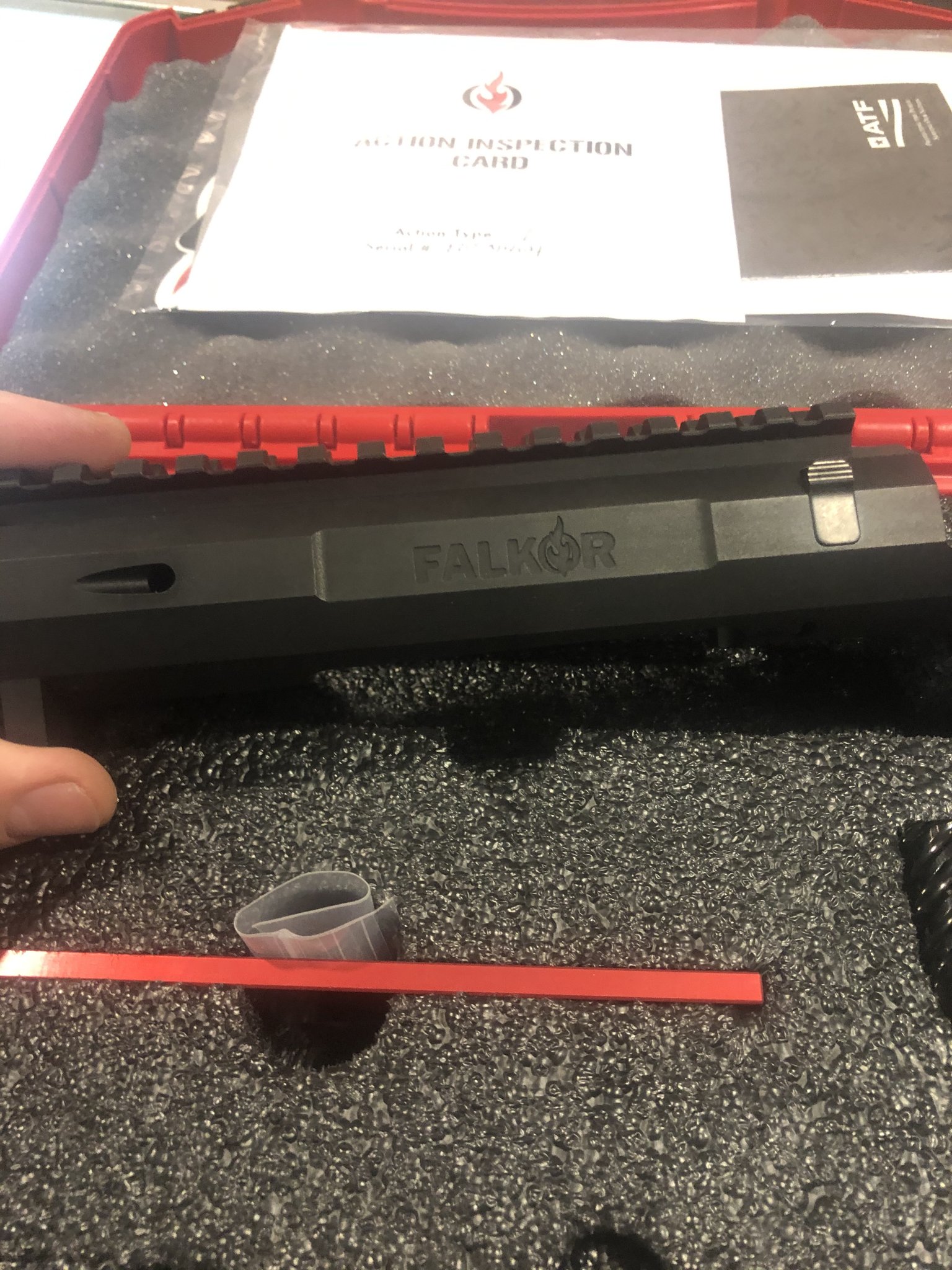

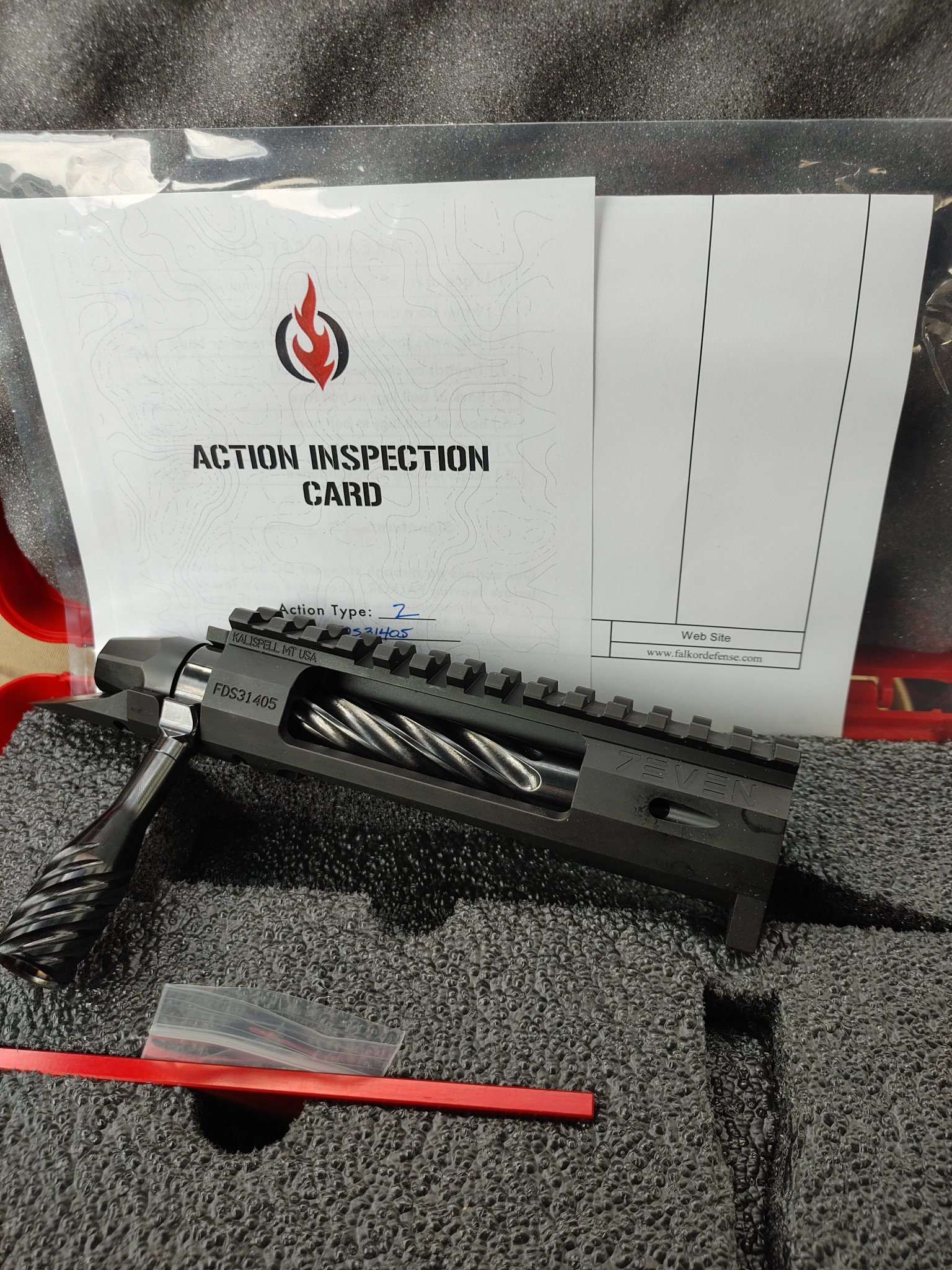

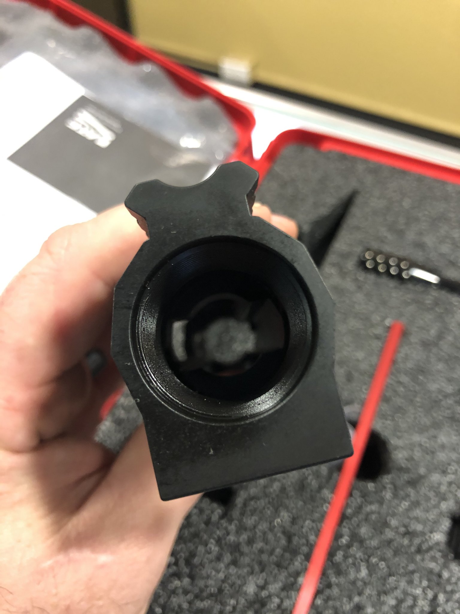

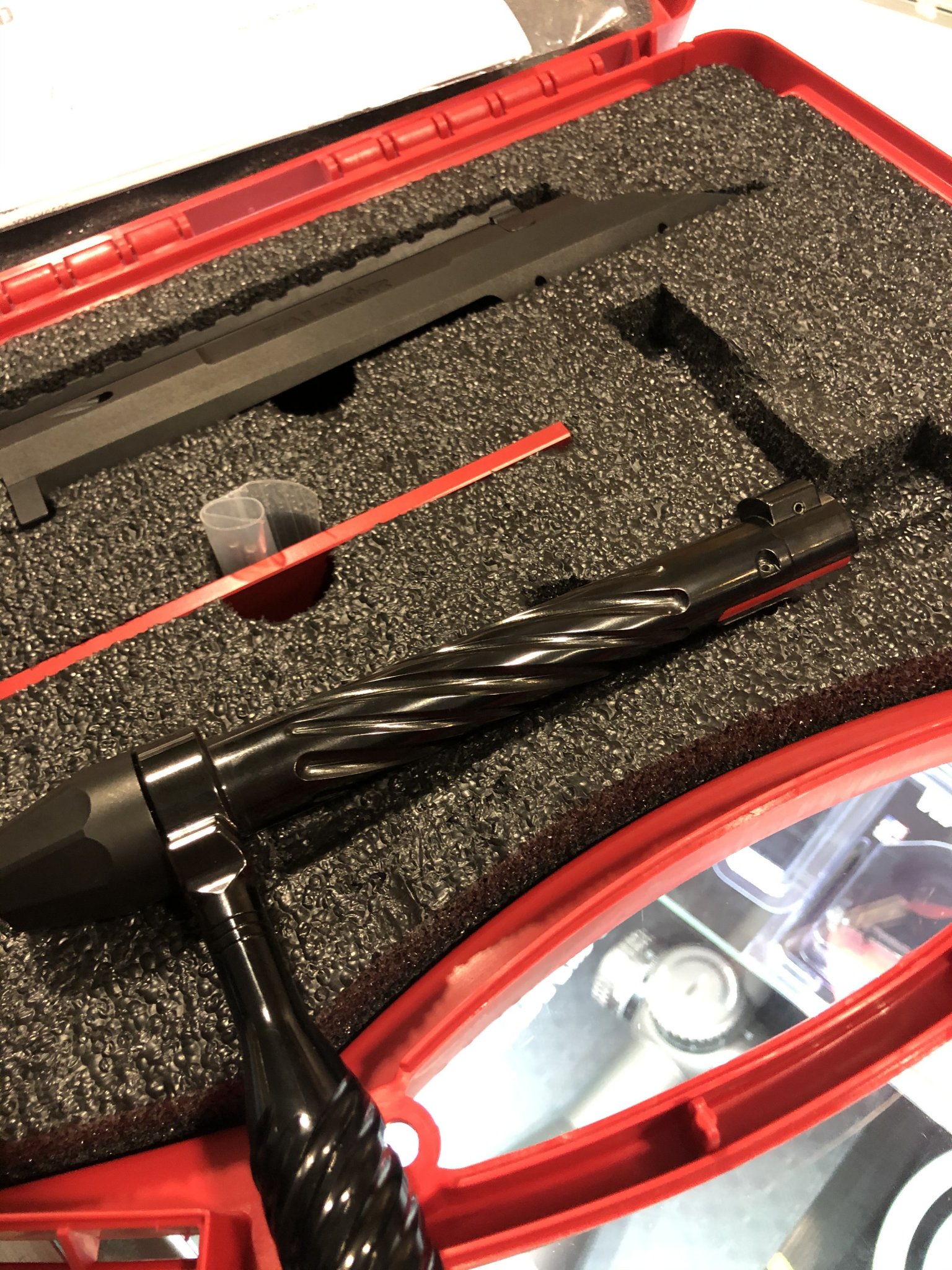

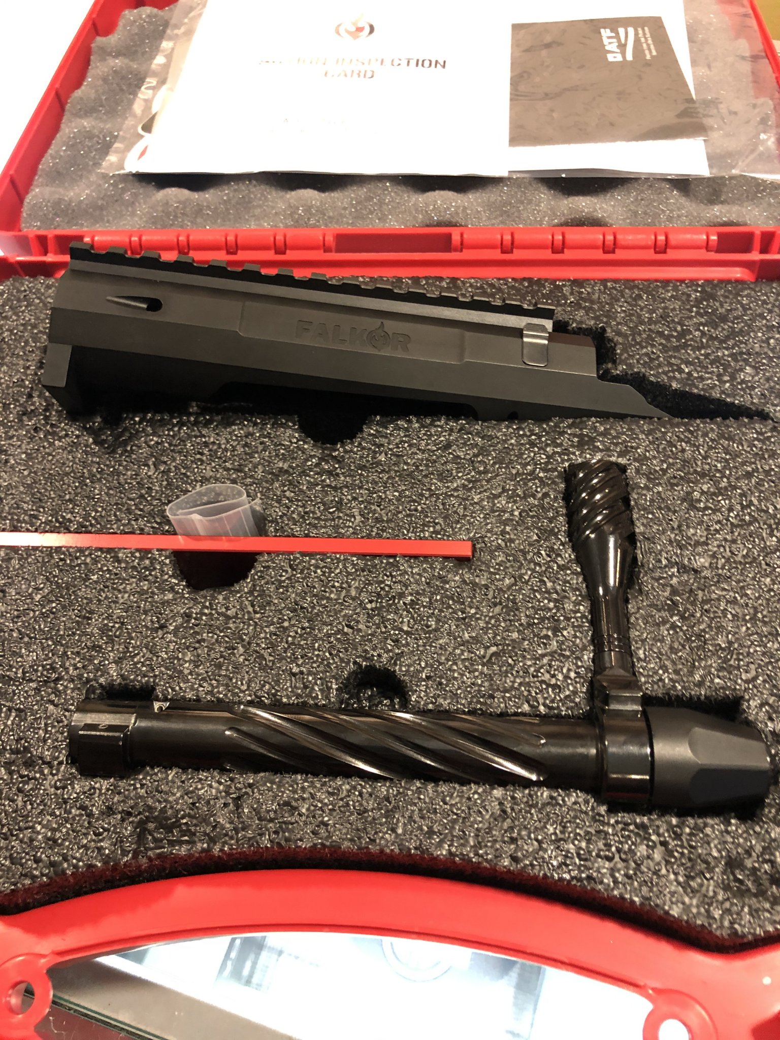

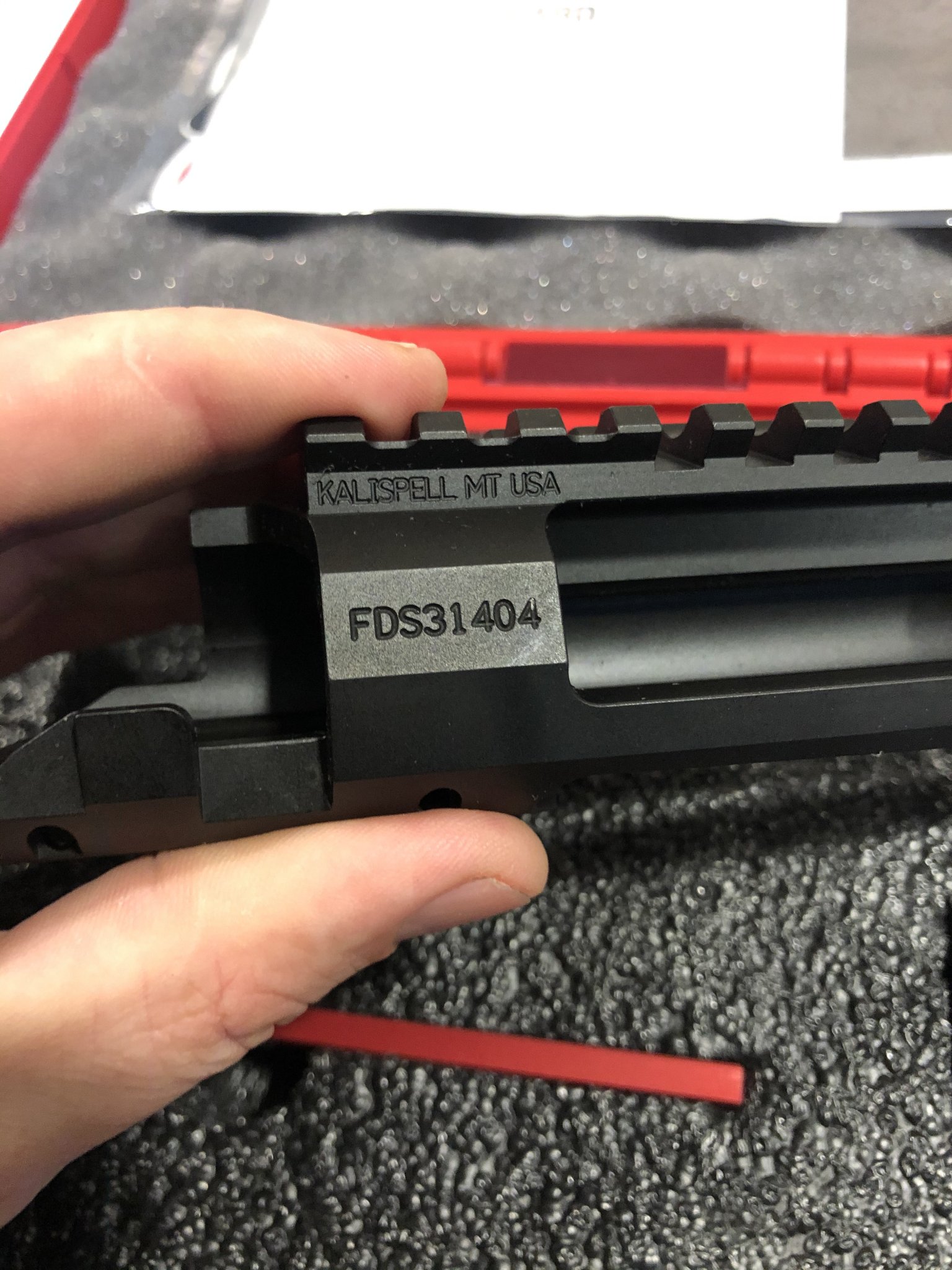

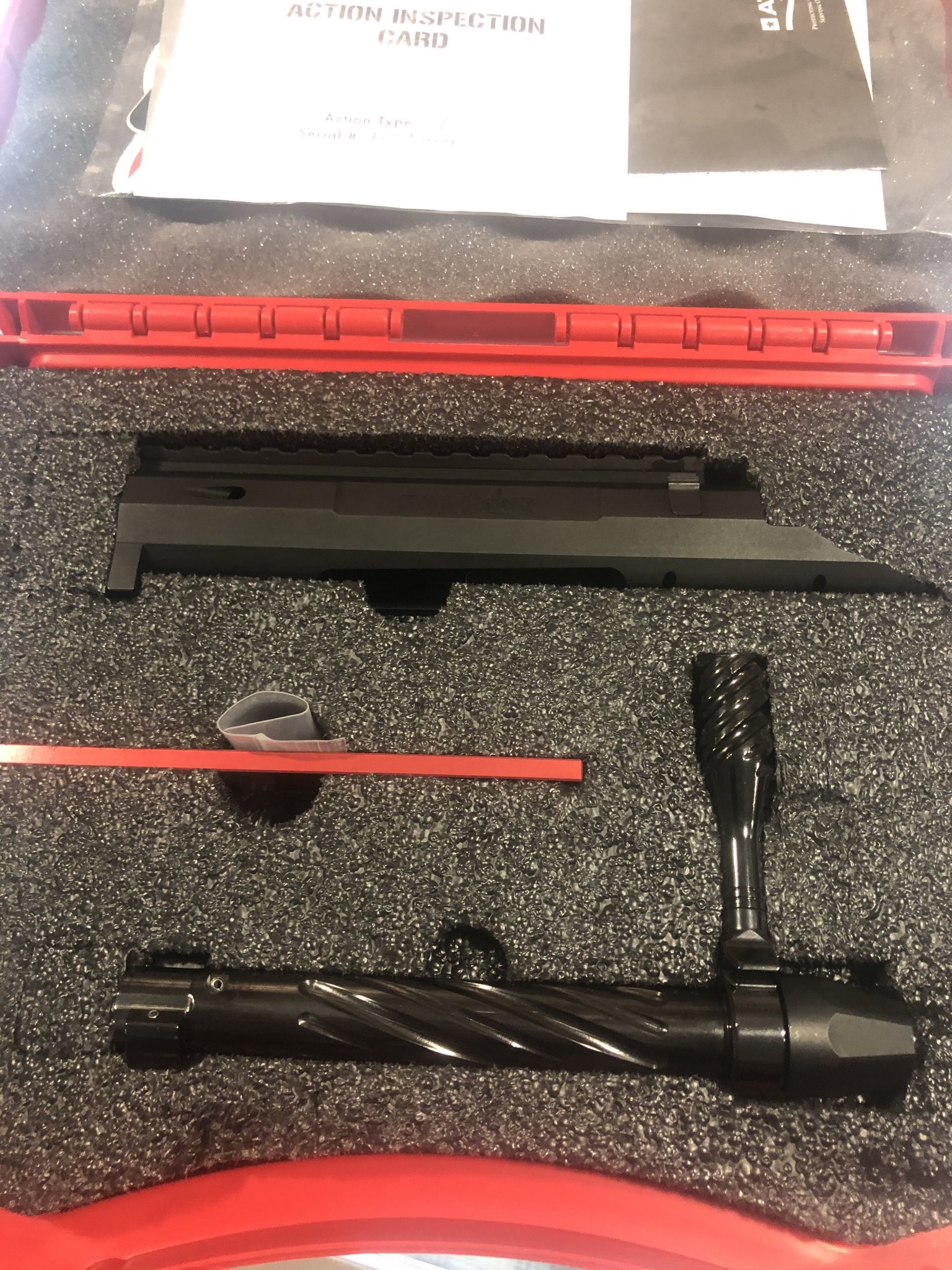

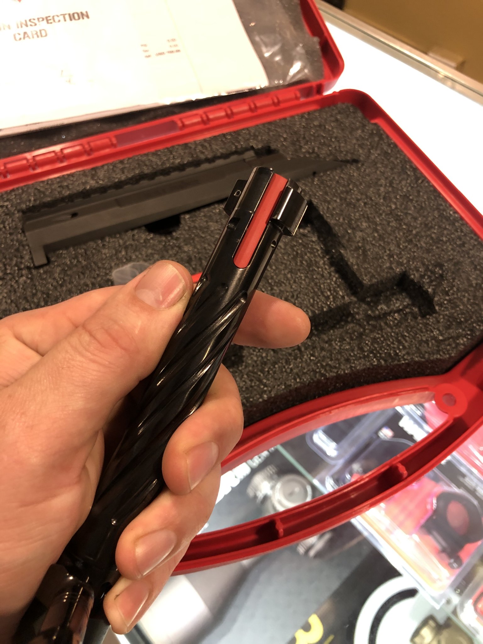

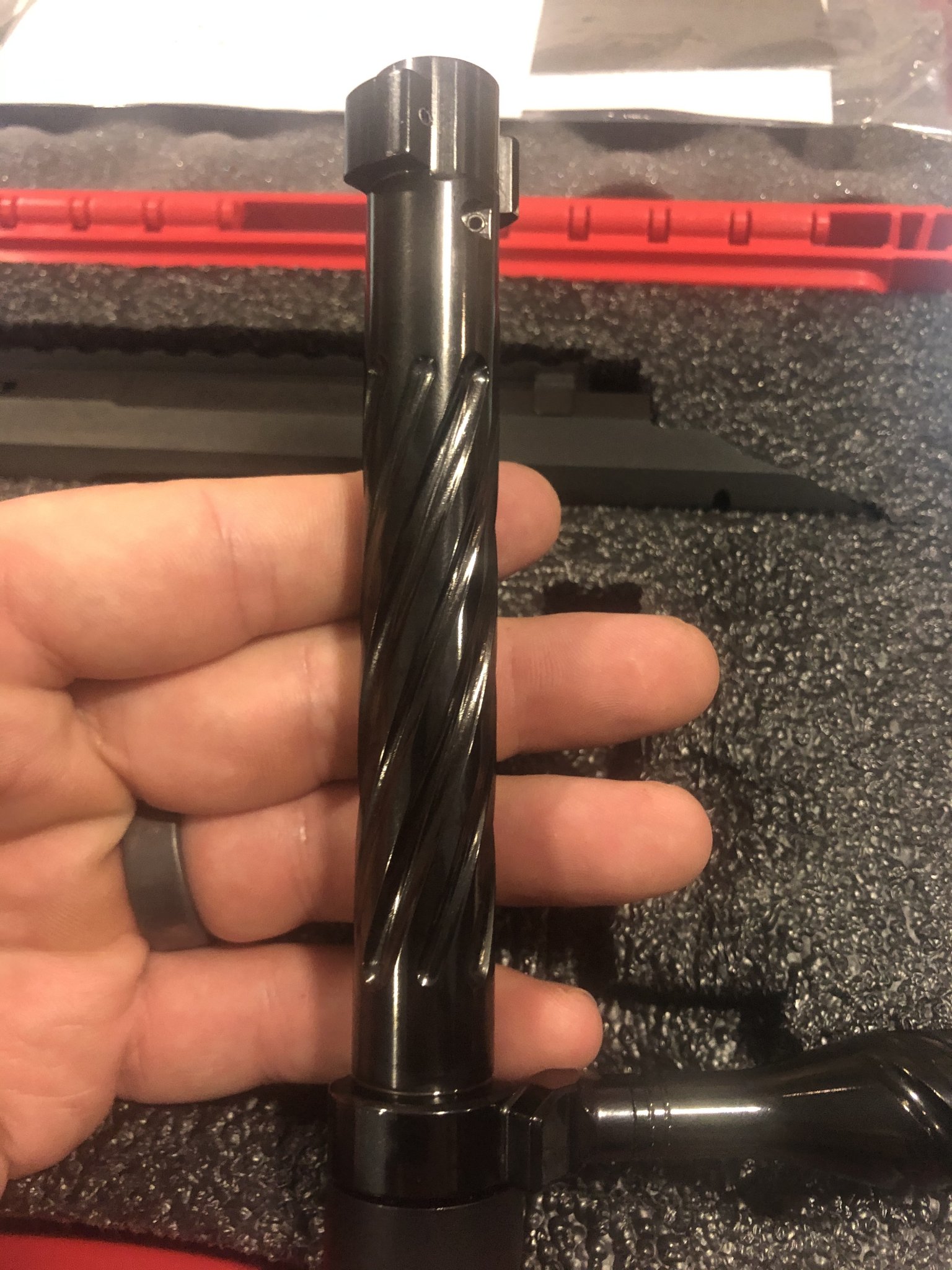

Got mine in today, super impressed with the quality, feel and packaging. Can't wait to get a barrel on it and see how it runs.

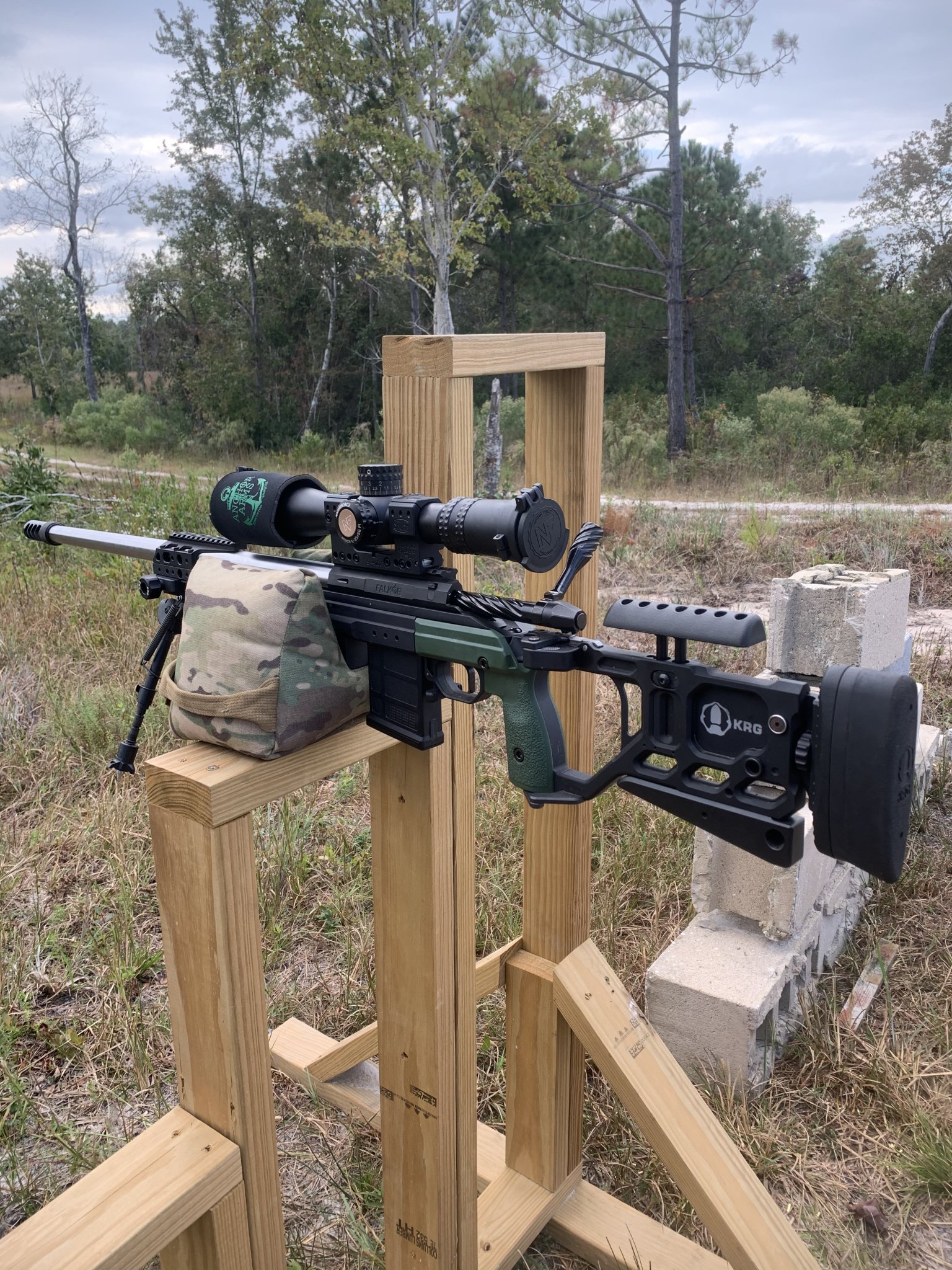

Finally got to shoot mine yesterday.
Lapua factory 90gr @2960 fps with an SD of 13. I don't mess around shooting groups at 100, but it stacked 5 rounds into about 2" at 400 on a plate. Swift Creek Rifles did phenomenal work and it'll only get better with hand loads.

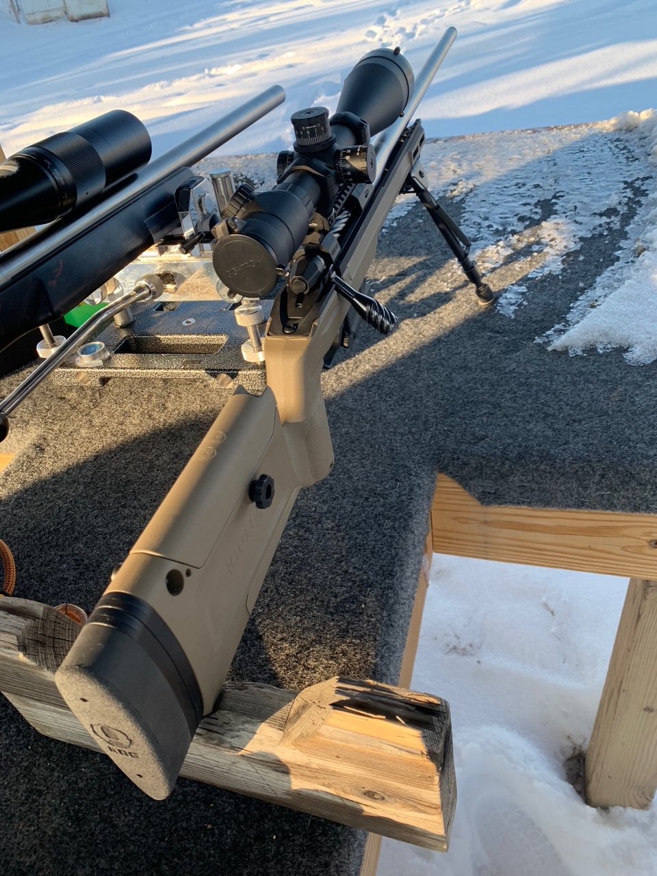

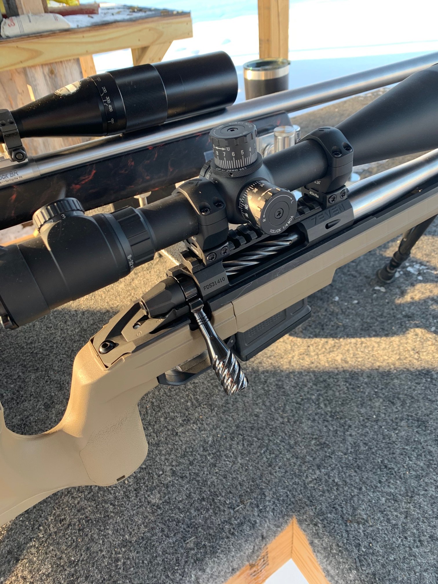

Finally got mine out yesterday after throwing some loads together.
* KRG Bravo chassis
* Brux Rem. Sendero contour 1-8 twist
* Jewell trigger set at 10 oz
* 22 BR with a Manson reamer: .252 neck and .050 FB
This is primarily a varmint rig for p-dogs, so 75 grain bullets will be heavies, and 55 grains will be used in most settings. The bolt is really smooth and solid feeling while working the action. How has the ejector been for others that have used the action? Mine did not throw the case clear of the loading port. Not sure if it was cold weather (25*), or if the spring is weak on mine.
* KRG Bravo chassis
View attachment 7519278View attachment 7519279
I found out pretty quickly that you can't pussyfoot ejecting spent brass. It wants you to run the bolt like a man.
Reactions: jhutch3313
:ROFLMAO: My problem is not wanting my brass to hit the ground (snow that day), due to my reloading practices. My Borden BR action was spitting the brass out of the dual port like crazy that day.

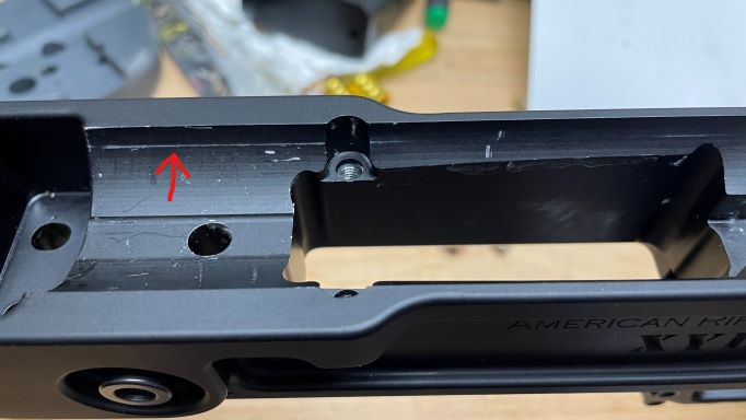

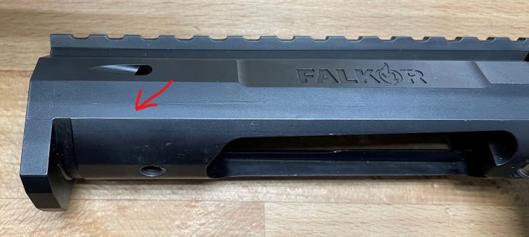

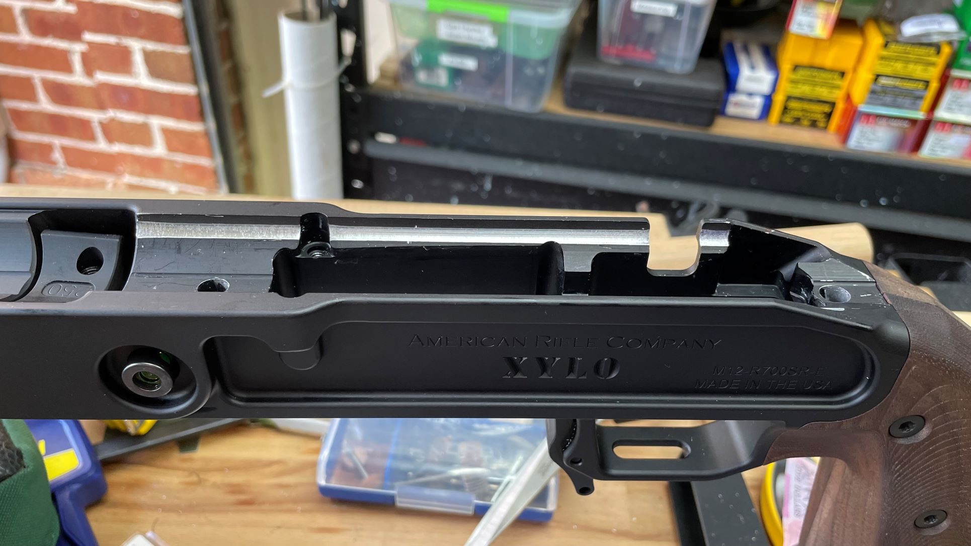

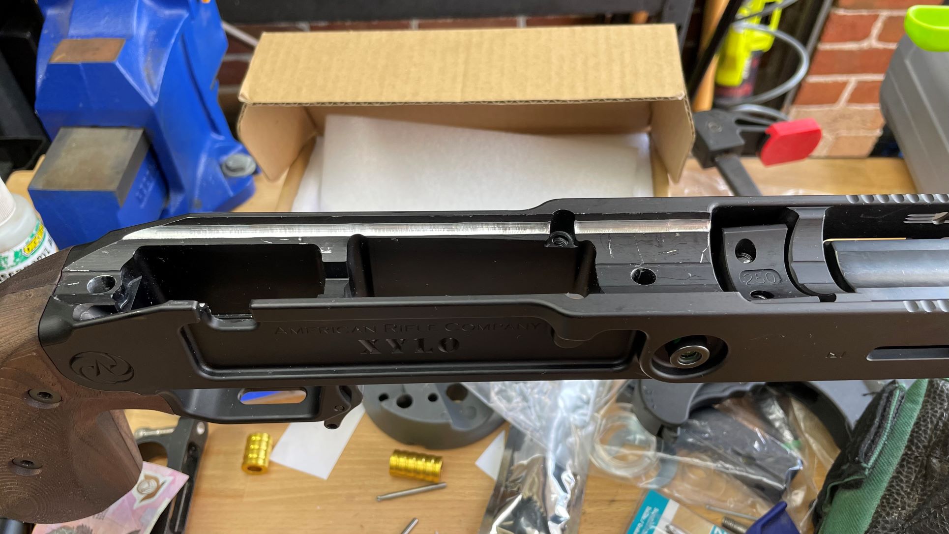

Hi All,
I've had my 7even action for a couple of weeks now. Still waiting on the barrel.
In the meantime I test fit the action into my chassis which is an ARC Xylo and was bummed to find out that it doesn't fit out of the box. Both the action and chassis are allegedly R700 footprint but as usual with these things, some fitting may be required. I don't know which one is out of spec.
The first problem is the line on the 7even action where the round profile becomes the flat octagonal shape. That corner edge is approx .020" wider than a round receiver would be at that point and thus the action won't settle into the round profile of the bedding on the Xylo chassis. This may be a unique problem to the Xylo as just looking at some of the other pictures in this thread the 7even seems to mate very well with other chassis.
The second issue is the distance from the action screws to the recoil lug is too long, thus when the recoil lug was fully seated against the bedding block the screws were being pushed back too far and binding in their holes. I don't know if this is a case of the 7even's dimensions being too long or the Xylo's being too short.
Anyways, problem number 2 was an easy fix with a round file to elongate the action screw holes on the chassis so the recoil lug could bed properly.
Problem number 1 took some creative thinking, a lot of measuring and some heart-in-mouth moments as I machined some grooves into the chassis so that the action could sit properly in the bedding. I'm now happy with how well it fits into the Xylo chassis.

Hi All,

Hello CamoWhamo, we are sorry to hear that you were having some fitment issues, yes our actions are R700 compatible, there is some variance from brand to brand on where the recoil lug sits from the action screw, to alleviate this many brands have moved to oblong holes on the chassis body for the action screws to allow adjustment, we have recently adopted this practice on our own chassis, so that if customers wish to run another action it allows them to take up any slack between the recoil lug and the chassis. As for the first issue you were having with the action seating in the bedding area, we have not heard of this happening with any other brand of chassis, however we will be looking into it, and getting in contact with Xylo or getting in a chassis to test fit with. If you need anything please fell free to reach out to me, or the shop.
@CamoWhamo that's not good to hear, I haze a xylo and have ran 3 different actions in it, impact, nucleus and origin without issue, really like that chassis for my lighter field configuration. I have been contemplating a 7even for a lil bit and am about to pull the trigger, but having to mill my chassis open isn't something I should have to do.
Thanks for the reply. I think this issue is probably unique to the ARC Xylo. I have no complaints with my 7even. I'm actually very pleased with it.
To be fair to Falkor, I'm sure ARC designed the Xylo to mate with their own actions (Mausingfield, Nucleus, Archimedes) which are all fully round receiver profiles. The bedding area of the Xylo is also a full round profile and not the typical 'V' block you often see on chassis'. The Xylo's bedding wraps around the receiver a lot more than other chassis where the action more or less sits on top of the bedding.
Over in the Xylo thread there are some users that have mentioned the Xylo won't fit a genuine R700 with the factory trigger, so while ARC say it is R700 compatible, it's not 100%.
I really want to use the Xylo because I just love the ergonomics of it so I decided to make it work. It was disappointing that I needed to do some fitting but I was not surprised.
P.S. If you do get a Xylo for testing you will also need to change the recoil lug wedge to the .250" part.
Edit: I've attached a couple of before pics which show where the action was too wide for the chassis.

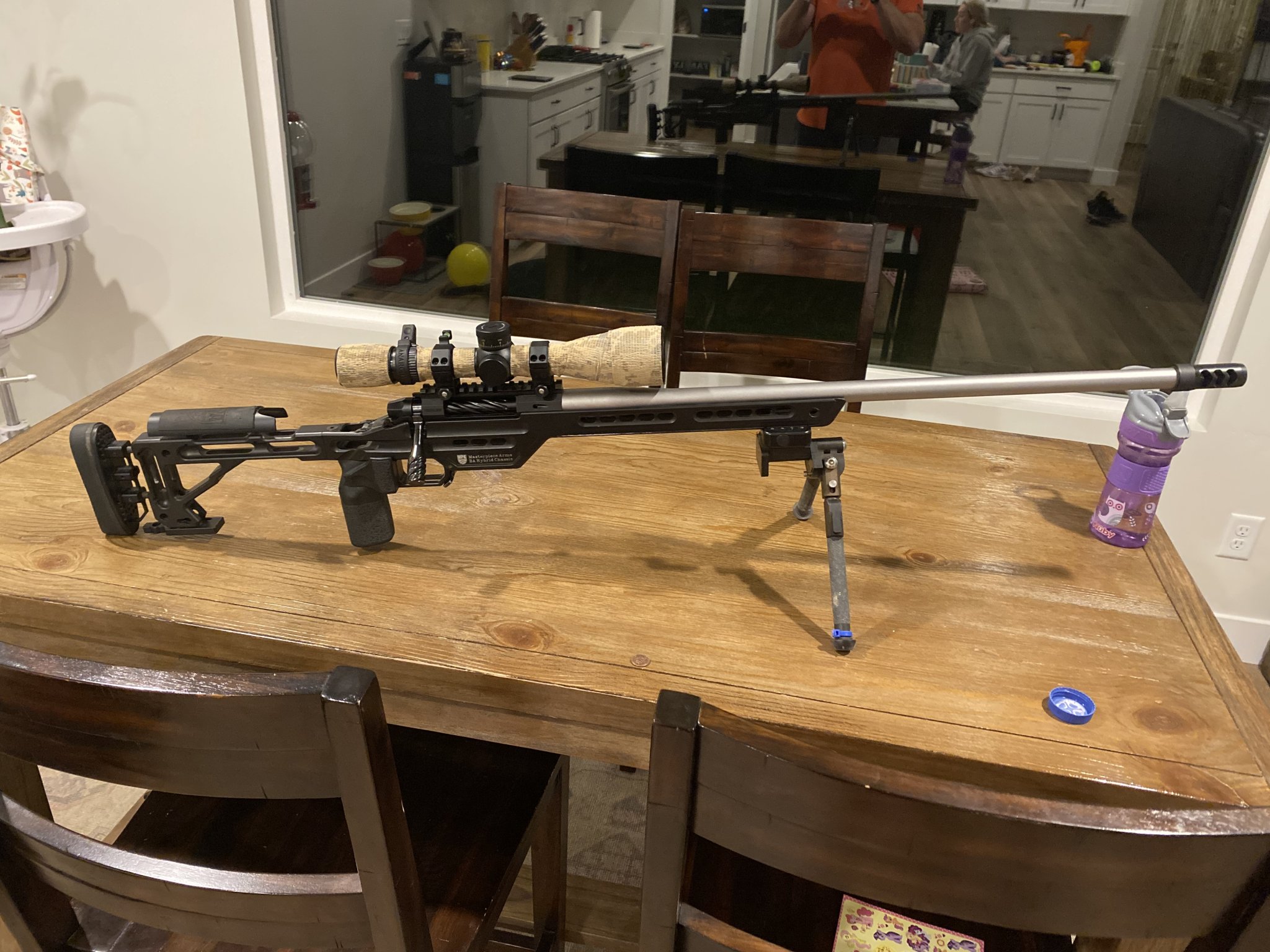

I just finished a Falkor action build in 6.5 creedmoor for an NRL hunter build. It’s a smooth action! Not as smooth as my lone peak action but that’s the good standard for me. Excited to run it in a match come January 14th. I’m optimistic it’ll do great. Of note, it fit into a krg bravo and mpa hybrid with zero issues
