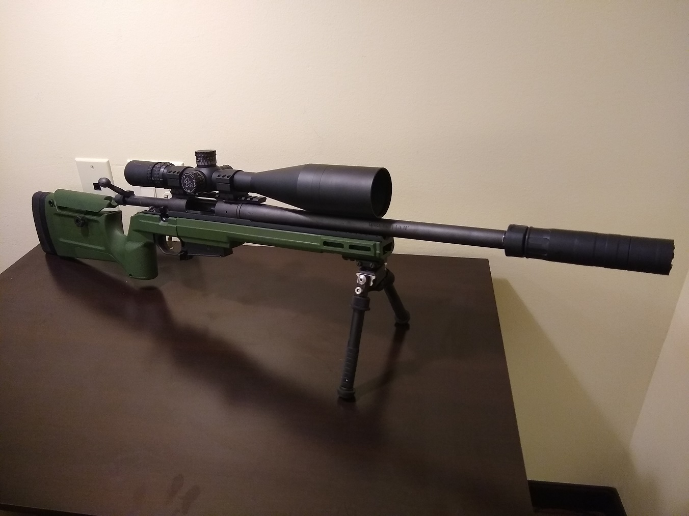

    I dropped my AAC-SD .308 into a KRG bravo as was mentioned. I love this chassis. It has a Triggertech trigger in it and that was a HUGE upgrade from stock.
    edit: I will say that this rifle has spun me off into shooting much more than I ever imagined. LOL
