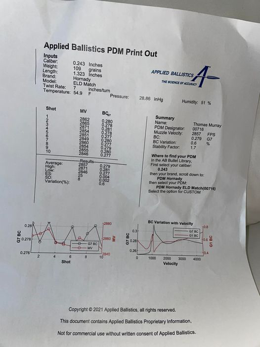

    Anyone else worked out the real world BC of these. Pretty disappointing if they only hit the .280 mark with an advertised BC of .295. Not that I would be surprised if that were the case. We have 2 cases in this thread where the BC varies.
    It depends on how you calculate the BC. Over what range and by what metric. 100-200yd high velocity published BC's is nothing new.
    If you go 0-1200 the BC that matches my real world/doppler results (MV 2750fps) for retained velocity is ~.265 G7. For drop at 1200 it's about .280. For 600yd velocity it's ~.280, and for 600yd drop it's .295. To match 200yd velocity it's about .285.
    Which kinda serves to show the subtle issues with BC-based solvers. You're making the assumption that the drag profile of the bullet you're using matches up with the G7 standard projectile and most of the time it doesn't. If I were shooting a 6mm Creedmoor my BC numbers would be different from the above. Using a simple fixed scaling factor like BC is like using a single photograph/frame to represent a video. Sometimes it works well, sometimes it doesn't.
    At any rate, if you use 4DoF, you can use the 109 profile as-is (I believe it's on the mobile app), or use a 110 with an axial form factor of 1.05 or 1.06 and it will line up with velocity and elevation all the way out.
