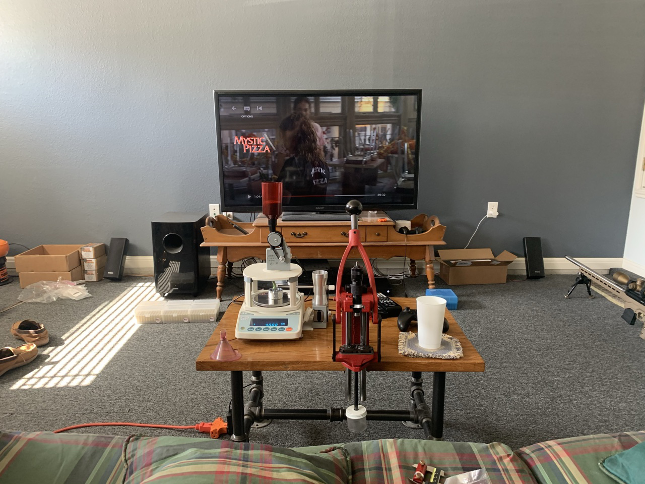

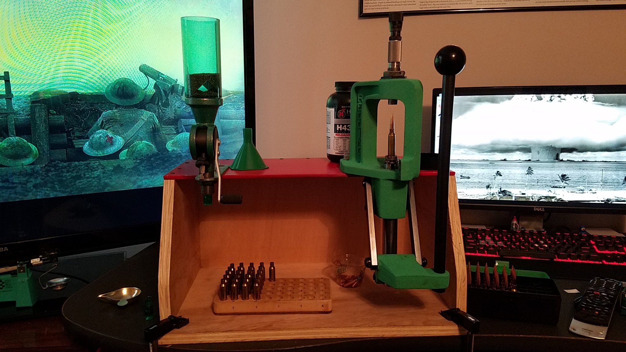

Bolts and wing nuts. Makes it easy to put on the coffee table and then remove when you’re done. Mines in the converted garage but if I move I’ll do the same thing in the living room.
(Don’t say shit about what I have playing, I’ve seen everything else)
Not gay porn, you are good.

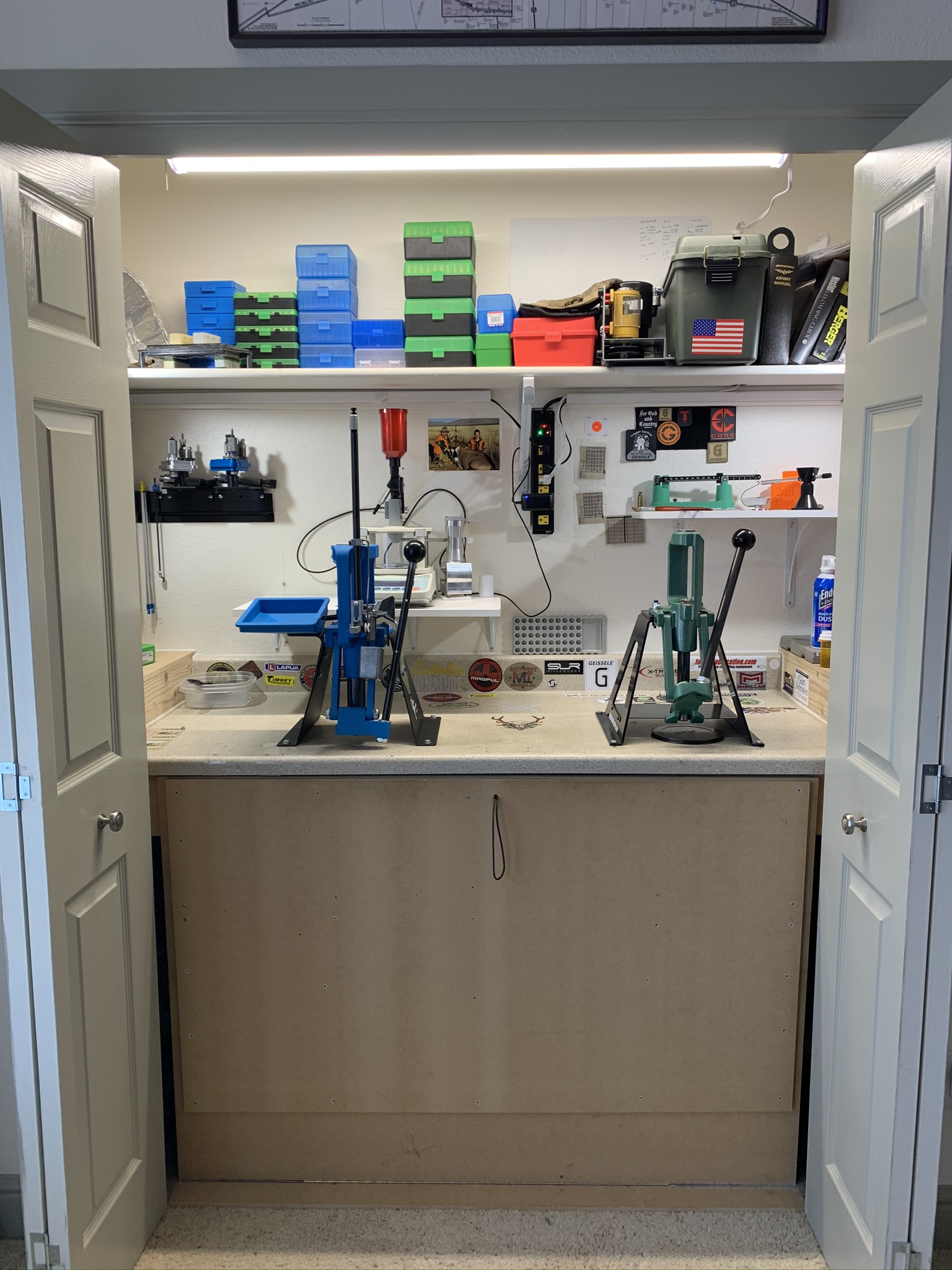

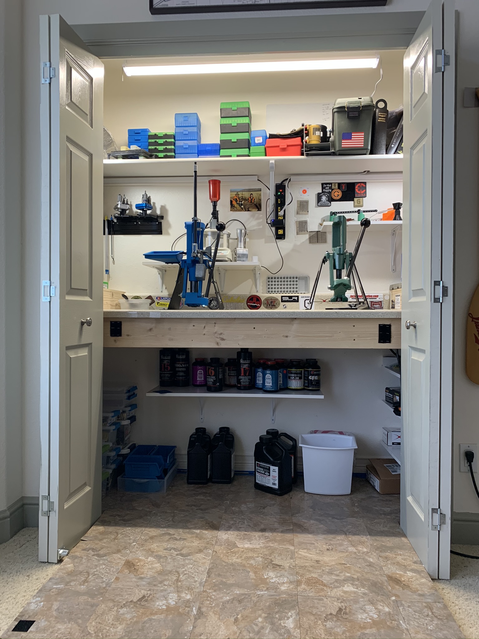

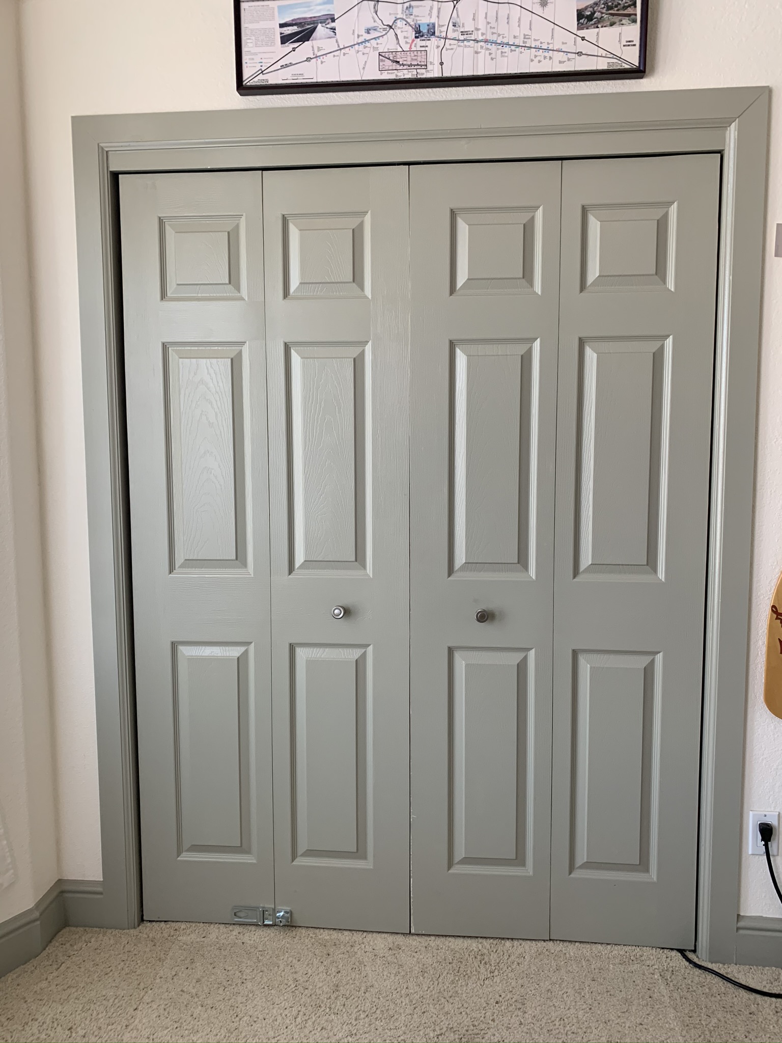

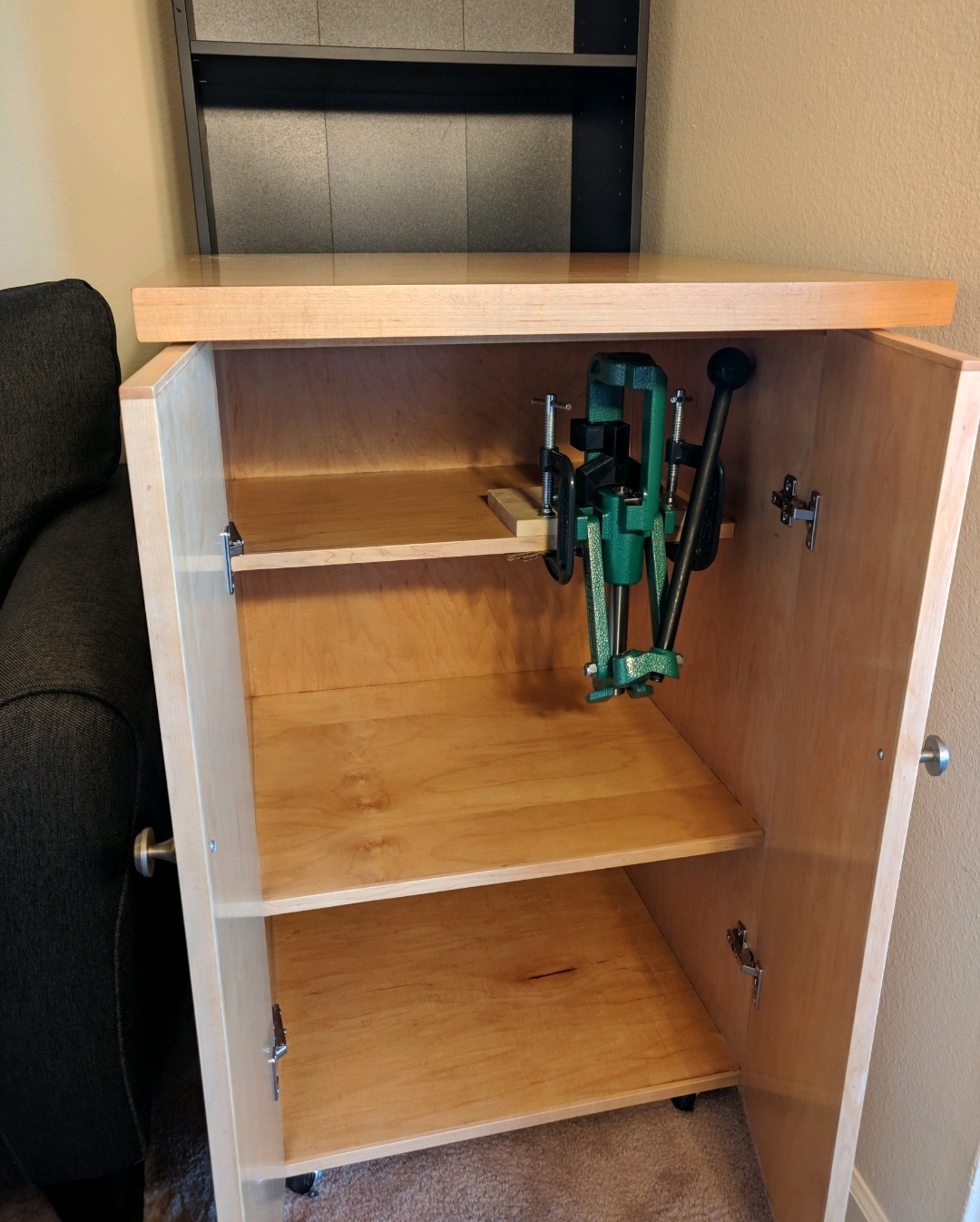

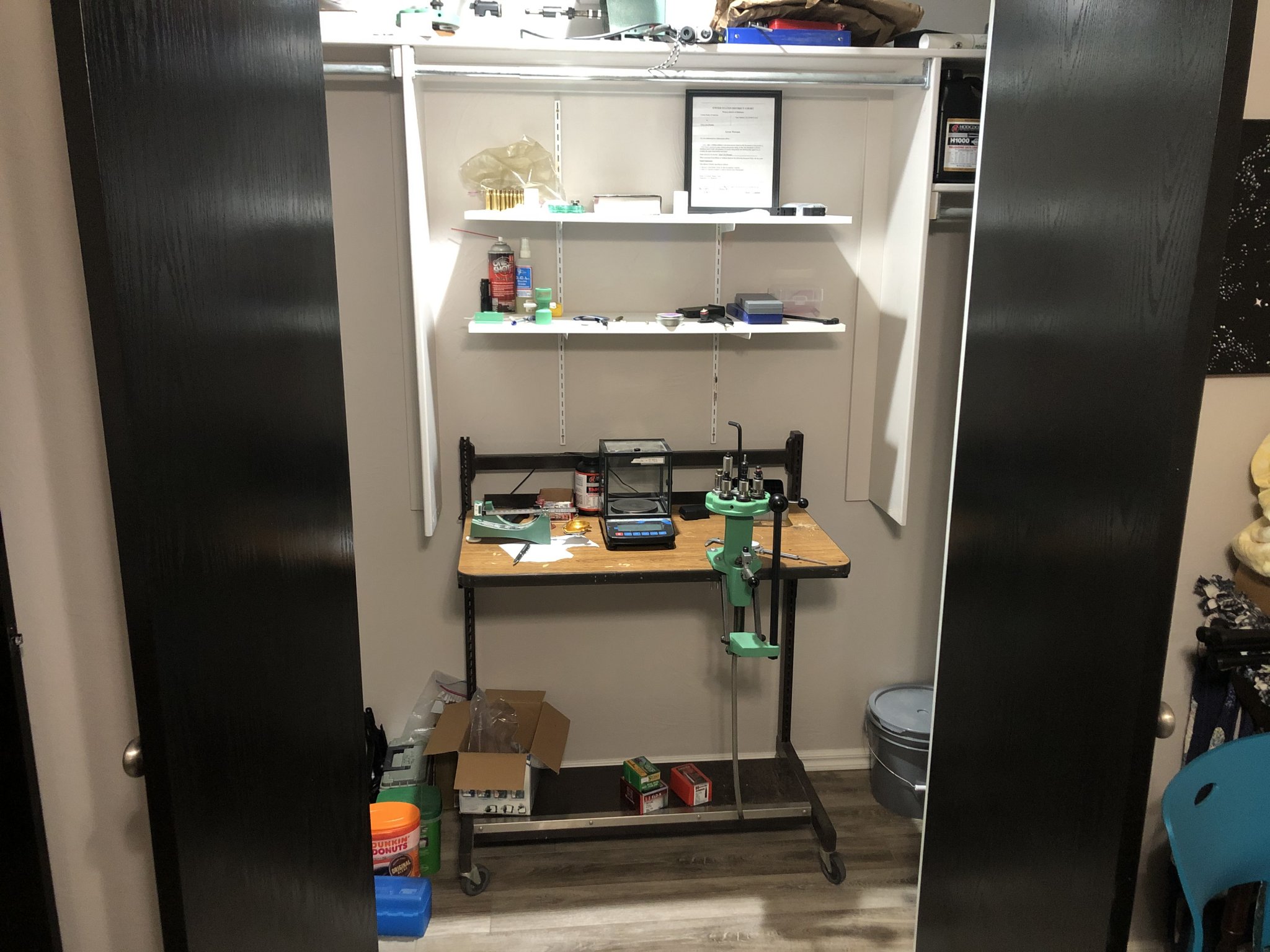

I set it up in a closet. Stows completely away. I have a fold down “floor” to catch stray powder from the carpet. This is a standard bedroom clothes closet. The Lowe’s generic counter top is on a frame that is lag bolted into the studs rock solid View attachment 7564680View attachment 7564682View attachment 7564684
Very elegant!

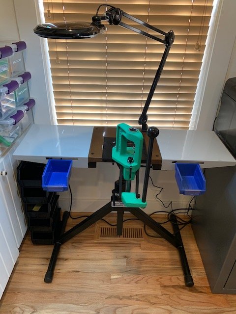

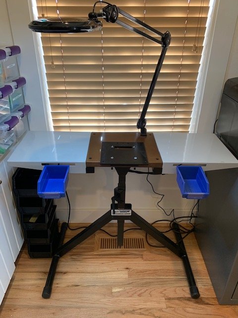

I bought a harbor freight bench grinder stand and got two 24x24x1 pieces of plywood which I glued and screwed and together. Bolted the wood to the grinder stand and used that in the small laundry room in the apartment days. I always left the wood attached to the stand but you could always take it off and stash it somewhere for easier storage.
I just have to say, that's impressive.
Reactions: High Desert duck
You are a genius dude.
That is very impressive.

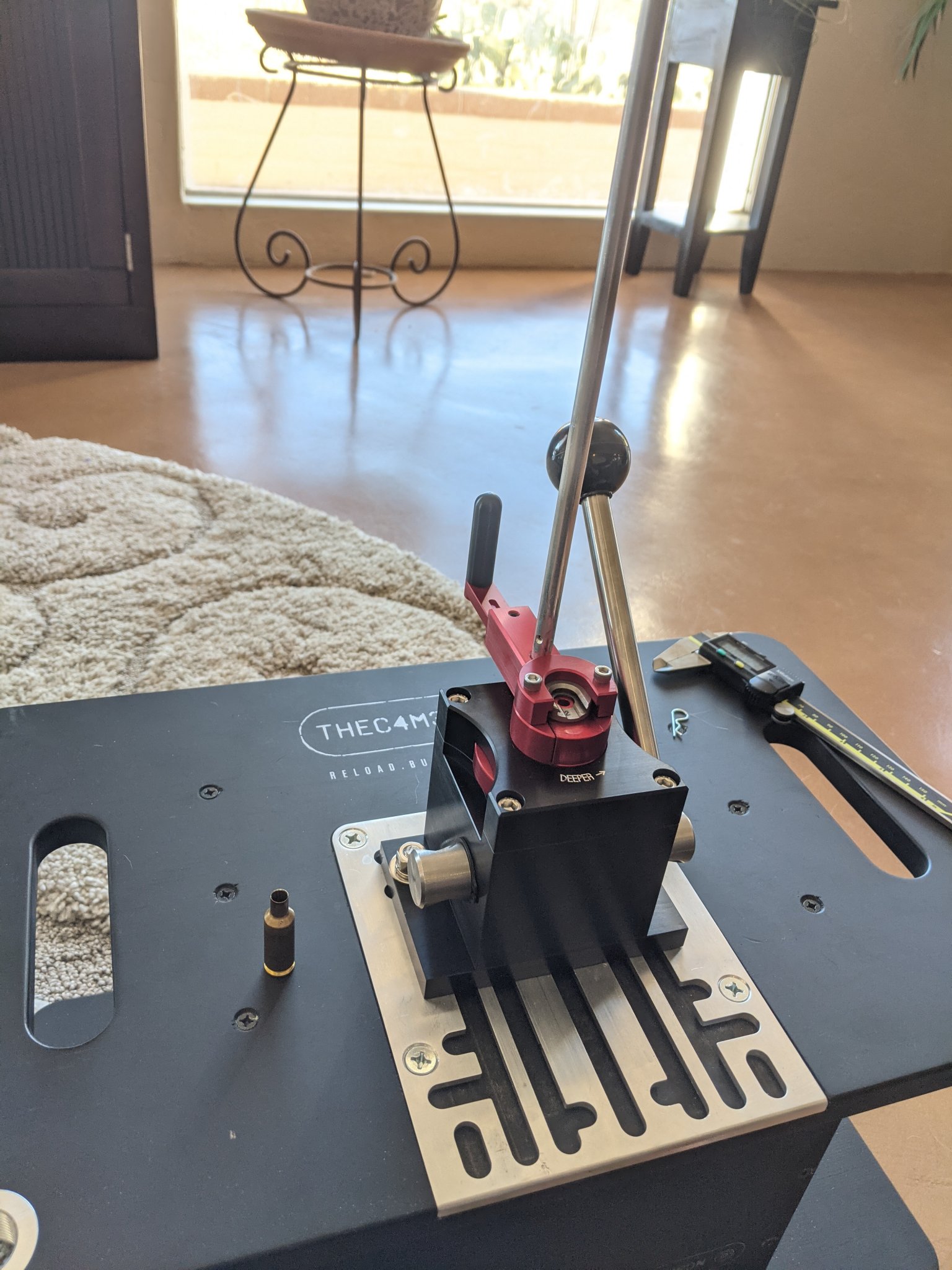

When I was in a similar situation, I bought a "The C4m3ron" reloading bench. It's not being made anymore, but it was a simple bench made out of wood that you would put a ~25lb bag of sand or shot on the inside to stabilize it.
I now use it for my CPS Primer, so I can prime in the living room.
However, there are some really badass solutions posted here. The closet and metal work cabinet are pretty amazing compact setups. That Harrel's compact press seems like a very elegant solution.
This^^. I also run the C4m3ron with a Dillon 550 but you could make your own "H-box" type mini table and attach a press to it. It is a truly portable solution, but once you load it with a sandbag, it sucks to move. Unless you bench 275 and something about bow kills and concrete :) I've used mine in the kitchen, spare bedroom and even in my camper.
