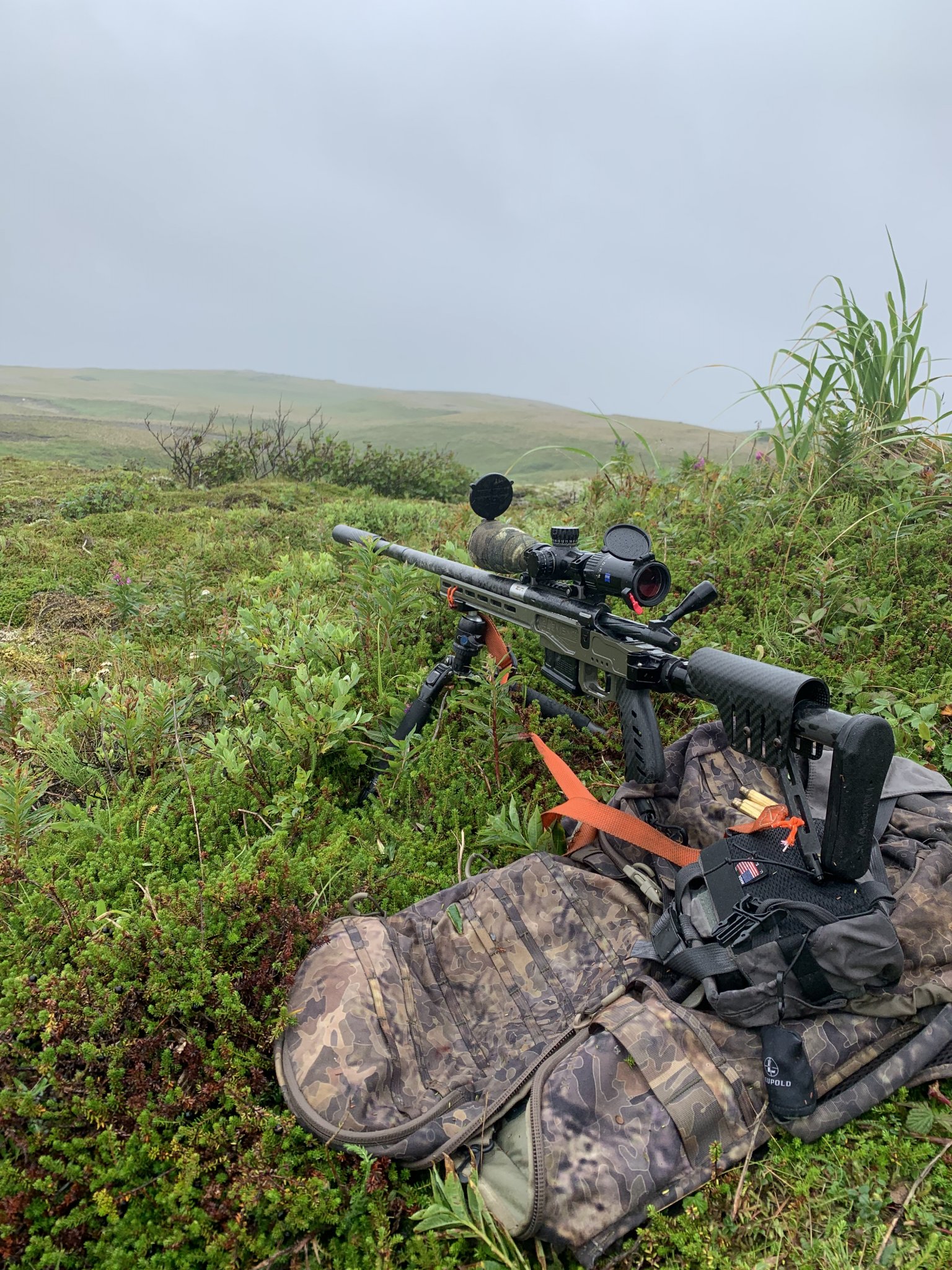

Zermatt Origin, 24” proof 300 wsm, Ultra 9, XLR magnesium, Zeiss V4. 9 lb 13 oz. Current load; 200 gr ELD-X at 2930. Other loads; 185 juggernaut at 3040, 176 A-Tip at 3130. All with RL-26.
Imo, 300 is kinda overkill, I went with it because I wanted 200 grains of fuck you power. This action has another barrel in 7 saum, 26” proof ss, and another chassis for straight up range work. Next iteration will be; AntiX and 18/20” proof carbon in 7 saum.
