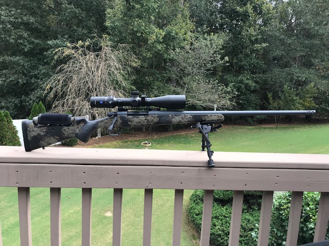

Got it back a couple weeks ago and am very pleased with the build. Used a smith in Screven Ga that came highly recommended and couldn't be more satisfied with the out come. AO was going to build it but they closed up and was going to send it to some other smith's that I have used on other builds but decided to go this route.
Trued 700 action
Manners EH6A
Hawkins BDL bottom metal
Brux 10 twist barrel chambered in 30-06
KDF brake that works great
Topped it off with a Zeiss V4 and the gun shoots excellent.

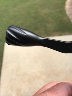

Attention to detail,blended bolt knob instead of just ground off and threaded..

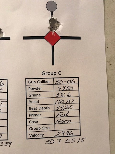

Haved confirmed this load 4 times and shoots 1/2MOA or better

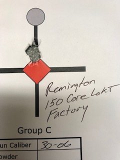

And some shitty factory ammo

10LBS with bipod,scope and #4 contour brux barrel
Gun shoots excellent. Load was worked up with Nosler Ballistic tips
Shot some Hornady SST's and they are showing good results also. Need to play a little more with powder on those. Shooting H4350 with both bullets.
