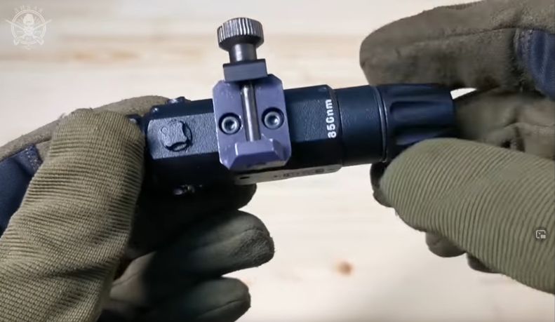

I've been researching IR laser illuminators to find something that matches well with a Perst 4, with similar rugged build and power capabilities.
Many are using the Luna ELIR-3 for this purpose, one of the few stand-alone illuminators with full power on tap. It does have some downsides though - there've long been complaints about the design and build quality, bulky mounting system, sensitivity to recoil and its exposed power control dial. It also doesn't have a weatherproof rating.
On the positive side, the potential output is comparable to the full power DBAL-A3 (80mw) and LA-5B (80mw).
So when I came across a unit with more power than the ELIR-3 I was curious. I'd never heard of it since it's never been advertised or sold in the US...the Electrooptic IR 530-850 Digital Laser Illuminator.
Electrooptic (EO) has been making night vision equipment since 1996 based in Belarus. The ELIR-3 is also made in Belarus...by Dipol.

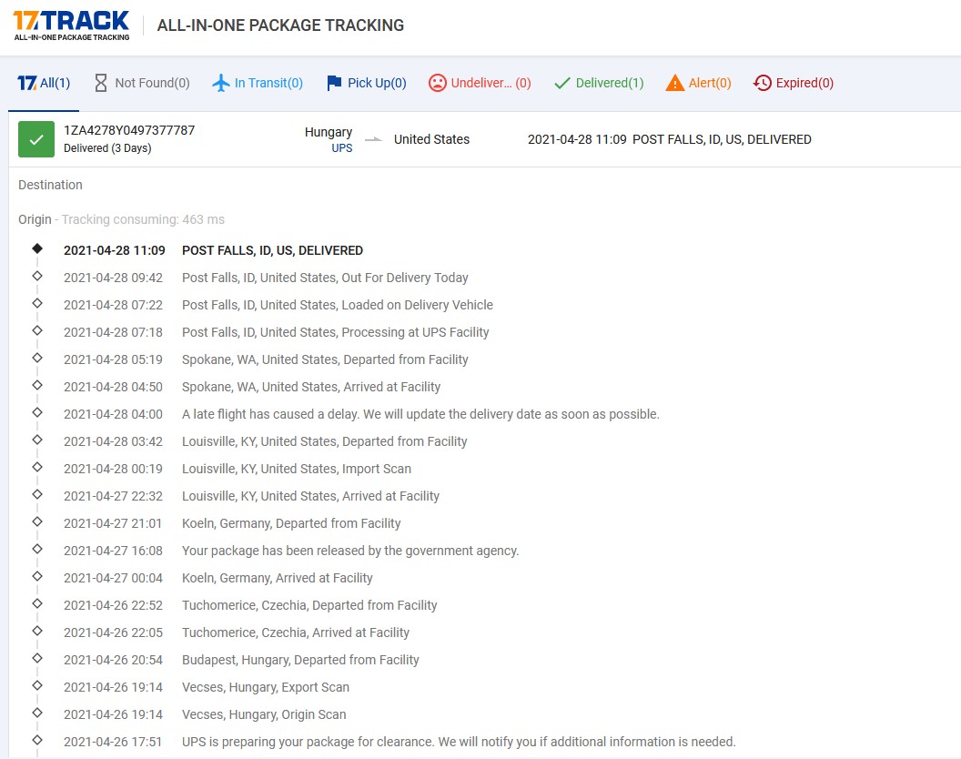

I ordered the EO unit on the 16th and it got here on the 20th via UPS from Hungary. Not sure if that was a fluke but impressive. Am on a trip at the moment so can't do full testing, but wanted to share details/impressions so far.
Build quality: CNC milled T6 aluminum, 500g rating for recoil, tested to .375 H&H. Has a rugged, high quality feel
Size/weight: 4.8 inches/3.2 oz; ELIR-3 is same length but plastic construction makes it 15 grams lighter
Appearance: modern shape compared to the tube-with-a-dial look of the ELIR-3
Wavelength: 850nm (785nm for the ELIR-3)
Laser class: 3B
Power: adjustable - low, med, high and turbo. High is 150mw, turbo is 300mw. ELIR-3 max output is 70mw. (Ultra High Power LA-5C = 200mw)
Power-On Indicator: recessed LED power-on indicator with different intensity for each power level - blinks in turbo mode
Power Control: button on top has a firm feel and is mounted inside a protective ring to prevent accidental activation
Power memory: on/off and power status maintained if battery is removed
Focus: wide focal control (.5-20 degrees). ELIR-3 is .1-5 degrees. Limited beam spread is a limitation of both ELIR-3 and the Perst-3
Focus Ring: nice action, not too loose or tight with solid end stop. Lots of travel, not a quick throw design
Lens: appears to be high quality glass. Diode is set deep inside the body to reduce glow
Range: specs say 800m at 1 degree but new model goes down to .5 so it may go a bit further
Windage & Elevation: recessed adjustments with protective outer rings...small 2mm hex screws but a beefy setup overall
Battery: 1x CR123 or 16340 battery w run-time 4-20 hours (ELIR-3 claims "up to" 4 hours on CR123...not rated for 16340)
Mount: small removable picatinny mount attached with hex screws, allowing use of custom mounts (ELIR-3 mount is built-in)
Weatherproofing: IPX6 - not submersible but otherwise waterproof. ELIR-3 not rated
Temperature rating: -20°С to +50°С (ELIR-3 not rated)
Warranty: 2-years (ELIR-3 is 1 year). Service is done within EU, not Belarus, to avoid shipping delays

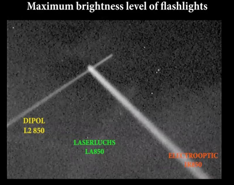

Dipol L2 850 is the more powerful (100mw) EU version of the ELIR-3.

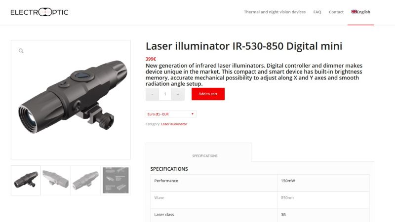

Here's the website for Electrooptic:
Looks like a solid option if you don't mind a bit more bulk. I'm told the larger lens gives a bit better beam performance with a larger dot when focused.

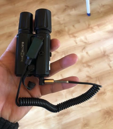

Apparently they make a pressure switch for this one.

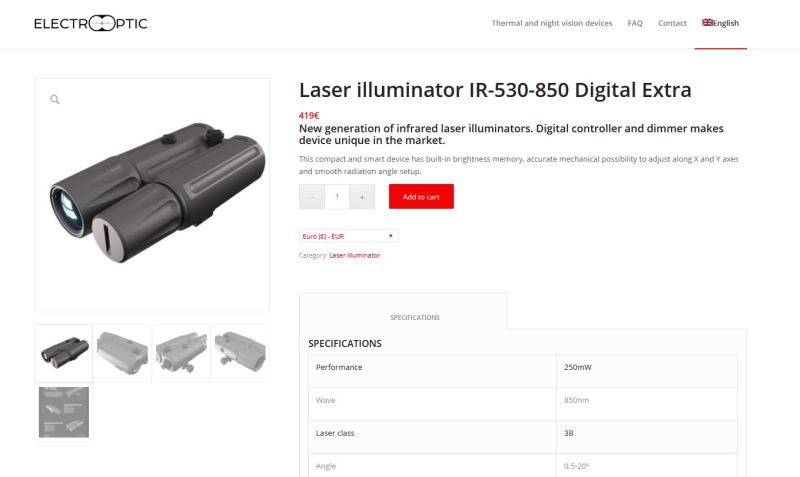

I just learned this unit has a turbo mode that will bump the power to 700mw for 20-30 seconds. It uses an 18650 battery to supply the current.
They really need to update their spec charts...the one I have also has a turbo mode (300mw), but it's not listed in their specifications.

Their website isn't the best...I'd contact Daniel via email regarding the pressure switch.

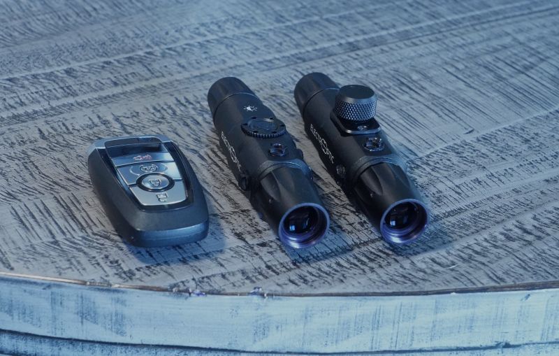

The fast shipping the first time around was apparently no fluke.
I ordered another unit (dimmer version) and it was shipped Monday...I got it yesterday (Wed), customs and all. I'll be posting more about the dimmer unit soon.
By the way, I have no financial relationship with Electrooptic...I paid full price for both my units.

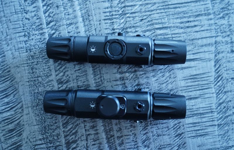

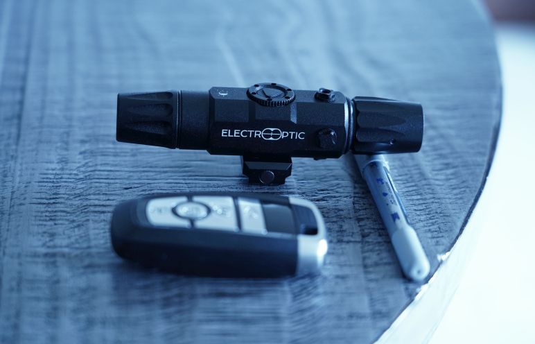

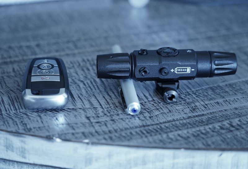

First impressions of the unit with the manual power control dial:
Same size as the digital unit.
The power dial gives smoothly-graduated control from off to max power.
The dial has a very firm feel to prevent a casual bump from changing the power. Perfect IMO...I was worried it would be too easy to turn or feel loose.
No LED power-on indicator. The body shape is slightly different from the digital unit so they may not have had space. Hope to see this feature added.
I'll be posting more info when I'm able to do more detailed testing.

Interesting. Glancing at them, I thought they were the same unit with and without the dimmer knob. Do you think the guts are the same or no? (Admittedly haven't actually looked at specs. Just glanced at photos when I had a sec the other day)
There are differences in the body shape and function, so I'd imagine the electronics are different as well.
