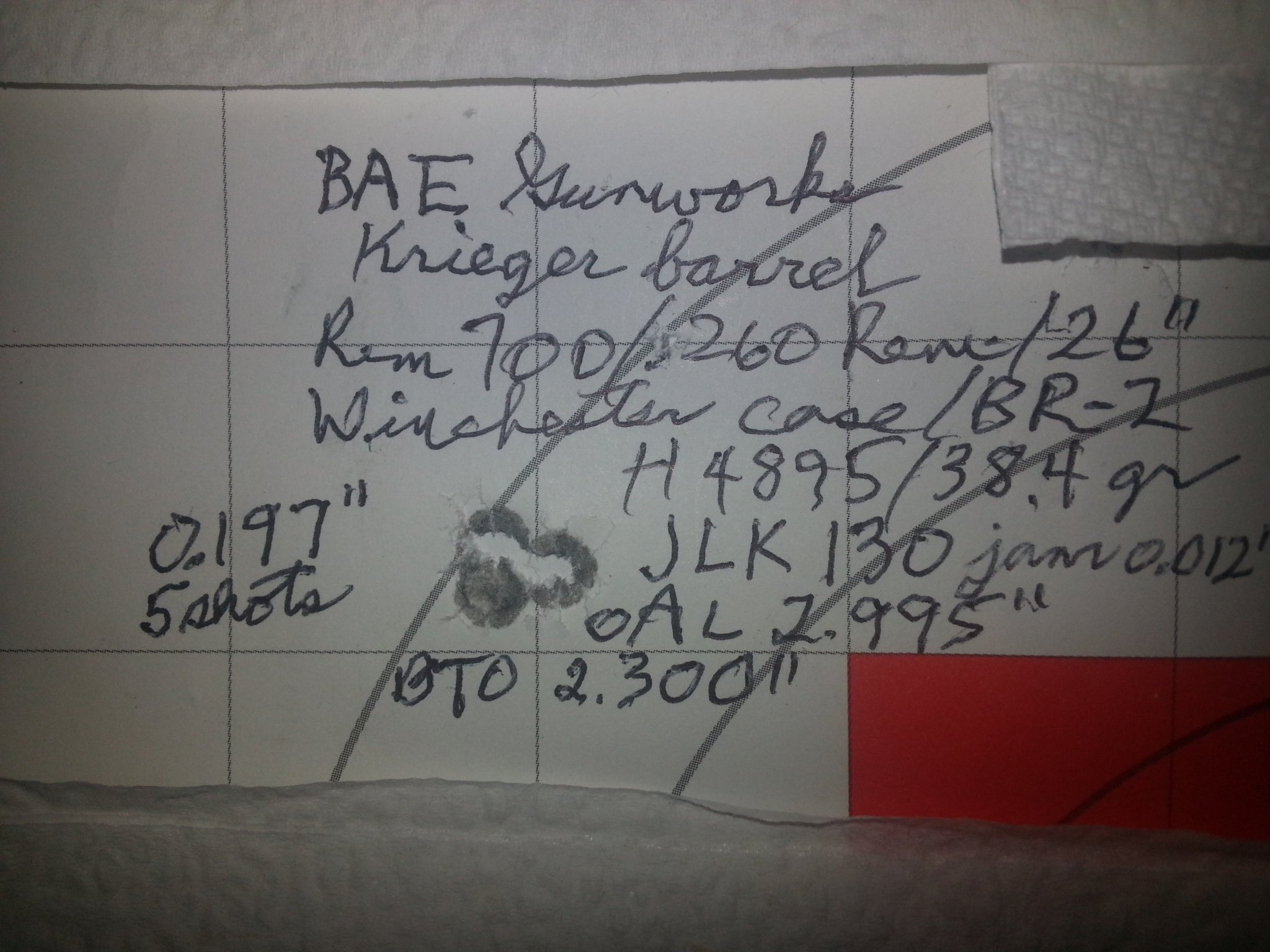

I decided to test the new JLK 130 grain bullets in my .260 Remington, since that chamber permits the bullet to reach the lands. The rifle is a trued Remington 700 built by Barney Eiseman at Shooter's Station in Conroe, TX, with a Krieger 26" 8-twist barrel, and bedded in a MagPul Hunter 700 stock. Jewell target trigger and Bushnell Elite 6500 scope. The barrel has 1,500 rounds fired. Ammo specs: Winchester .243 cases necked up to .264, fired multiple times, sized with a Redding body/shoulder bump die and Lee Collet/Mandrel neck sizer die. I don't anneal. The bullet jams 0.012" at OAL of 2.995" (BTO of 2.300"). CCI BR-2 primers and 38.4 grains of H4895. I fired 5 shots with another bullet and H4895, to warm up the barrel, then fired 5 shots with the new JLK's and this load (the first and only load I tried today). The 5-shot group measures 0.197". Firing rate was just what you would do in F-class, which is no appreciable delay between shots. Other shooters will do better than a 70 yr. old guy who's had 2 eye operations. Please try out these awesome bullets. Their consistency, and now their accuracy, is beyond my wildest expectations, and I will be testing larger group sizes and different calibers when they become available. Thank you, Ed Faber, for putting out the effort to make these marvelous bullets available again!
