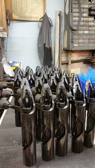

Available for shipment 08/25/2014 is the new Atlas Tactical action.
Features are a 416 RS body with a 4140 Bolt Body with a TIG welded 420 bolt handle.
Available in Short Action for .308 cases and .532 cases.
Accepts both the AICS or AW Magazines.
Features our "Never Fail" TG Ejector, Fluted Bolt, APA Tactical Bolt Knob, and Dual Pin Recoil Lug.
We have upgraded the Bolt Stop Screw to be "hammer proof" to take the beating tactical shooters put on there bolt stops cycling rounds.
We have also pinned the 20 MOA Picatinny Rail, so that it is just like an integral rail.
We top it all off with a Salt Bath Nitride Coating, trade name is Melonite. This allows shooters to use their bolts dry, so that dust and grit does not stick to the bolt.
This action was optimized for the practical/tactical shooters by feedback from shooters in the field.
Action will retail at $1200.

Do you have different angle porn shots of the action? The one you posted does very little to appreciate it.

As soon as they are all finished out, I will take some more photos. We wanted to see how the would sell at first, then introduce the .223 option. We don't sell very many .223 actions, but we will be happy to add the option. I will get one of the new AX stocks and try it out.

Also, the pinned picatinny rail. Is it only pinned with one pin? In the photos it looks like its only the rear part of the action that has the "pin hole"
Northman,
It is pinned in the back with one pin. This will stop the rail from sliding around if the screws ever start to come loose.

Quick question, what is the bolt throw angle? Picture looks like it might be 90 degrees but it would be awesome if it's 60 degrees.
It is a 90 degree bolt throw like a Remington. We are running .005" of bolt clearance in these instead of .002". We flute the bolt to help with debris. This will push the debris into the flutes and away from critical areas.

Man is that PURTY stuff right their and glad to see some more pictures of these posted up. I will be calling you on 1 of these. Glad to see Kelbly moving forward in other directions to support shooters in different areas. I have had varmint rifles built some years ago by them and can attest to the superb quality of their products not to mention they are some of the best fellows you will ever deal with.
The entire action is done in melonite. The only parts that aren't are the scope base and cocking piece, which are anodized.

The rail on the Atlas Tactical has a chamfer. That's why it has the gap.
