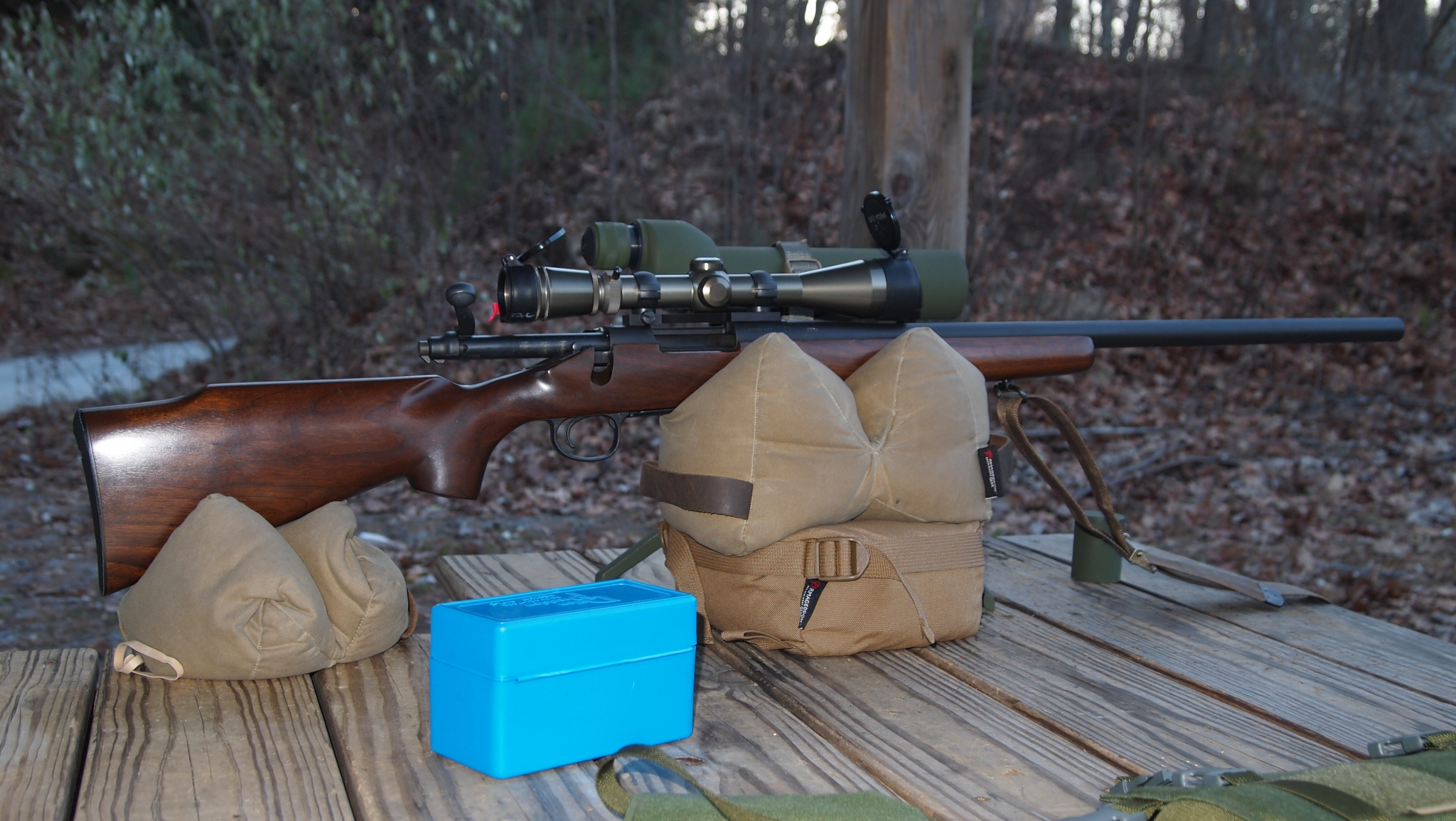

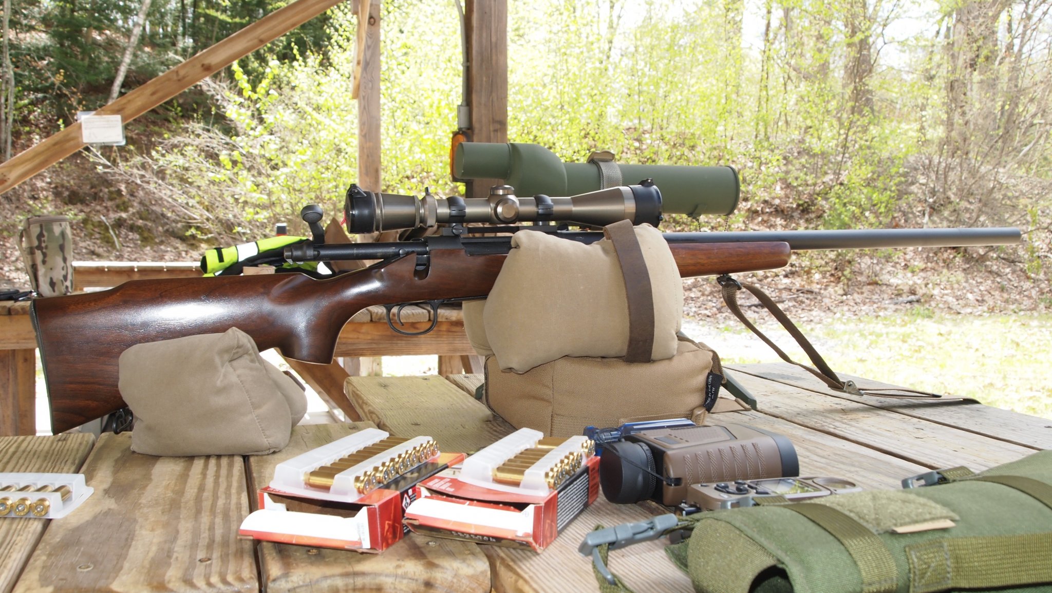

    Took advantage of the Cameraland sale and bought a Kestrel Sportsman that I have upgraded to a 5700 Elite. Found a Bushnell Conx RF in the PX to pair up with it.
    Taking a 1000 yard class at Sig in mid May and hope to play some with my Kestrel and get my feet wet with it on a KD range.
    Ill be using a USMC M40 clone (24 inch 10 twist varmint barrel M700) Remington .308 with a Leupold 3-9X, capped turret, mil reticle scope. Ive shot the same class a few other times with more capable gear and the fun of this event will be using reticle holds only to run the class. Ill be dialing down magnification to double my reticle value. Might come up a little short with 10 mils in the reticle at +/- 4.5X. May have to change my 100 yard zero from the cross hair to holding under 2 or 3 mils.
    My ammo will be Federal GMM 175 SMk.
    Ive entered my rifle info into the Kestrel, previous chrono values for my ammo, height of optic above bore, twist etc.
    Ive shot the course a few times already so Im pretty confident in what Ill be doing out there regards previous info with similar rifles/ammo. It should be a good exercise to learn the Kestrel/ConX RF tools.

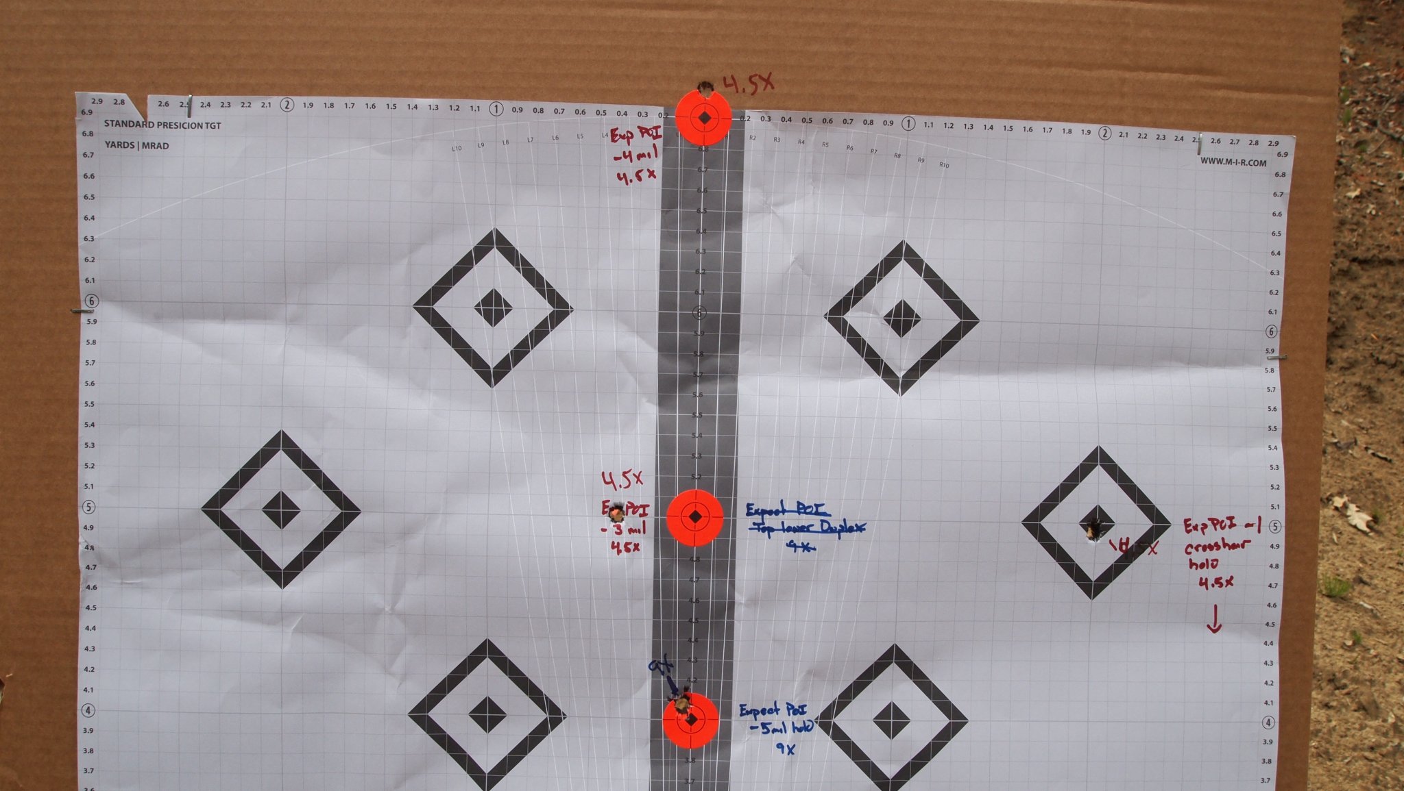

    In order to make my class more interesting I'll be shooting a Vietnam era clone M40 mounting a Leupold 3-9X with capped turrets. Adjustments are in MOA and the mil reticle is in well.......mils.
    I plan on checking zero on Wednesday.
    My current 100 yard zero is on the cross hair.
    If I dial down to 4.5X+\- to double the hold in the crosshairs that won't give me enough holdover for 1000 yards, shooting 175 FGMM at 2650 MV.
    This what I came up with using JBM. If I zero at 2 mils holding under I should get to 1000 without having the torso targets get lost in the duplex stadia.
    Holds should look something like this.....
    Kestrel should come in handy to confirm or adjust holds.
    Ranges we will shoot are typically 100, 300, 750 and 1000 during the Reach for 1000 class. With about 2/3 of the day shooting under 800 most of my shooting can be at 9X.

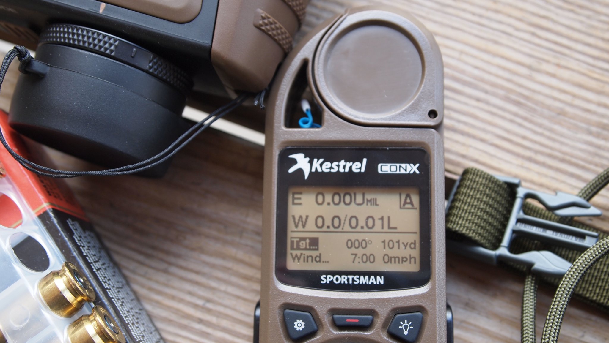

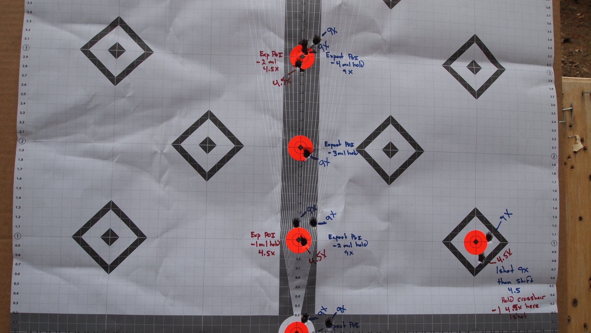

    Went out to 100 and played with my rifle and the 9X to 4.5X shift........
    Kestrel and ConX gave me what I expected for shooting at a short 100 yards.....

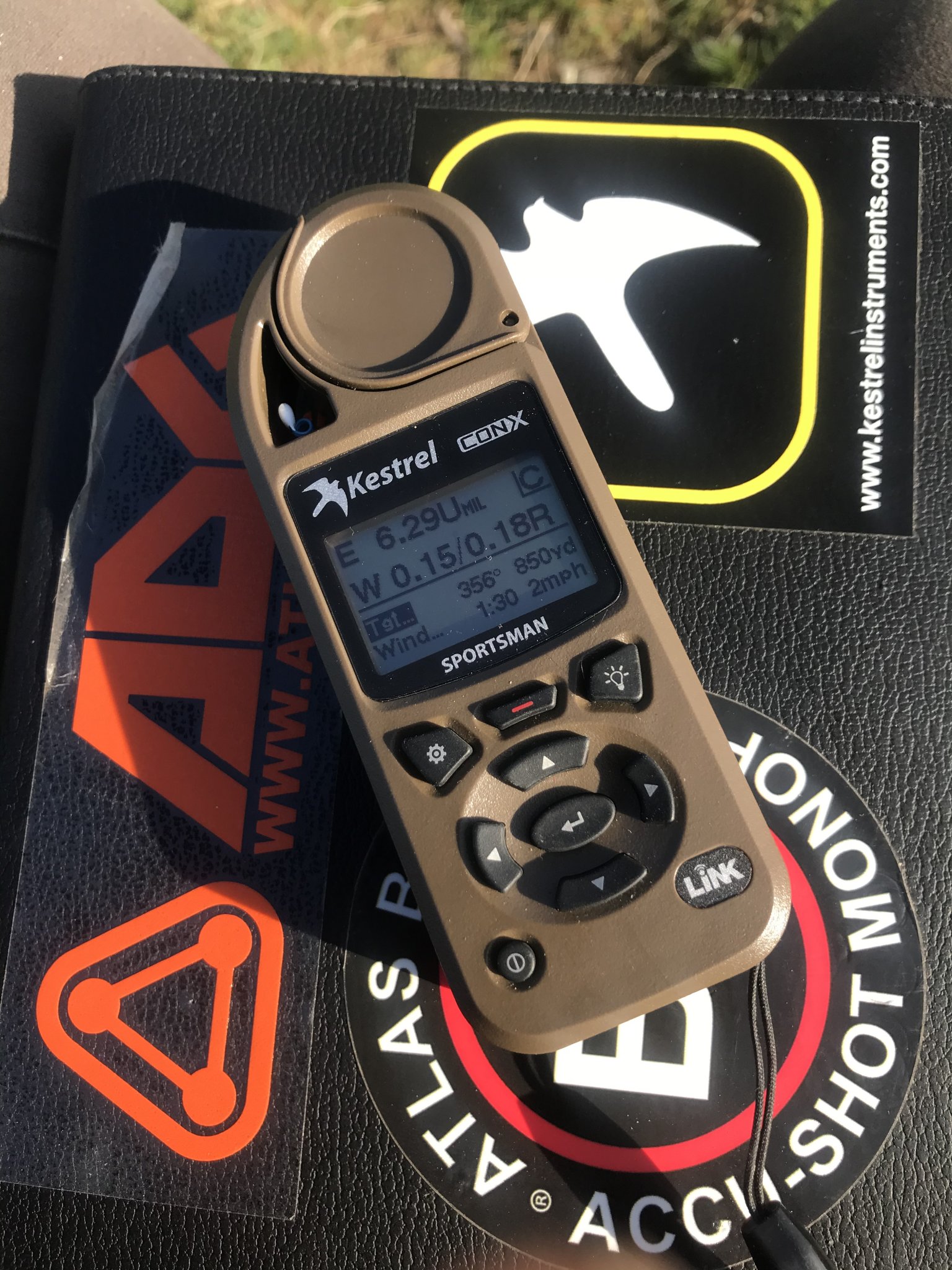

    After matching the inputs and adjusting the settings as @pmclaine suggested above in post #18, this new kestrel exactly matches my solutions from the Shooter app on phone out to 1250. Those had been trued so looks good to go.
