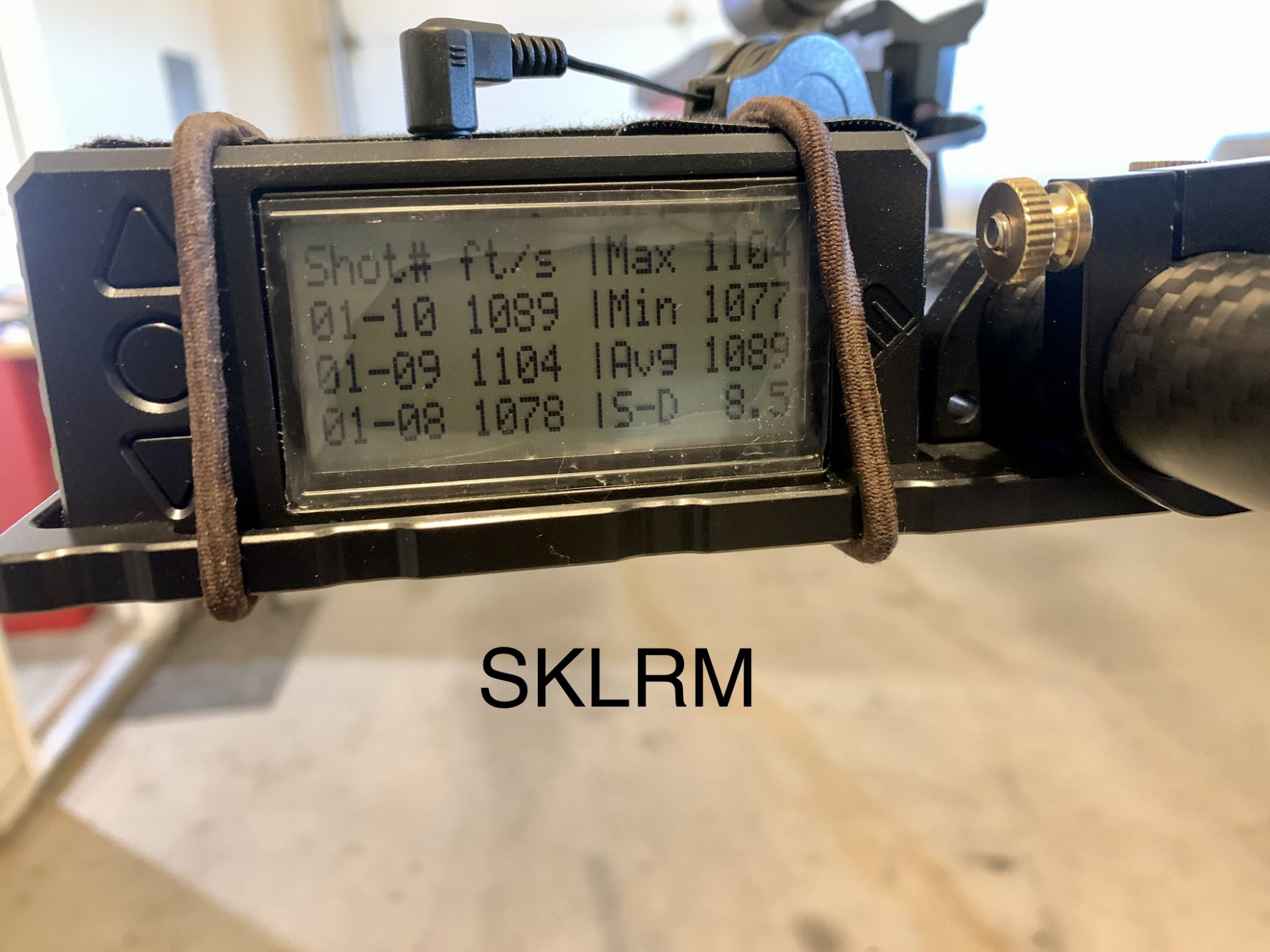

    SKLRM averaged 1104fps out of a 22” barrel during the summer. Approximately 1080fps out of a 26” barrel.
    A new lot of it was 1064fps the other day at 42* out of my 26” barrel.
    What twists? My numbers are from LW 24” 1-12 with a match chamber.

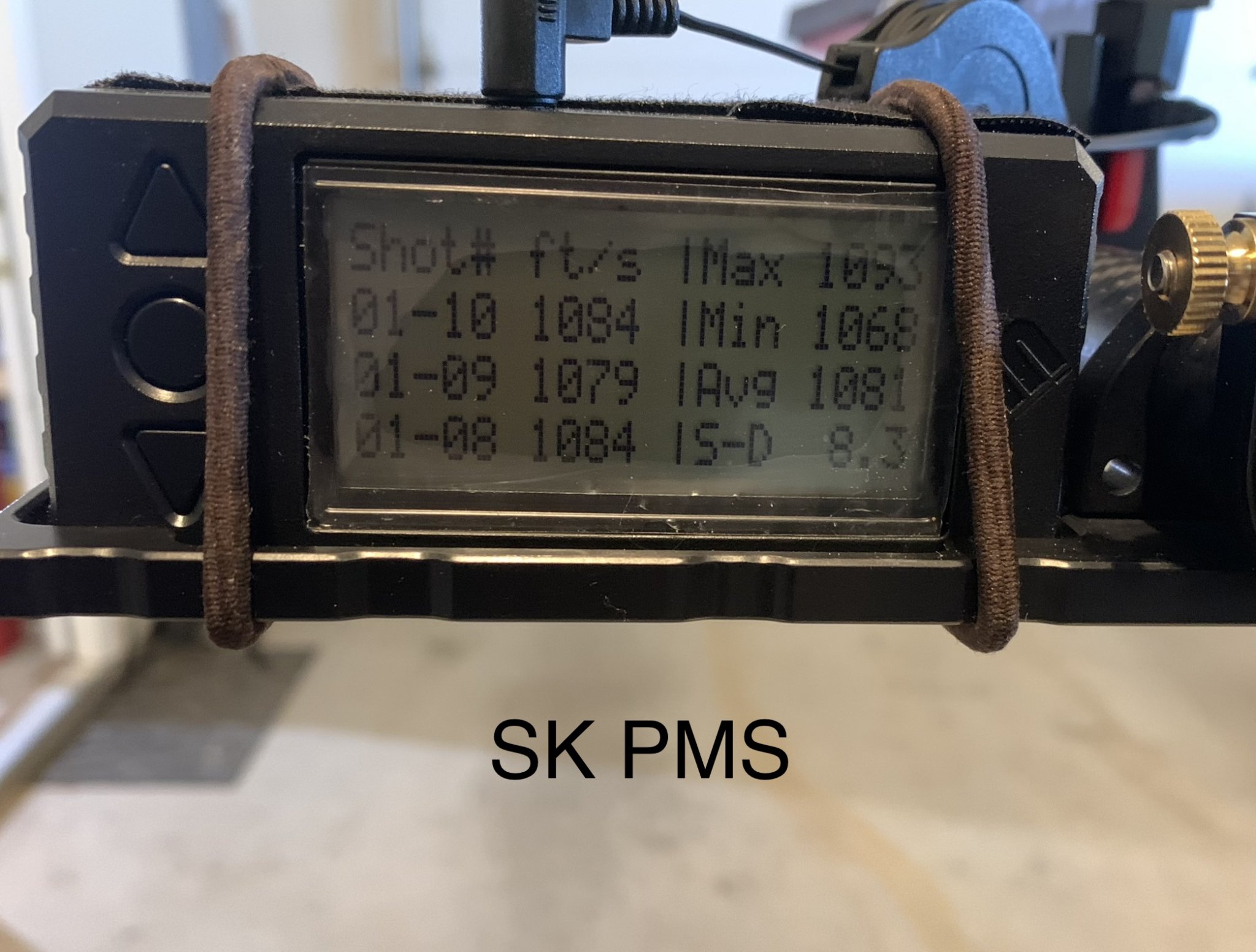

    This was taken out of my house straight to the garage and shot. It’s 69 degrees in my house so should give you a close idea. 24” Shilen Ratchet
    View attachment 8046543View attachment 8046544

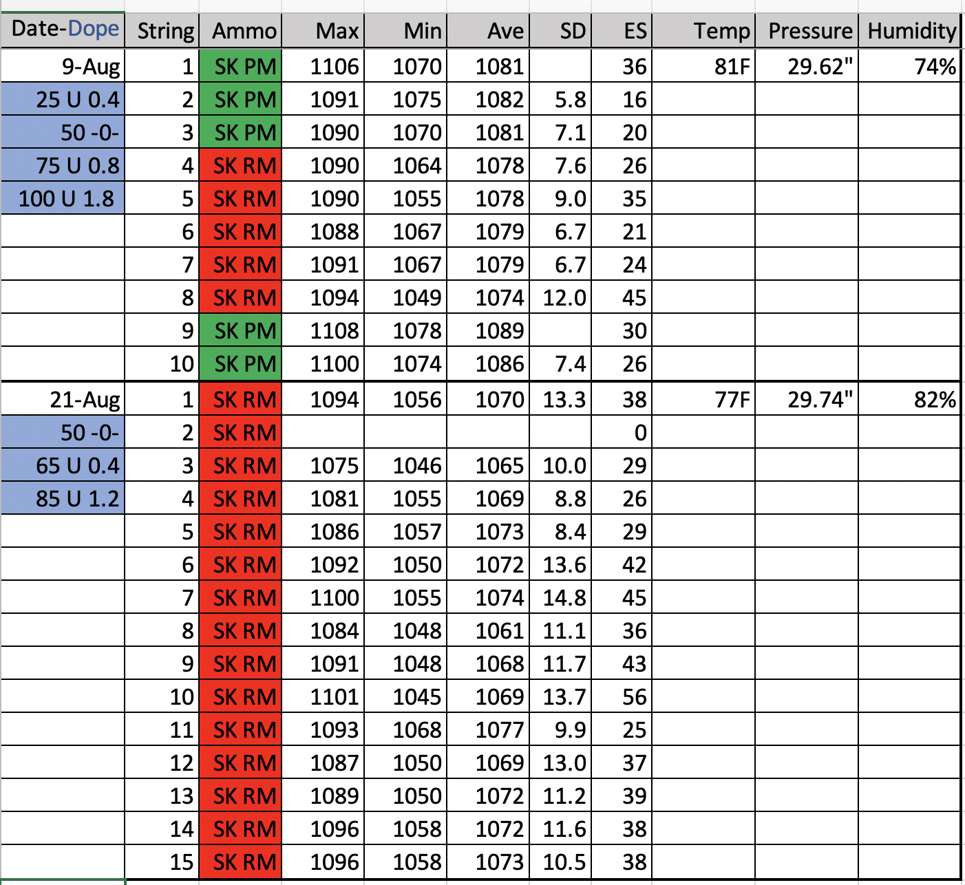

    Thanks, I'm going to pick up some SKLRM and test it out of my 20" Ace 1:16 at the indoor range in the next few days. It will be done at the indoor range, so temperature should be somewhere in 60's I think...I'll check it with the Kestrel and get data for temp, humidity, pressure, etc...and see what the numbers look like over the MagnetoSpeed V3. Maybe I'll get my tired ass moving in the morning and get it done.
    I'll put some SKRM and SKPM across the chrono too, so we'll have three sets of numbers to look at....say 50 rounds of each in one string for each? Or should I do 10 round strings, and swap ammo between? It's all SK stuff, so switching ammo shouldn't matter.
