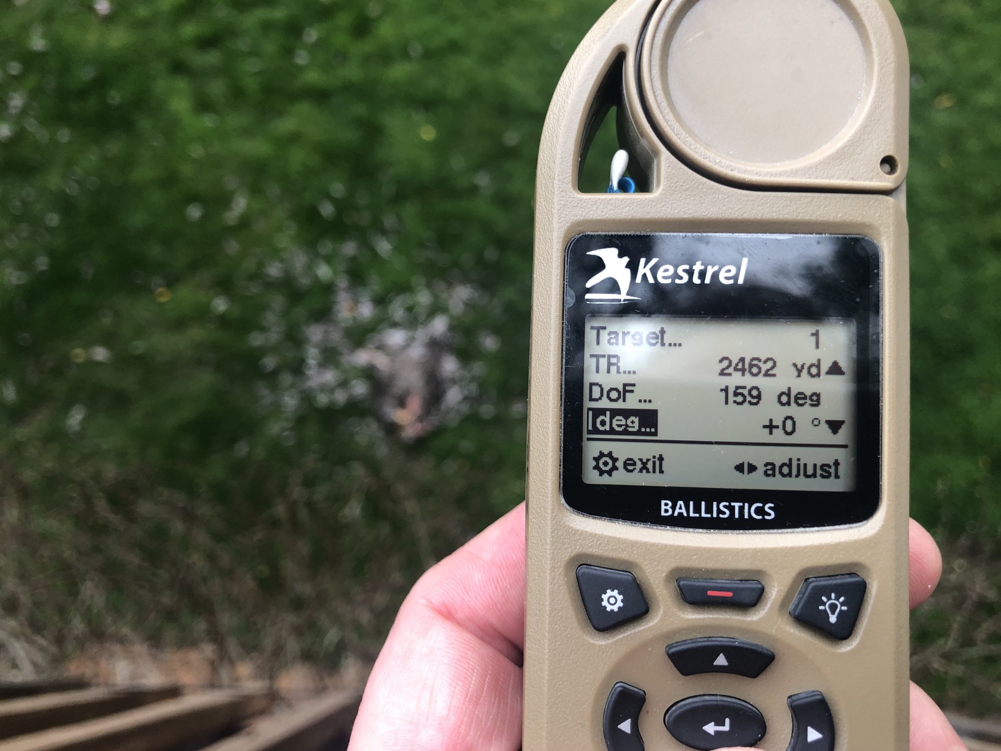

In the 2800, it first displays, then moves to the next: RANGE, the WIND 1 followed by WIND 2. (The video is harder to see than the real thing)
2462y
26.4U
.6L
1.0R
For my gun with wind 1 @ 3 and wind 2 @ 6 for an example
I wish however it would leave the drop displayed after it cycled through the wind. If you miss it you have to hit the range button again. The display does stay on the 5700 however.
Hand held cell phone video. The solution is fast, slowed only if the range and drops are huge. will post images of the 5700 screen shortly
I walked out in the back yard to do this and a Hawk just flew off one of my Chickens!!.. Feathers to the left

The connection between the 2800 and the 5700 is super fast, but.....
If you have the 5700 in any mode other than the main ballistic screen - or, (and this one gets me) have the target or wind left highlighted, the hand off from the Leica does NOT take place.
This is 100% user error, but I get caught in that trap after capturing wind.

Go to "Target Card"
"Enter"
"Enter"
"Target Inputs"
"Enter"
"scroll to target number"
Range with 2800
"scroll to new target number"
Range with 2800
etc..
edited to add: If you are testing at home make sure to range something far enough that your 2800 and 5700 will provide a solution.. The range finder might show 15yards but it will not update the target cards unless you give it something it can solve.
PLUS THE SOLUTION STAYS ON THE SCREEN LONGER - MY WISH LIST COMPLETE.... Tiny, light, fast, small beam, target cards each with it's own DOF etc --
