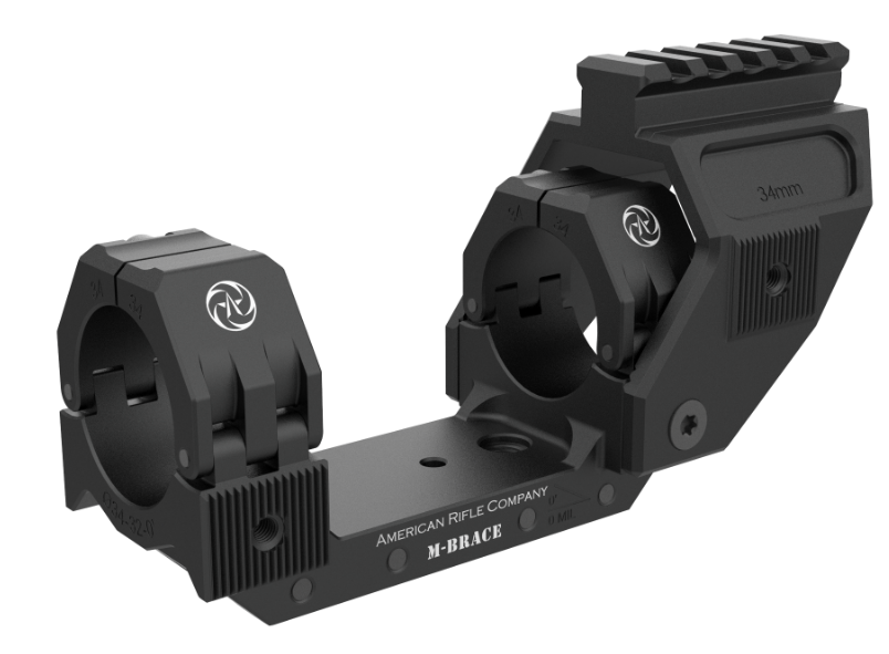

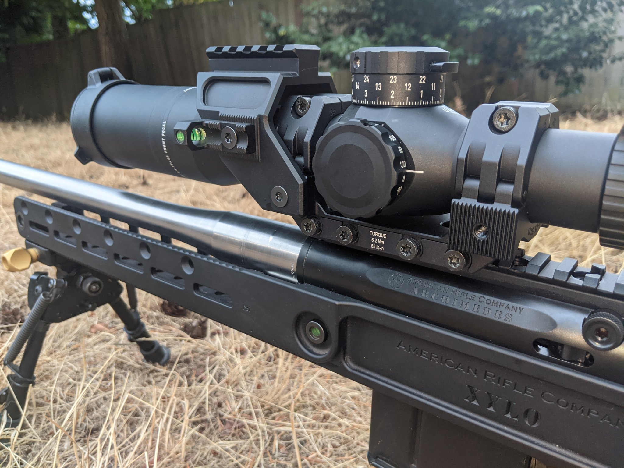

Hi folks. Ted here form American Rifle Company introducing our M-BRACE Scope Mount. Now available for purchase at https://www.americanrifle.com/shop/product/m-brace-mount-1402 for $279.
This mount has no equal, at any price. But for $279, I think we're really getting good at giving you what you want at an incredible price. And yes, it's all 7075 aluminum.
The mount is derived from our M10 rings which provides for super simple installation that doesn't roll your scope when tightening the scope clamp. But the big innovation is the serrated accessory interface. We offer an LRF mount that connects to both sides of the mount base by way of serrations, effectively unitizing the LRF and the mount to absolutely guarantee a constant positional relationship between your scope and laser range finder or other aiming device. This is an engineered product for which loads are the primary consideration.
A level vial is also included and can be positioned in various locations. Pick the one that works best for you. Auxiliary Pic rail is also available that can be secured to either the M-BRACE mount or the LRF mount, all by way of the serrated interface.
And as always, our goods are designed by American Rifle Company and made by American Rifle Company right here in the USA, actually just north of the communist homeless encampment otherwise know as Seattle.
Enjoy...
Ted
And up to 60 MOA available on the 34mm mount, neat!

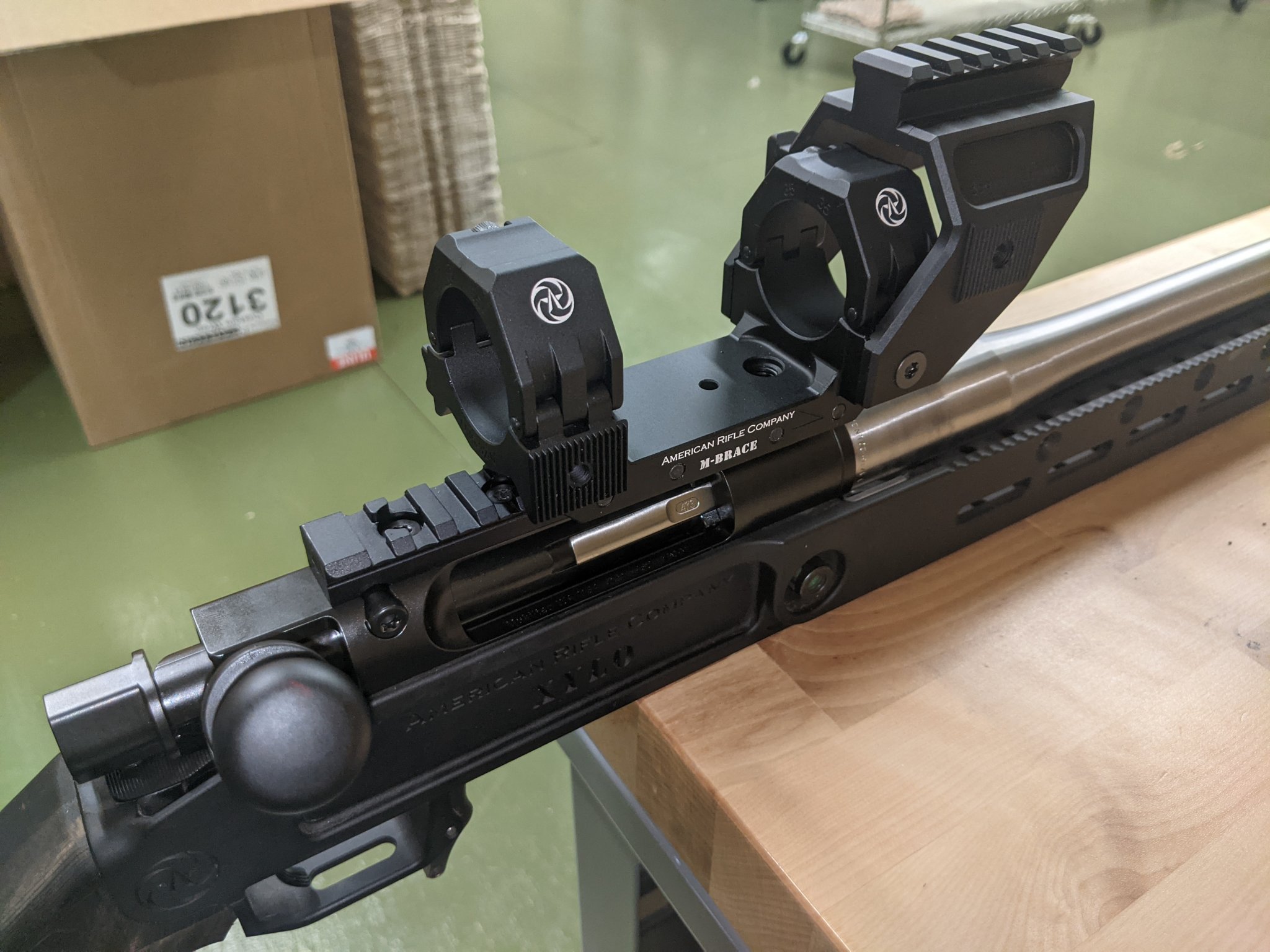

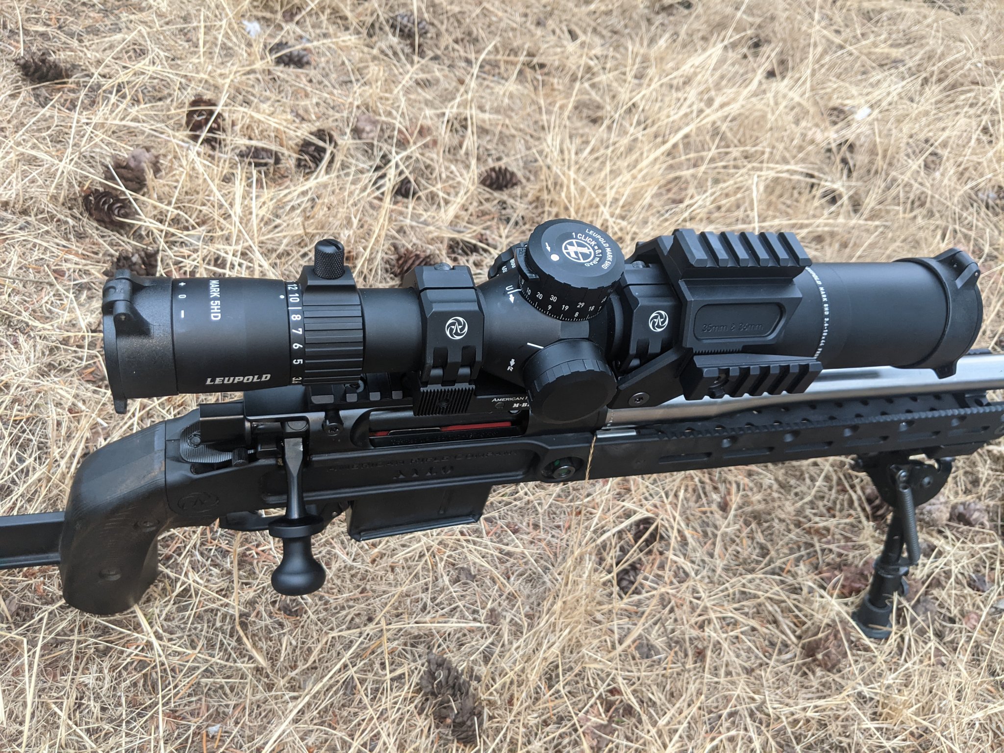

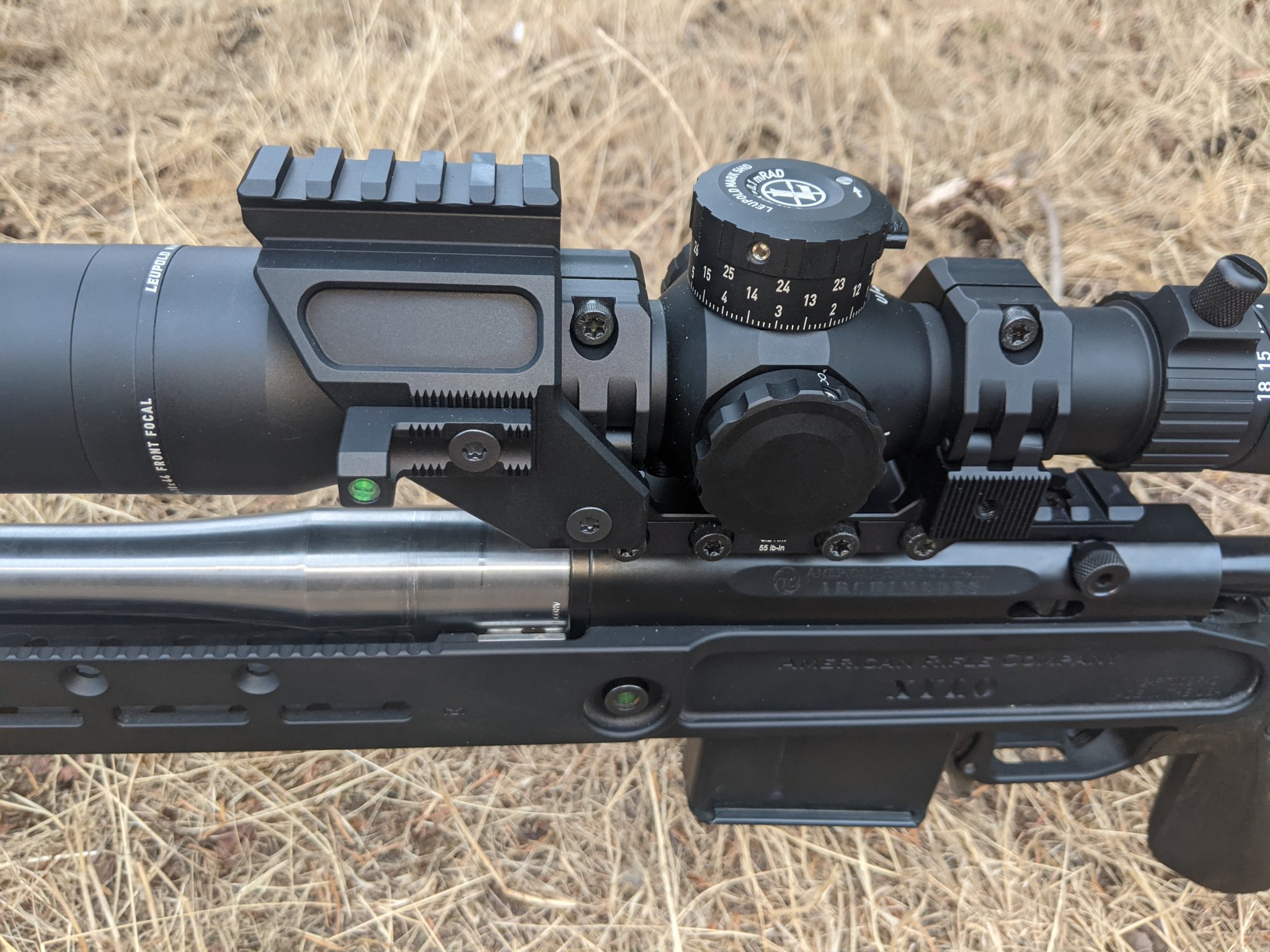

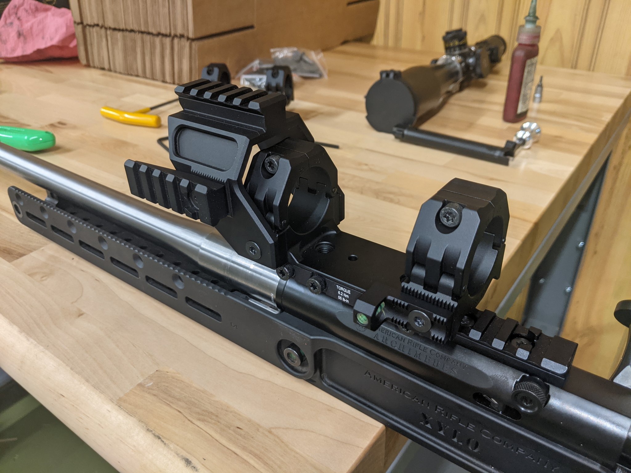

Here are some pics of my setup. I should have made this a long time ago. Thanks to Caylen Wojcik of Modern Day Rifleman for the impetus. Back in January, or maybe it was December, I asked Caylen why he wasn't using our QD-L scope mount. He replied it was because we didn't provide an LRF solution. So that got me thinking about the problem. It's hard to resist a good problem. I'm glad this is now done.
Ted

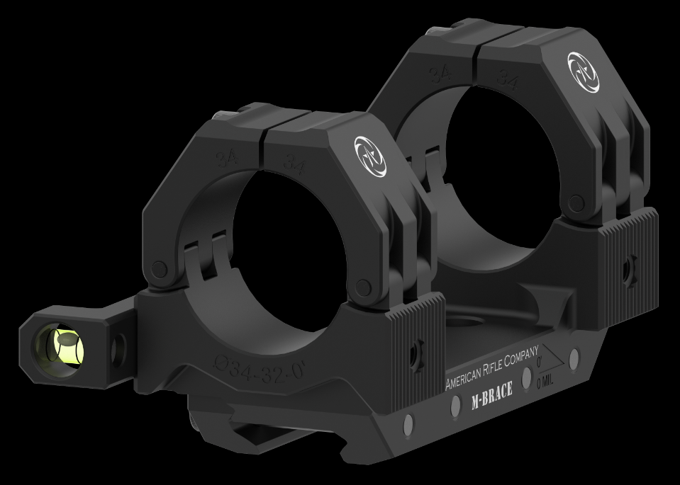

Nice job Ted...does the level allow for mounting on the other side for us southpaws

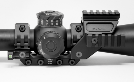

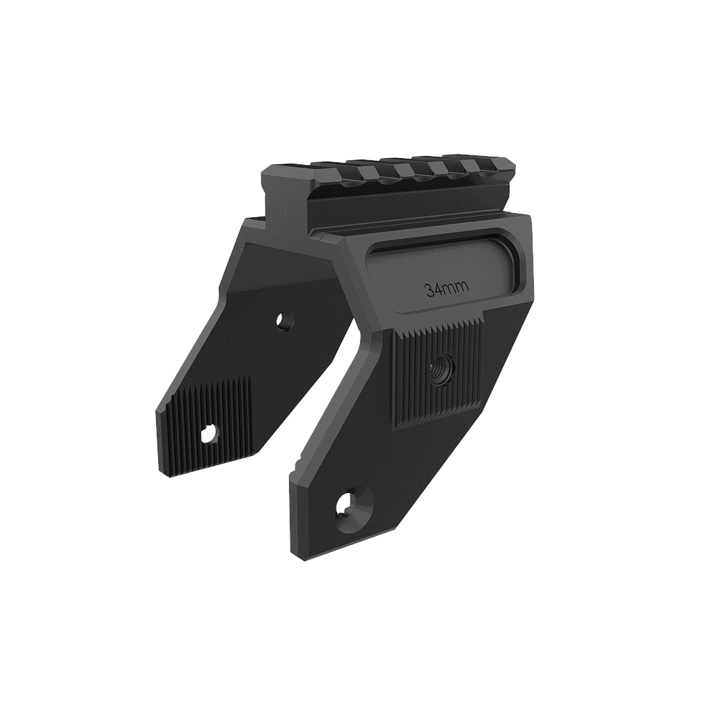

What would the height from the rifles pic rail to the LRF pic rail be if the ring height selected is 1.5"?
Welp found something else to add to the “must buy” list, now I will finally be able to mount my Radius on top of my Revic since I only use M10 rings on my rifles.
Ted
The top of the LRF rail is position 48mm (1.89 in) above the centerline of the scope regardless of mount diameter, height, or inclination. Therefore, LRF rail to pic rail is simply 48mm + mount height. In your case, 48 + 38 = 86mm (3.39 in).
It's also worth noting that the LRF mount follows the inclination of the mount. In other words, the serrations run perpendicular to the scope tube. So if an LRF mount is used with a 30 MOA M-BRACE mount, the the Pic rail of the LRF mount will also be inclined at 30 MOA with respect to the rifle's Pic rail.
Ted

I like the design! Can we see some pics of the bottom of the mount? Any chance you've added a squared recoil lug to interface with the pic slots?
Thanks

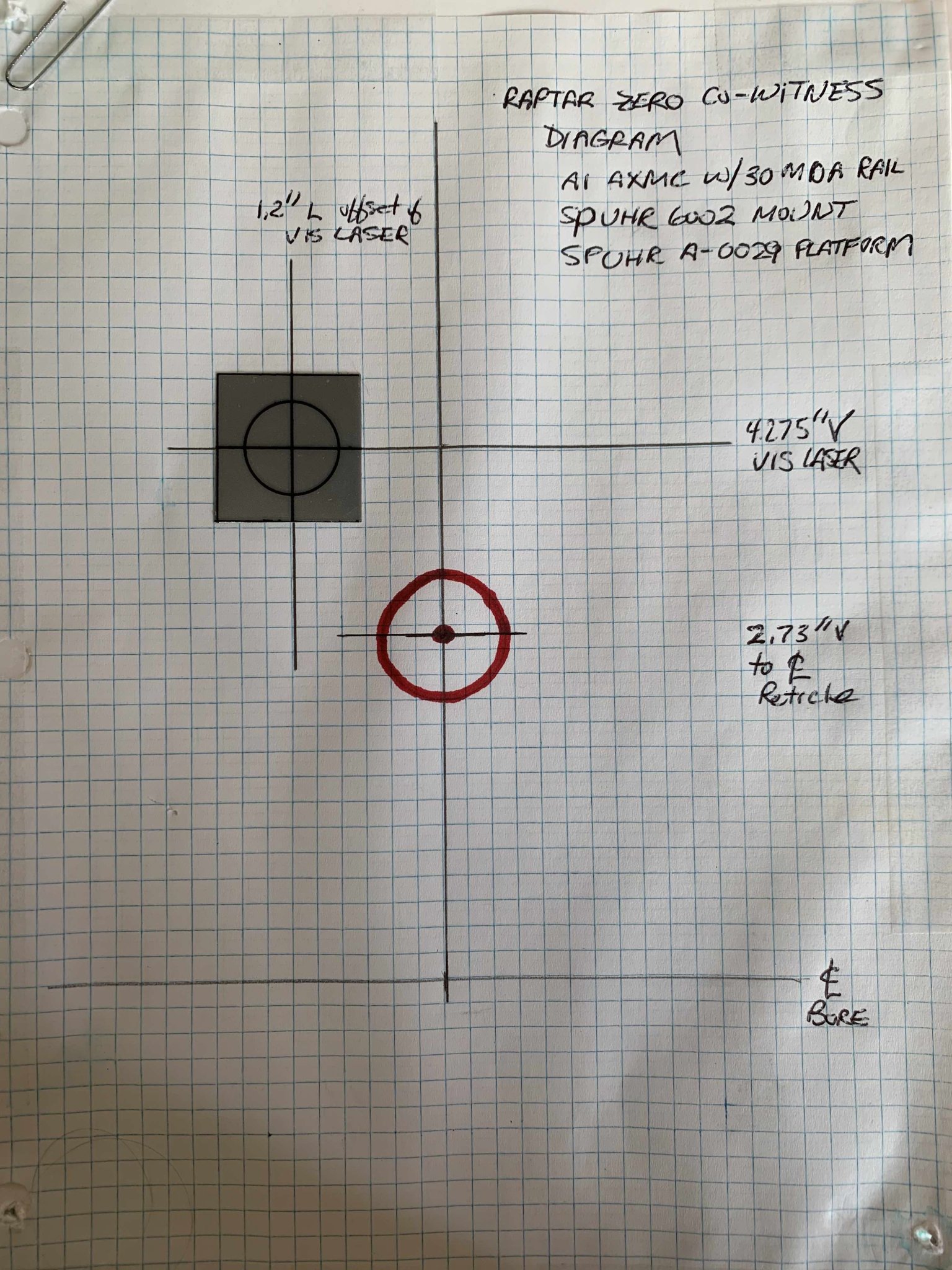

Thanks Ted. I was a little confused when looking at the drawings on the LRF page. I guess it is coincidental that the height from the screw attachment point on the LRF to the inside surface is also 48 mm....LOL. I didn't see the lower drawings of the assembled LRF and mount when I looked yesterday, hence the question. My LRF has co-sited aiming lasers that are not on the centerline of the LRF or the dayscope. Therefore, I construct a target to co-witness the lasers to the centerline of the dayscope. The reflective part of the target has to be offset in both vertical and horizontal directions from reticle center. See below
Thanks for your help. I will definitely be ordering one of these. Use your rings on my other sticks and can't say enough good about them

It's already there because we knew someone would ask. However, it is not necessary. The four rail clamp screws each engage a slot making a squared lug superfluous. Superfluous is something I normally avoid because it is not in accordance with my form follows function style. But in this case, I acquiesced because it didn't require a performance or manufacturing compromise.
I'm glad you brought this up. It gives me an opportunity to remind folks that ARC can advertise substantive features. For instance, in the case of the M-BRACE, ARC can be proud of the following:
  1. M10 ring design that doesn't role the the scope during installation
  2. M10 ring design that doesn't spall the finish of the scope tube
  3. Rail clamp screws placed as low as possible in the rails slots thereby arresting recoil
  4. Rail clamp screws placed approximately between the rail clamp contact areas maximizing its ability to immobilize the mount with respect to the rail
  5. Crowned rail clamp interface that properly engage the rail and the mount an that tolerates variation in rail section
A squared lug doesn't make this list because, as I previously stated, it's superfluous. It's also worth mentioning that "the internet" thinks that a flat surface of the lug in contact with a flat surface of the rail is somehow superior to any alternative. But what "the internet' doesn't do is think about the details of such contact, which, when loaded is essential edge on flat. When thinking about contact between parts, an engineer, in contrast to "the internet," might remind himself of a logarithmic profile bearing. I'm not saying that that's applicable in the case, but it does illustrate that contact is often considered in great detail.
"The internet" also thinks that scopes need to be mounted as low as possible. That too is completely bull shit at least because the bullet's trajectory is 3-dimensional. The shooter's comfort is what should prioritize the height of the scope.
Nevertheless, the lug made it onto the mount, and it did so for those who will not read my paragraphs above.
Thanks for asking and for providing me with an opportunity of illuminate a couple of points, however small they may be.
Justin has since added some more info on the LRF page.

I'm not sure I understand your question. Are you suggesting that we design separate rings each having serrated interfaces? Designing such rings would be a bad idea. The serrations can resist large moments. In this case, think of moments as forces resulting from recoil (acceleration of the LRF mass) that tend to tear the mount from the rail. These moments really should be transferred into the rifle's receiver over some length, hence the integration of the serrations into a mount that is much longer than a stand alone ring.
Mounting an LRF to a single ring is a really bad idea because it would transfer the moments primarily into the scope tube as it offers the stiffest load path back to the rifle. It's almost as bad as mounting an LRF to a diving-board pic rail cantilevered from a scope ring cap, an idea categorized as cranial-ooze.

Interesting idea. Minimum ring height would be 32mm if identical serrations are used. You make a good point. Light weight attachments would be OK. Maybe that would be something for the distant future.

How much cantilever would you want? The M-BRACE cantilevers by up to 1.27 inches (lower pic) if you don't use the forward screw. Doing so would be fine without the mass of an LRF. But if you need a cantilevered mount and an LRF, you need to find a place on the rifle to connect the LRF. I wouldn't recommend connecting an LRF to any cantilevered mount unless it's a super lightweight LRF. Does that even exist?
