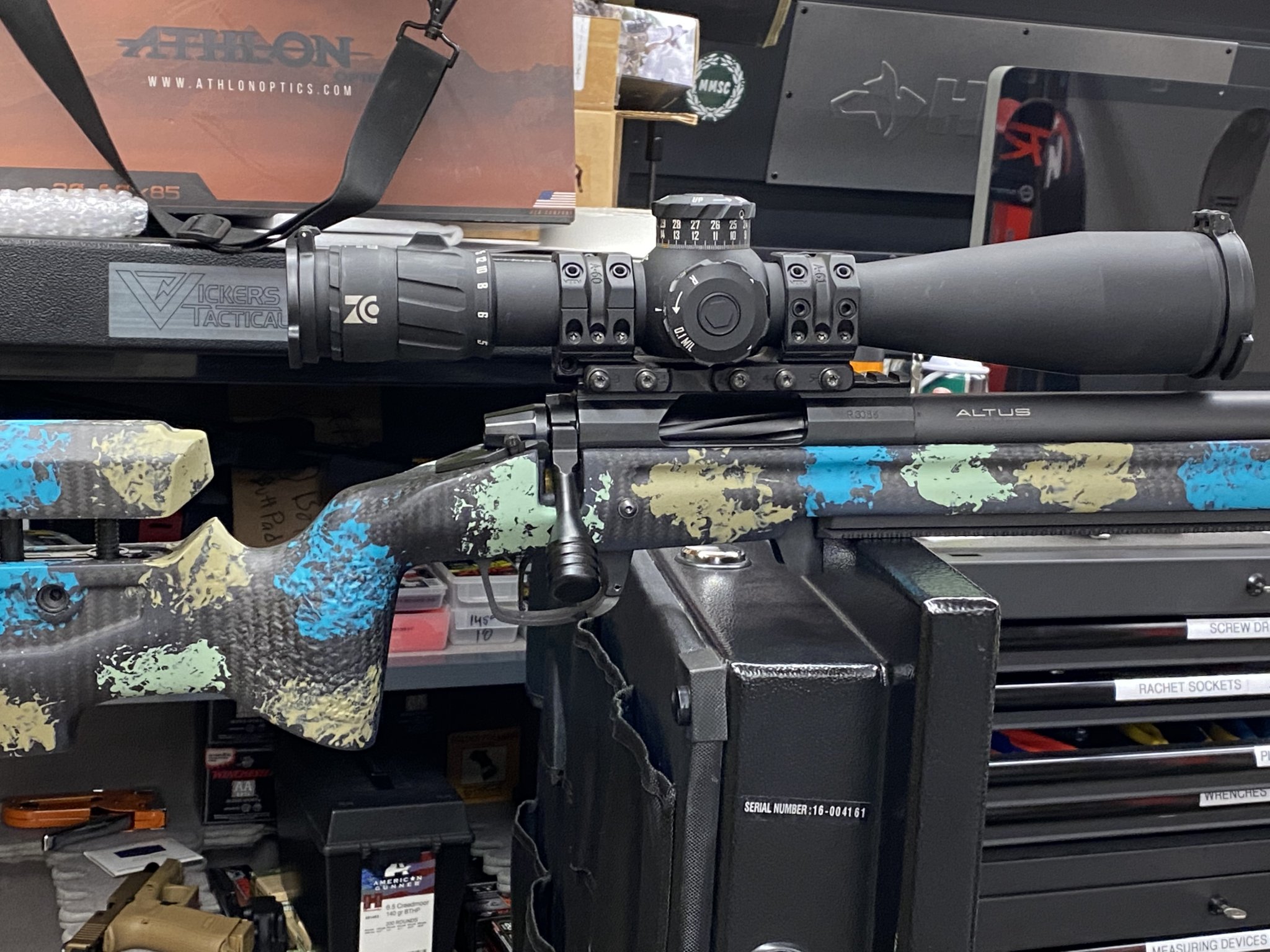

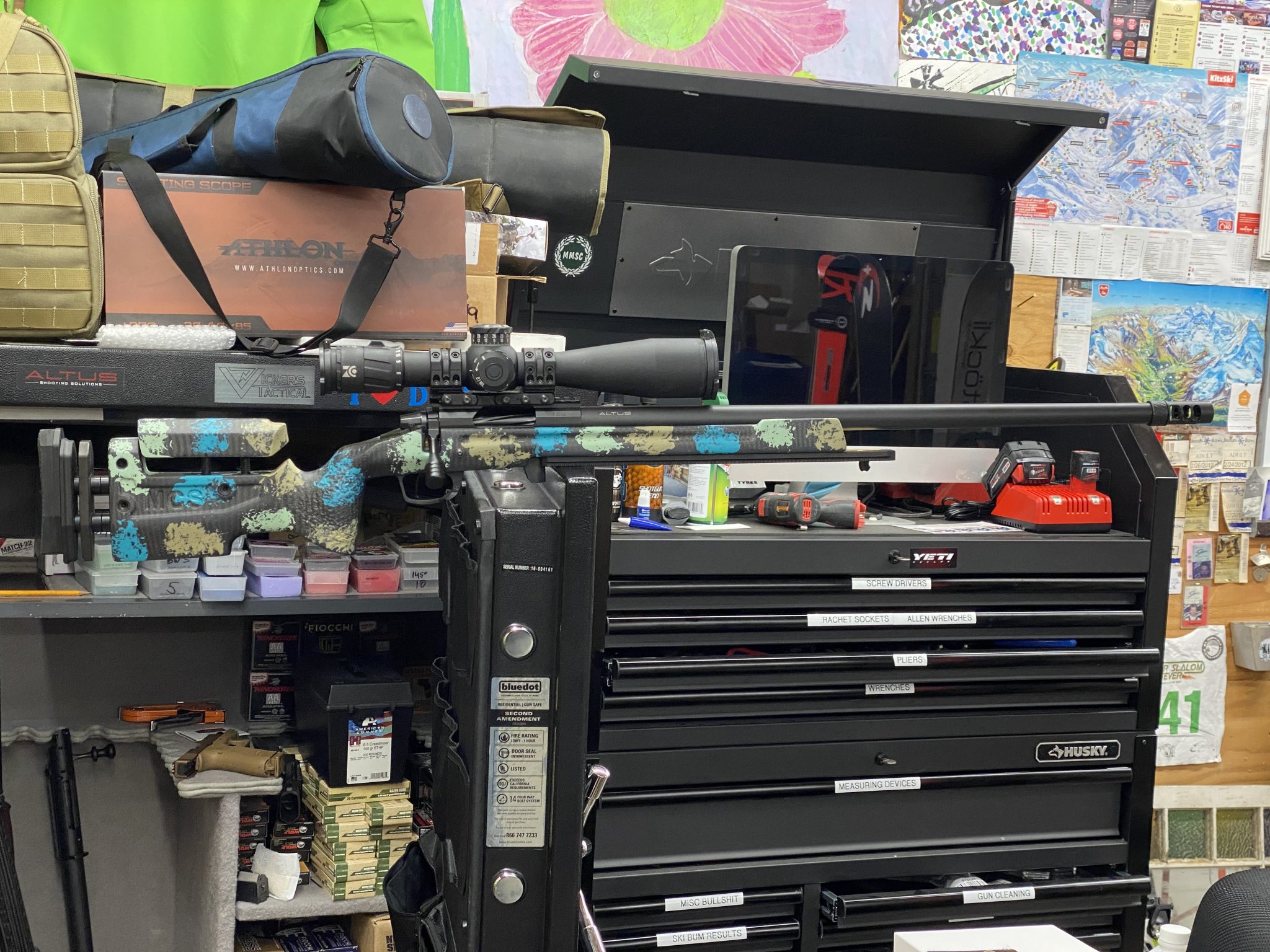

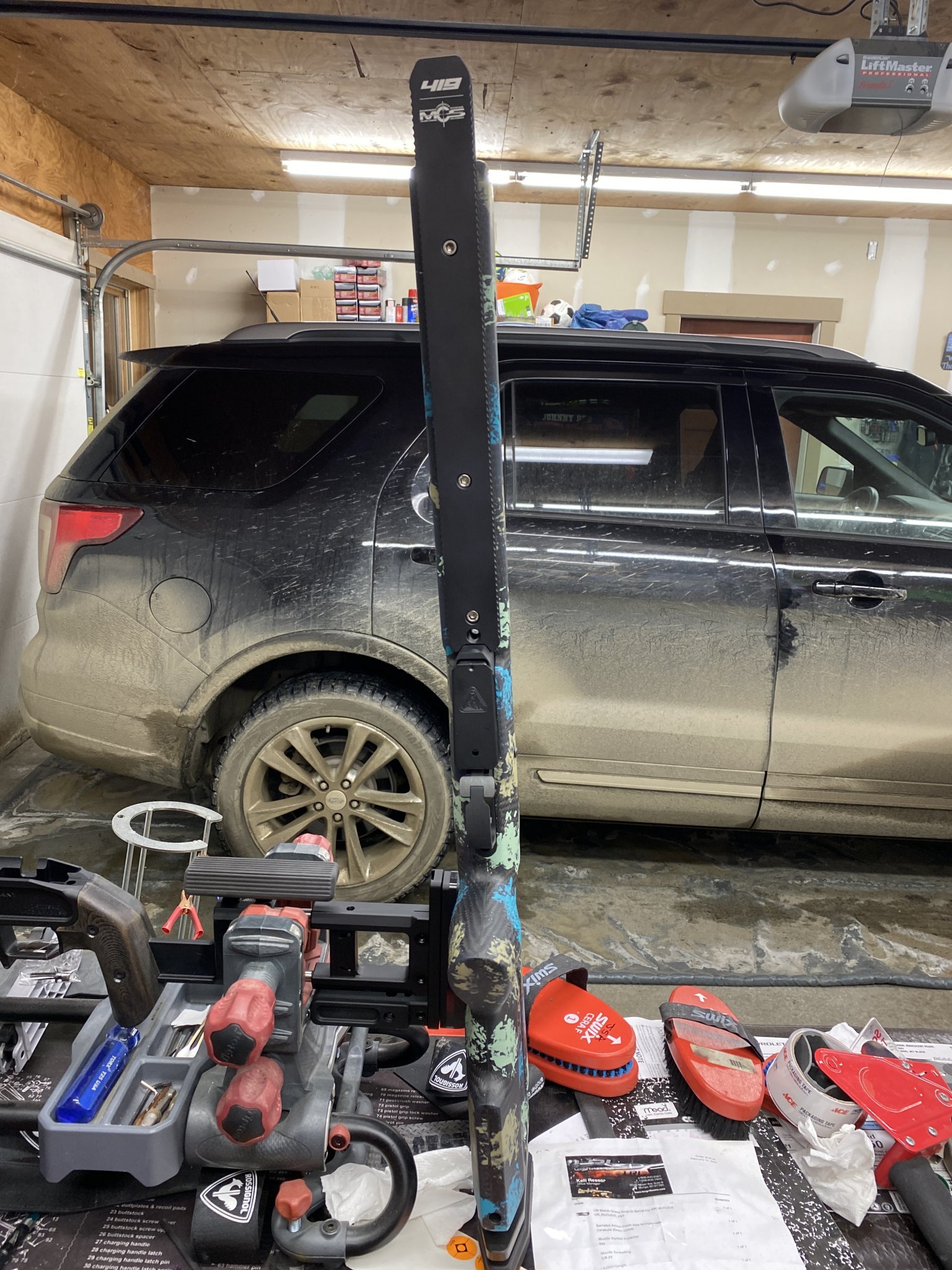

    Here you go!!
    I wanted Bad Lands, but Salt Water was my second choice. Happy with it. Haven’t seen one Bad Lands through Altus yet. The barreled action work looks flawless. Pretty excited to shoot it.
    What chambering did you go with? Also, salt water is a bad ass pattern!
    I went with 6.5 Creedmoor since I am stacked deep in it. I don’t reload, but if I did, I would have gone 6 CM.
