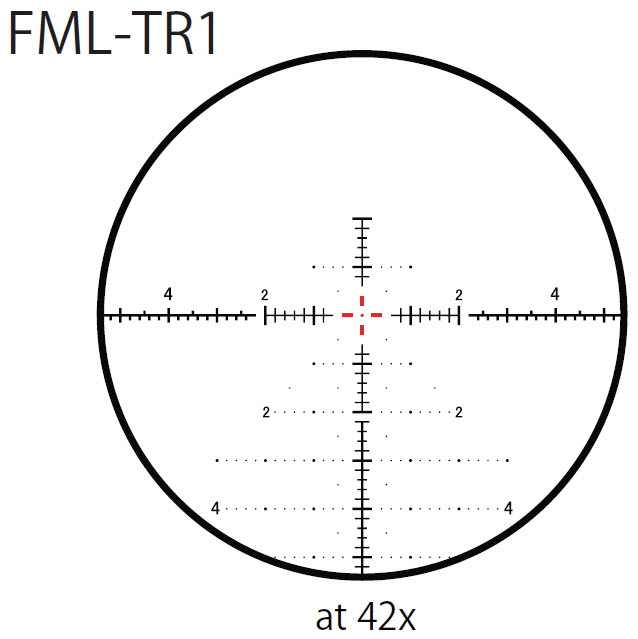

    One disappointing feature of the 5-42x56 HM that was displayed in 2019 was the reticle, it was not well received here on the Hide and specifically with competition oriented shooters; however, that all changed late last year and March now has a very viable .2 mil tree reticle which they've needed for a long time in their FFP scopes. The first reticle in this series is called the "FML-TR1" and it hits most of the marks that I look for in a modern Christmas tree reticle with .2 mil hash marks, center dot and dots in the Christmas tree which does not obscure the image behind it.

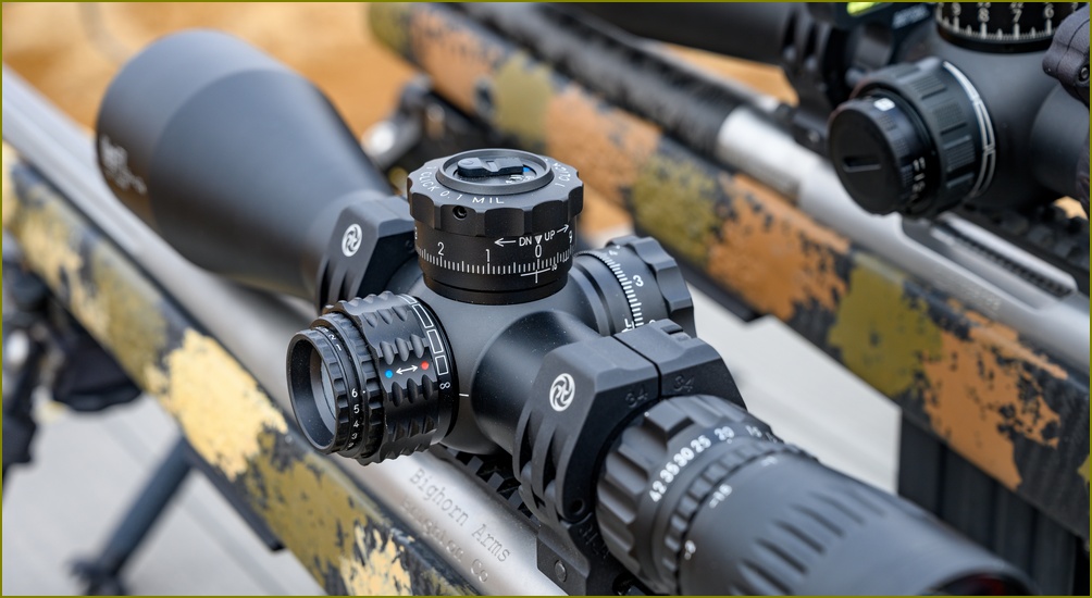

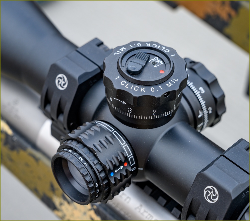

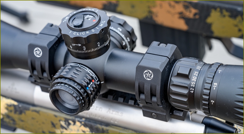

    What I was not prepared for was the new turrets that March is introducing with this scope. For any of you who've read my reviews over the years you'll know that I am not a turret purist, an optical purest yes, but as long as the turrets landed on the right tick mark and provided adequate feedback I was usually pretty happy. My past March scopes had what I would call "mushy" turrets, but they landed accurately and gave enough audible and tactile feedback to get the job done. I expected much the same with this new scope but was taken aback at just how good these new turrets are - they are anything but mushy and provide what may be the most tactile feedback I've ever felt in a turret. Previously Kahles had some of my favorite turrets with regard to tactile feedback, the ZCO turrets maybe had an edge over Kahles (I've only spun TT turrets once so would need more time with them) but the new March turrets best my experience with Kahles and ZCO. Contributing to the feel is the spacing, while manufacturers seem to be pushing the limit with 15 and even 18 mil per turn turrets, March kept their's at 10 mil per rev, a wise choice I believe as each click is very distinct and with adequate spacing between clicks that you don't get lost thinking "did I just move one or two clicks?". Not only are they very tactile, they also have a unique locking system which can be seen in the images below. I've previously used the Vortex AMG, the Schmidt & Bender locking turrets and the ZCO locking turrets (oh, and the Tract as well) and this, I think, will prove to be my favorite design. All the aforementioned designs have a "lift to release, push down to lock" turret housing that rises and falls, but March decided to place a lever at the top of the turret (also on the windage as well) with a blue dot for unlock and a red dot for lock, this lever can easily be manipulated in the dark but what I like most about it is that you can choose to turn it off and the turrets spin freely without having to worry if you need to lift up or push back down, and when you don't want them to move you flip the lever and they lock solid - no play whatsoever, and speaking of play, I cannot find any appreciable amount of play when turning. Solid, distinct, audible and with adequate spacing - these turrets I am sure will become a hit among the community. My only area of criticism is the zero stop, this is set by a hex key at the very top of the elevation turret in between the lock/unlock dots and you simply turn CW to lock; however, the turret only gets more difficult to turn at the 0-set point, but given enough effort and you can turn past the point you've set the lock, time will tell whether this becomes an issue or not, especially for competition shooters. Another recommendation I would make is to put the hex key position under one of the lock/unlock sides so that the key slot is covered by the lever... drop your scope in the mud and you may find it very difficult to clean out the slot leading to the hex nut.
    You may also notice in the image above that the parallax knob has what appears to be a blue dot and a red dot and yes, you guessed it, the parallax is also locking. I've never felt that I've needed a locking parallax before, but it will be interesting to see if this design proves useful over time. The illumination is also different from past March models, instead of pressing the center button to move through different magnification settings, you push to turn on/off and using the outer ring to twist to different settings which I much prefer over strictly push button.

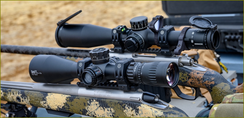

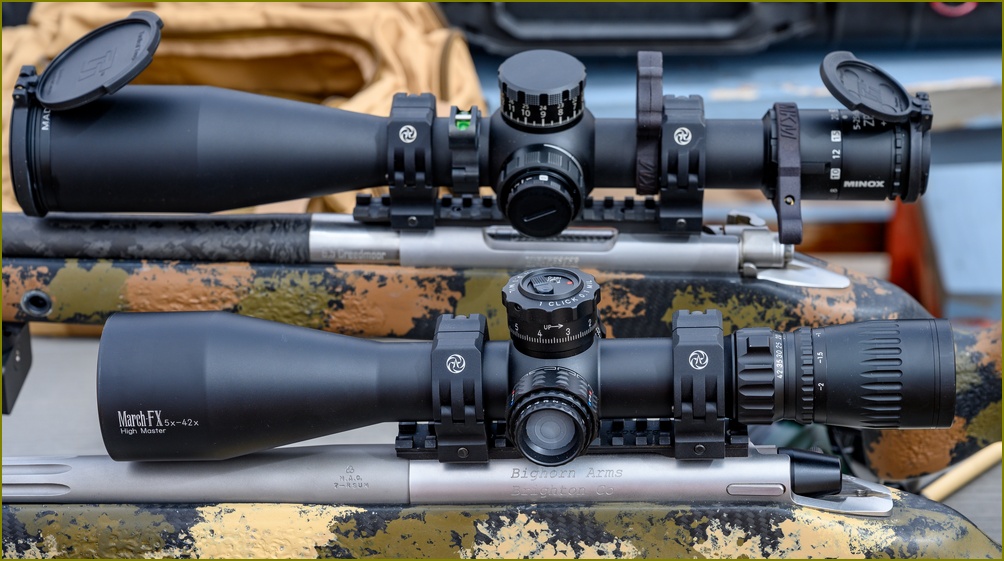

    The ergonomics of this scope play out very well, at just over 14" long it is considerably shorter than the scope it was aimed to compete against - the Schmidt & Bender PM II 5-45x56. In fact, it is shorter than many 5-25 scopes and with the wide angle eyepiece has even greater FOV than the venerated TT525P and Minox ZP5 all the while providing 17x more magnification on the top end. Another feature that sets it apart from the Schmidt 5-45 is the parallax goes down to 10 yards making this a very viable option for many rimfire rigs out there - serious NRL22 competitors should take notice.

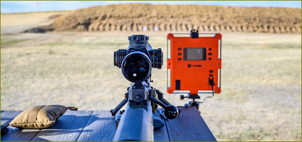

    I had a bunch of load development to do on the day I went out so had the opportunity to use it at 100 for sight in and at 300 for my LD work, I did notice that the parallax/focus was a bit finicky which is not too surprising given the 8.4x and shorter body design, but the parallax was easy to set and had the right amount of tension. The mag ring is a bit tighter and would benefit some with a throw lever. The diopter is a fast focus design with a lock ring and initial setup was easier than some other scopes that I've had to play around with more to get just right.
    If anyone has any specific questions, or has something you'd like me to test in the field, please let me know and I will do my best to accommodate. In shooting the March 5-42x56 HM side by side with my Minox ZP5 5-25x56 I really enjoyed shooting with the March, in fact, I found myself enjoying the FML-TR1 reticle more than my favorite - the MR4. The thicker center cross and dot made acquiring the target "easier"... it might just be my older eyes but I've found the thinner reticles are harder for me to pickup

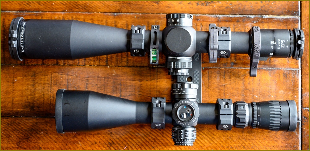

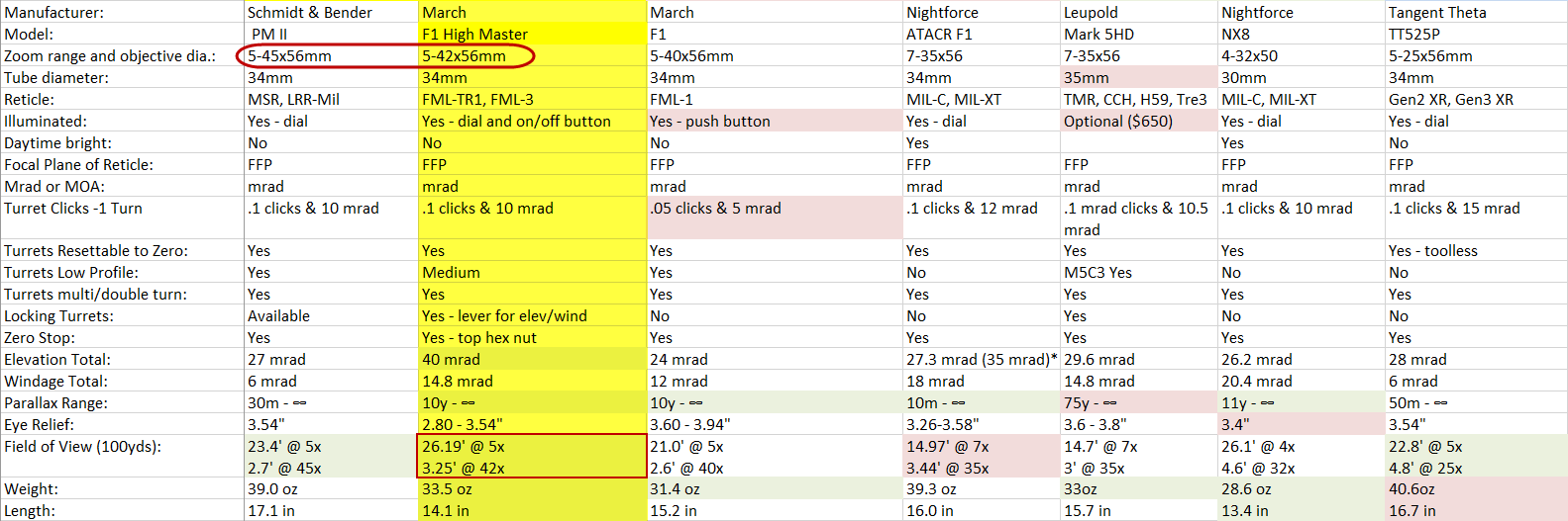

    For size comparison, here's a top view showing the size difference the 5-42 HM has over the ZP5 5-25

    I did not think I would like this reticle as much as I do, and I now feel it is my favorite crossover hunting/long range reticle, the tree disappears when you aren't needing it and the center cross and dot are idea and easily picked up. My previous favorite has been the MR4 reticle available in the Minox ZP5 series, but I really think the FML-TR1 has some distinct advantages as there are times where the center dot of the MR4 gets "lost" in busy backgrounds but the FML-TR1 was just the right thickness to be easily seen in all kinds of background situations but also not be too thick that it obstructs. The Hide's own @koshkin is responsible for the FML-TR1 design and after using it on multiple occasions and different environments I have "seen the light", it has the ideal center thickness, .2 mil spacing, thinner outer stadia with .2 mil hash and a tree section made up of dots that virtually disappear when you do not need them. For more details on the reticle, check out the link in post #5 below.

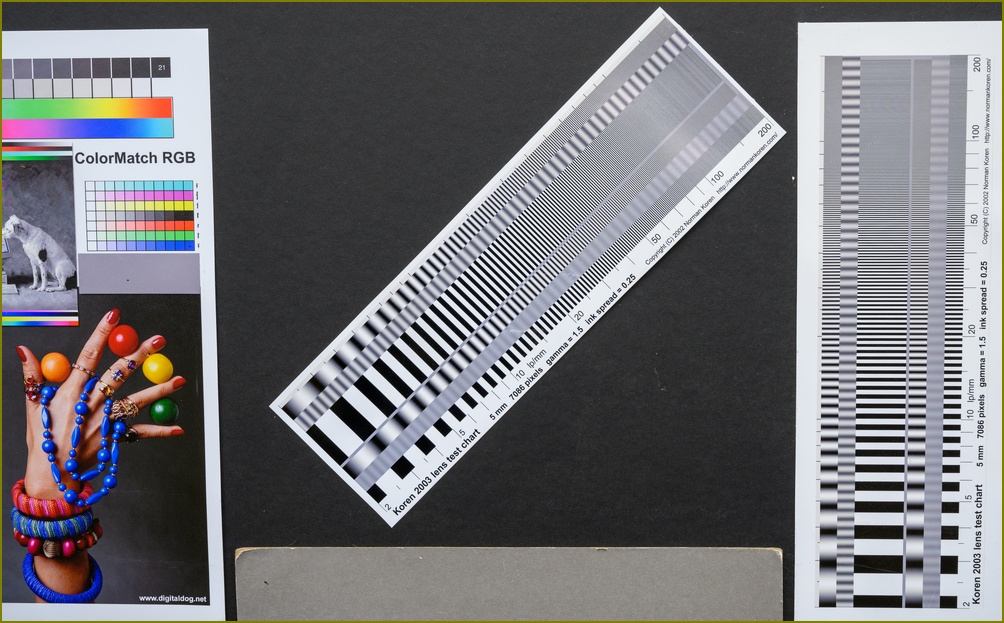

    Resolution
    While the 5-42x56 High Master may suffer from a bit of edge distortion, it excels in center resolution and offers superb image quality (IQ).

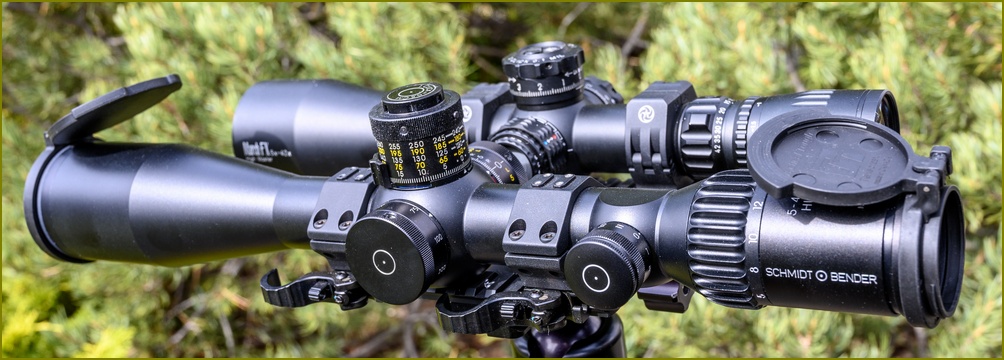

    Sneak peek with the Schmidt 5-45x56 High power, yes, it is quite a bit larger than the March!

    Interesting. It looks like the March Rep showed me the FML-MT reticle.
    So, @koshkin, I take back what I said in our short convo at shot.
    I think the MT looks like shit. The TR1 is much better.

    I was worried the center portion of the reticle would be too thick, but I actually really enjoyed shooting with it and I like how clean it is around the reticle. Everything is spaced at .2 mils so very easy to bracket.
    Edit: if the entire reticle was as thick as the center I think I would not like it as much, but because the rest is thinner it strikes a very nice balance overall.
    Also, I’m sure I’ll take some heat for my comments on the turret’s feeling better on the new March than they did with the Kahles and ZCO. Keep in mind this is my experience and my opinion, my statements do not infer that somehow the Kahles and ZCO turrets are inferior, but at 15 mil per rev they have a different feel and what I’m saying is I prefer the feel of the new March turrets and part of that could simply be the wider spacing being 10 mil per rev vs 15. YMMV

    I did like the turrets a lot. The way the locking feature is executed allows me to lock or unlock the turret with no disruption to the sight picture or my shooting position. Click feel is excellent and keep in mind these are relatively low profile turrets. I have never seen a reasonably compact turret have clicks as good as these.

    I’m curious if they’ll maybe change the zero-stop a little bit. I HATE needing to have several or even 1 small, easily lost little tool just to change my zero.
    hoping they get rid of the hex
    I'm led to believe the production model is tool-less, however that is third hand. I did not attend SHOT this year, so didn't get a chance to question them / enquire.
    Kickin, one could say this is the "finalized" pre-production model. I suppose it's always possible for March to make some last minute changes, but my understanding is that the scope I have in hand will be the same as the scopes they release to market shortly.
    Regarding future upgrades, March is listening and my hope is that the new 4.5-28x52 scope will have an enhanced version of this turret but even if it doesn't the turret is still completely usable I just wish they had someway to hide a hex wrench like Kahles does inside the battery cap.
    While it is not toolless it is nice that you only need one hex wrench and one hex bolt to adjust to set zero stop from the top of the turret.
    I believe I forgot to mention this above, but to set zero it is similar to other scope designs where there are two hex bolts on the side of the turret housing that must be loosened and then the turret spins freely (no clicks) to set zero wherever you like, then cinch up the two hex bolts and you're GTG.

    Here's from my own database and compared to other scopes that have magnification above 30x, I've also thrown in the TT525P which previously had one of the widest FOV's in a long range scope, keep in mind the design parameters of this scope have it more comparably compared to the Schmidt 5-45 vs. other 5-25 or even 7-35 scopes, but I thought seeing the specs together would be beneficial.
    Great news, March is saying April for official production on the 5-42x56 HM. They have also provided full specs and confirmed what I'm seeing with my eyes, this has the widest FOV I've ever seen in a long range scope, in fact, at 5x the March has wider FOV than some scopes at 4x!!! Specs can be found here - https://marchscopes.com/wp-content/uploads/2020/03/March-FX-5x-42x56mm.pdf
