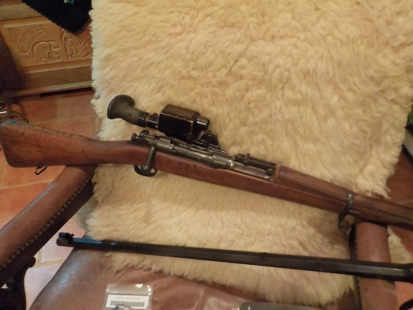

    I'm waiting on a 1903 Springfield dated 1917 to mount my Warner Swayze scope and a field manual for the scope to see if I can dis-assemble it for cleaning. While waiting for that to arrive, I ha have 3 projects ongoing.

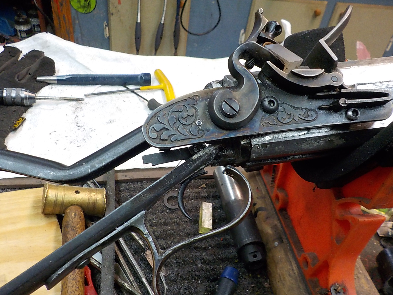

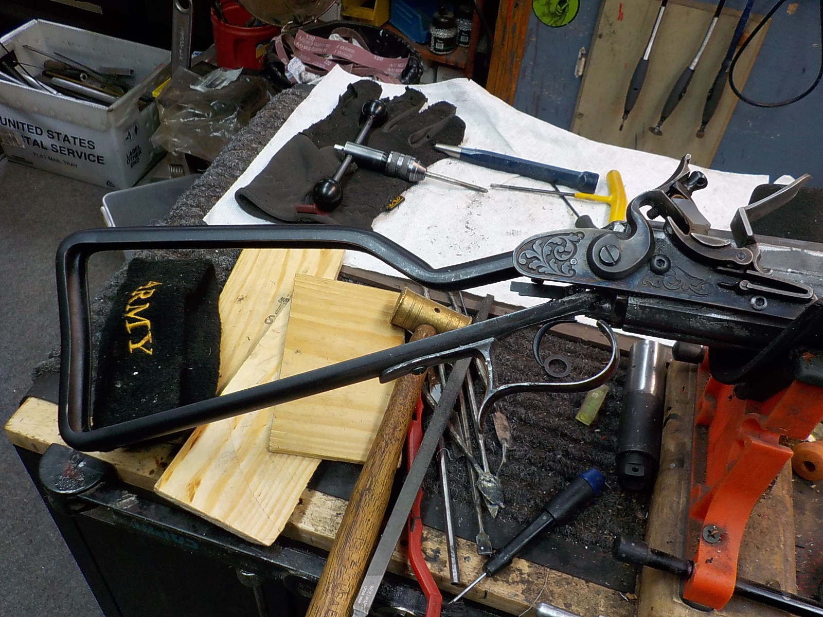

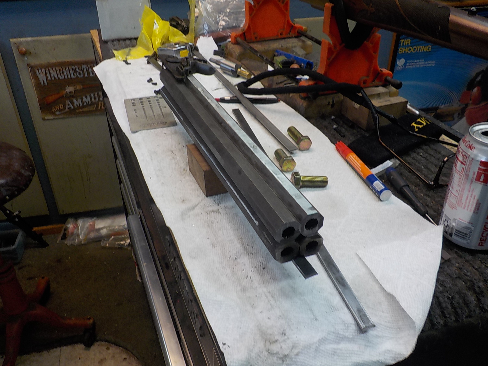

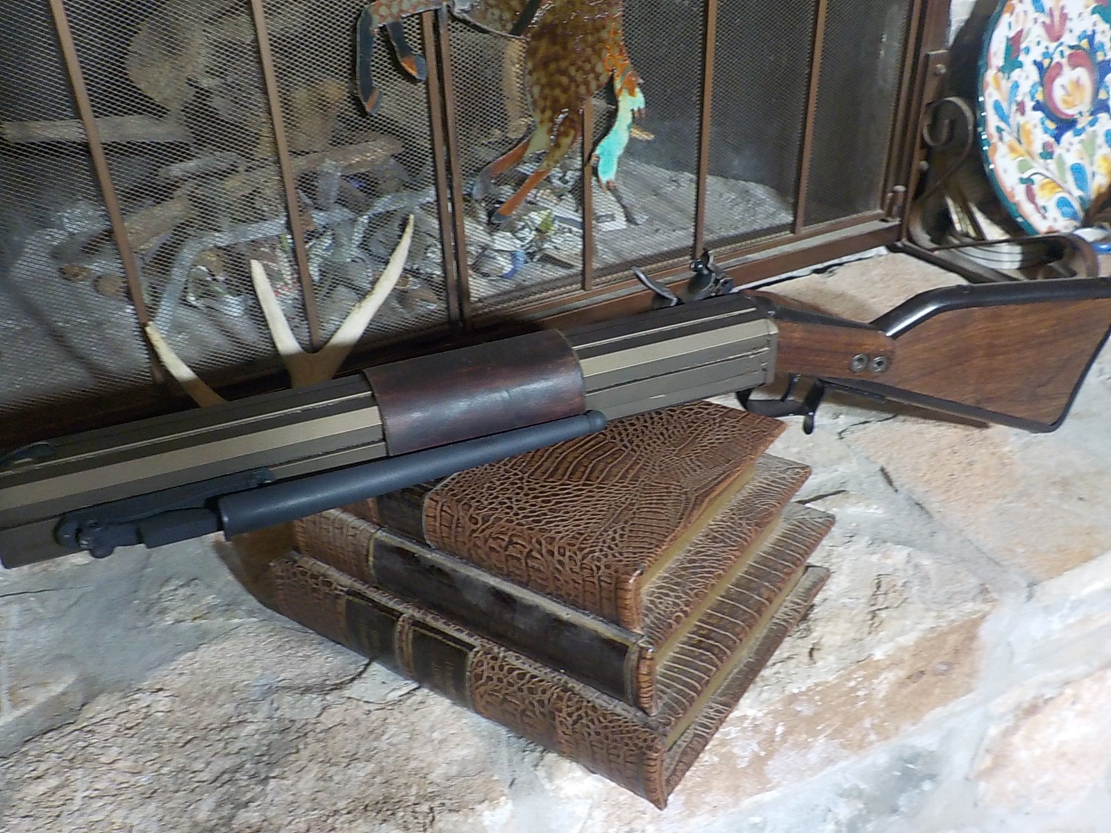

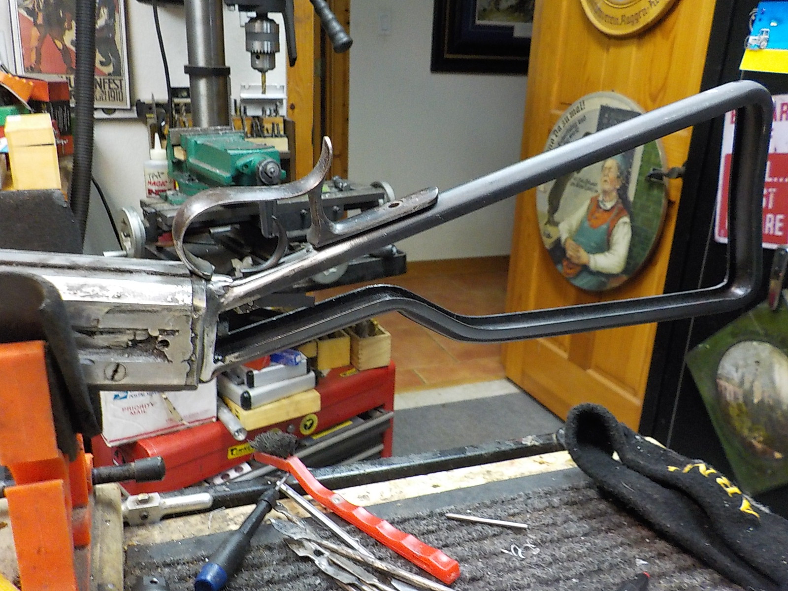

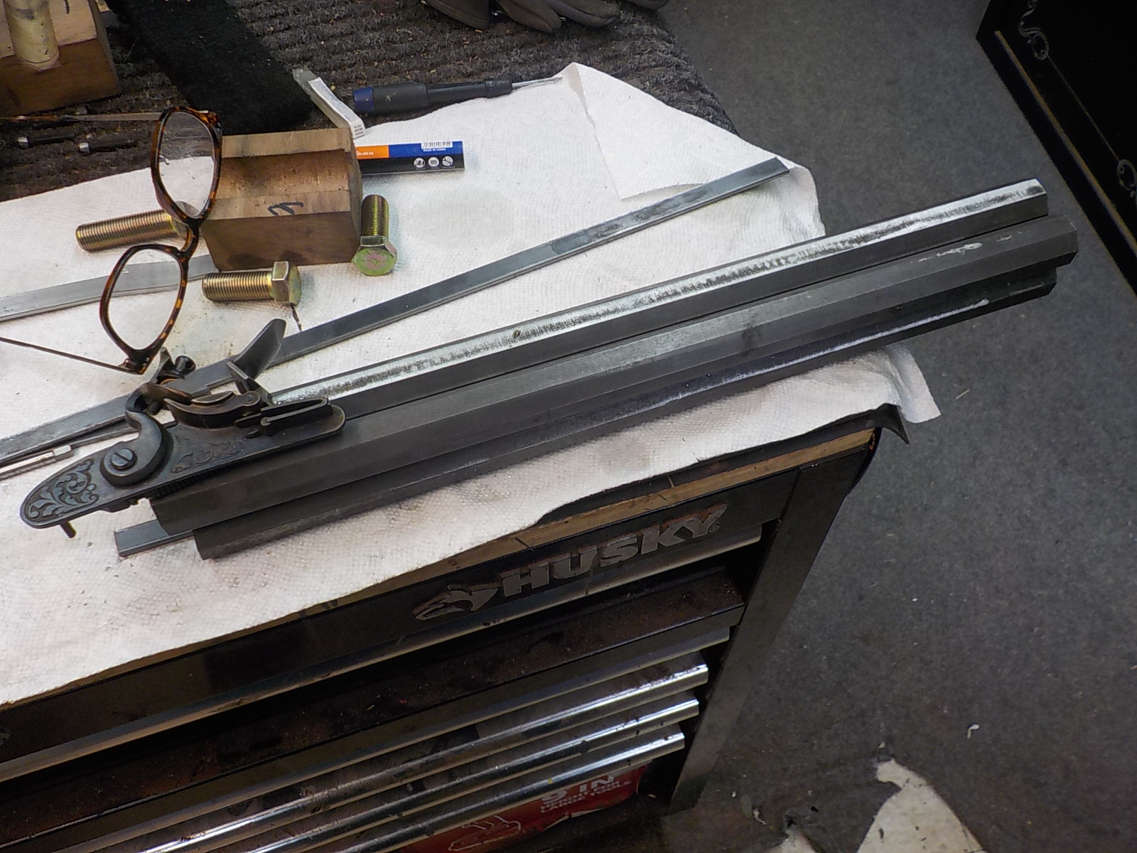

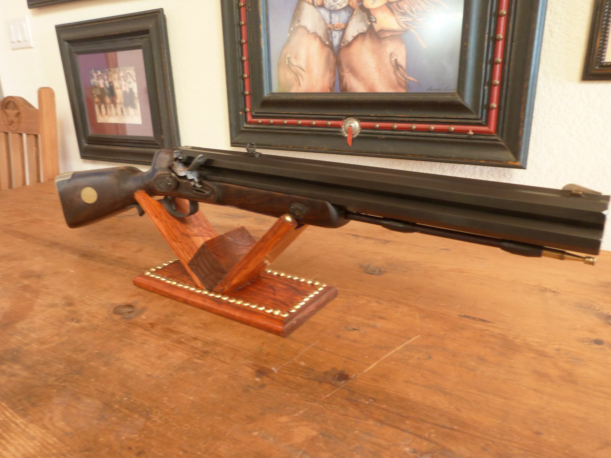

    First, I am re-building my Volley Gun after the rotating force of four barrels igniting in series ripped the barrels apart. Yhis time I'm welding the barrels together. I'm also shortening the barrels to 16.5 inches and using a Sten loop stock for an all metal gun. There are several metal stocked flint locks in museums.
    Original volley gun that self destructed,
    New volley gun

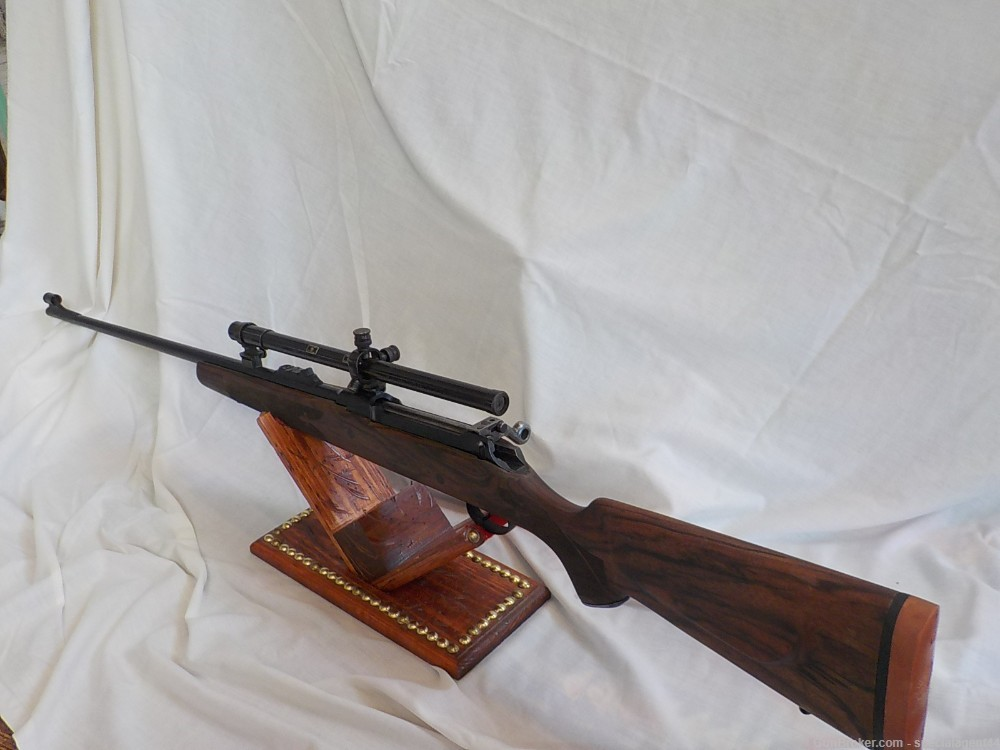

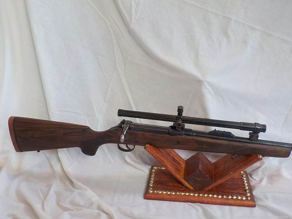

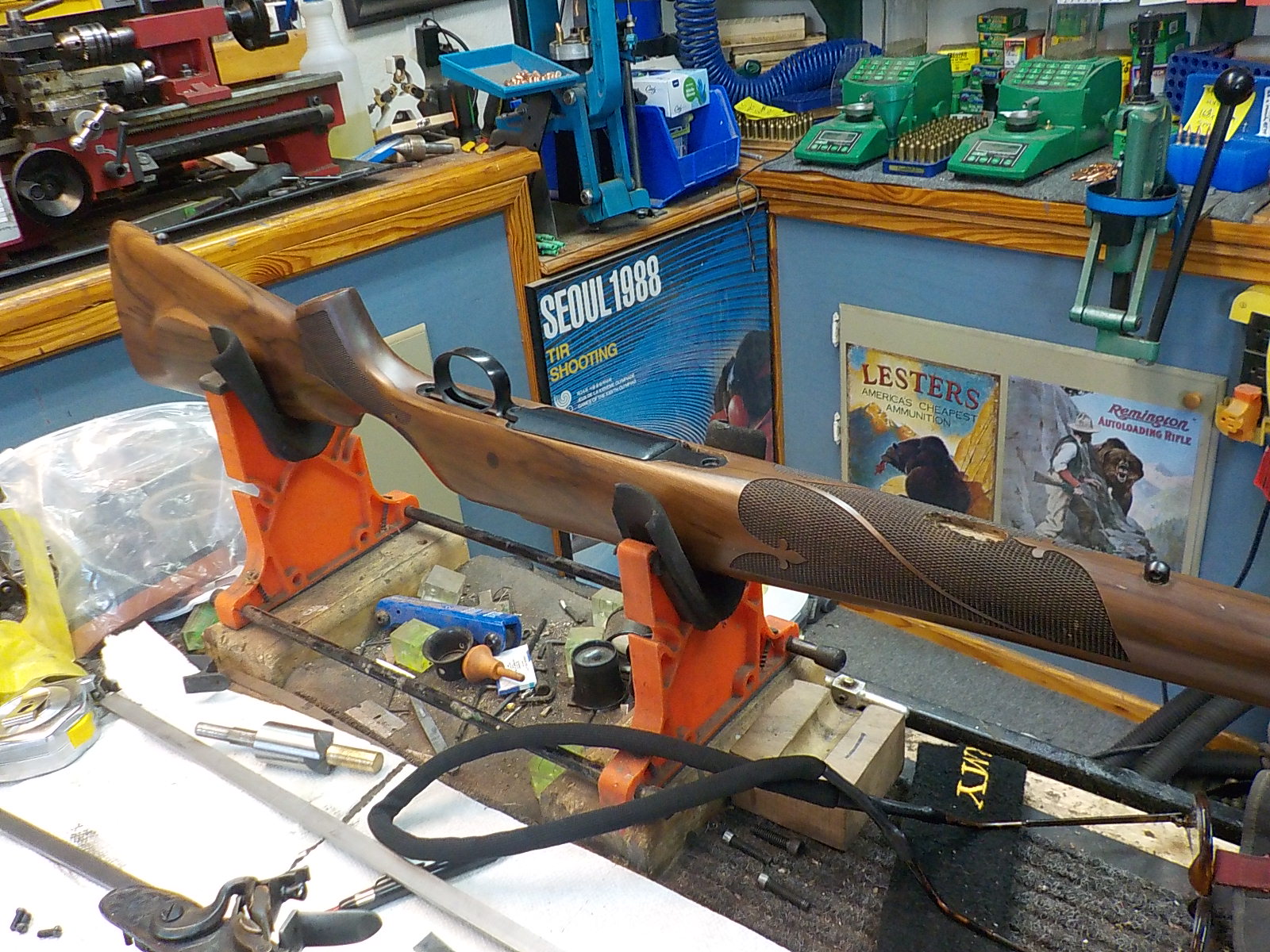

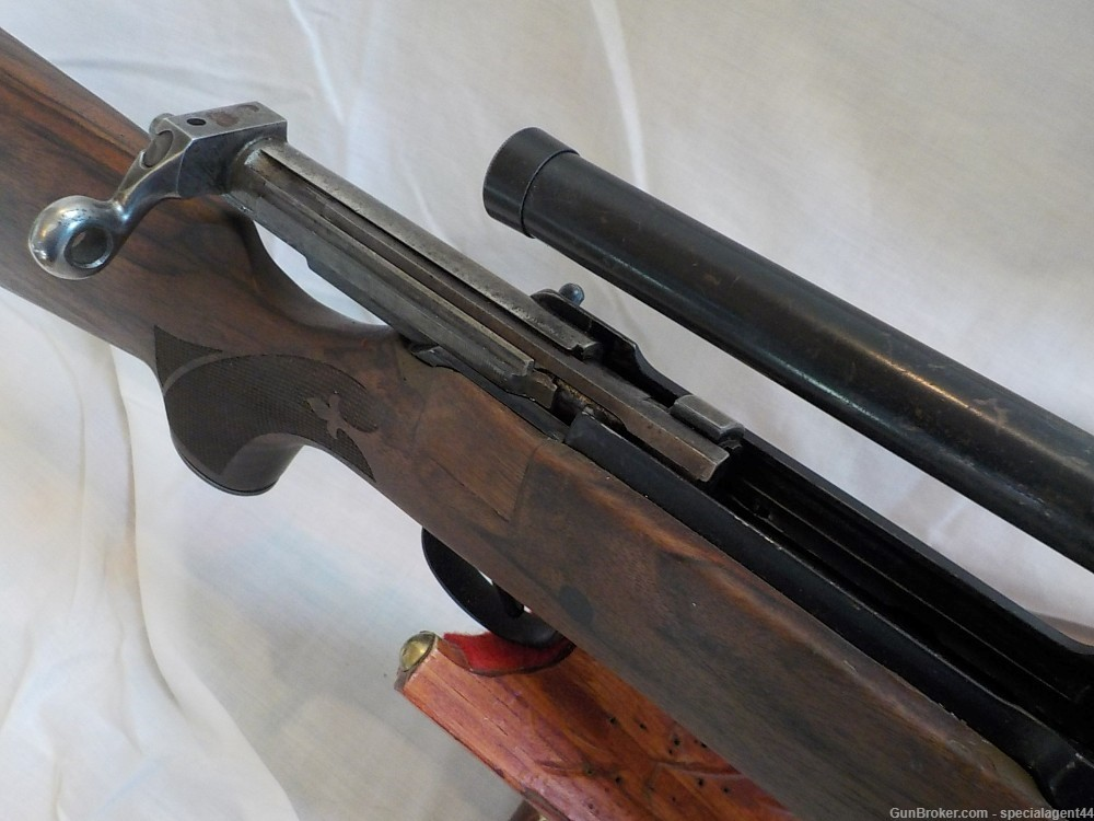

    Next I'm making a Ross .303 sporter. I've had a super accurate Ross barreled action laying around for years and the same for a high grade sporting stock for a Remington model 30. Put this all together with a nice vintage external adjustment long tube scope and probably sell it as I've since bought an original Ross 1910 sporter.

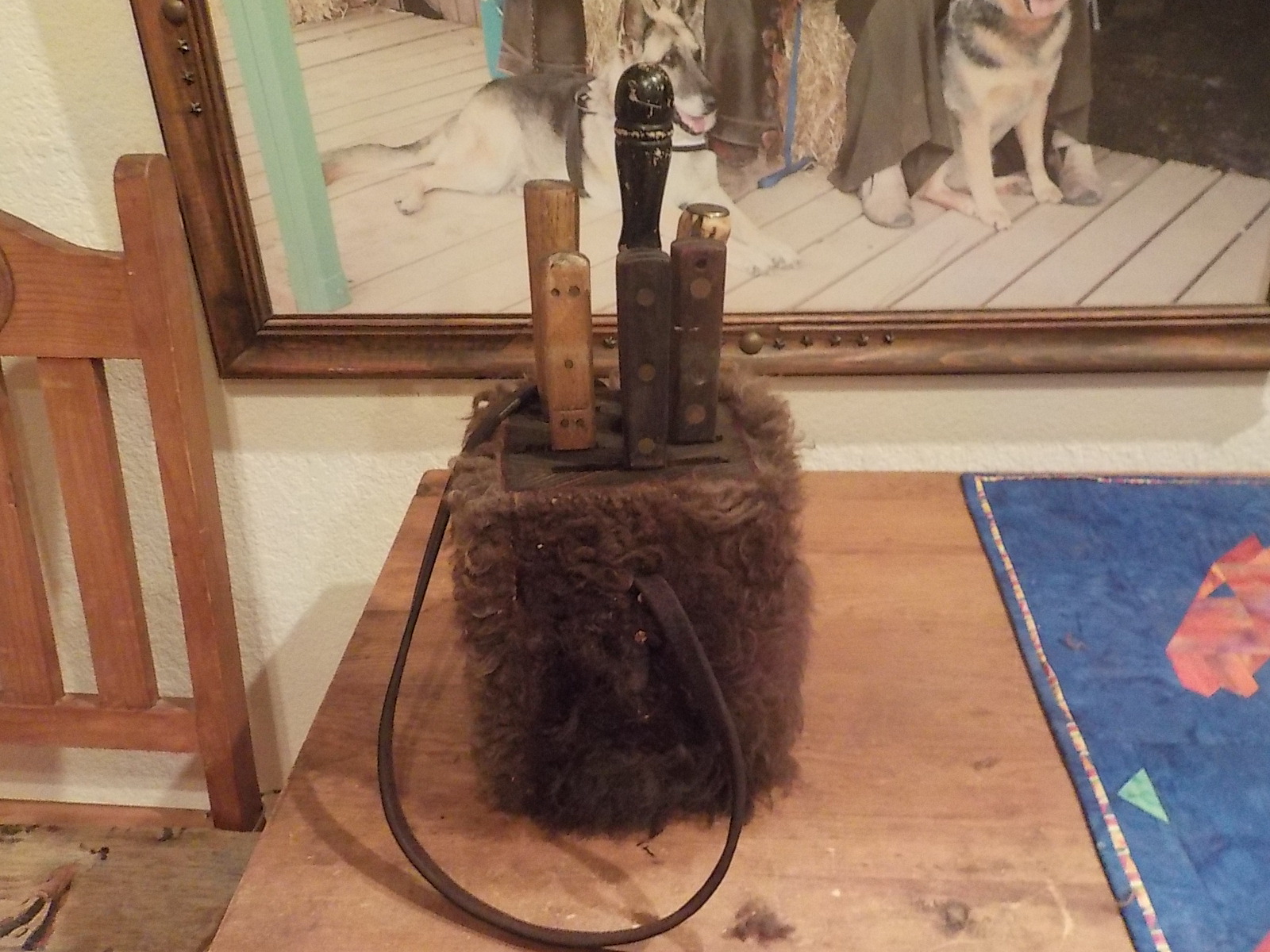

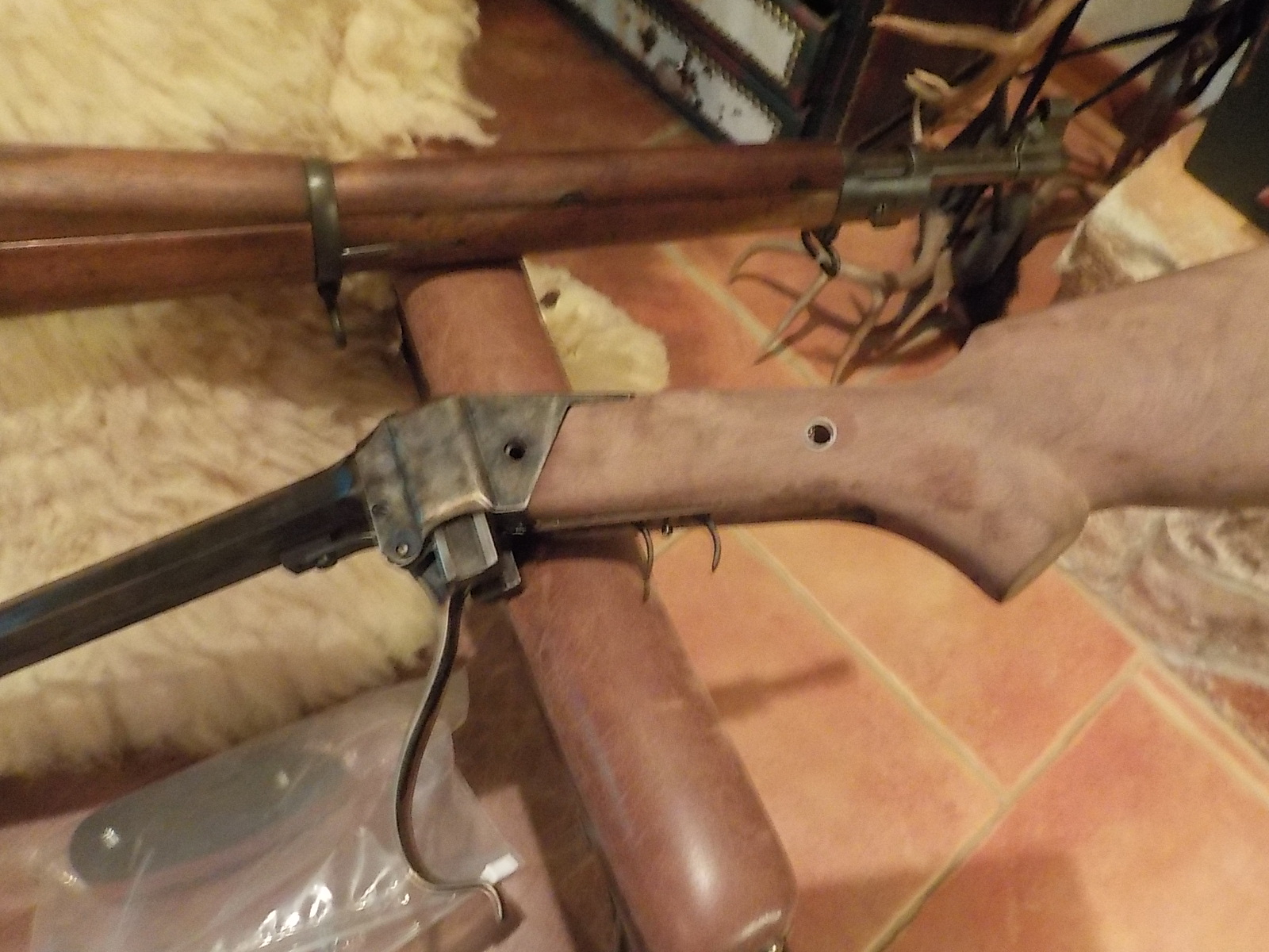

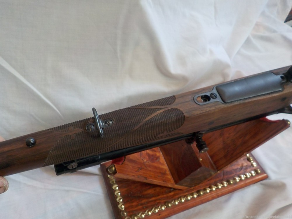

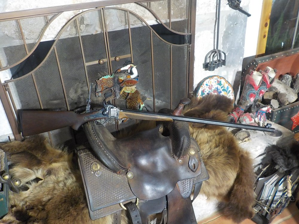

    Finally I picked up a really rough Pedersoli 1874 Sharps sporting rifle in 45-70 and am refinishing it, putting a new stock on it, adding a double set trigger and Soule type long range sights. I'm going to sell this as a complete Buffalo Hunt package with Buffalo hide coat, period gauntlets, cartridge belt, shooting sticks, brass, bullets, loading dies, leather scabbard and buffalo skinner knife set in buffalo hide knife block.

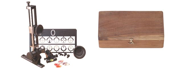

    On a side note, which Soule Sight are you putting on the sharps? I am evaluating my options for an upgrade on said Remington.

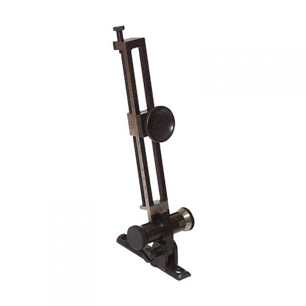

    Pedersoli long range sights.
    Reactions: Modoc
    Volley gun is not for sale. I just thought I'd mention some projects, I don't want to appear to be trying to circumvent the Hides' sales policy.
    I was joking. You have the coolest projects. Does it fire all 4 barrels at once?
    Reactions: RTH1800
    @buffalowinter , I will be interested in your opinion on the quality of the sights after you are finished. The pictures look good, but I haven’t seen any physically. Those that I know are shooting BPCR. Are all running MVA sights or PC (Period Correct) scopes.
    Pedersoli sights are excellent at half the cost of the MVA...still $380
    New volley gun
    View attachment 7991349View attachment 7991350

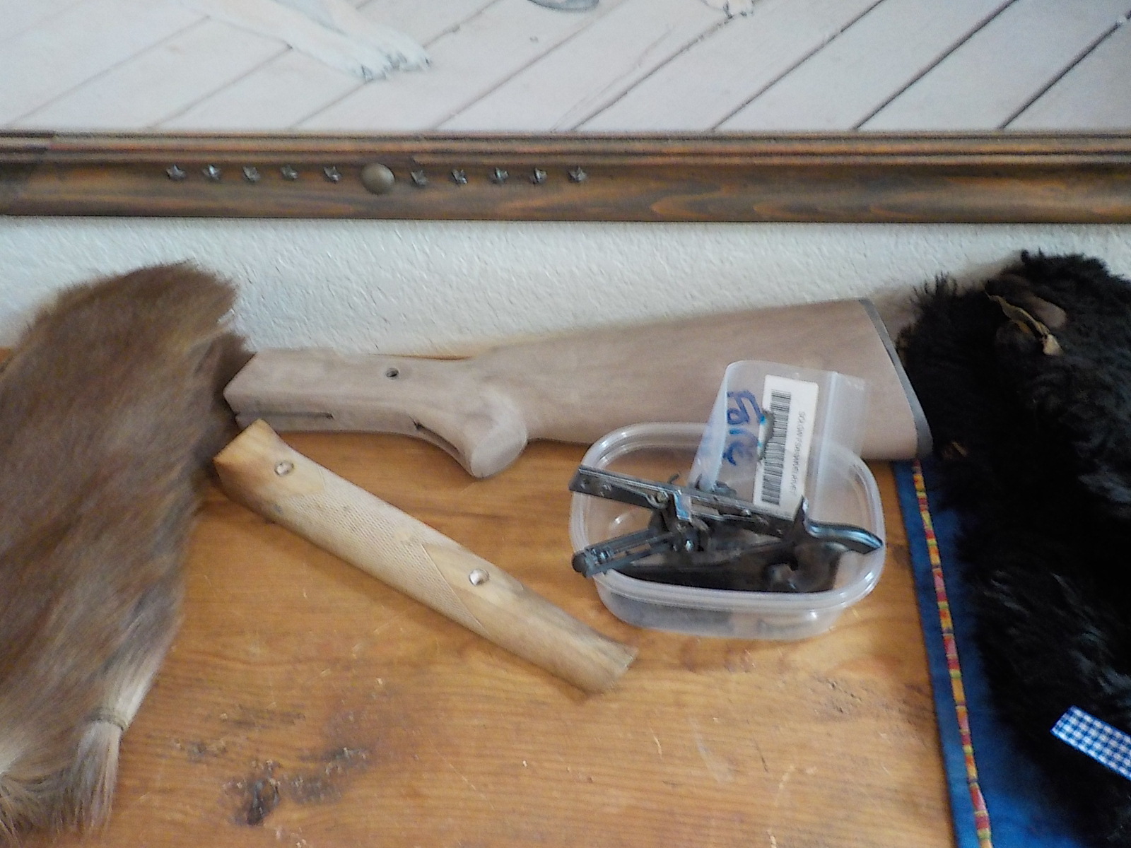

    View attachment 7991353View attachment 7991358
    That stock in the cradle looks like a Goens vintage. Beautiful European walnut and all

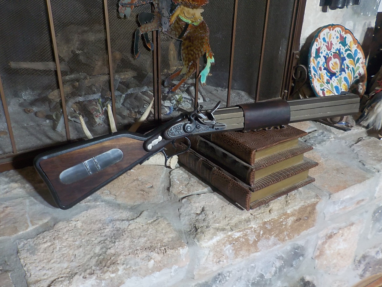

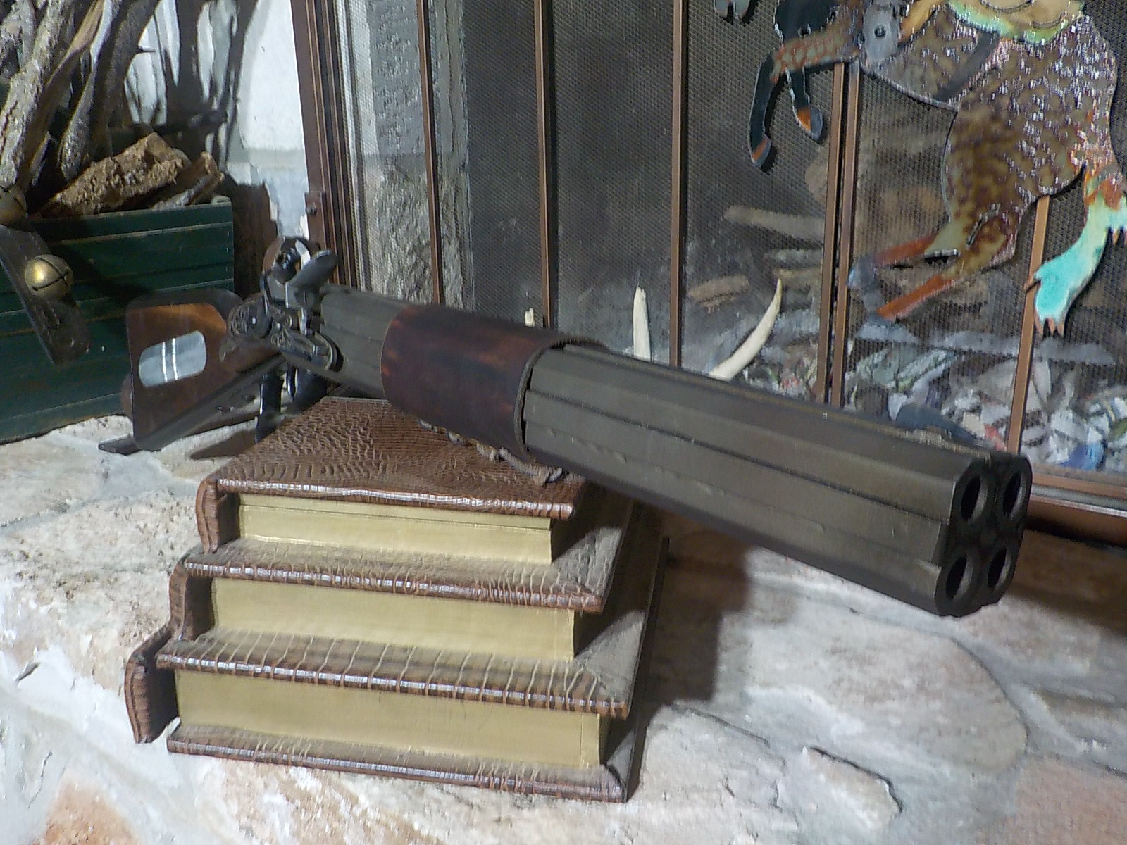

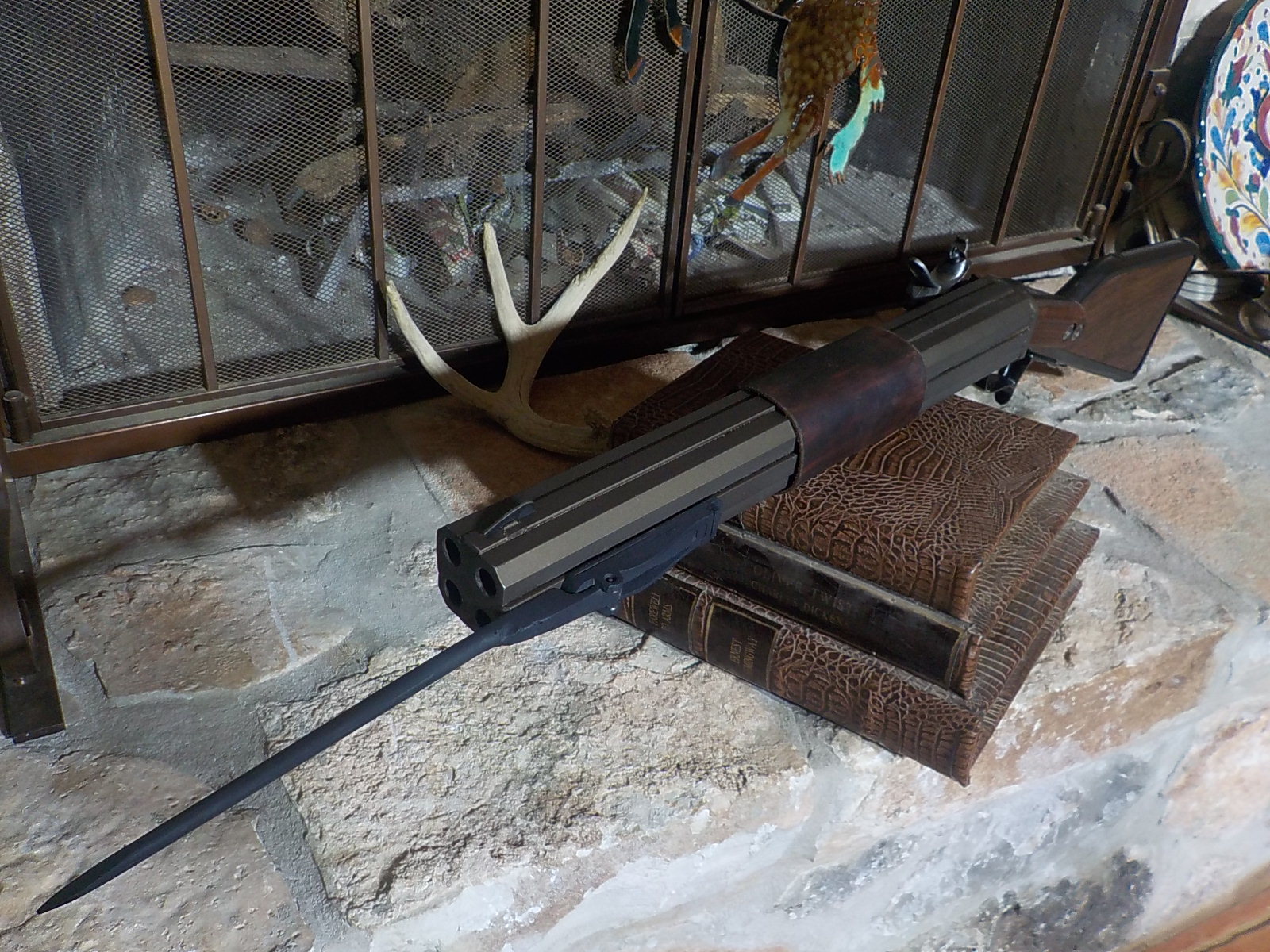

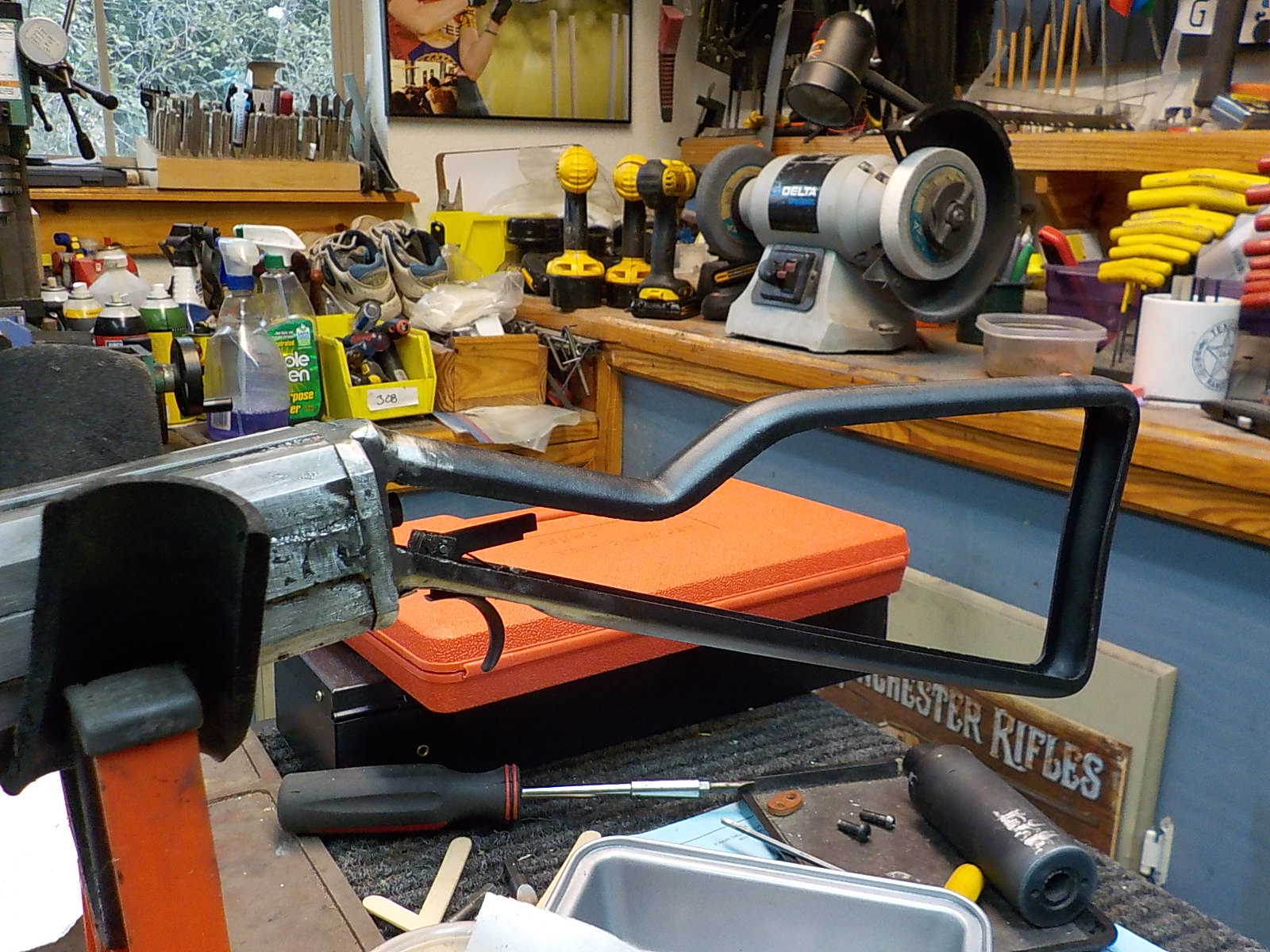

    Getting into the Volley gun as it progresses. Stock, trigger, and trigger guard are all on. I'm going to put a Walnut panel in the "skeleton" portion of the stock and Walnut panel handguards. Barrels will be in a darkened Burnt Bronze Cerekote while stock and bayonet will be in Oiled Antique Bronze with a Cerakote matte clear coat.
    mocked up
    installed
    That would be a kick in the pants at the Rendezvous this weekend.

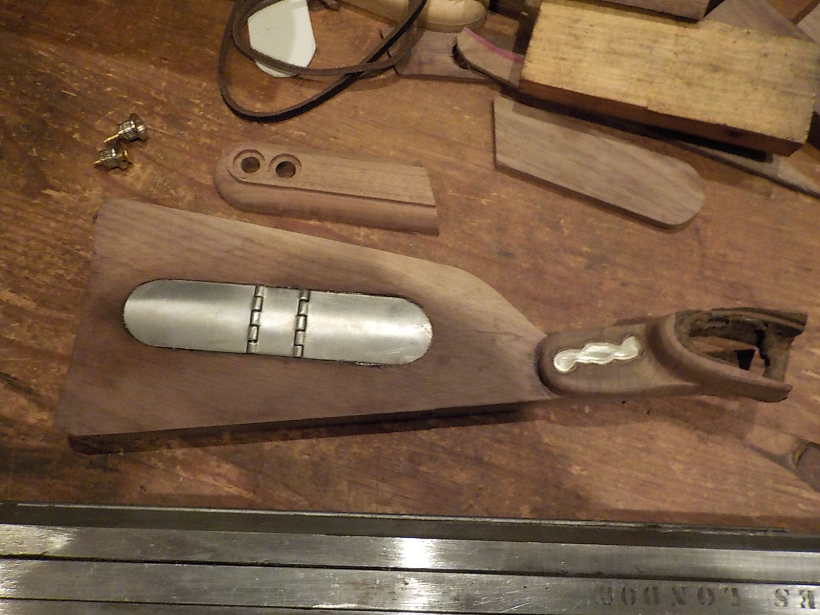

    Butt stock with patch box. Now on to final finishing.
    Warner-Swasey scope installed on 1903 Springfield mfgd in 1917.
    Sharps sporting stock inletting around new double set trigger.

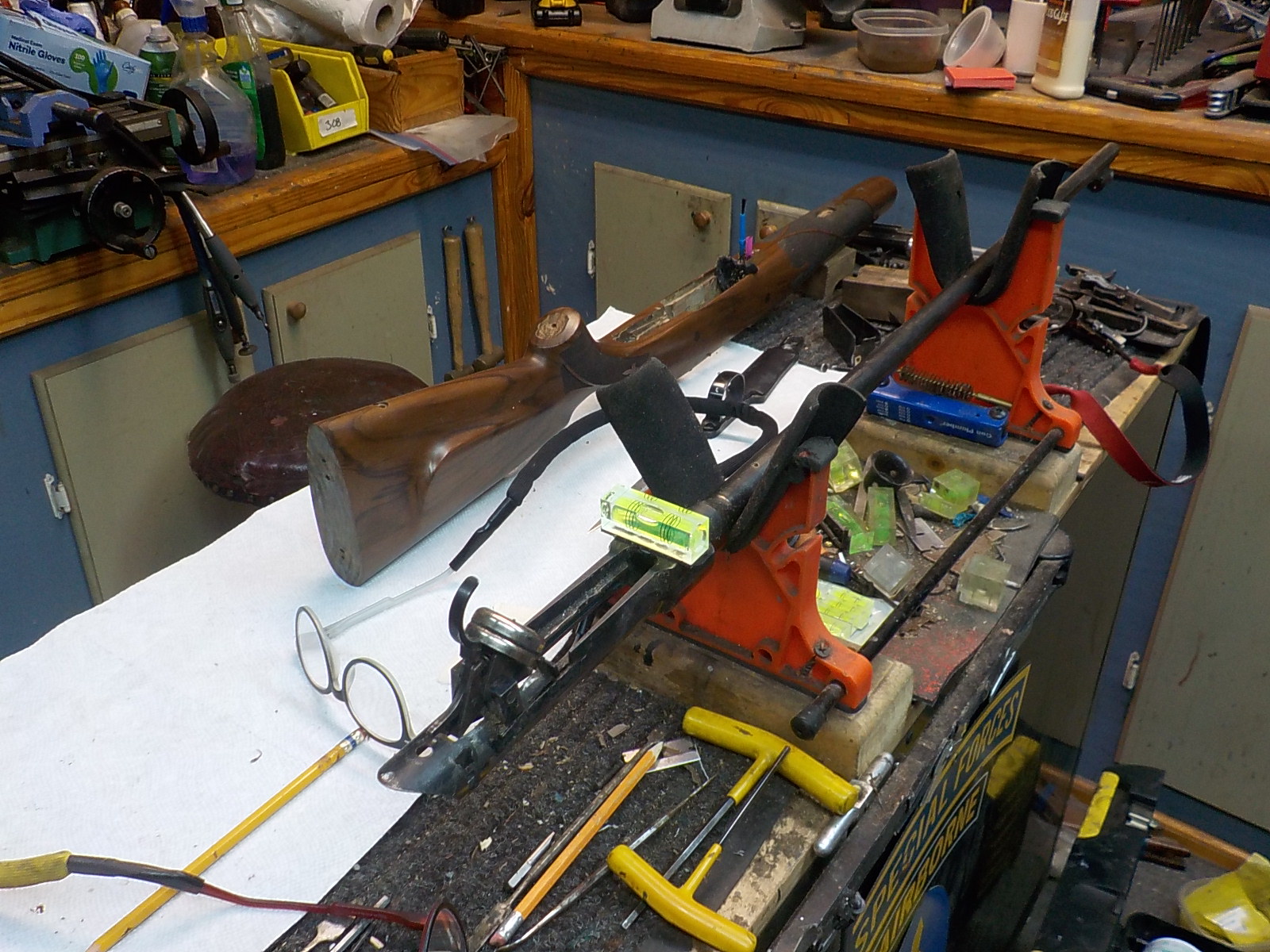

    Ross 1910 sporter, inletting, bedding, fitting new magazine box, floorplate, re-drilling action screws, cut and weld new trigger.
    Volley gun finished. I guess I'll have to do a video and accuracy test. Not looking forward to it. I hate the explosion in front of your shooting eye and the timer delay between flash in the pan and actual discharge. Very un-nerving. I would have to guess that as soldiers stood on line and fired in volleys that they all had their eyes closed. I'm surprised that every veteran wasn't blind in their aiming eye. When I shoot this I fully intend to wear my riot helmet with face shield and maybe my welder's glove.
