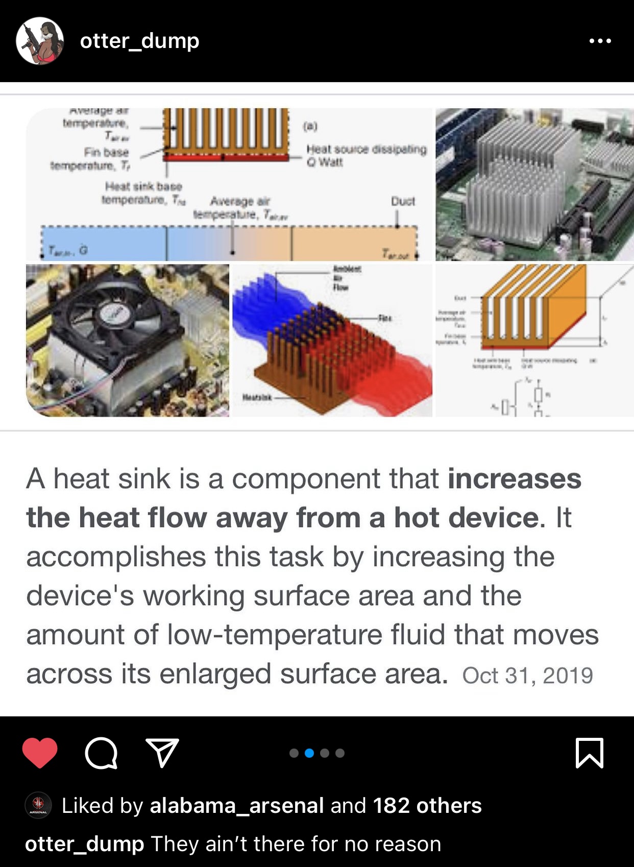

    @AndrewKing responded on Instagram to some questions about the “ribbed” design. Basically, they act as a heat sink.
    And I did notice that they cooled down quicker than my other cans do. So, I’d say it worked as intended.

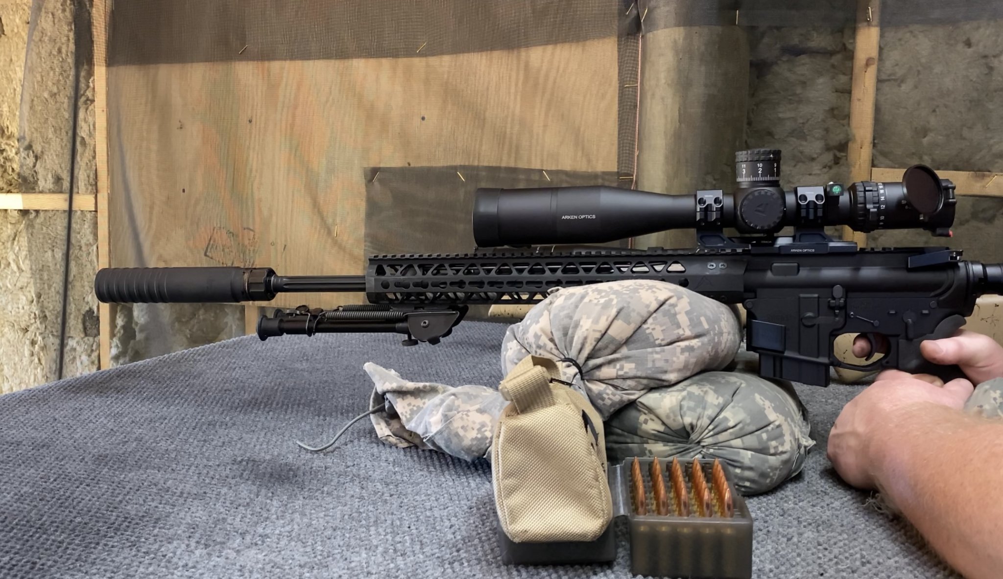

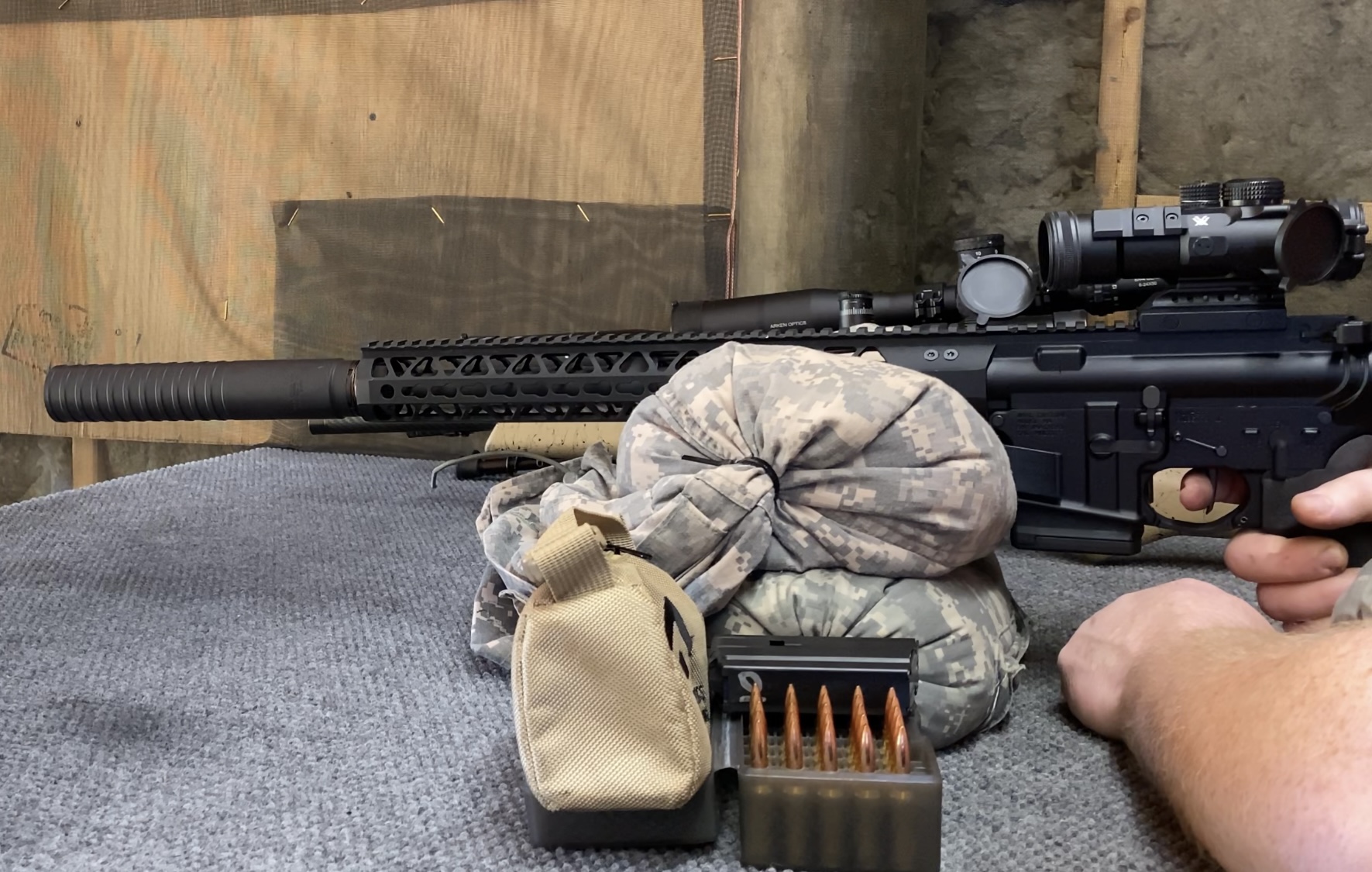

    Went to the range today, and put some subsonic .300 BLK and supersonic 5.56 through them...
    Impressed with 5.56...Both cans handled it well. I expected the L to hold its own of course, and it did with ease. Hearing safe, great tone, ran great. But the S really surprised me. It was pretty impressive on taming the 5.56, which is a very hard cartridge to tone down in an AR. No notable gas in my face, ran perfect, and volume was very manageable without ear pro for a couple of quick shots. Which I know is subjective to A LOT of folks, but when I'm doing these tests I only shoot 5 rounds at a time, and I like to hear the suppressor and the tone from behind the gun. So it's not like I'm doing 30rd mag dumps, or running a belt-fed without ear pro on.
    Now to the .300 BLK... Once again, the L performed as expected...Extremely quiet, great tone, right on-point in every way a quality suppressor should be. The S performed amazing. It was quiet, no gas, no "thumpy" sound like my Sandman-S cans, and was just all-around impressive with subs on a .300 BLK. There were a few folks shooting and everyone stopped, and just watched. One guy asked what I was shooting, and said, "That is the quietest thing i've ever heard...You can't even hear you shooting it with plugs in!" I think the Hydro-S might have found a permanent residency on my .300 BLK... 😏
    One thing really shocked me about both of the OCL cans on everything I've tested them on so far... The POI shift was virtually nonexistent from my 100 yard zero, even at 200 yards. With my DA cans, I notice a very slight (maybe 2" max) POI shift to the right with .300 BLK 220 subs at 200 yards, because they're moving so slow and that's a decent stretch for any subsonic cartridge. The POI shift with the DA cans doesn't happen with any other cartridge or rifle I have tested them on, just the .300 BLK with subs, so it must be a subsonic thing.
    Will post videos soon.

    Went and tested 4 of the cans today back to back on the .300 BLK with subs…Videos to come… The Nomad-LT, Hydrogen-L, Sandman-S, and Hydrogen-S.
    After more shooting this weekend (150-200 more rounds)…Dude, I’m honestly impressed with the Hydro-S. It’s the best mix of length, weight, and suppression. Its so light, you don’t even feel it on the end of the gun, even on the bags. I think it’s found is new home on the .300 BLK. 👍🏼

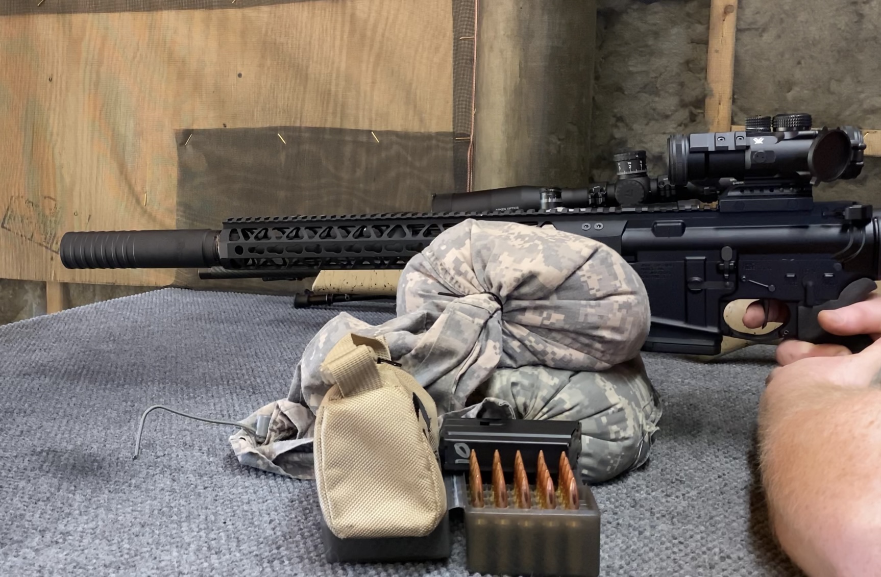

    New video comparing the new Otter Creek Labs Hydrogen-S against the Dead Air Sandman-S MIL Contract suppressor on my 16" .300 BLK with 220 subsonics.

    Get ready for the novella...
    Purely based strictly on decibel volume, and not on any other factor... It's a REALLY close tie between the Hydro-L and the Nomad-LT. They're both phenomenal cans, and they both sound great on everything I've tested them on.
    The Hydro-S is definitely louder than the other 2...But it's still hearing safe, and sounds great, with a very smooth sound signature. Volume differences, and weight and size differences of the 2 new OCL cans, it's almost a spitting image of comparing a regular Nomad-Ti to a Nomad-LT. That's the best well-known comparison I can give comparing the Hydrogen-L to the Hydrogen-S...Just incase anyone was wondering what a more commonly known comparison would look like between the 2 new OCL Hydrogen cans.
    The Hydro-S sounds amazing, and for an all-around suppressor, it would be a great option, especially when you factor in the 7" length, and it still has 9 baffles in it, so it's very efficient for its size. Which makes is very maneuverable and perfect for hunting or compact setups...It's very similar to a Nomad-Ti in specs. And it also sounds good on the Grendel. It's slightly louder and has a little more "thump" to the sound than the other 2 long cans, but still hearing safe, IMO. It even sounded good on my 14.5" 5.56 this past weekend. Videos on that to come later. I can't dump all my content at once 😂, as ammo is still not cheap, and while I have all the stuff to reload for 5.56, it was always cheaper just to buy LC XM193 or cheap Tula .223 in bulk, than for me to single-stage load for it. Not currently, but hopefully prices will go back to normal soon. So us "Poors" can afford to shoot. 🤣
    But if I was forced with absolutely no choice but to pick only 1 suppressor between the 2 different "L" suppressors, as to which one for the 6.5 Grendel based strictly on sound & DB volume alone, and no other factors...I'd have to give a slight edge to the Nomad-LT. But it's NOT by much. When I replay the videos at home with my high-end headphones and my interface with high-quality preamps in it for maximum sound recording/reproduction, the Nomad-LT is a more smooth "wooshy" sound signature, and has zero "thump" in the sound... And the Hydrogen-L does have a very very slight "thump" to the beginning of the sound signature. But you only really notice it in playback...You don't hear it in person, as the guy behind the trigger. This could just simply be a matter of the 2 very different baffle designs in the suppressors creating a slightly different sound signature, and might not even be any DB volume difference...Just strictly different sounding suppressors. I don't know if they sound any different downrange? 🤷🏼 I am certainly not an expert, and I don't have any sound testing equipment to prove any of this, i'm just going off how they sound to my ears without plugs in, and how they sound in playback from an indirect side angle, after hearing them dozens upon dozens of times while editing and making each of the videos and sound clips. LOL
    So, I would say that honestly, the average guy shooting both the Nomad-LT and Hydrogen-L back-to-back (in person) on the same rifle, they would probably never hear a difference between the 2 from behind the trigger. My final thoughts on this... You really can't go wrong with either one of them. All of them are great cans. And the Hydro-S will probably end up being my new dedicated .300 BLK suppressor...It's THAT perfect of a combo with subsonics.
    Is there any other specific criteria you might be interested in that might help me advise you on which one to go with?

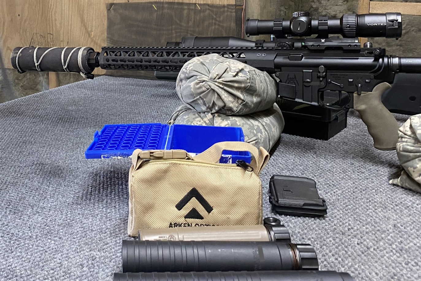

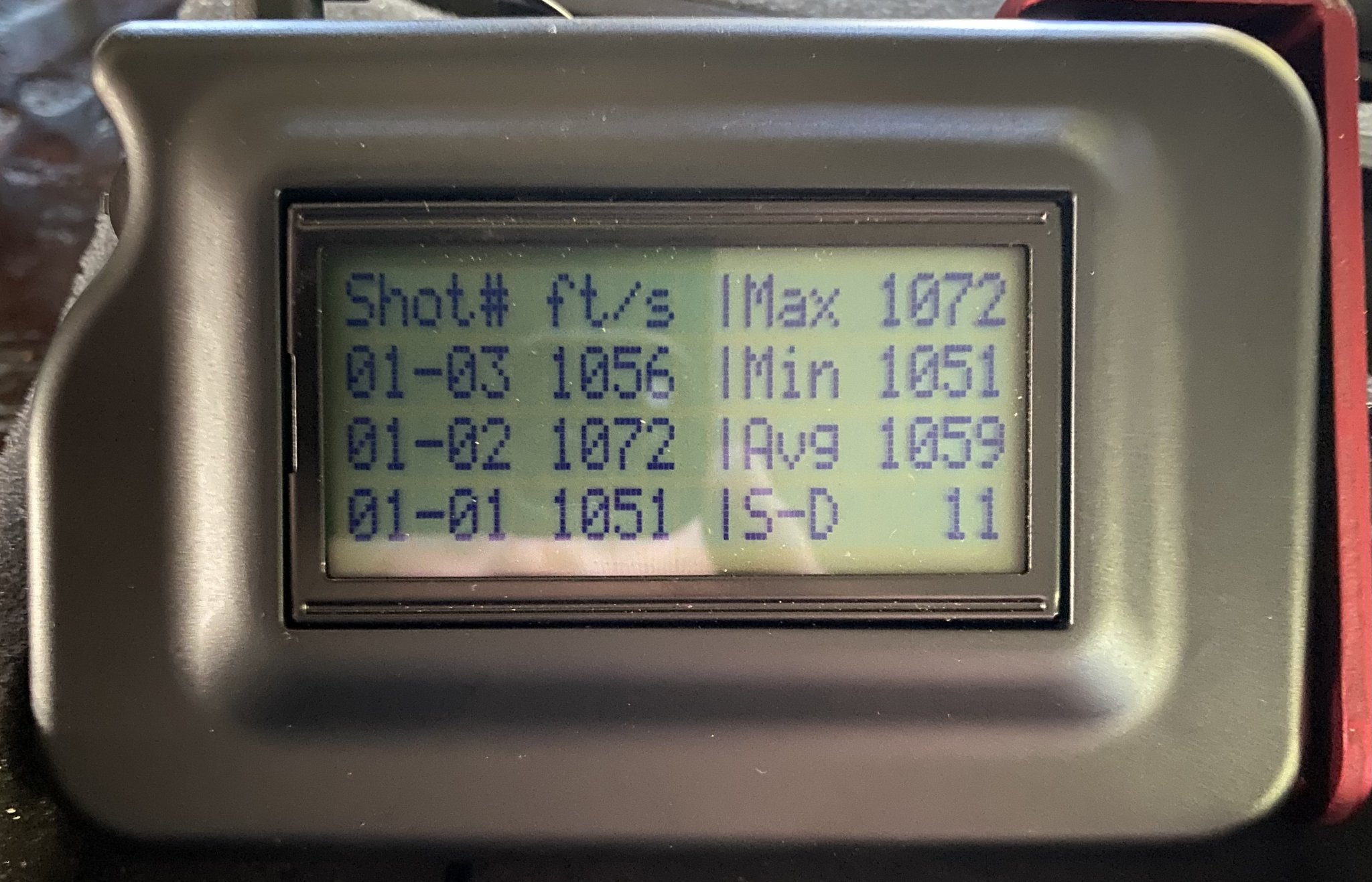

    Noticed recently with the weather getting warmer, that my “subsonic” .300 BLK load was no longer subsonic. 🤦🏼 The 16” barrel already makes it a bitch to keep loads subsonic, but now I’m fighting both. 😑
    So, I loaded up a few with 1/2 grain less of Alliant 300-MP with CCI 450’s in some cut-down WCC 5.56 brass, and strapped the MSv2 on the end of the Sandman-S, and walked out to the big empty berm along the driveway. Popped off 3 real quick, nothing went super, so I was happy. Then I looked at the MSv2, and was really happy. Only 21 fps ES, and an 11 SD. Not bad for .300 BLK subs! I will be taking the old MagnetoSpeed to the range with me tomorrow, and will get more data, and shoot for groups @ 100. 👍🏼

    Bring it down, and we’ll swap for a few rounds. I’m interested to see how the regular Nomad-Ti stacks up against the Hydrogen-S. Length & weight they’re almost identical. I think the baffle count is close, too.
    As far as want…Why not get both? They both serve a role. The Nomad-LT will be a beast of a hunting can with max suppression.
    And then get you a couple of the OCL cans… I’m telling you straight-up, they’re nothing to sneeze at. They’re holding their own with the big boys. I’ve been highly impressed. And I bought all of my cans, so there’s no bias going on. 👍🏼
    Went and tested the new subs today… Yep, worlds better than before! You still hear a very slight bit of bullet flight on video because it’s close to the transonic range, but it never breaks the sound barrier, so you don’t hear any “crack” down range. And it’s way quieter than it was before. 👍🏼
    If the ribs on the Hydrogen-L are 0.025" radially, then they add about 5% to the surface area. The net decrease in thermal resistance (increase in heat transfer rate) probably won't be as large due to a few effects (such as stagnation in the inside corners), so overall it's not some huge difference.
    I imagine any functionality from the design is marginal at best.
    Seems to be mostly aesthetics, which would be covered up by a wrap anyways.
