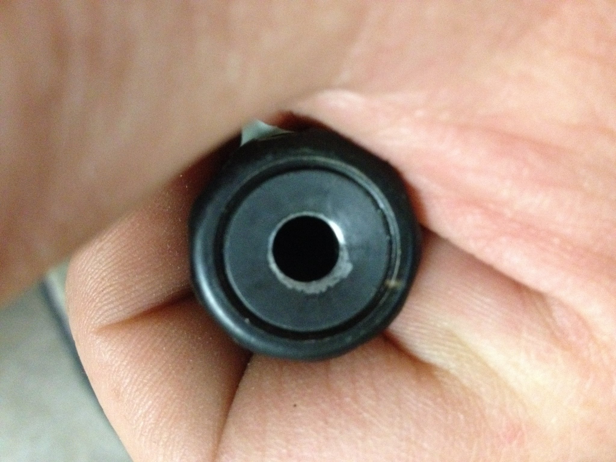

Third, I've always read the crown is the most important as it's the last thing the bullet sees. Well, this crown is a bit thorny and there's a small chunk missing at the very edge. Seems pretty rough the whole way around actually but that one spot is particularly glaring.

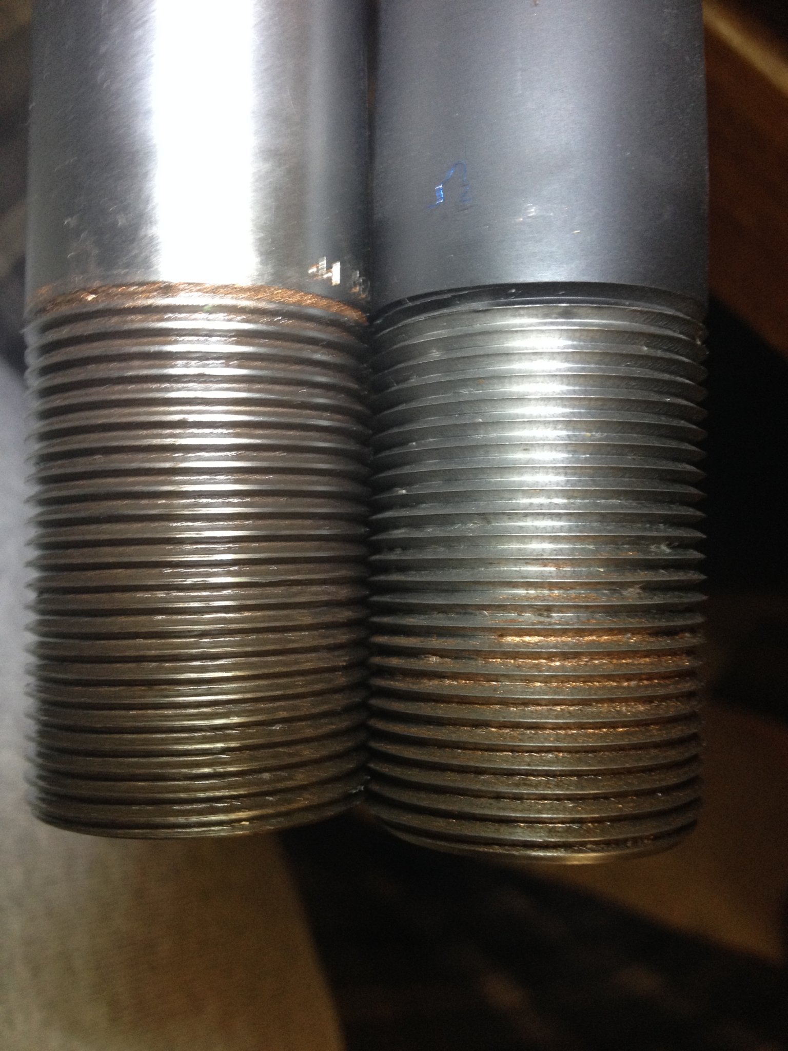

Fourth, there appears to be tooling chatter or something just before the gas port.

Let's start with various photos of the crown. My bore scope isn't the best so I apologize.

OK, First off;
1. The muzzle threading looks like shit.
2. The ding in the crown appears to protrude into the bore. It looks like shit too (based on the pic).
Borescopes and their associated pics are a thorny subject. A lot of barrels will shoot lights out, even though the borescope pics look like ratshit.
You need to contact the vendor and register a complaint in regard to numbers 1 and 2 above and get them to fix or replace. The bore condition (as evidenced by your pics) may or may not point to a barrel that doesn't group.
My guess (and it's just a guess) is that based on numbers 1 and 2 above, the barrel may not group. Most reputable 'smiths would be embarassed to have work like that even leave their shop.

The crown alone...
The threads alone...

Ding in crown is no bueno.
Threads and shoulder on the threads looks like amateur hour.

I hope there is a metric ton of anti-seize on those muzzle threads but they look like they were cut with a die (badly) and not single pointed. I see shit like that in my shop and somebody is going home and we are just doing rams for hydraulic cylinders not class 3 threads on a barrel.

The ding in the crown is unacceptable. Id probably live with everything else or at least see if it shoots but crown damage out the box is a no bueno.

my problem is that the threads and the ding would be very obvious to ANYONE handling the barrel that this is not ok. So I’d be pissed that it left the shop at all.

I just went back and looked at the threads and yeah they're pretty rough. I pulled out a Faxon 300 blackout I had lying around and its worlds smoother. I then used a magnifying glass and the peak of the threads is galled pretty much everywhere. I don't have an extra 5/8x24 muzzle device that isn't mounted to test.

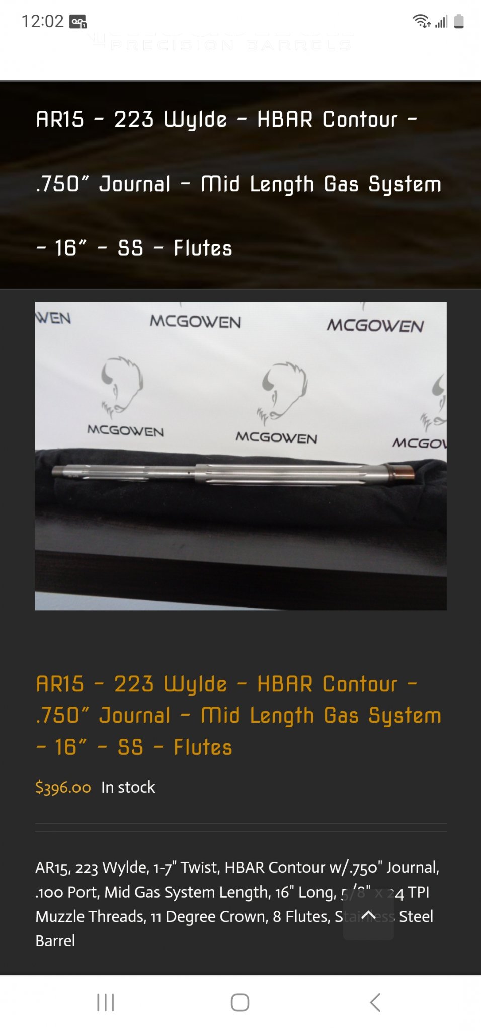

This one? If so that's some awfully shady stuff they're pulling. Glad I found this thread, and others, before I made an order with them. I'll stick with WOA I guess.
I'm about 5 weeks out from the time I mailed my barrel back. Never had any sort of email or phone call to let me know what they were going to do. I included a letter outlining the issues and asked for a replacement. Out of curiosity, I went on their website a few minutes ago and checked the in-stock barrels. Yep, there she was, the barrel I sent back. Unbelievable. I kinda wonder if they've sent this thing out multiple times hoping it would stick. I did receive it rather quickly, well below their stated delivery times of 6-8 weeks, so it makes me wonder.
Wait....5 weeks after sending it back in with their approval to do so, its listed for sale on their site, and not a peep out of them at all?

Yep, that's the barrel. I've been absolutely slammed this week and haven't had a chance to call them and discuss. Should be able to give them a buzz on Friday and see what's what.
But I've had no communication from them since I sent the barrel back. No mention that they're fixing, replacing, telling me to f*ck off, zilch. I mean I suppose that could be a different barrel but I seriously doubt it. Literally the same specs I ordered.
Yeah thats a fairly uncommon barrel. Not many people order a 223 Wylde with 5/8x24 thread. Get your money back boss.
5 weeks....5 WEEKS....and they are trying to sell it to some other schmuck
