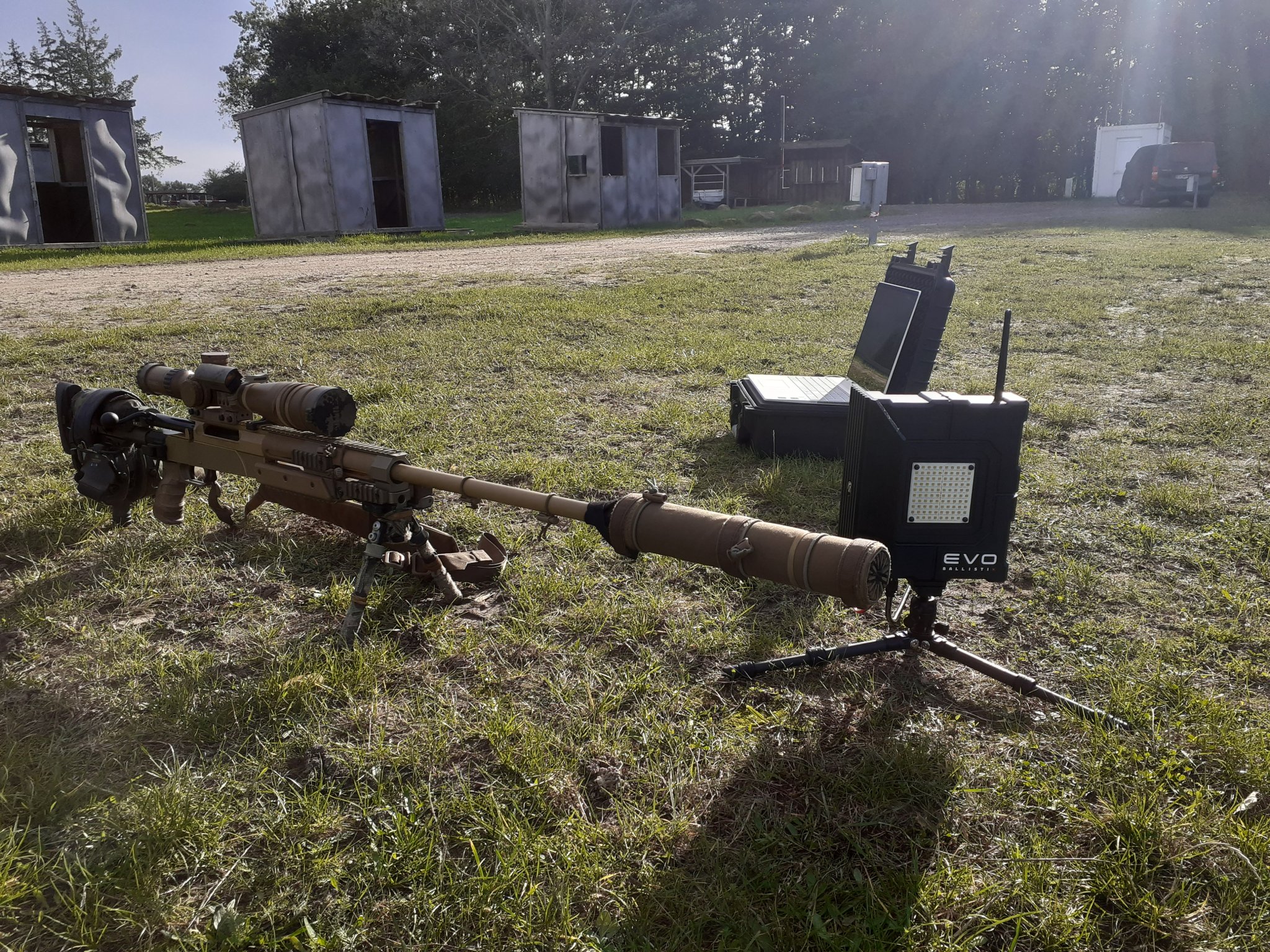

The EVO is an very interesting device and yes, the ColdBore Range crew has aquired one, thanks to a VERY substantial contribution from one of our sponsors :cool:
In fact, the EVO is not comparable to the LabRadar, as it is a professional device and is designed to assist in the development of ballistic data on small to medium sized projectiles, just as the Infinition and Weibel radar systems ( we had both of them on test, as the ONLY private / civilian company... ).
The ColdBore Range crew will be doing a lot of testing in the forthcoming weekend, both on known projectiles plus some new monolithic designs and some of the German shooters will bring their experimental bullets to get them tested.

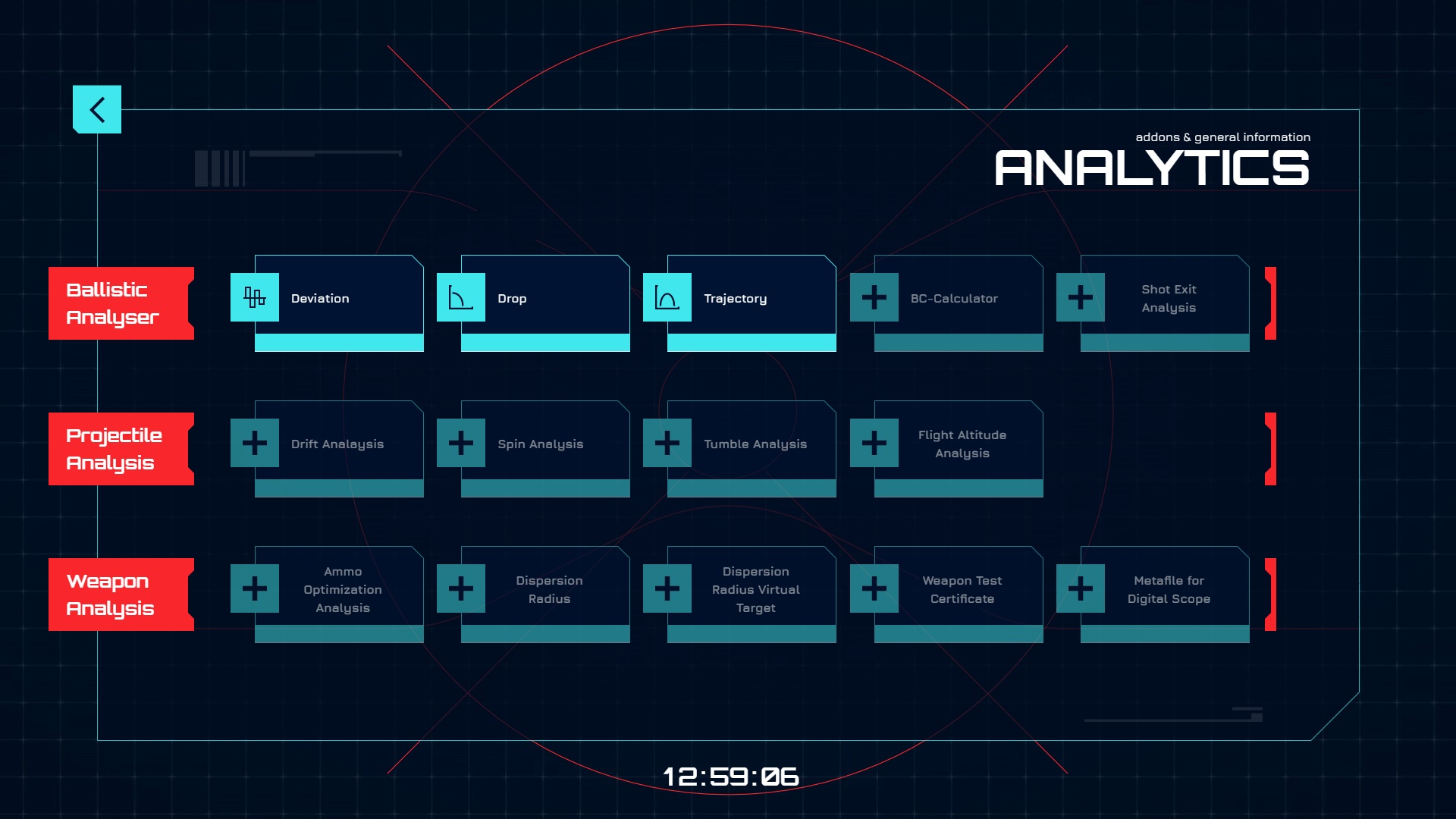

From the source: (their sales engineer)
Due to the modular design of its features and functions the price ranges from 15.000 to 25.000€ depending on module choices and if the expert software is purchased.
This was in one of the attachments:
Pretty bad ass system on paper.

Can you tell us what happened during the test?
Yes: The system turned out to be VERY sensitive and could deliver some very detailed reports on the bullets used.
But, the sensitivity turned out to be a disadvantage, as every movement of grass and trees on the range, was detected and thus, interferred the reports.
The tech-guy from the company was quite baffled and had to admit, that this was the first time his system was been tested on a open range ( it was the same problem, when the Weibel system was tested ) and he had some issues in the software, to solve.
But overall, the system seems promising and more real-life testing are in the planning.

Thanks for the report, please keep us updated. Talking price, do you think uch a price tag is somewhat justified?
I really can't tell.
One thing to be considered, is that the EVO is NOT a standard consumer product, but is made for the professional segment and the pricetag are corresponding this fact.
But for the ELR folks, this is a incredible tool and all data obtained during the test, turned out to be valid out to 2400 meters.
Due to the weather, it was not possible ( very misty ) to shoot the two mile target, this day.
