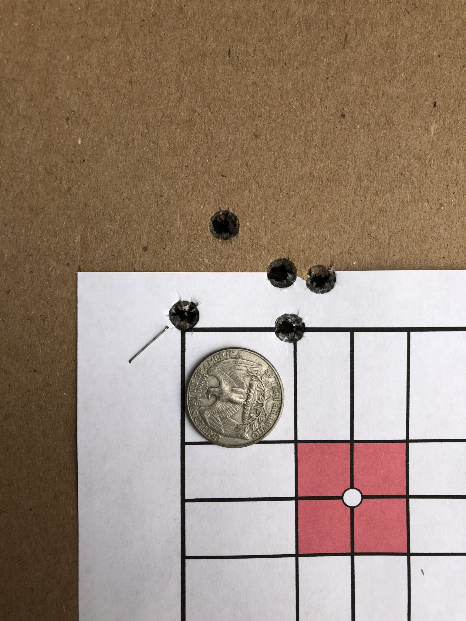

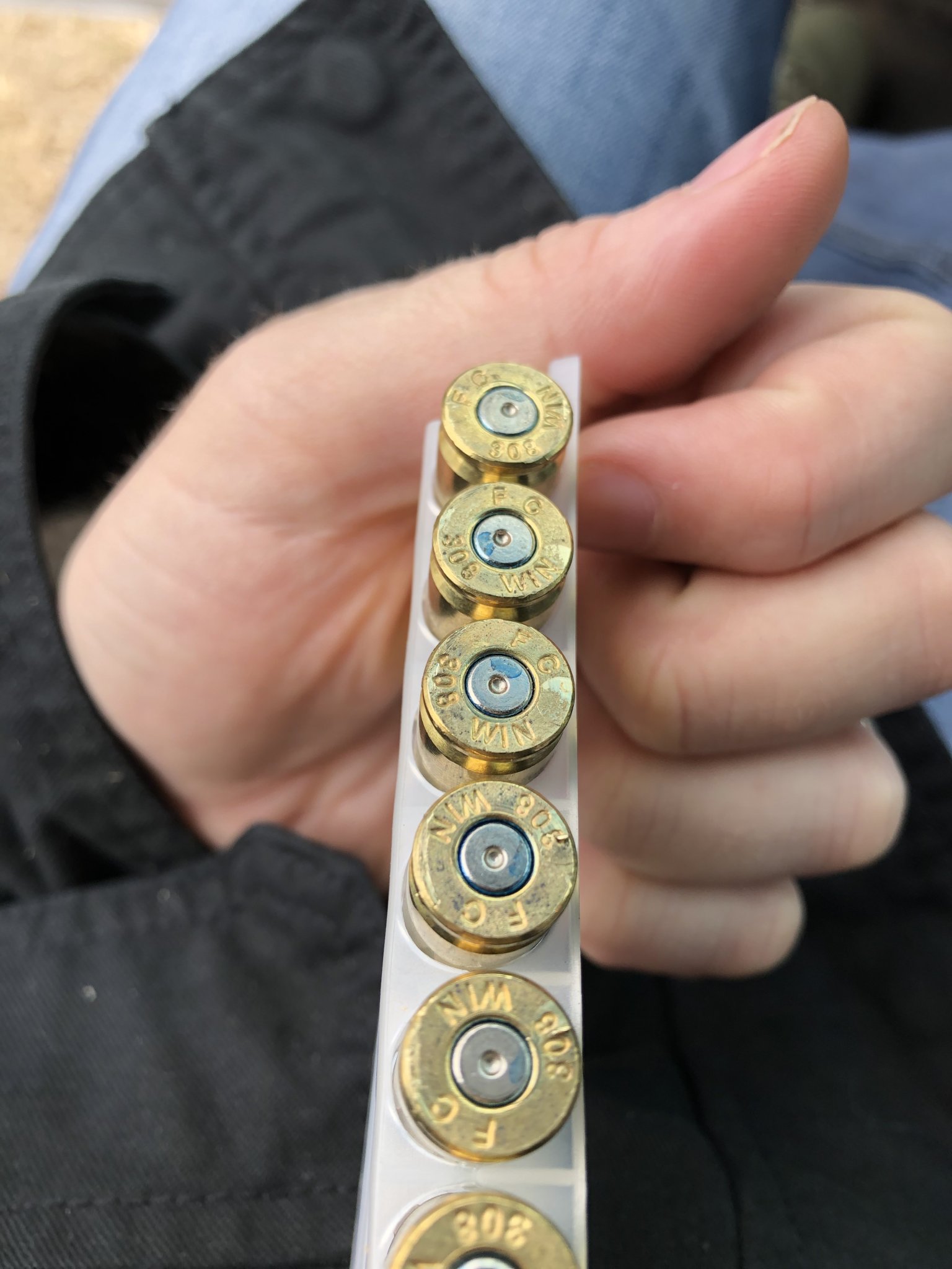

Well, I took my rig to the range. I elected to shoot the federal GMM first. I shot a 5 round group and it landed a group that was bigger than desired (see image 1). When I looked at the brass, I could see clear ejector marks (see image 2) again, this was factory FGMM.
I have found pressure signs on my hand loads in the past but have discontinued at the first sign. Noteably, I have gotten pressure signs at what I believe to be rather modest charge weights.
I contacted rainier via message, I hope to hear back soon. I’m a little disappointed that I’m having an issue, but I’m not going to be very quick to blame rainier. The good news is I will be able to test the quality of rainier’s customer service.

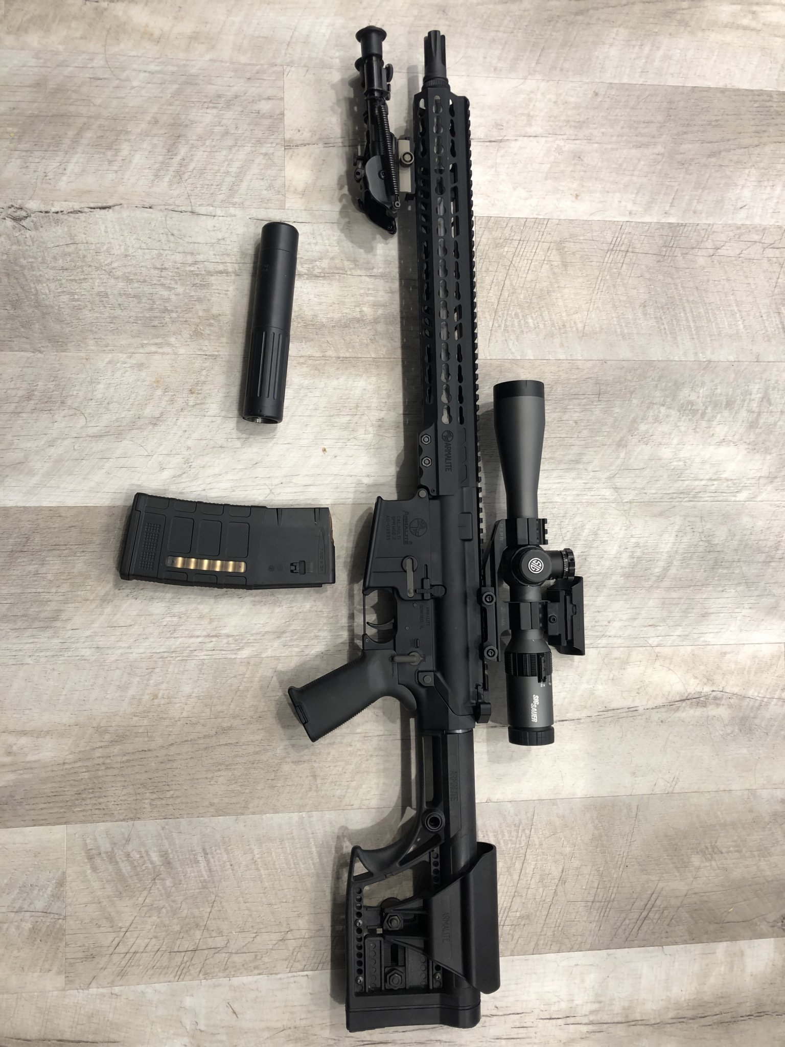

A few points: the swipes on your brass can easily be tuned out with adjustable gas block, buffer spring weights and buffer weights (@padom has discussed this a ton). Your bolt is unlocking a bit too early and case is still under pressure causing bolt to rotate around brass during extraction, this causes swiping.
If running your rig suppressed (just a guess due to suppressor in photo), shoot it without suppressor to see how it does. Suppressors dramatically increase dwell time and back pressure in case causing extra swiping if not tuned properly.
If you are running a new bolt head, it's more than likely that your bolt has very small burrs that will increase the appearance of swipes.
Your primers look fine: no flattening and no cratering.
The one group or even the first 50-75 rounds from any new build or barrel (specifically semi-autos) doesn't really say much about barrels capability. I don't bother too much with precision for the first 50-100 rounds simply because it takes time to uniform.
My 6.5 CM gas gun showed the same swipes you have for the first 200-250 rounds before calming down and being non-existent. I tuned buffer and gas block (which helps a lot) then shot gun to smooth bolt.
If your 16" barrel 308 can shoot ~1" with factory ammo within the first 50 rounds, it's doing really well and I'd keep shooting it. Almost certainly nothing Rainier did/can do to fix what you are seeing.
I appreciate the points. I went ahead and ordered an adj gas block. I will get that on, then reassess for the buffer. Which buffer did you end up settling on?
I’m not running it suppressed yet, I planned on getting everything running correctly before giving that a try. As for the bolt, the barrel and bolt were both purchased together through rainier at the same time so they would match them.
