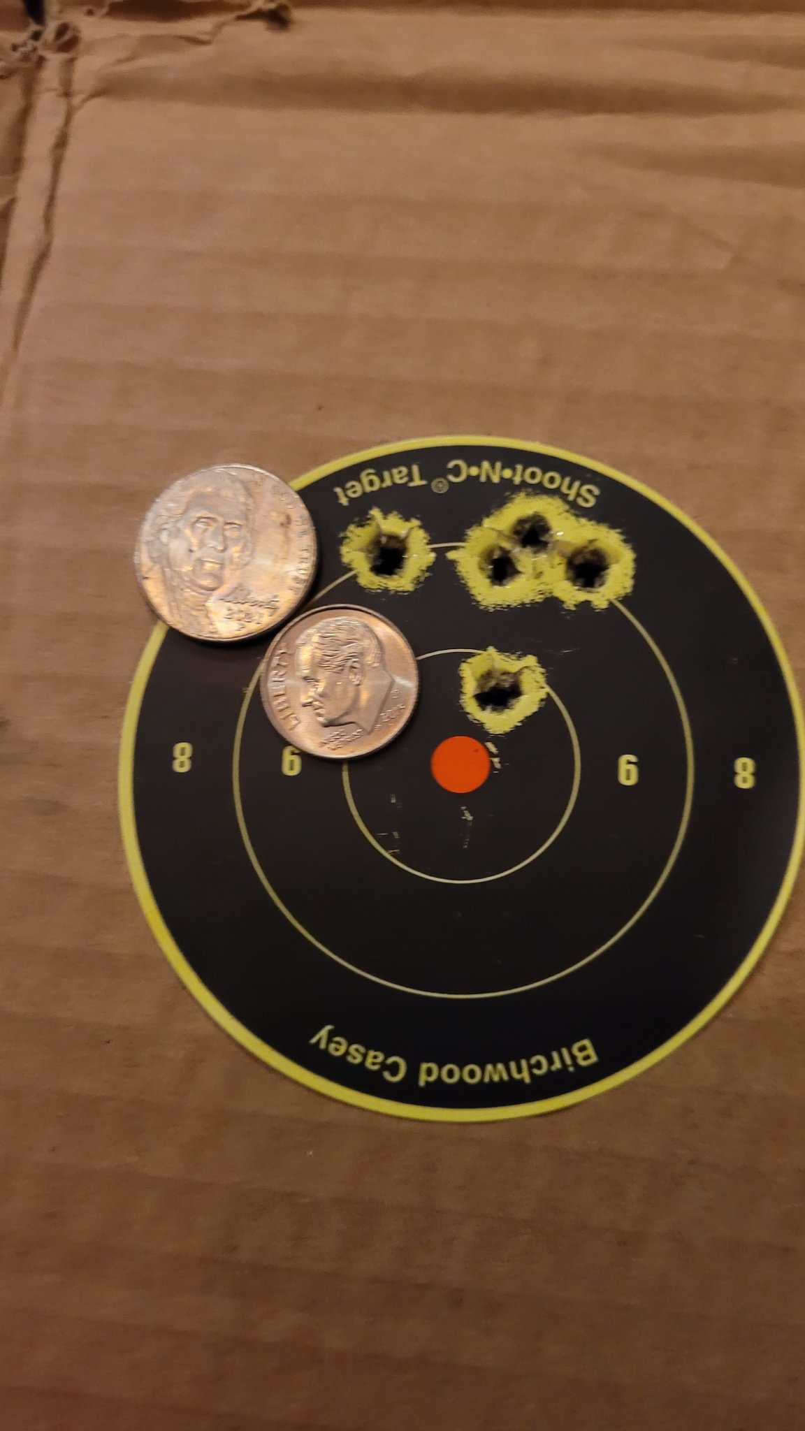

I'm general the best I've ever got it to shoot was with 77 grain smk Sierra factory loads then it was what I would call 1 moa, several. 75 groups ranging to 1 1/8 -
1 3/16" groups, all 5 shot groups es measurements at 100 yards..... I've been told 1.5 moa out of a budget ar and match ammo is all you can expect, but then I hear about how all these guys have budget ar's that shoot sub moa all day etc...... Most the guys I see shooting at range shoot about 1.5 to 2 inch groups.... And they seem happy, I like to just consistently stay at .75" even an inch and I'd be happy honestly, I can shoot these groups but then they open up randomly, poi is the same 90% of the time ...

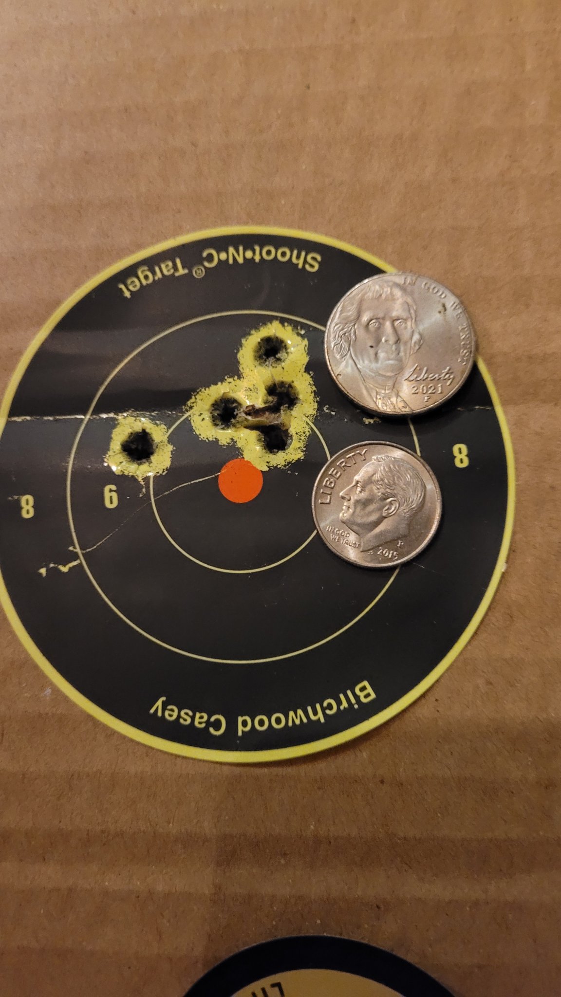

This was best I've ever got gun to shoot with Hornady 75 grain bthp match and seirra 77 smk factory ammo

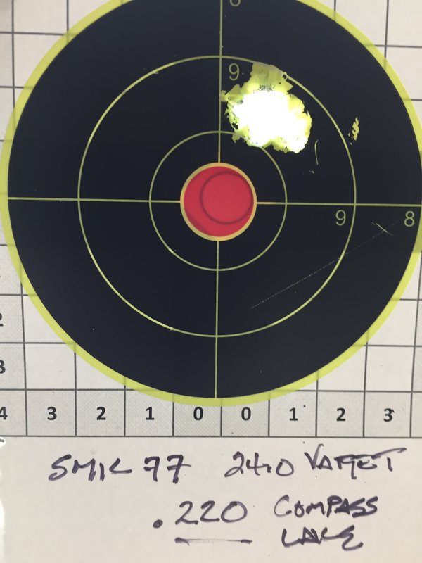

My first AR was an FN, not a bad factory rifle. Best I could get it to shoot was 1-2 MOA - usually 2-3 MOA.
Next was a Compass Lake with Krieger 20” rifle length. 24 gr Varget and SMK = consistent 1/2”.
Ordered another carbine 16” Krieger - consistent 1/2”
Moral of the story - quality matters, especially the barrel.

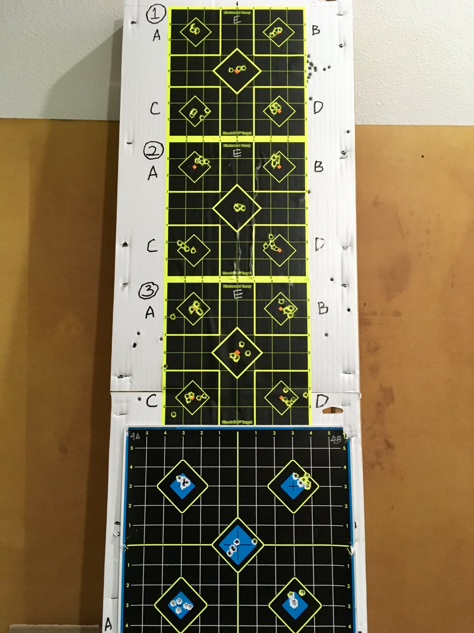

I have a CLE AR 223 that will do 1/2" no problem, but again that's a very good barrel and an AR built for precision.
5 shot groups
Factory HK MR556
77gr smk
range picked brass
cci 450
varget or rl15 (I don’t know, gotta check my book)
sized and seated to SAMMI (nothing fancy for this ar)
on a Dillon 550

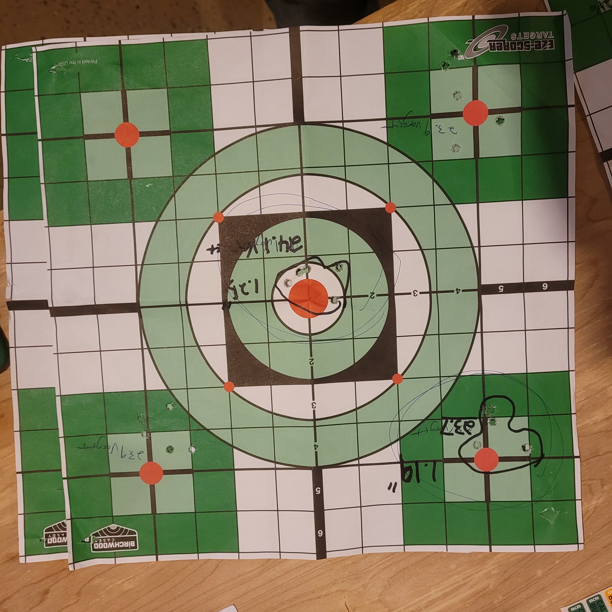

Just shot again, I'm pretty disappointed, nothing changed, load is the same, everything's the same, yet my groups opened up to 1.75 and 2 moa...... I haven't cleaned my barrel in about 500 600 rounds, but I can't believe that would do it, I have read enough now I'm scared to clean due to damaging the crown..... I have simple 3 piece rod I've used forever n clean with jags and patches but no bore guide n no Dewey 1 piece rod...... I have read you run your barrel by cleaning it too much....... I also tried the whole thumb on the right side instead of wrapped around the grip deal and it feels weird as hell..... I don't feel as comfortable with my trigger pulls.....maybe cuz I have been shooting with thumb wrapped for so long? I wonder should I even keep trying it if its not what I'm used too...... I'm not seeing any advantages either if anything I shoot worse but I'm trying to maintain precision fundamentals.....
