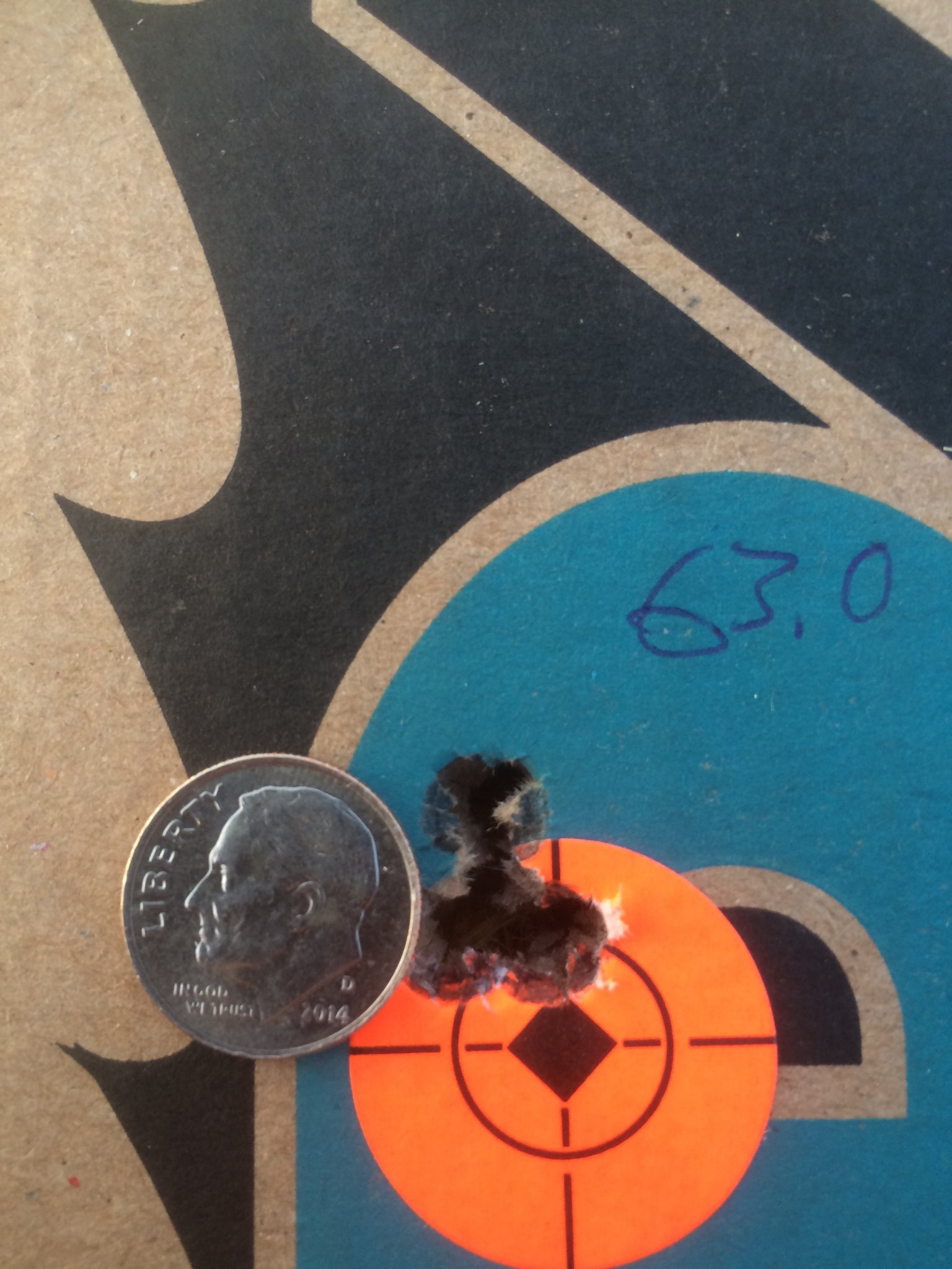

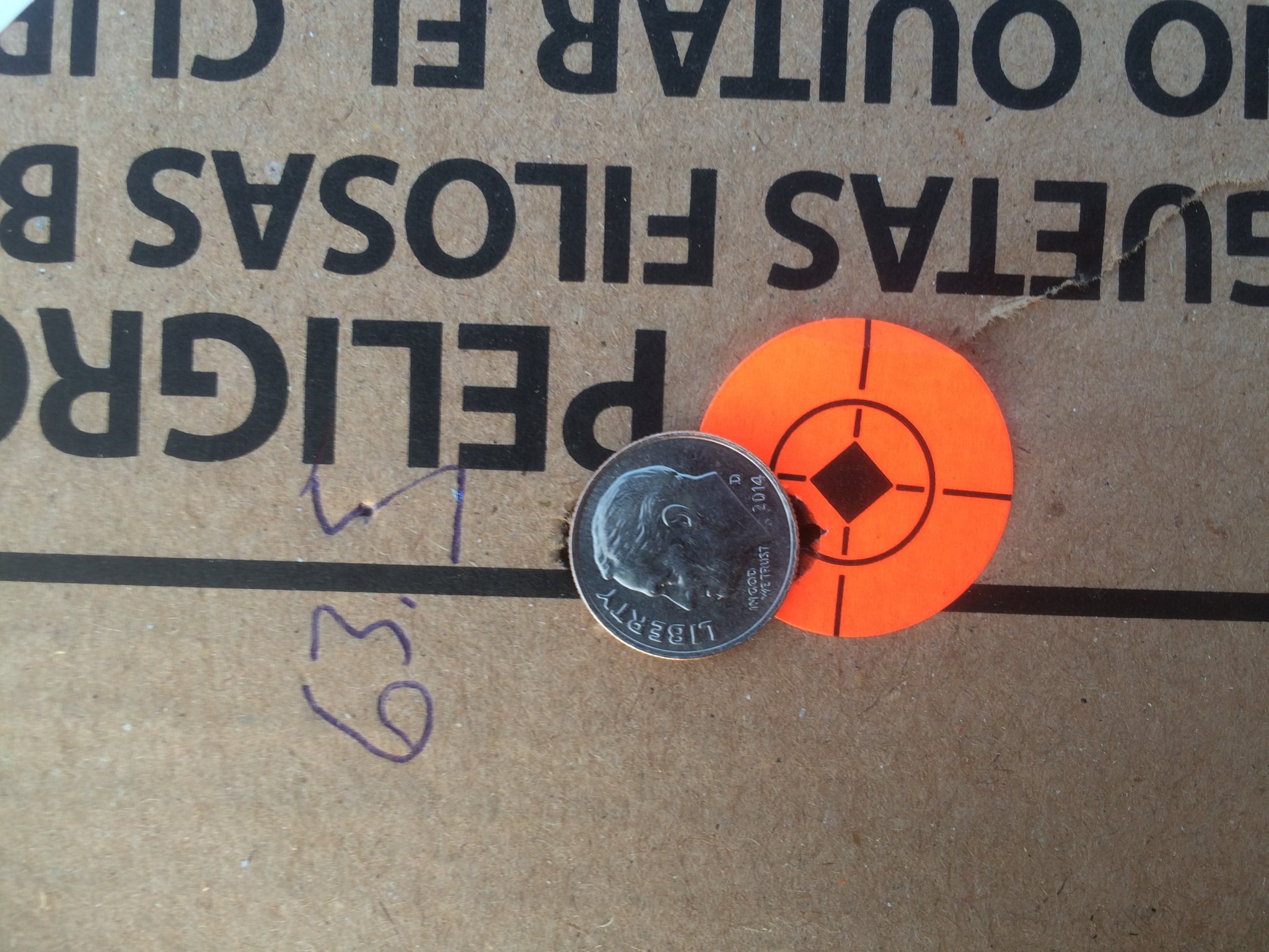

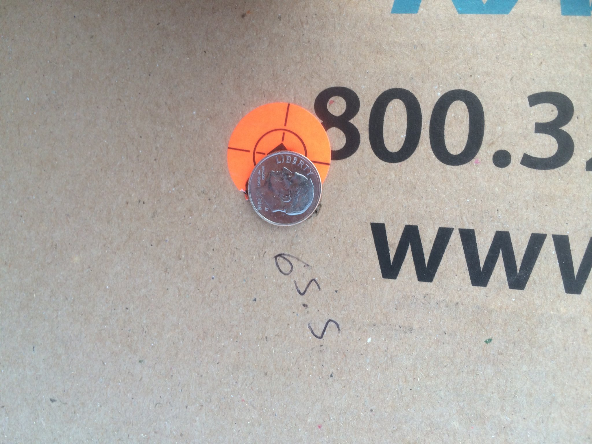

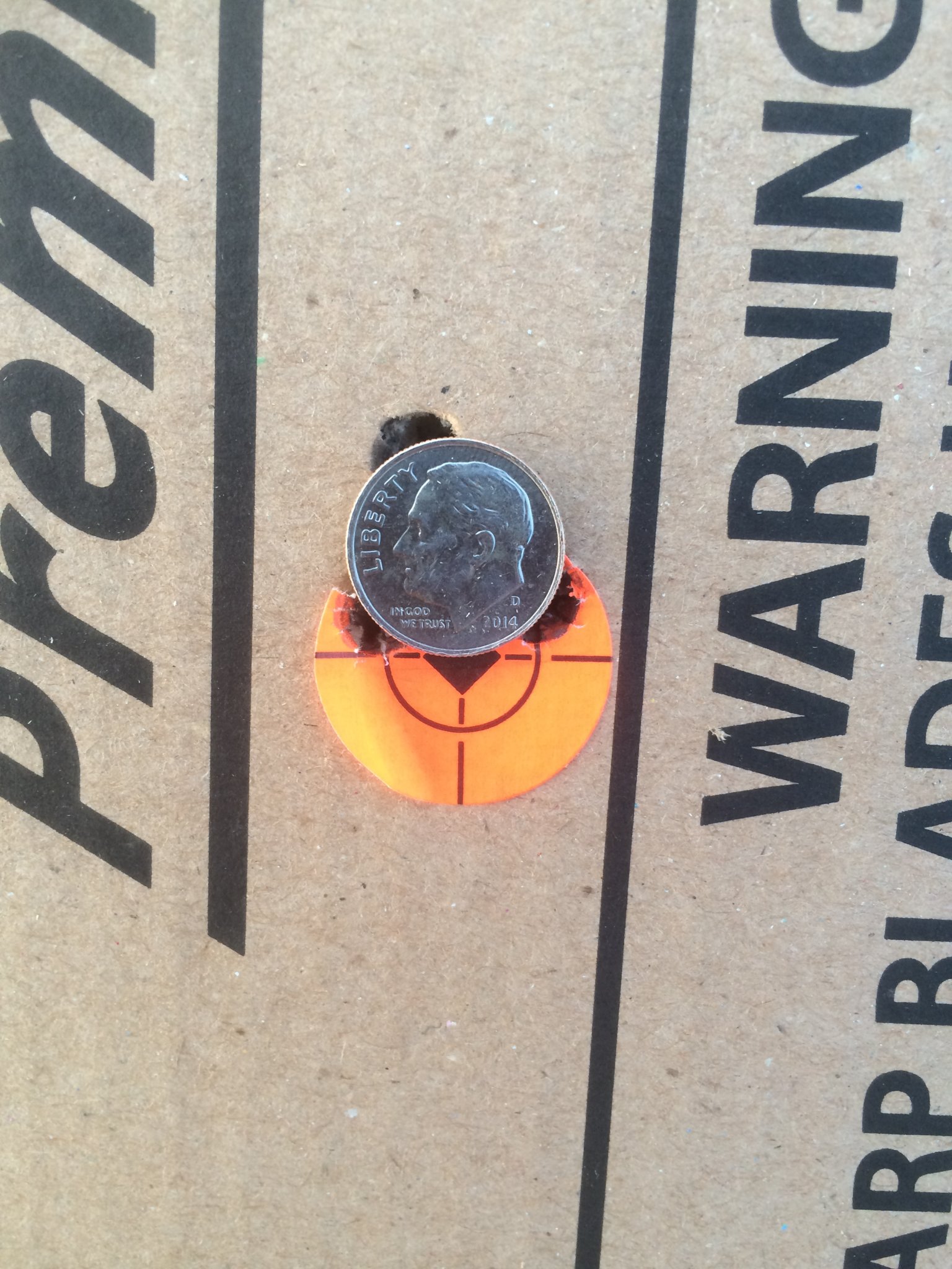

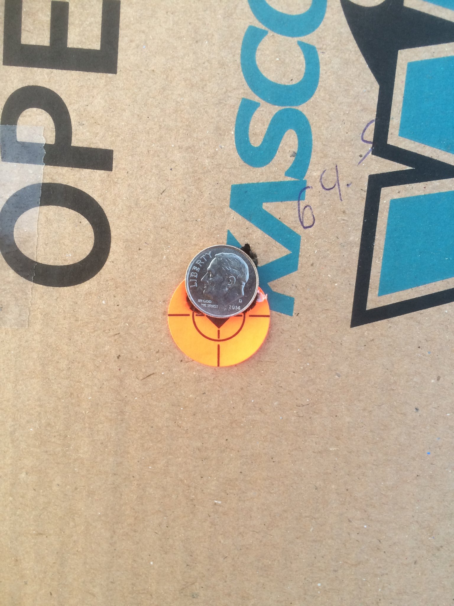

Below is the load I currently run. I used a lower load with mine as I wasn’t looking to get the highest velocity.
63.0 grains of H4350
200 ELDX .030” off lands
2716 FPS Suppressed
Not suppressed
Same Load/Rifle with suppressor
Reactions: Stewy151

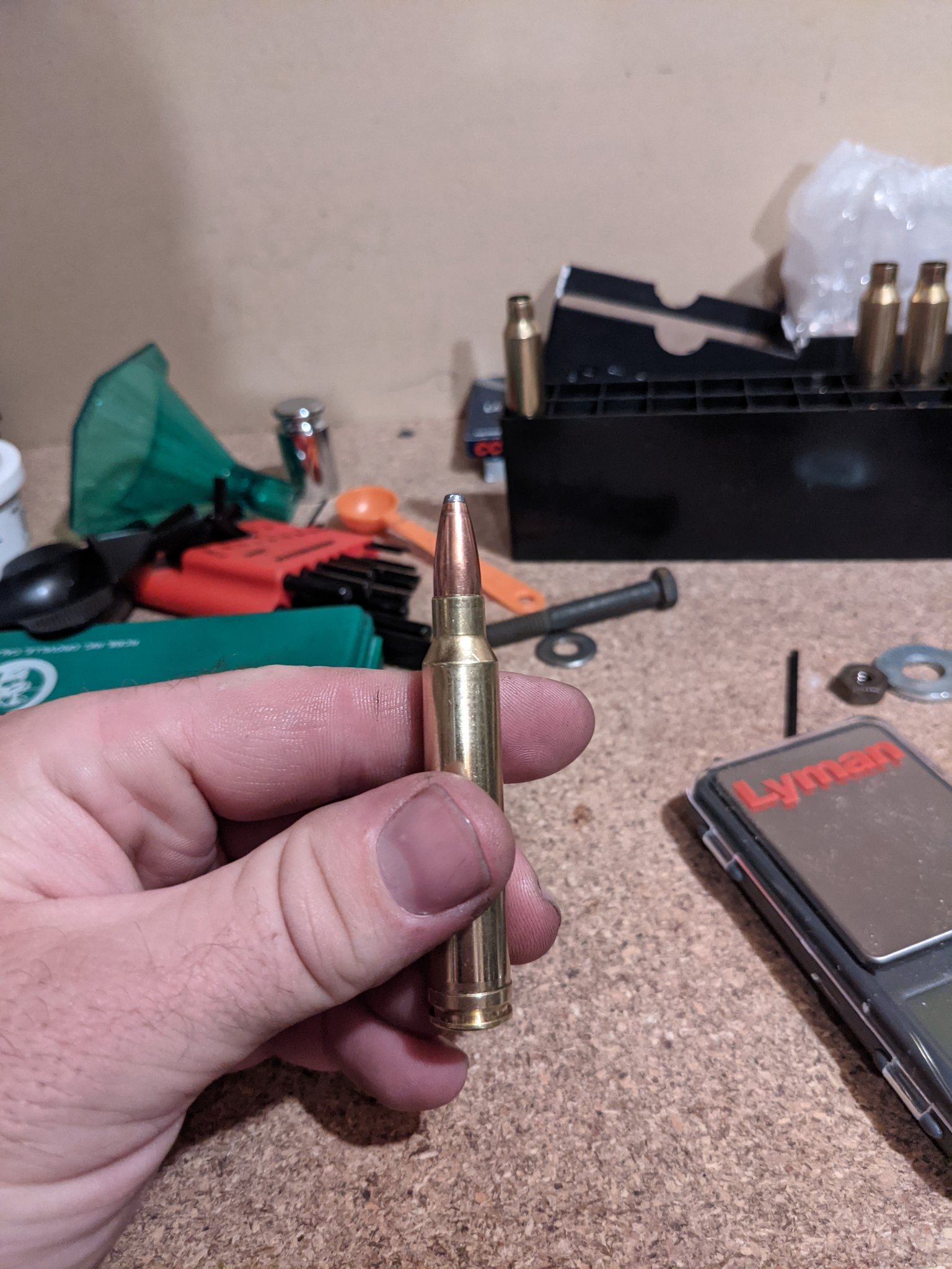

Loaded my first 4 rounds last night. The first one I need to get a bullet puller and redo I seated .007 to deep.
Load data said 69-73 grains of h4831 sc I went with 70 grains.
Run the 180 grain partitions
And 250cci primers. Hopefully find out this weekend if I screwed anything up lol

Yeah, the e-tip is a solid bullet. You are better off using data for the speer which is a jacketed lead core bullet. Brand means nothing, bullet construction and length is more relevant for extrapolating load data.
One said 67-72 grains one said 69-73 so I went 70 so I was in range with either the col is the only thing I'm worried about nosler shows for the partition 3.210 with a max saami of 3.340 the data on hodgdon shows 3.285 which is what I went with but the difference from the recommend on the partition makes me nervous
For a 180gr jsp like the nosler partition using h4831 your starting charge should be 70.0gr loaded to standard oal of 3.340”, max charge is 76.0gr which would be a compressed load. 70.0 would put you around 2675fps with a 26” barrel. Of course thats an approximation.
Awesome! Thank you. I will need to pull my bullets and reset oal. I appreciate it
