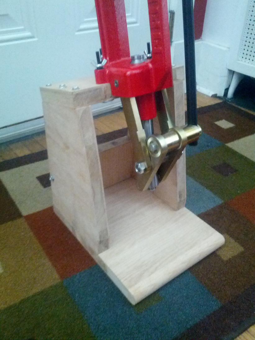

FYI for anyone making a stand for a Lee Classic Cast press. I don't think that it needs much, if any, additional clearance than the original plans call for here: Portable Reloading Press Plans | Precision Rifles & Handloading
I measured my press and the piston and swing linkage clearance appears to be the same as the rockchucker. To be on the safe side, I used 10.5" side height in place of the original plan's 8.25". I kept the remaining dimensions roughly the same and I have at least 3" of excess room under the piston and swing linkage. I used 9x11.5" for the base and have more than enough clearance for the lever as well. If I were to build another one, I wouldn't go more than 9.5" for the side height.
[Please excuse my poor woodworking skills displayed in the pic.]
