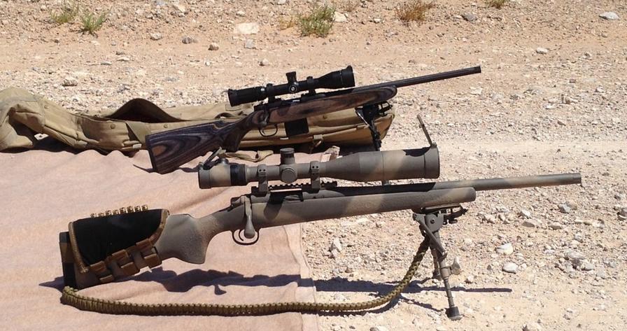

Did some upgrading with good results. Added a Mcmillan A-5 stock, Hook Creek Industries Bolt Knob(JB Weld, sandpaper and spray paint), and a Harris 6-9 bipod. Not that it wasn't accurate before, but I noticed some inconsistency's. Probably because of the hogue stock. Sometimes I would group OK and others was excellent. Not to say that it wasn't me, but the stock didn't help 'I'm sure. Now with the upgrades I can definitely see a difference in consistency, and comfort.

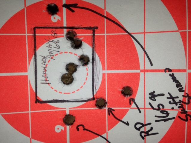

I think I found what my SPS likes!

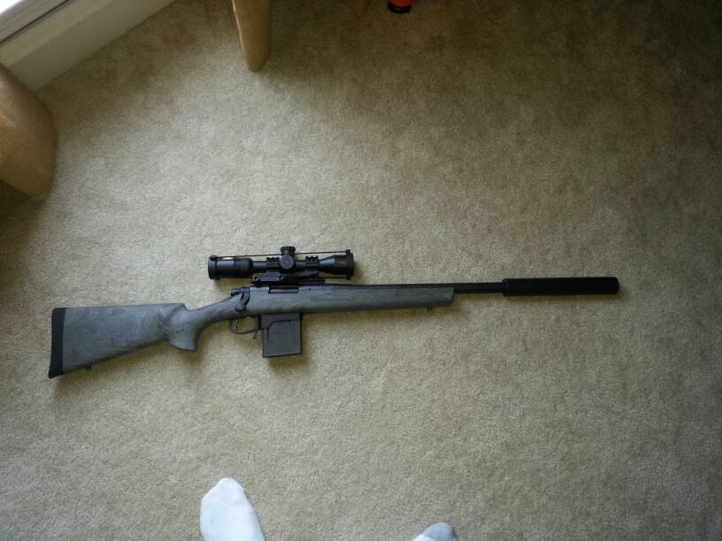

Here's my little 300 BO that I've had for a month now. I did a few mods to it. It's spits out that crazy ammo pretty good.
Heres my pig hammer!
300bo

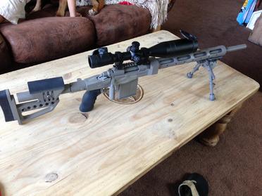

I bought my AAC SD a year ago as my first precision rifle. I mounted the same scope With a NF 20MOA base and medium rings and was pleased with the accuracy out of the box. Replaced the stock with a McMillan M40 stock, installed a PTG bolt and a Timney trigger. Love this gun.
