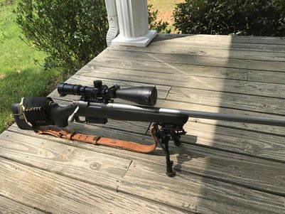

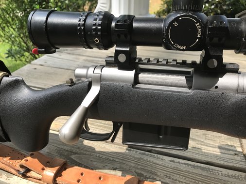

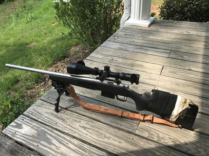

Savage 10 BA Long Range Hunter 6.5 Creedmore.
I handload, and would order mine chambered in .260 Remington.
But really, I would buy a Savage 11 VT .308, rebarrel it with L-W 28" drop-in chambered in .260, and add the Choate Savage Tactical stock (for 4.4" center feed), and could add an aftermarket Karsten's cheekpiece. Less money and precisely the right rifle with a good barrel.
I already have the rifle, a barrel, bipod, and stock, and other bits are on the wish list. With this stock and my optics, the cheekpiece is not needed.
Greg
