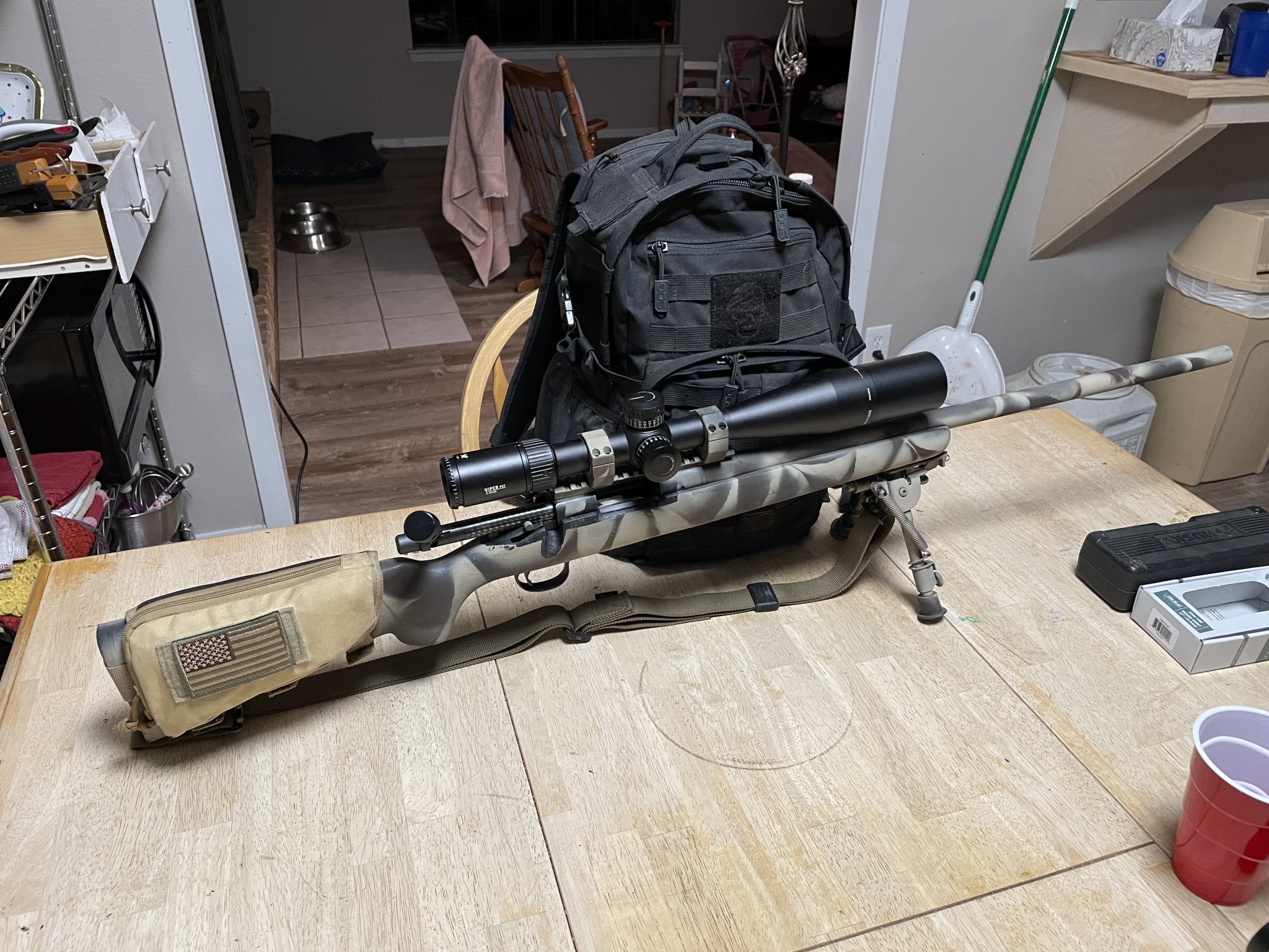

I dropped my Vortex PST Gen2 on it on a 20MOA mount. I have to have one of the receiver holes drilled because the mounting screws that were on it were rusted in place. Otherwise, the internals are brand new. I painted it and built up the cheek piece a little. Also put my bipod and sling on it. I’ll post pics as soon as it’s permanently put together. I plan on bedding the stock, but I don’t want to do any other mods to it.

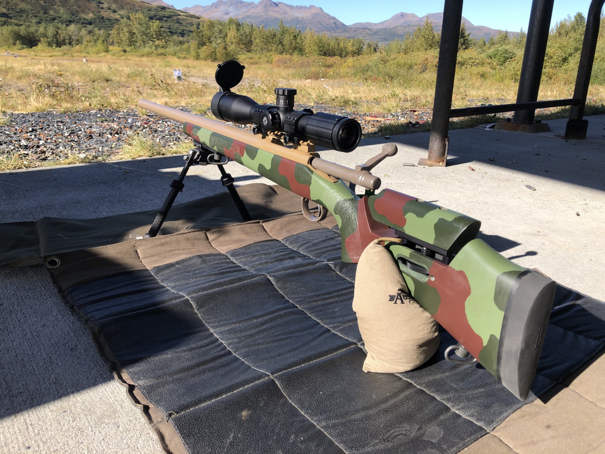

I feel that this thread is useless without pics. So, heres my R700 in .308 Win. with an M24 barrel and McMillan stock. ;)
Excuse the condition of my kitchen. It’s being remodeled at the moment. That’s about $10 worth of spray paint 😂

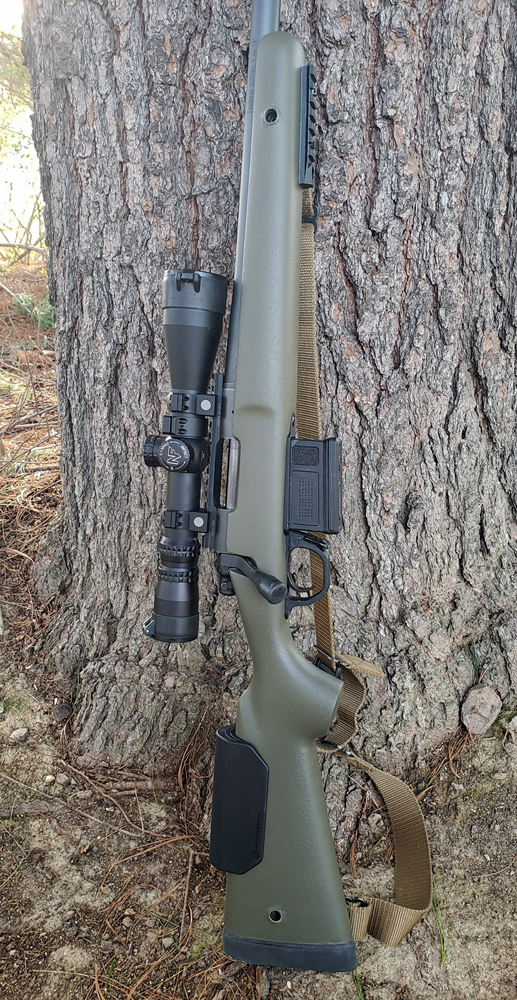

The Badger bottom metal will need to be inlet to that stock, which involves opening up the footprint in the stock and reducing the pillar depth. Badger Ordnance, GAP, and a host of other smiths offer the service for a relatively small fee.
That being said I installed a Magpul Hunter DBM into a HS stock that didn't require too much work if you're handy with a Dremel. Also doesn't require any changes to the pillar depth, just opening up the footprint a little bit.
