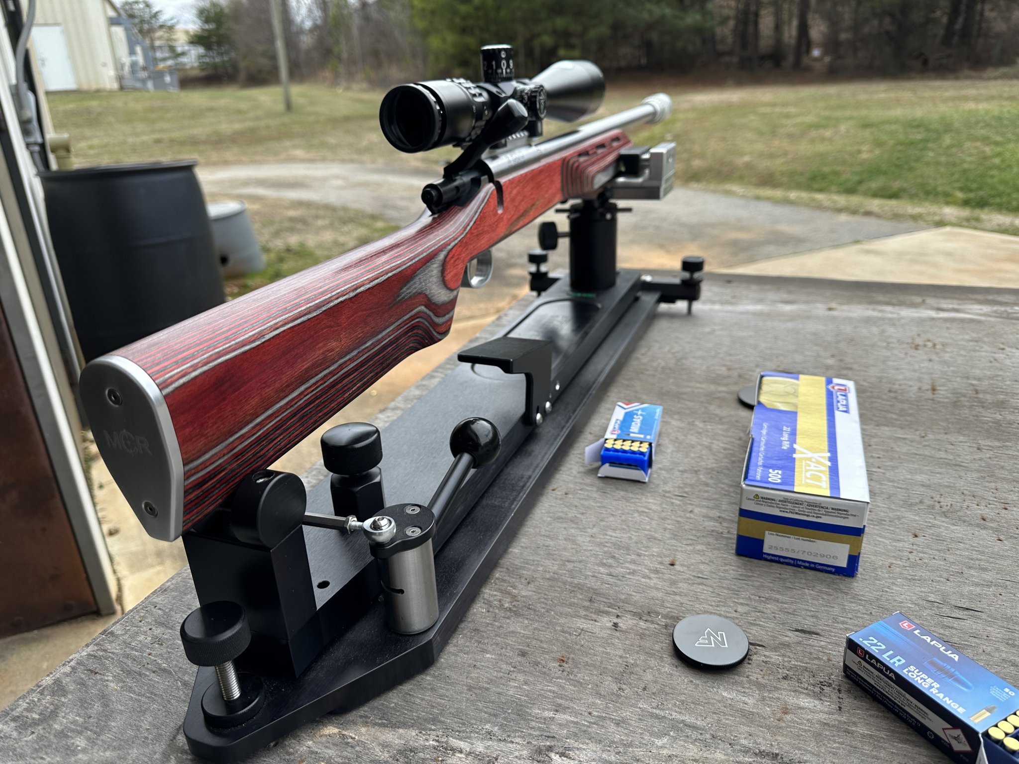

    Made my mind up on what glass I'm going to put on this RFBR setup...
    Shout to to Tyler @ EuroOptic for a smoking deal and super fast, smooth transaction. Ordered yesterday, arrived today.
    Curious why you chose that reticle for BR?

    I guess times have changed. When I started BR I was told FCH or FCH w/small dot. Still use small dot.
    That's not a reticle option for NF comp 15-55... or I would have taken that floating center dot with subtensions gladly...
    I'm a floating center dot fan, but the DDR2 is very limited.. thats why I went with this FCR1

    I was referring to fine crosshair.

    I have that scope and like the cross hair. I am seriously looking into the Atlon Eres Etr UHD 15-60x56 BLR1 SFP IR for my other RIM X this year. I can't find anything better at the price point. This has been getting great reviews.

    I've read some recent tall about that Athlon. At $1000 I'm sure it's a decent 50. Not gonna be as clear as a NF, SV, etc... if it's same glass as my Ares ETR 4.5-30 but get the job done.
    I run Athlon Cronus HD Gen2's on my RimX and it's glass is equal or slightly better than my Gen2 Razor with the APRS6 favored floating dot reticle.

    I could be wrong but I think that this particular ETR 15-60 is basically a G3 Athlon scope. I got one last year for Field Target comps and the very first thing I noticed is that the IQ in it is quite an improvement over the ETR 4.5-30 I had before which has decent IQ but not as nice as this new 15-60 does. In fact it has nicer IQ than my G2 Cronus 4.5-29. I did a side by side of those two scopes and my S&B PM2 5-25 and this 15-60 is right up there with the S&B when both are at 25x.
    Also part of that might be that this ETR is SFP so less lenses but no doubt the lens coatings do a great job.
    Nevertheless I personally know some of the top airgun FT and BR shooters in the country that are amazed at the glass in this scope as compared to their expensive target scopes.
    Also at one point later on I had it next to a Sightron S3 10-50 and the ETR had more contrast.
    Though it only comes in MOA I do appreciate the daylight bright center dot and the half MOA hashes.

    That's awesome. I reached out to Doug about grabbing one to test. Although I got this NF mounted up today and threw it on my CF BR rifle to get behind it and man this thing is crystal clear and crisp. Excellent color depth. I'm very impressed, I may just grab another one of these...
