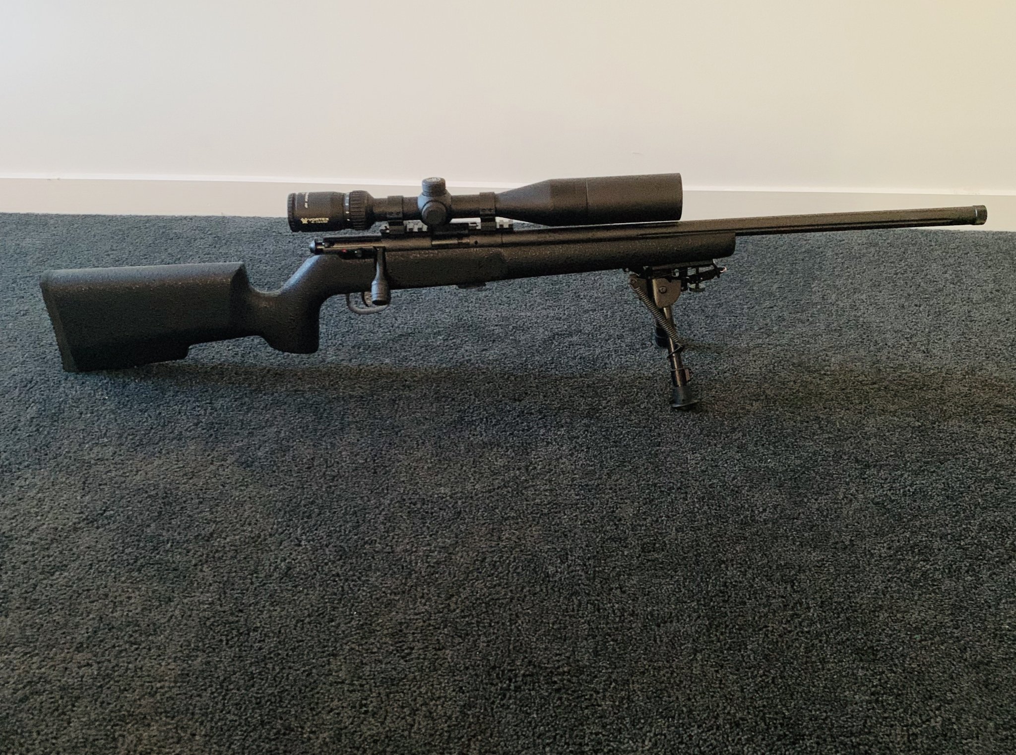

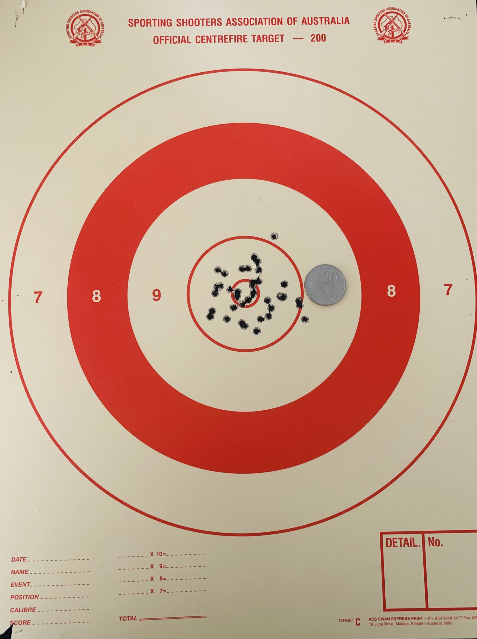

Hey guys, long time lurker first time poster. Im from Australia & have just sighted in a brand new .22 Savage TRR-SR with a used (but great condition) Vortex Diamondback 4-16x42. I mounted the 25 MOA rail & scope myself & used Leupold PRW2 low rings. I sighted it in at 25 meters then 50 meters & finally 100 meters using CCI standard velocity. When I was happy with it I put up another target at 100 meters which is the one pictured (20 cent piece is there for comparison). It was a bit windy which was a shame but this was the result. Ive read the aftermarket DIP bottom receiver kit is a great upgrade for these rifles & will tighten groups so will be ordering one soon. Im also keen to run a few different brands of ammo through it including match grade to find out what it likes best. I would love to eventually step out to 200 meters with this rifle on a good day. What do you guys recon about the first shoot & do you any tips on improvement?

I have a Savage MKii FVSR in a Boyd’s stock. Basically the same exact rifle you have with a 16” barrel. It is very accurate. The biggest thing that will make a difference in the accuracy is the quality of ammo you feed it. The only issue I have ever had with mine is the magazines. The Magazines Savage uses are total crap. Once they start to get a little warn you will have problems. Go ahead and do some research on how to fix the magazines because eventually you will need to. Magazines aside the MKii is one of the most accurate 22’s I have ever shot straight out of the box. I don’t know what Savage does but they defiantly do something right when it comes to their barrels.
Reactions: tinman52
I have a BTVLSS that shoots great but it took a few hundred rounds to settle in. The heavier bottom metal will make for a more solid foundation, I made mine out of 1/8" SS. Also try different torque settings on the action screws. A Rifle Basix trigger will make a huge difference over the factory trigger, at minimum install a Apachee trigger kit.
Thanks for the heads up on the mags Eoddave27..Ill definitely look into the issues they have. Ill grab a few different types of decent match grade ammo & head back out to the range Saturday morning.
Thanks 1badDart, Im going to order a thicker metal bottom receiver kit as soon as my import permit gets approved. Ill also have to get a torque screwdriver to make sure I do it properly instead of just guessing. Will also look into the trigger, thanks for the tip.

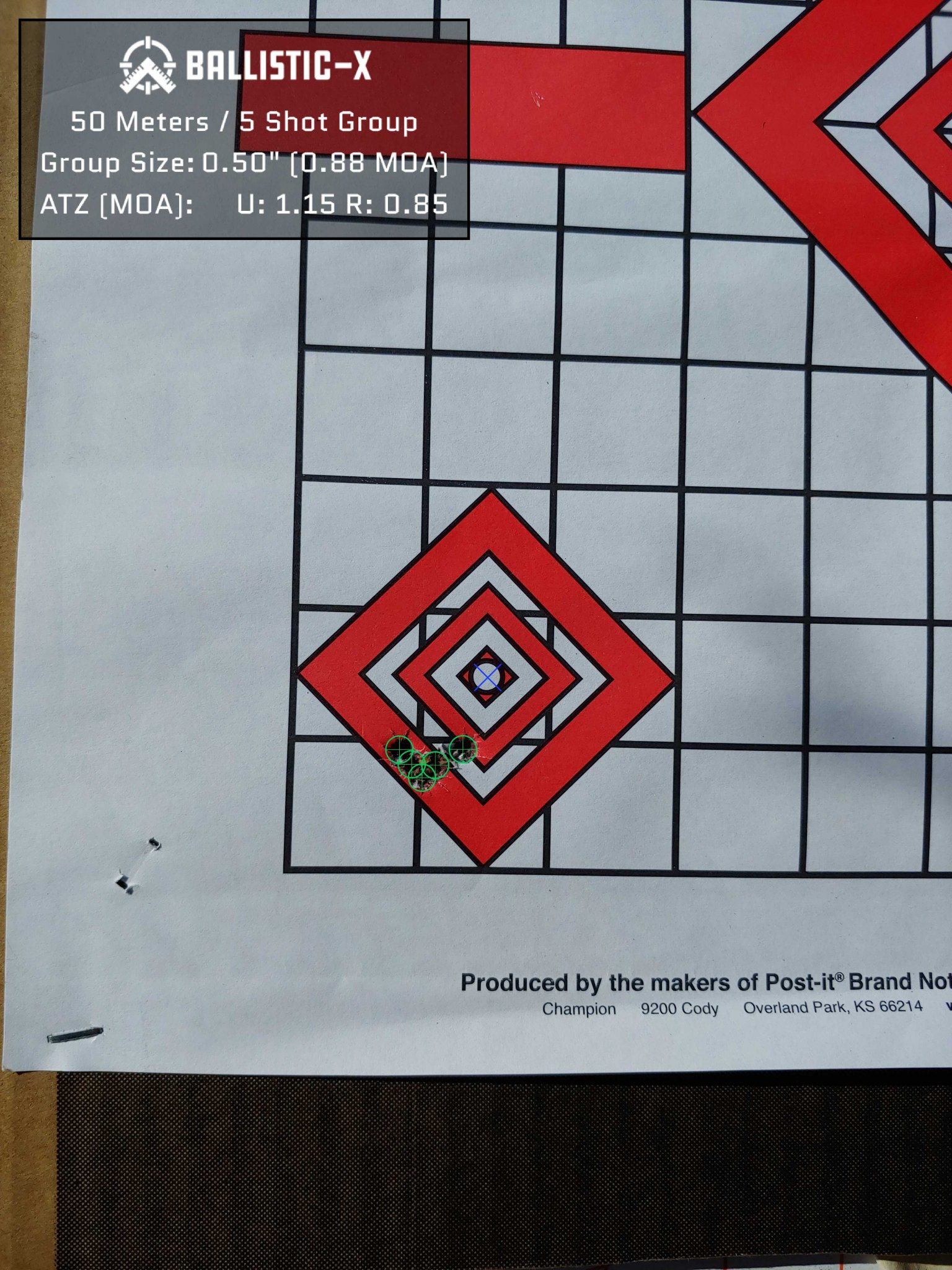

Here it is with Eley sport, action screws torqued to 40 in. Lbs.

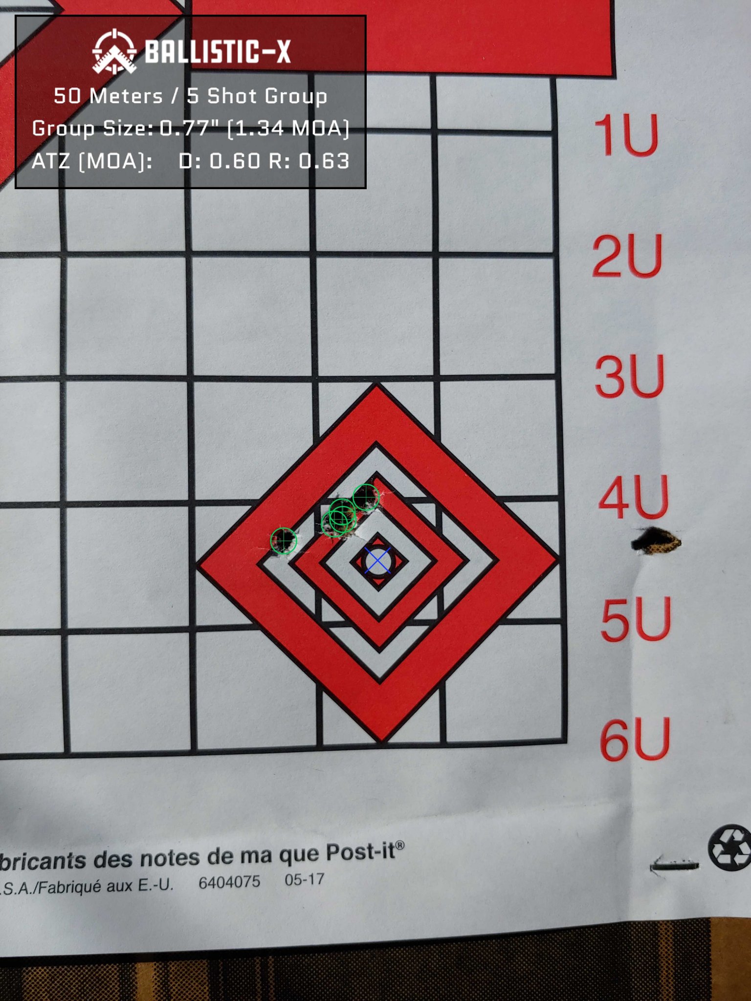

This is with cheap Winchester super x (x22lr) same torque value
My only gripe was changing to the thicker bottom metal changed my grouping with the Winchester super x. Shot like shit after. Hope it doesn't do the same in yours, I'm not too upset though, only a bit because super x is so cheap
