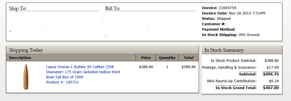

    Since everyone thinks I am full of shit, here is a screen shot of the invoice from Midway.... Notice the price is $111 less than their price on their website.
    Lapua Scenar-L Bullets 30 Cal (308 Diameter) 175 Grain Jacketed Hollow
    So yeah, I am pretty sure I bought a box of Scenar-L's on clearance from Midway. Maybe it was the end of one lot and they just got a new lot in and did not want to mix them??? I have no idea why it was on clearance.
