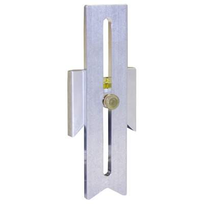

check out Arisaka's scope leveling tool. simple and elegant, all mechanical.
I have their 3 piece set. I picked up my Bergara B14R today and installed the NX8 using the wedgies. Makes for a very quick job, I ran a thin cord through each piece to help keep the stuff together,
Yeah... if you want to level the scope to the rifle, then I haven't found anything better than a deck of playing cards or some feeler gauges from hardware store. If you want to level scope/reticle to gravity (because you cant the rifle when you shoot), then get behind the rifle and use a plumb line. No special tools or gadgets are needed in either case.
The Arisaka tool is something commonly used by machinists and engineers. And it WOULD be a good option except it doesn't fit under any scope I've ever tried if your action has an integrated rail, which most do these days. It's just too large. At least for most 5-25x scopes.
