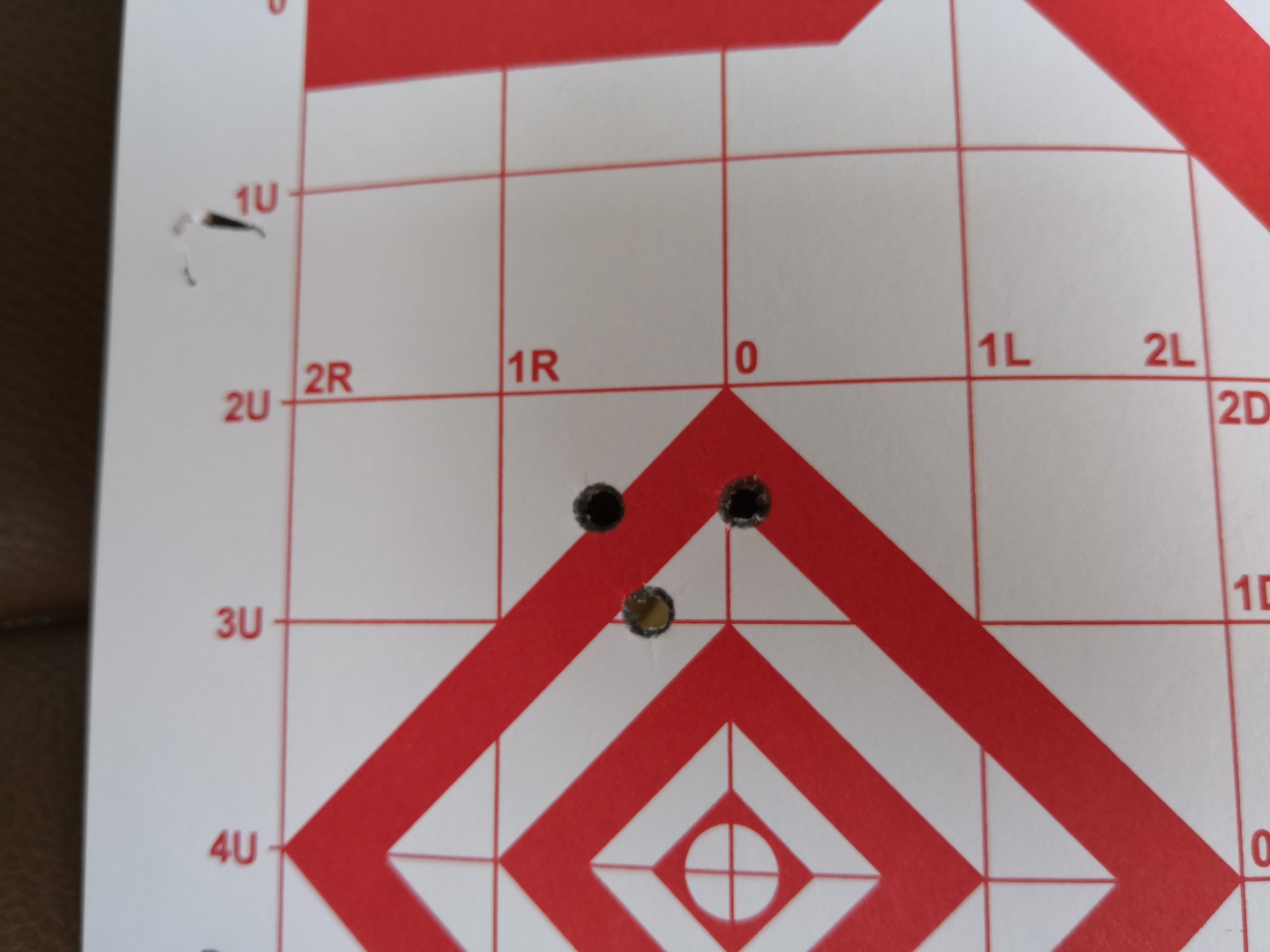

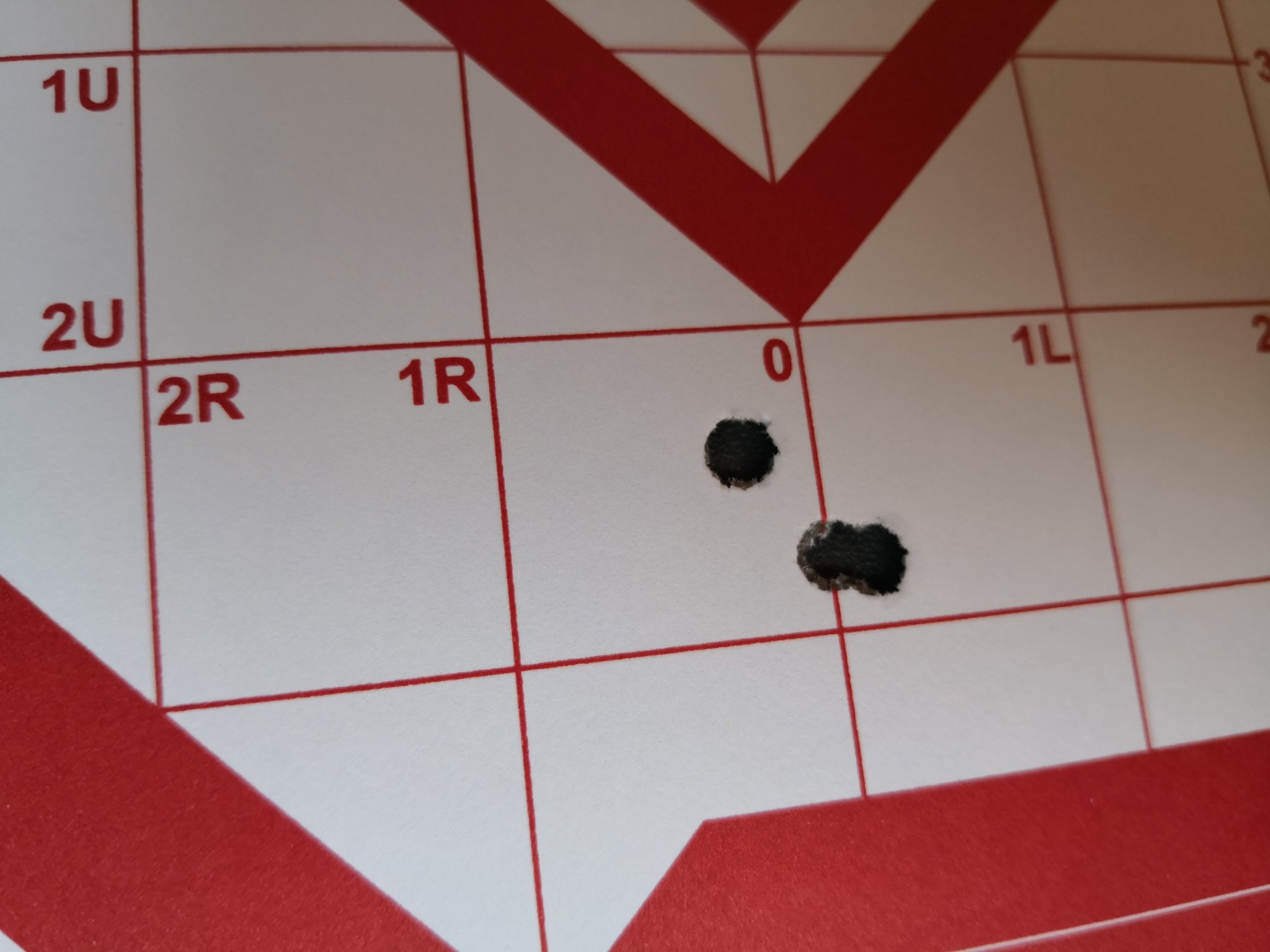

Well I did some load development. Haven't shot anything past 100 yards so far but initial groups look very promising that this is stabilizing in my 1:10 twist barrel. These are the 90 grainers for those who didn't see my earlier post. Both groups are about 0.5" at 100 yards. Not bad for a factory rifle in my opinion. Aiming at the tip of the triangle in both cases, so hitting about 3/4" low, but I've since adjusted that out. I'll try some longer ranges and see how the BC holds up.

Shot a 5" group at 500 yards. I think that's respectable for a factory rifle. I also have no concerns about stability in this barrel at this point as dope was perfect. Good to see some results on game as well, I appreciate that info from @Steelnecktie and the pictures. Seems Sierra has a good thing going here.
