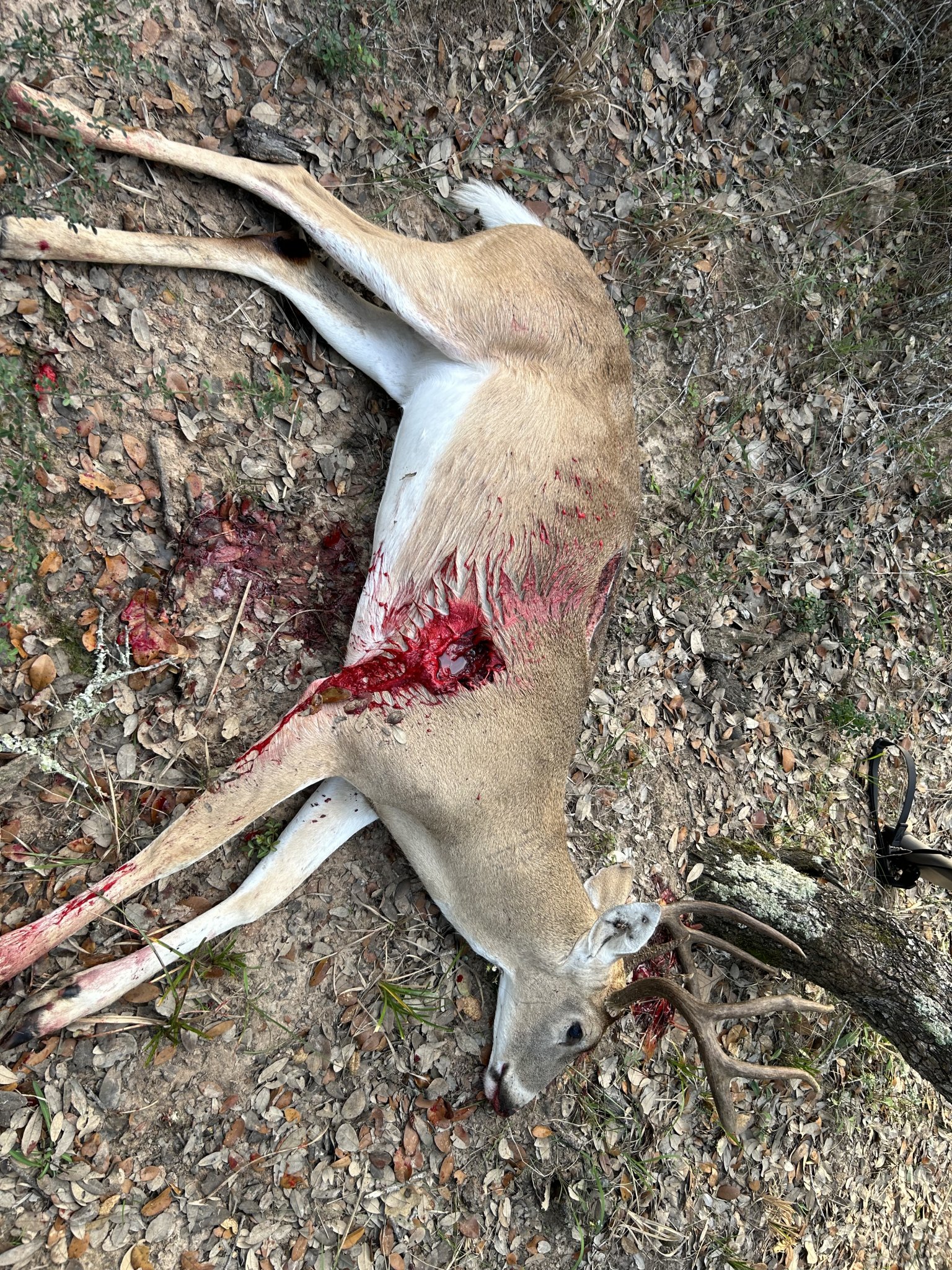

It's not budget friendly, but since you're emphasizing precision in an environment where every bit of juice you can squeeze matters, I would suggest the Federal Terminal Ascent 175gr .308 loadings.
a few things to note, and an explanation of why I'm recommending such a premium round.
notes:

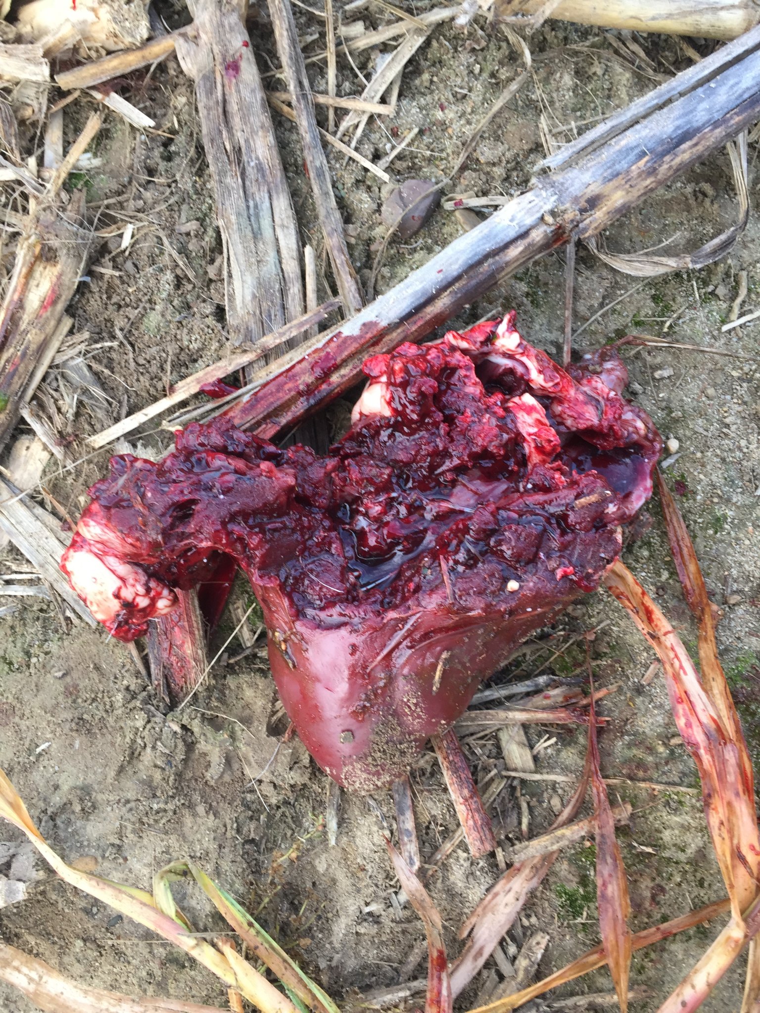

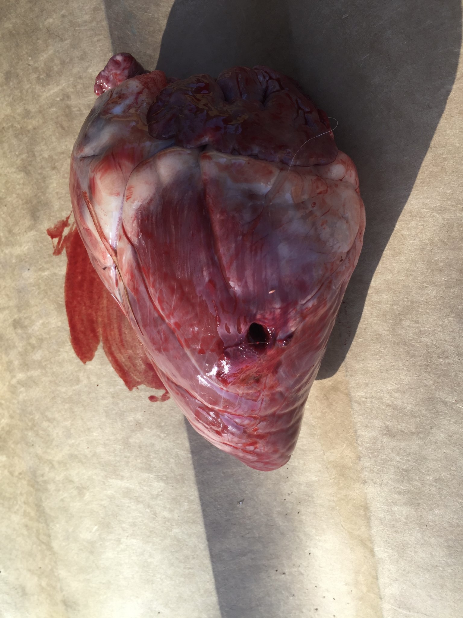

1) I've used it extensively in competition and hunting, and it is the only premium cartridge that feels actually worth the cost to me
2) You will need to use either metal mags (KAC, etc) or the Magpul red follower 25rd, designed for M118LR as the cartridge length is 2.83"
Reasoning:
1) accuracy. It has the highest BC available to a .308 factory loading without single-feeding and running hand loads, it has performed well in every gas and bolt platform I have tried it in, and is my competition load for that reason.
2) terminal performance. The design is very similar to the Trophy-bonded Bear Claw which was the basis for Federal's Law Enforcement ammunition line, because of its performance against barriers, particularly auto glass and other commercial glazing, which is traditionally a very difficult barrier. The solid copper base does an excellent job of providing barrier blindness and retained weight on target.
3) Reliability of terminal performance: The projectile will reliably expand even at transonic velocities out to the advertised maximum of ~1000y. This has been demonstrated multiple places, and provides for excellent terminal effect at most conceivable ranges and conditions that a LE sniper team might be called upon to operate in.
4) fully element sealed: Perhaps a nitpick, but the nickel brass case, sealed neck, sealed primer, and nickel coated projectile mean that short of being mangled somehow, the ammunition will remain usable and effective in harsh conditions.
It is expensive, but considering the potential benefits to your department, it may be worth the price of entry.

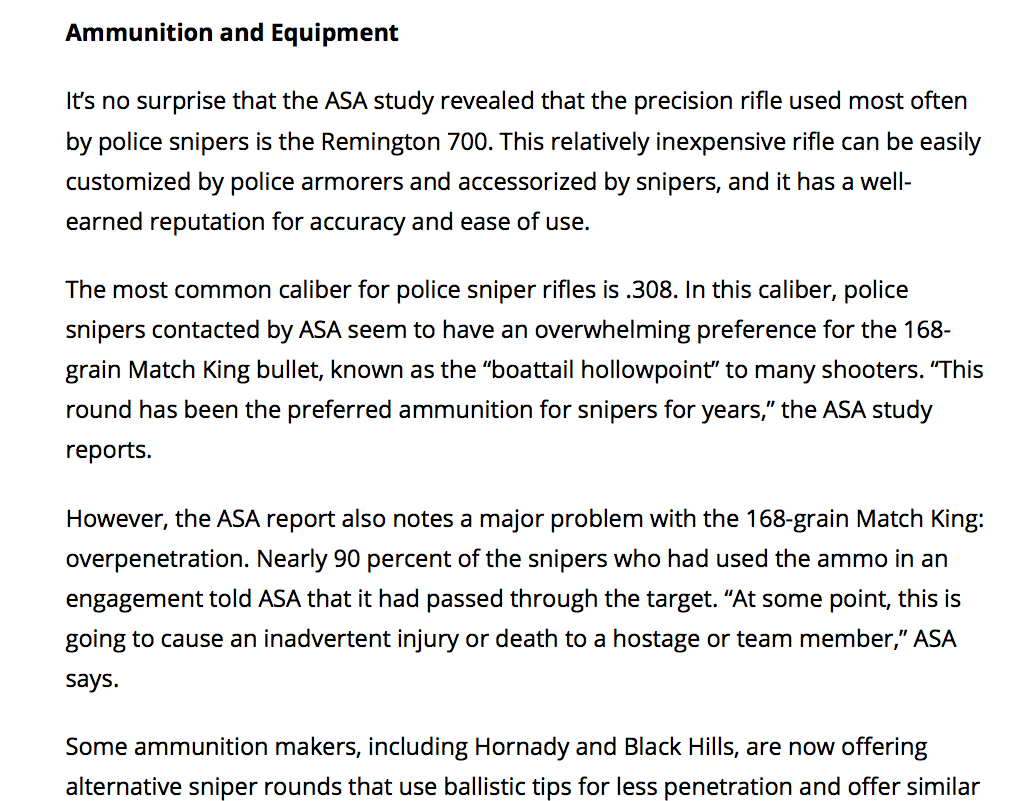

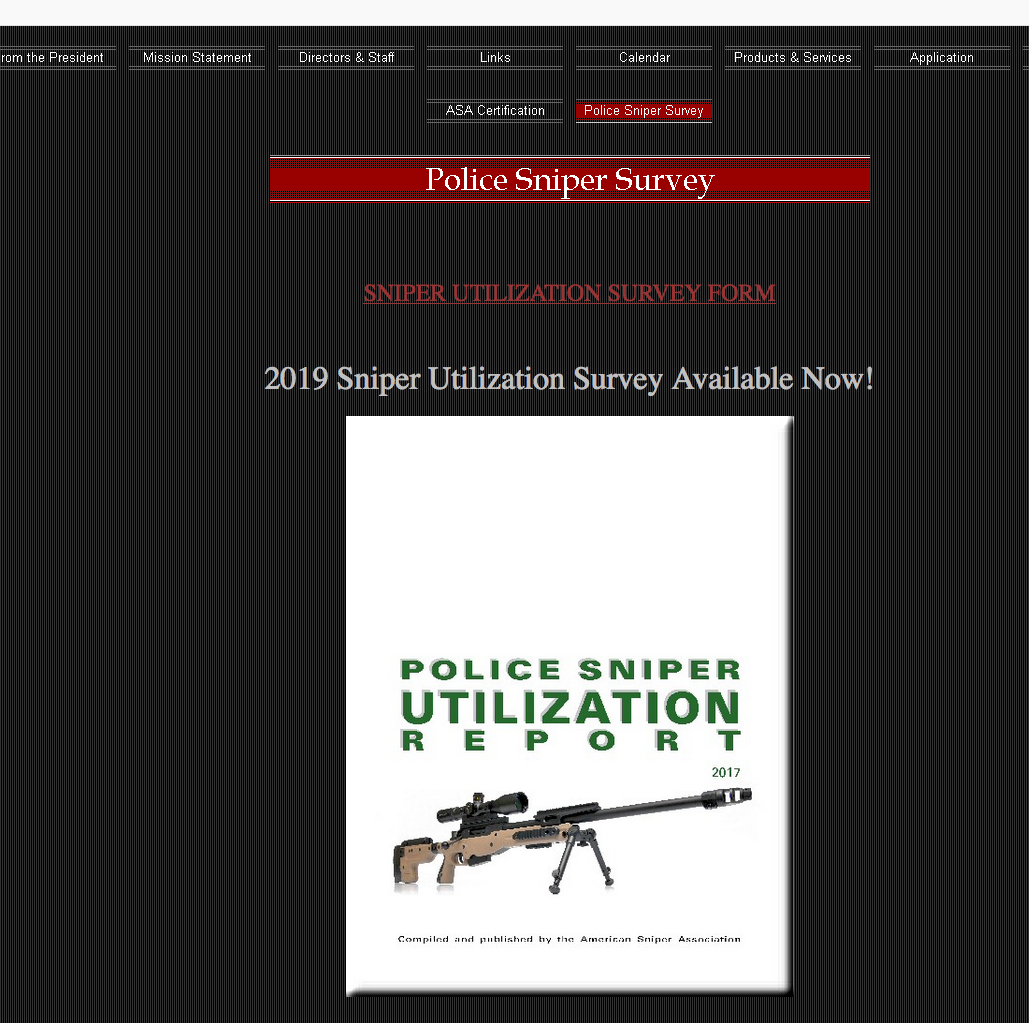

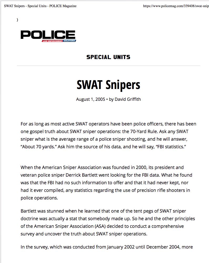

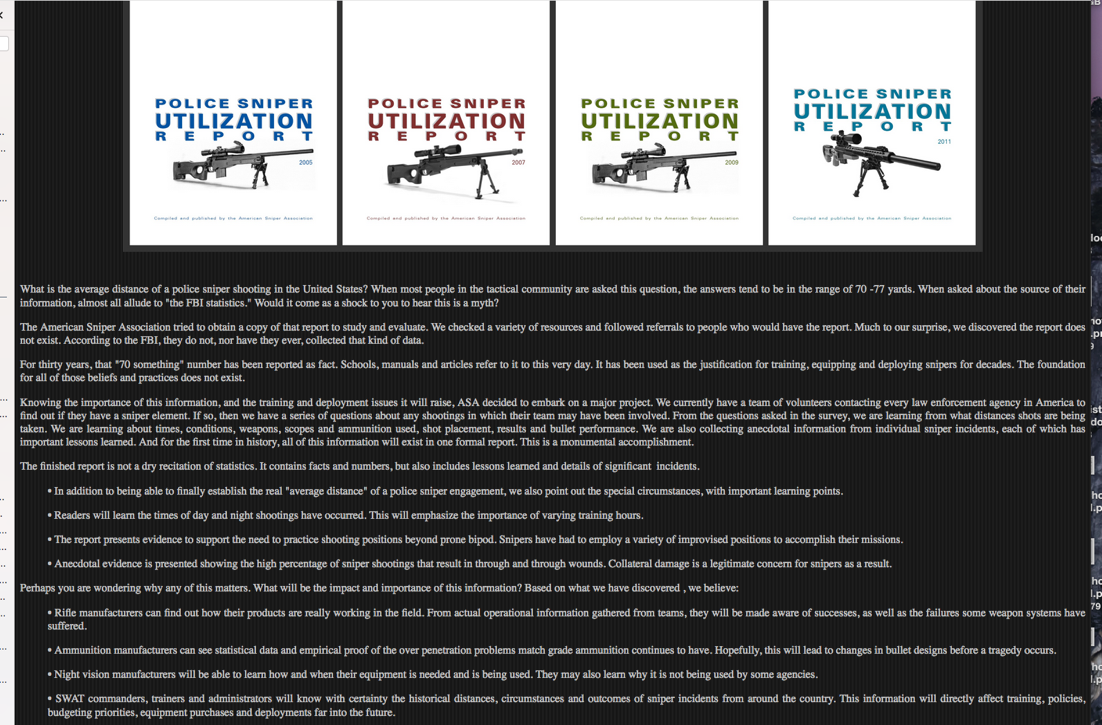

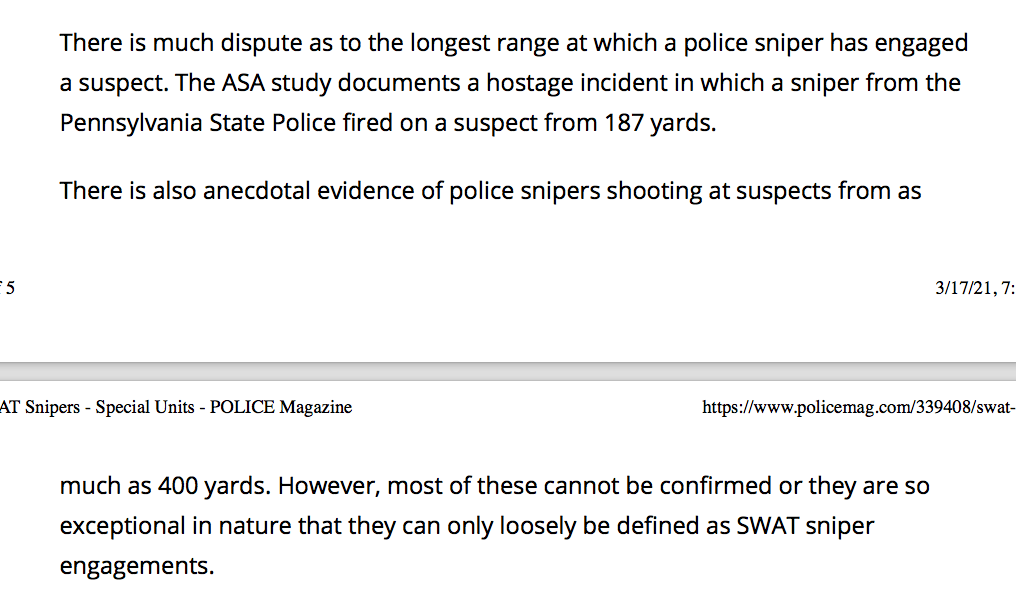

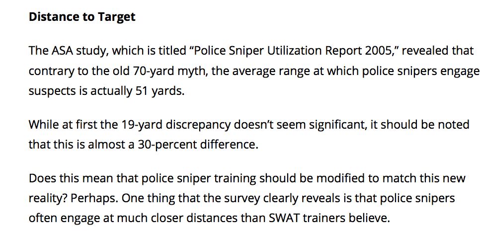

The documented average spiper engagement distance for U.S. law enforcement personnel is 50-55 yards. Why is employing extremely low drag (ELD) match grade ammunition even a consideration? Law enforcement studies have concerns of over-penetration with match grade ammunition at these distances. Intermediate barrier profile and angle of incidence may screw up your first shot to the target, subsequent degradation of the barrier by the first round may provide better second shot placement which is the ultimate arbiter of success to the situation; sequential loading your magazines with different ammunition profiles might be a consideration. IF you zero your rifle at 100 yards you still have height-over-bore issues to consider for the shot. The NTOA (National Tactical Officers Assoc.) has endorsed the .308 ELD Hornady products.

Where did you get that from and how do you figure that? Actual shootings by cops in your department?
What training does your lead sniper or instructor have?
😂Lead sniper. No we are not that high speed. We currently have no sniper element at all. I have a military experience and a 1300 yard range that I can shoot on from my back porch. Aka a big field.
Fortunately, former special forces members have created a training facility near our department, and I believe three of them were snipers.
My data comes from the usual Google search of course. I have also been testing it on multiple deer over the last several years with results coinciding with my research.

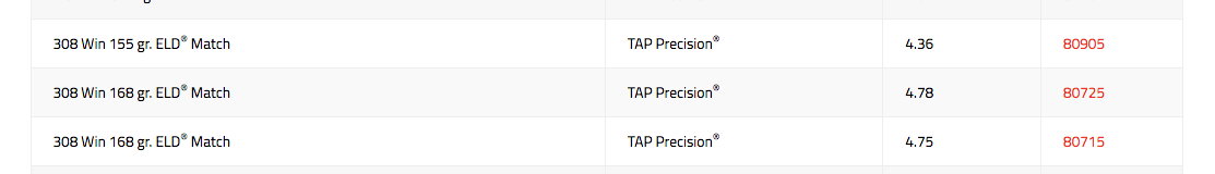

My department is trying to form a sniper team. We currently have Federal GMM 168 grain 308 ammo. Very accurate but terminal ballistics suck.
Looking at switching to the Hornady 168 grain ELD Match or the ELD Match AR.
Does any one know that actual bullet difference in the ELD vs the ELD AR?
There is no bullet difference. The powder is a different burn rate friendlier to AR gas platforms.
This would be the American Sniper Assn recommendation to you for duty ammunition in that platform.
Our experience with ELDM Tap (non AR) in several different gas platforms has been a failure to function due to over pressure. GA Precision built (armalite & DPMS platforms), both mfg's in factory format, LMT, and DD.
There is no less expensive duty ammunition option, sorry bud.

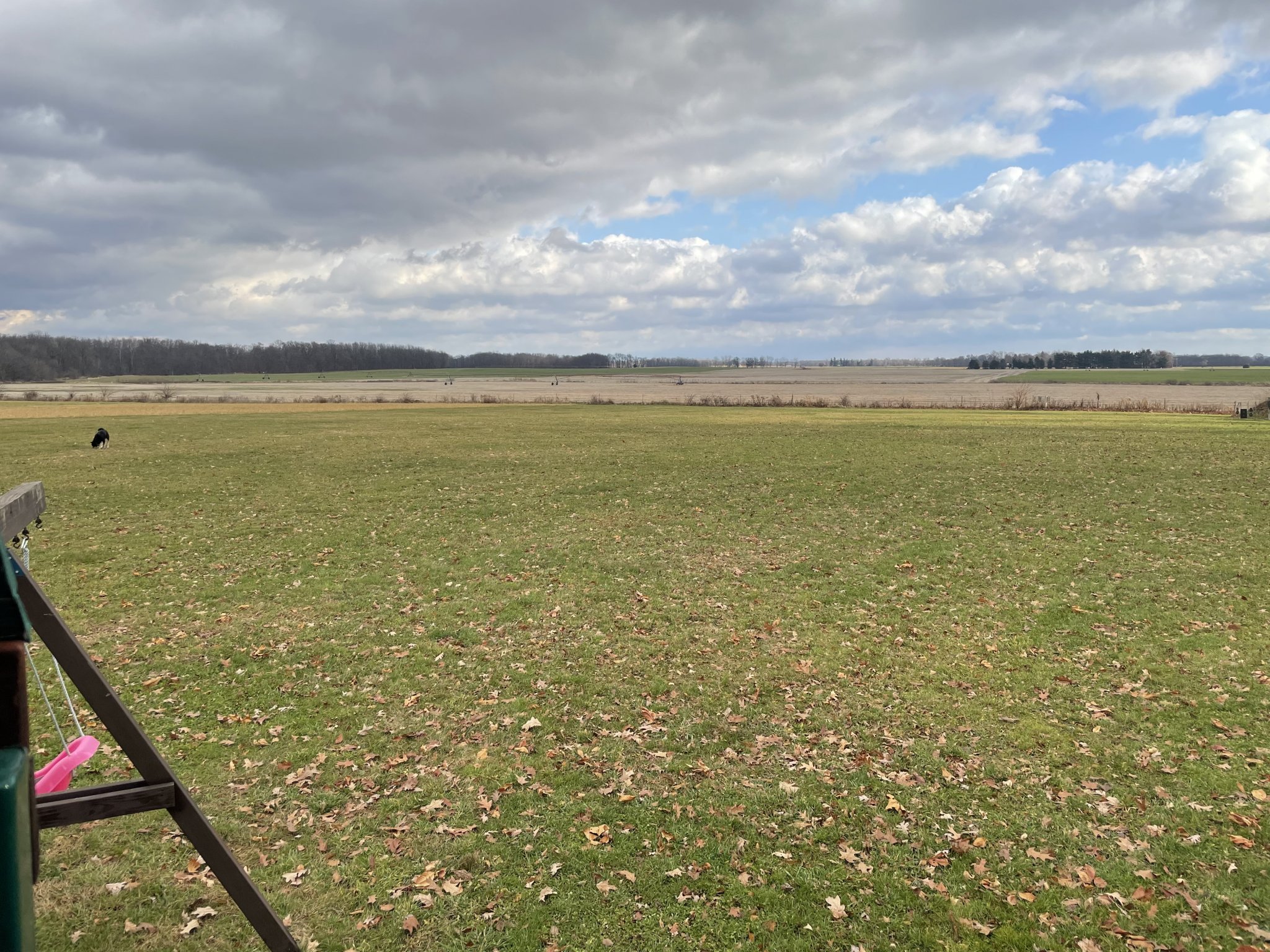

I just know in my personal experience using the ammunition. I am getting pencil size holes through the entire deer over and over again. I have found the only way to drop them is with high shoulder shots. Or trying to hit the tip of the shoulder to get the boy to tumble through the chest cavity.
I know it’s not the perfect or the most scientific way to go about it but I live on the farm where deer need to be shot. I have shot about 15 with this specific ammo to test it for terminal ballistics.

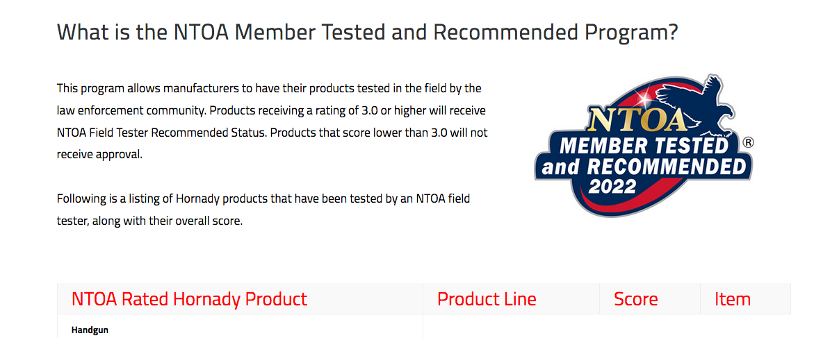

The eldm and eldm ar are the same bullet at same velocity so it should be the same by ASA. you got Derricks # ? Call him and ask, however if @Terry Cross is Still reading here, he might know if ASA approves the eldmar ammo . I'll call Derrick and ask if you don't have his #.

Canoe the head, deer, or meth head with a 168, the deer head is generally tougher, the hide is stronger, Fer sure, ... no, not showing the crime scene photos, no...
But,
Not sure what killing deer and terminal ballistics on barricaded meth dealer shoot outs have in common but if you’ve reached a conclusion based on wound channel or how far the deer ran after being shot, I’d say it likely had less to do with the 168 FGMM ammo and more the shooter. 🤷‍♂️
Back to back standing shots at about 200 yards with a Acog. Pretty sure it’s not the shooter.
First one is a broadside through and through pencil size hole. Even with a direct heart shot the deer didn’t die instantly.
On the second one I tried to Nick the edge of the front shoulder to get the bullet to tumble, and it did. Sounded like a drum being hit and it dropped.
Closest thing I can get to real world results without being a serial killer.
View attachment 8291566View attachment 8291567View attachment 8291569View attachment 8291570View attachment 8291573View attachment 8291574
View attachment 8291623View attachment 8291624
