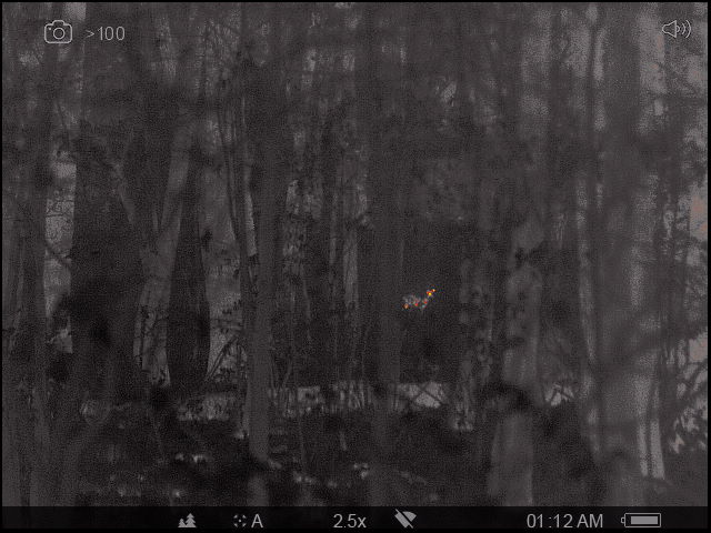

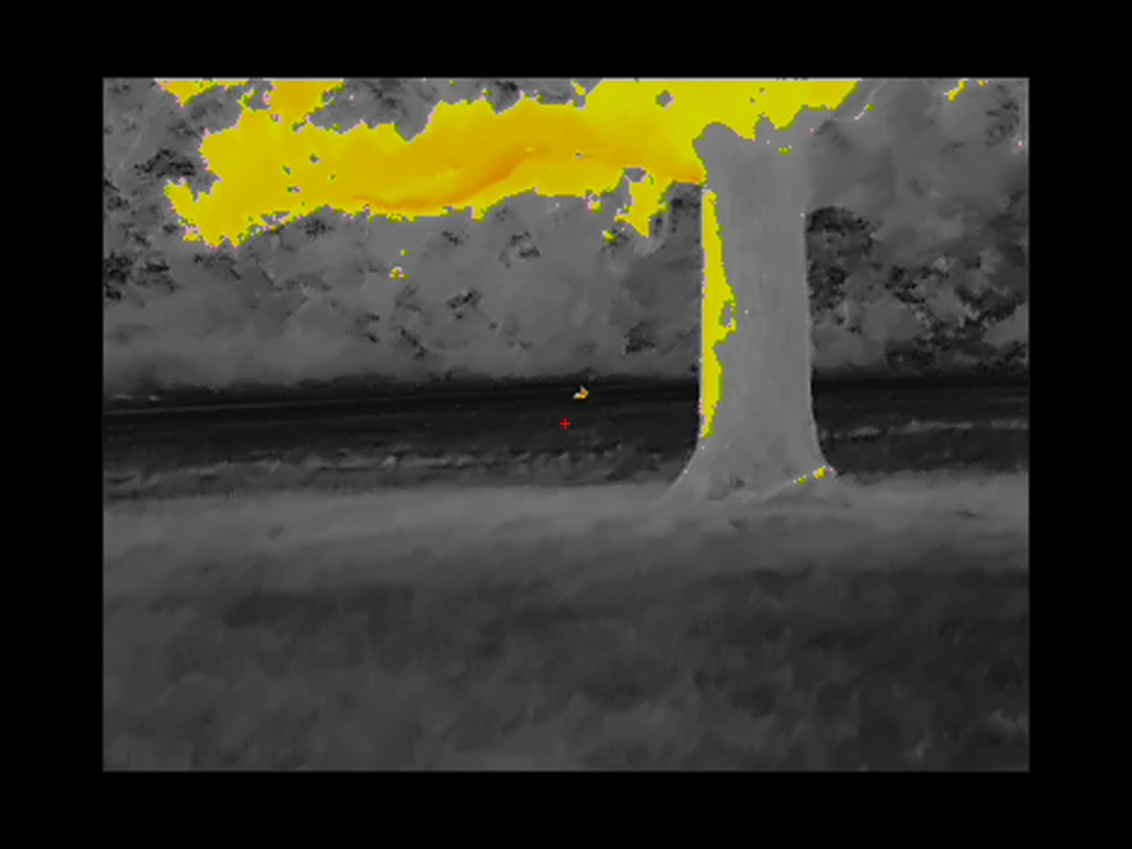

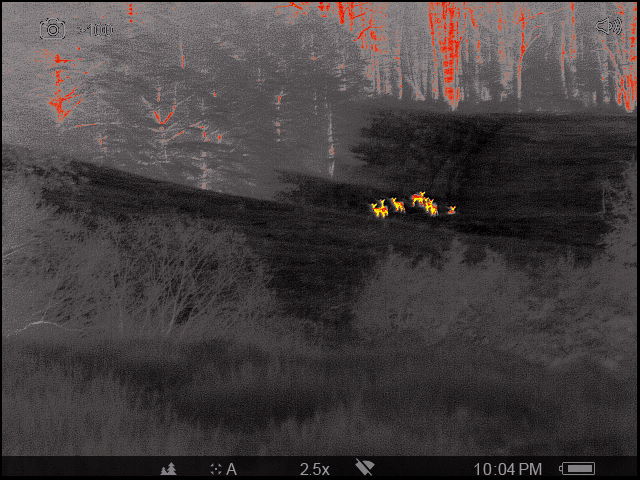

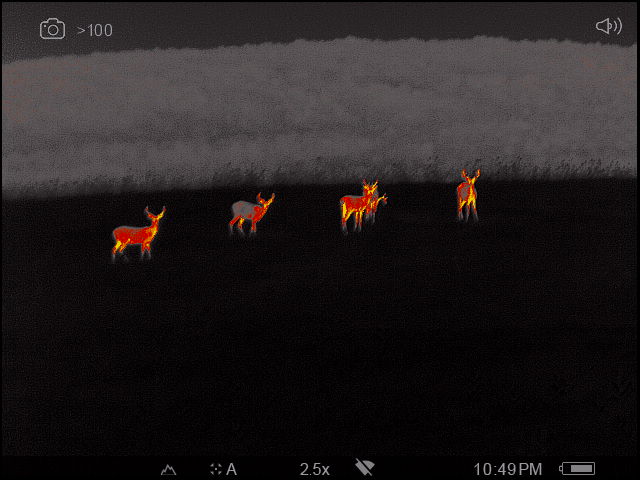

This is an example of the flaring I see with the Iray product all the time. This is a wide open field with 1 tree in front. If this were woods you would never see the rabbit. The next picture is in very thick woods and the older helion 2 xp50 (not the pro) picks up the deer easily with no flaring. Third image is helion 2 xp50 picking up bucks in a field. I can get the helions to flare a bit too as the 4th pic shows the trees lit up, but even then there is a huge difference between the deer and the trees unlike the IRAY.
