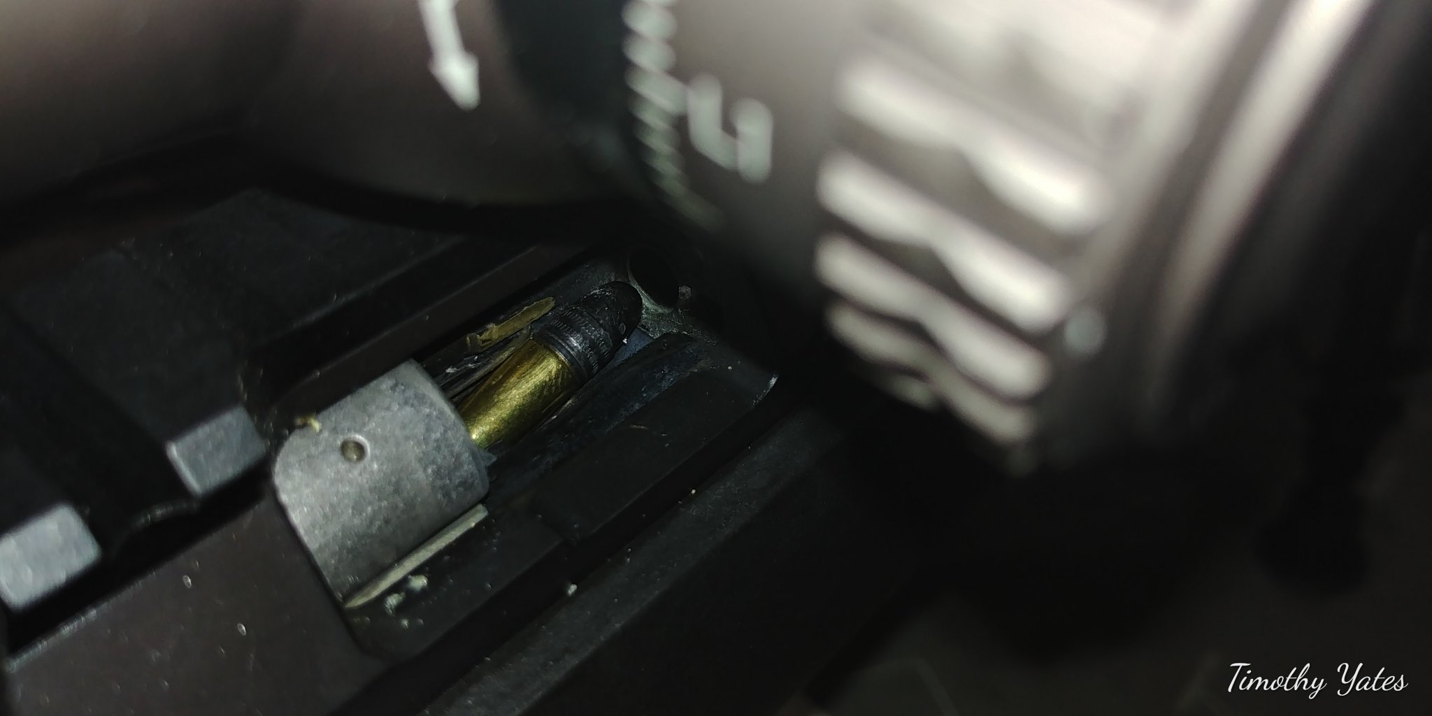

What kind of feed issues are you having? Example, is it nose up or hanging on the bullet tip when trying to enter the chamber?
It starts the shell out of the magazine then it acts like it's binding before it starts in the chamber. This cycling the bolt slow, if yo pop it seems to feed okay. I didn't check if it's shaving the bullet though.

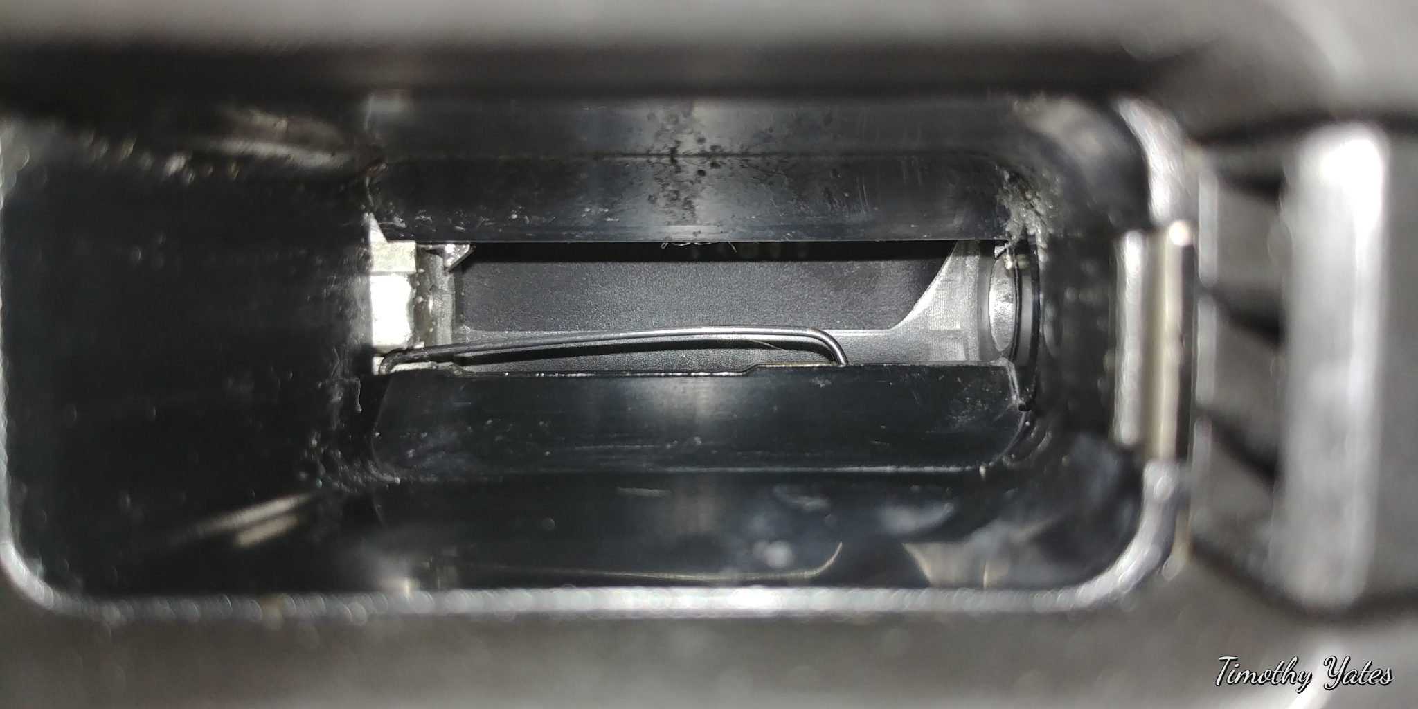

I currently have three Tikka T1x 22 LR. All three started out with ejection issues, my very first one had feed issues on the last round. Two have been in my KRG stock and one "last one" started out in the KRG. I didn't see any significant change in either stock. After messing with these three and the Tikka 17HMR I have, I am a firm believer it's related to the ejector wire itself. I also had the same issue with a Sako Finnfire Range.
Feed issues can be magazine related or ejector related, from my experience, ejector related more so. Trial and error is what it takes. Take this for what it's worth but I've done this on 4 Tikkas and one Sako. I have another Sako Finnfire Range and the Hunter model that worked perfect when I got them. I have a buddy who has a T1x 22LR and his worked perfect from the start. Luck of the draw I guess.
What sort of trial an error did you do to sort the FTE issues? I'm also convinced that it is the wire ejector that is the issue on mine.

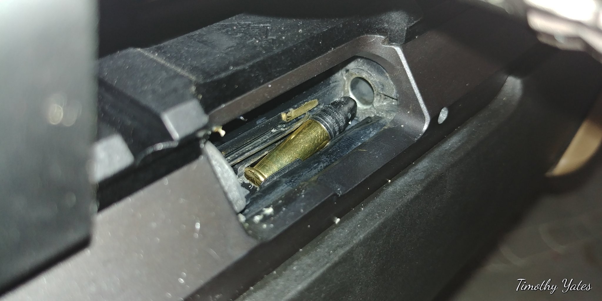

Three weeks ago I picked up a new T1X in 22LR so that my son and I could shoot NRL22 with it. The first 100 rounds or so were flawless but it has steadily gone downhill from there with typically at least one FTE per mag. I've tried CCI SV, Green Tag, FGMT, Norma Match, and Aguilia Eley Match with no differences in FTE rate. Definitely getting the best accuracy from the two CCI loads. I've read 34 of the 50ish pages of the big T1x thread and every few pages a new person chimes in with the same complaint. I've seen "smooth the extractor with 320 grit," "smooth the extractor with 550 grit," "radius the back of the extractor," and "bend the ejector wire" as possible solutions. I've smoothed the extractor and have bent the ejector as much as I felt like I safely could and am still having issues. In the 10 NRL stages shot by my son and I we had FTEs that cost us time and points in 6 of them. I have nearly 100 year old rimfire bolt guns that in the 30 years I've been shooting them have never had a single FTE so I'm a little grumpy about this. Otherwise I LOVE the rifle and really want to make it work.
Any other specific suggestions?
The match director at my latest NRL22, told me to just pull the bolt with a little more force and I wasn't extracting hard enough. I had 2 FTE in my last match, and he told me I wasn't extracting hard enough. The rest of the stages I pulled a bit harder, and had 0 FTE.
So yes, I think the spring could be fixed to be more reliable on short/weak strokes, but if you stroke it harder it'll also help.

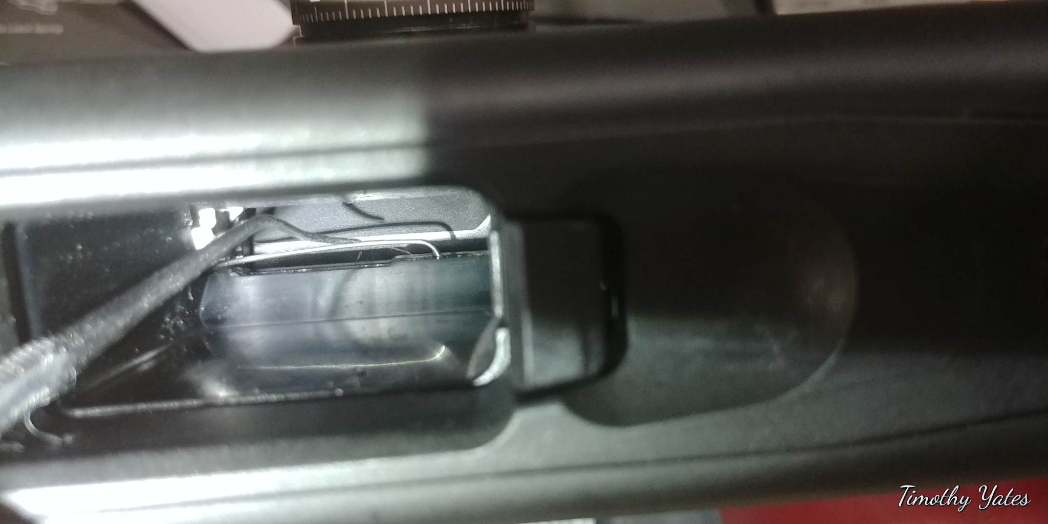

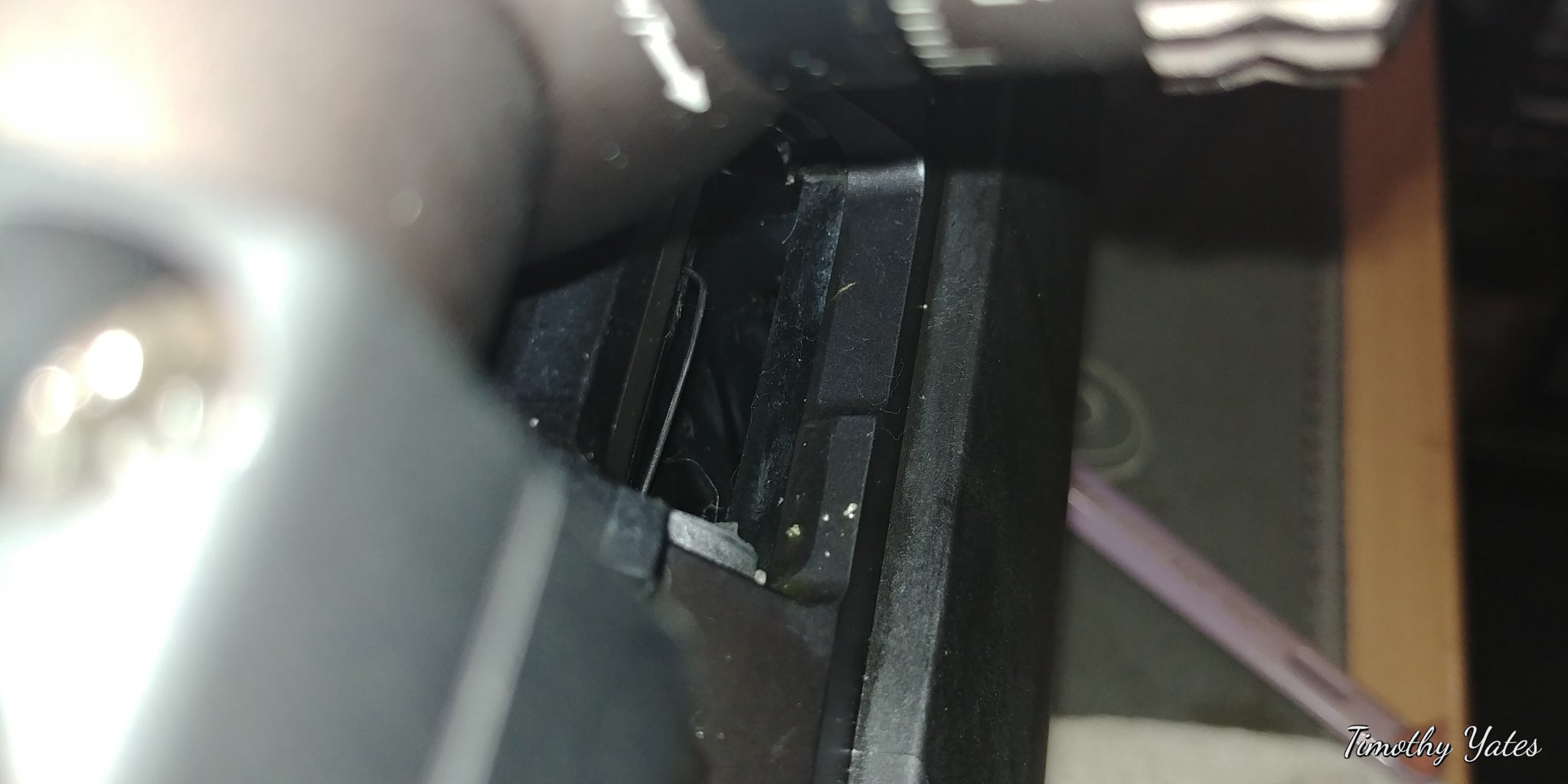

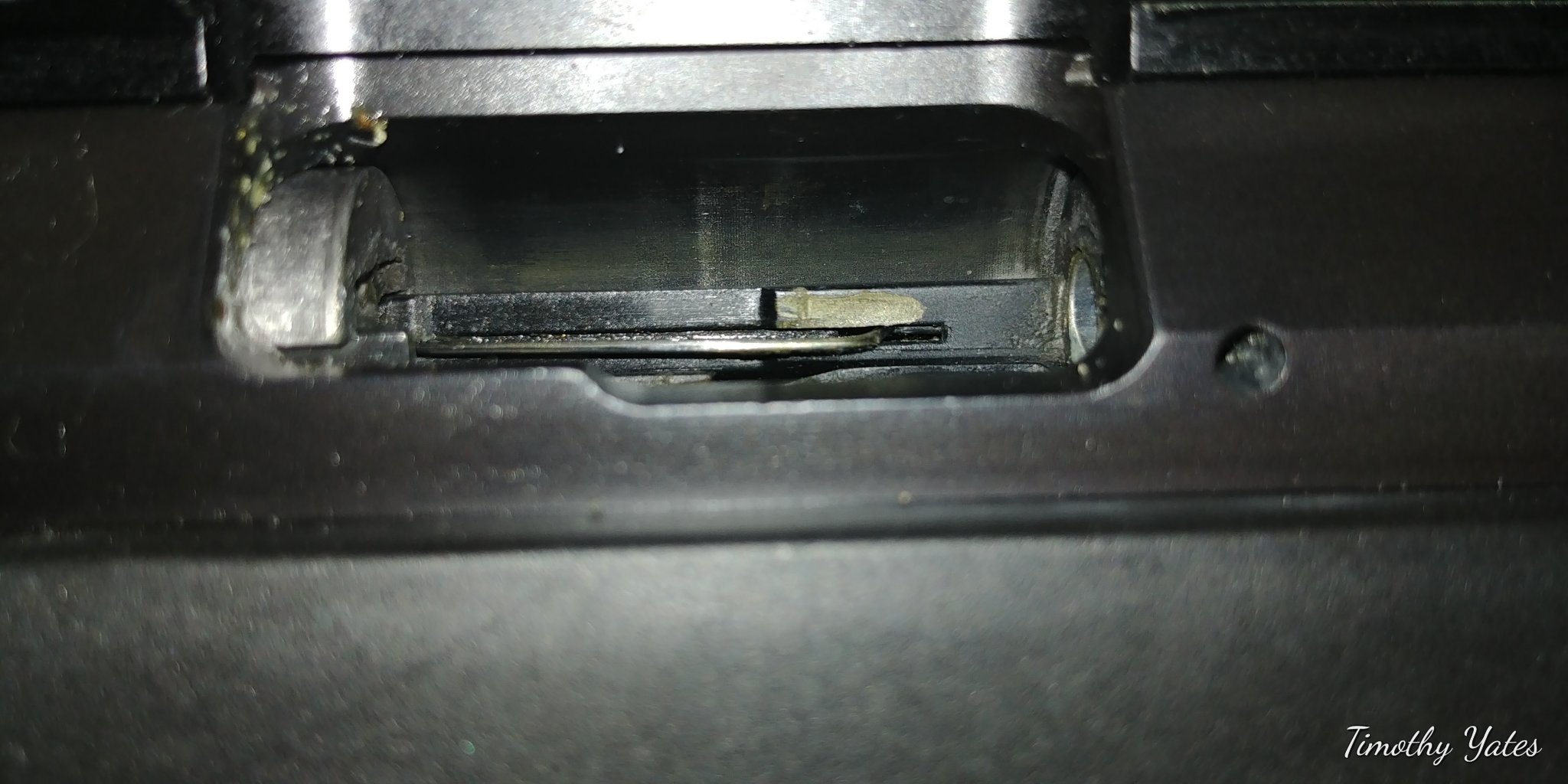

I used the medical type needle nose pliers that lock to bend my ejector. I have photos of one of mine. But, I say trial and error because my others don't look exactly like this one. So even though you get it bent like this one it may or may not work for yours. Anyway, here is how one of mine looks now. I also point out where I made the slight bend.
Thanks, that helps. I'll try that tomorrow. I did a bit of tweaking last night and then went to the range tonight. Still had 4 FTEs with around 100 rounds. I've tried pulling the bolt harder and softer with no change in failure rate. I wish the ejector was available separately from Tikka so that I could bend a few of them to different shapes and see which works best. I may source the raw materials and start making my own.

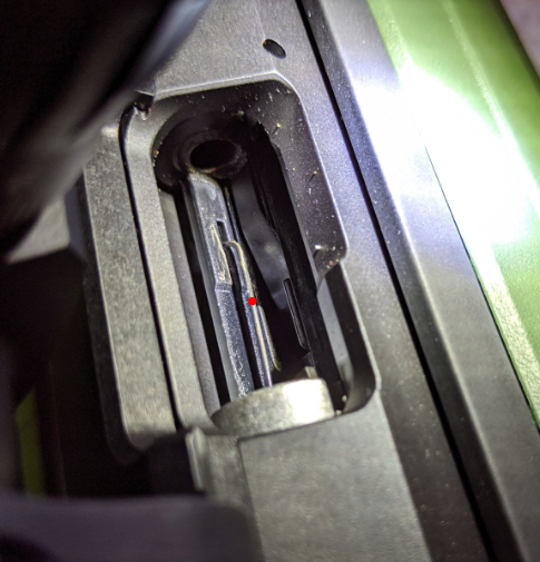

I made a similar bend last night and repositioned the magwell a bit. Went to the range on the way home from work and shot 95 rounds with only one FTE so that's a big improvement. It doesn't seem to feed quite as smooth now but I didn't have any actual FTF.
