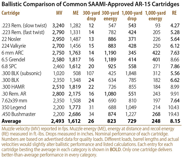

I'm surprised the 6mm ARC is getting so many votes. After seeing some guys running them at a match recently and talking to them about their velocities, I left pretty unimpressed. I think that cartridge over promised and under-delivered on performance. I talked to several shooters who felt the same way, who had built a 6 ARC.
It looks to me like this chart is all over the place - maybe I'm wrong. Did someone build exact identical 18" AR15's and shoot the highest performance factory round available in every one of them for these numbers?
Or did they guess. I'm guessing it was guess.
Agreed. Still trying to figure out the fast twist vs. slow twist 223 thing also.

Based on your chart, the 6mm ARC looks like the clear winner.
I don't know who made the chart but it is clearly biased in favor of the 6mm ARC. If you get rid of cartridges like the 300BLK subsonic, 450 BM and 350 Legend that skew the averages of recoil and bullet drop and don't belong in this conversation and then used data from the same barrel length for all of the cartridges. I feel like the results would be much more balanced.
None of these newer cartridges are head and shoulders above the rest in my opinion. I'd also be willing to bet you could find a similar chart from a few years ago that "showed" how great the 22 Nosler and 224 Valkyrie compared to the others before 6mm ARC came on the scene.
