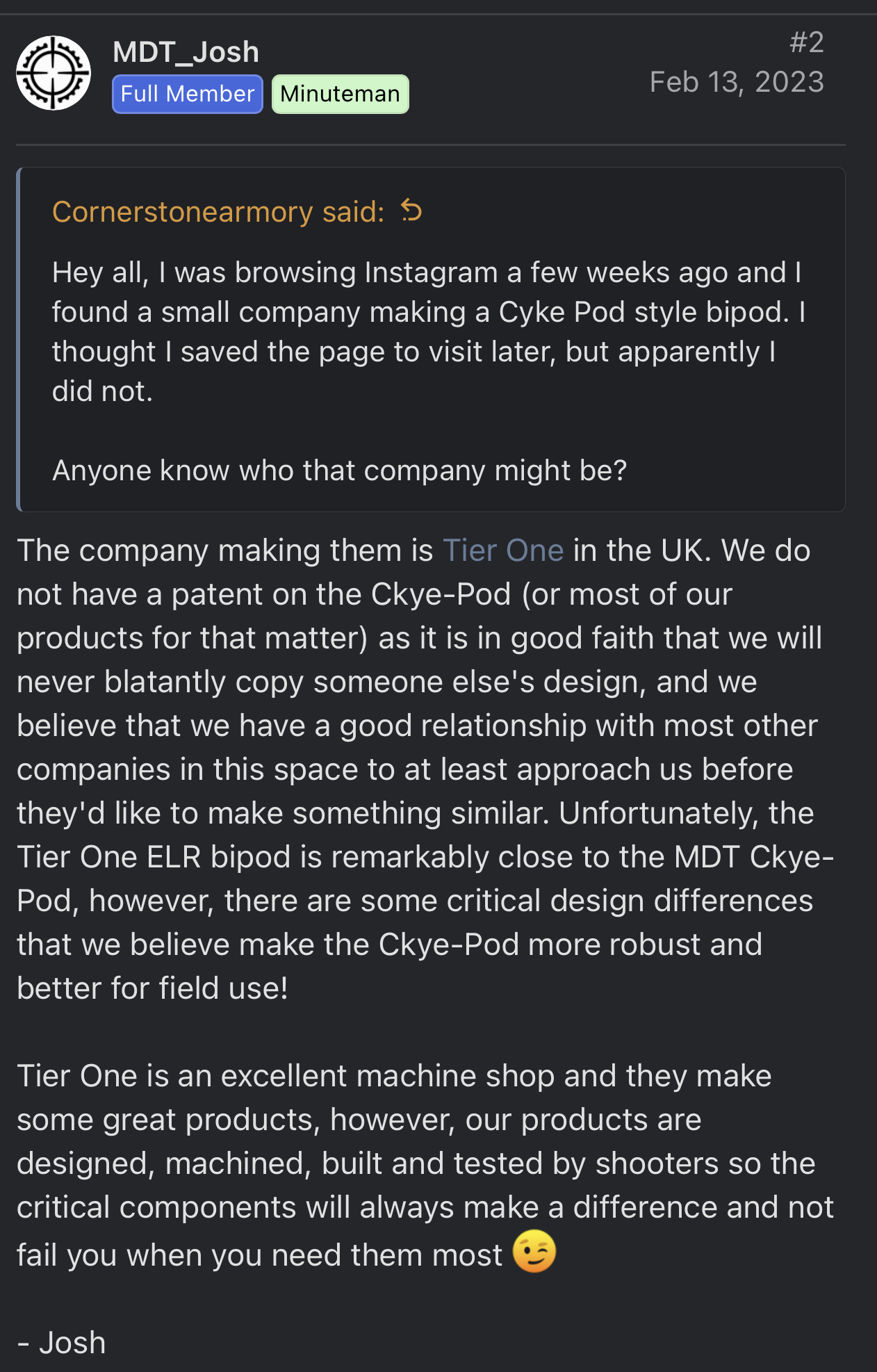

Since MDT didn't invent the cyke pod, why do people think Tier 1 UK is 'copying' them. :unsure:
They worked with the buy who invented the thing, I'm guessing they bought the design off him or atleast pay him something, either way they didn't copy it.

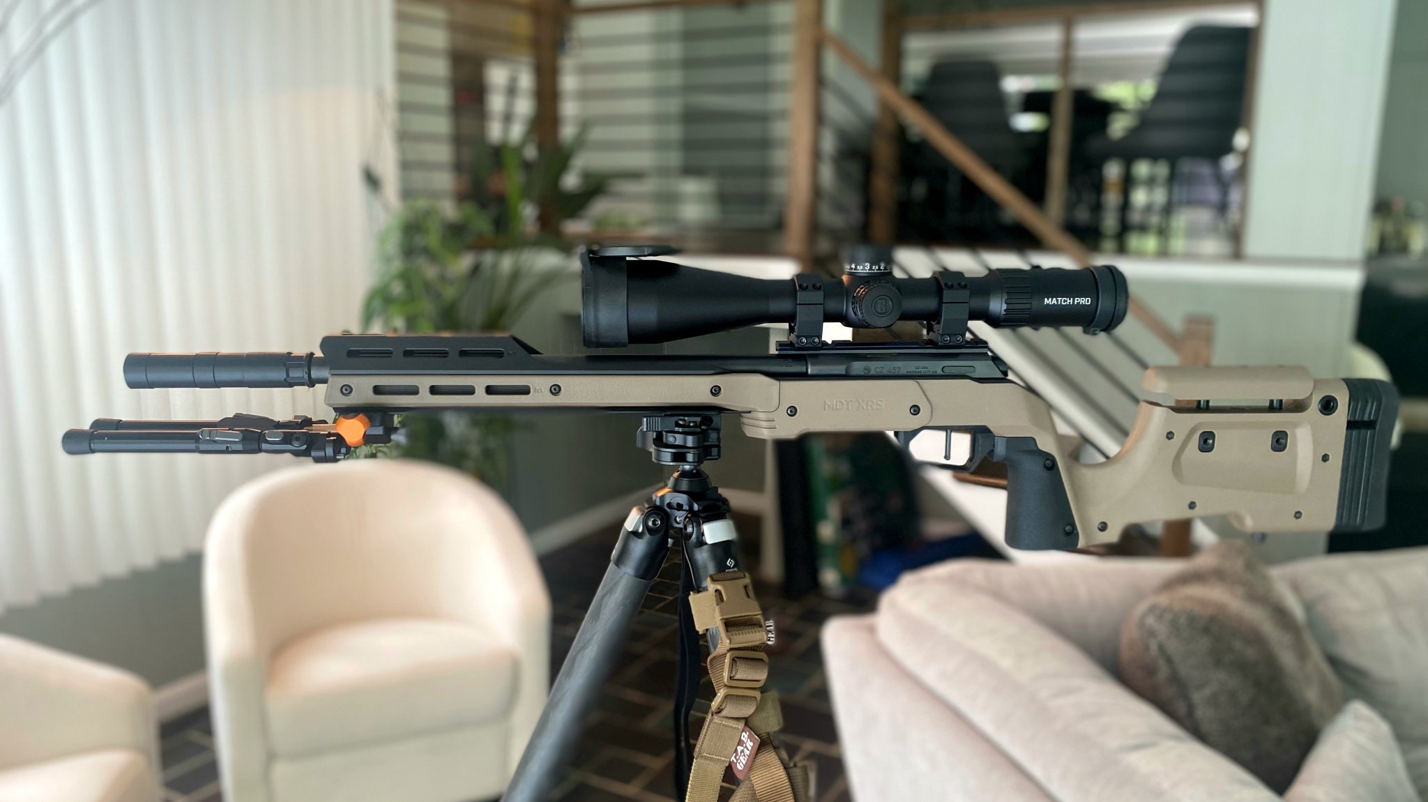

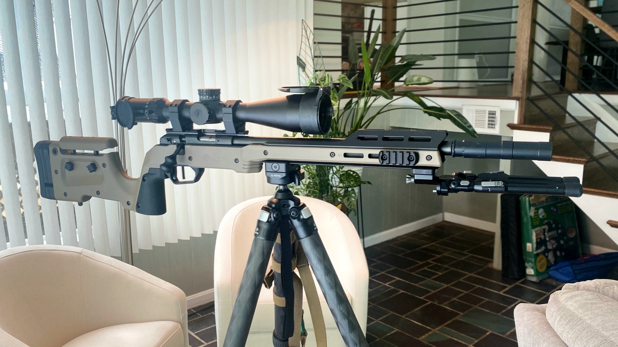

I have the ATAC arca pan & tilt model with 7" legs. Below are some thoughts I have on this product in no particular order. I do not own a Ckyepod, I've only played with them. I've mainly compared the Tier One ATAC with the bipods I do own currently which is a TBAC, several Atlas and one Harris.
- Features are all there. Stance width, leg extension and leg deployment controls are all pretty comparable to what you would expect at this price point. controls are easy to activate and is pretty durable.
- Legs are not spring loaded for the ATAC though I think some other models have this feature.
- Leg extension can be deployed without press of the button or you can push the button for silent deploy.
- The legs have some twist when the extension button is held down, this twist can cause the sliding motion to pause when retracting if you're twisting the legs.
- Bipod handles load pretty well, there is some slop back and forth when not loaded but no different than any of the ATLAS models.
- The ARCA adapter comes with a pan feature that I personally don't need. If there was a ARCA adapter that does not have pan I would've gone for that. The pan feature tension is not adjustable but it is very tight, so I can easily ignore it.
- The tilt adjustment knob is barely usable without a pod lock which is sold separately. The knob is very small and hand tightening it is not enough to keep the tilt function stiff. Until my pod lock showed up I wrapped a towel around it and cranked it tight with a wrench. Do not buy this thing without the metal lock pod accessory. I don't believe Ckyepod ships with pod lock either?
- The thing ships in bubble wrap and a card board box with no literature. Not complaining, I think my TBAC showed up in a plastic bag stapled shut with cardboard.
- Shipping from UK to VA was 6 days from ordered to my door.
Overall I'm pretty happy with this thing. I don't expect to use the stance adjustment much and for my money I would've been happy buying another TBAC bipod. For anyone that would utilize the stance adjustment I think this thing is pretty great for $420 + $25 metal pod lock.
Yes I know I'm running a MDT chassis with a knock off MDT bipod ;)
