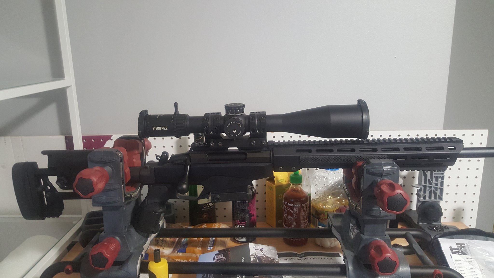

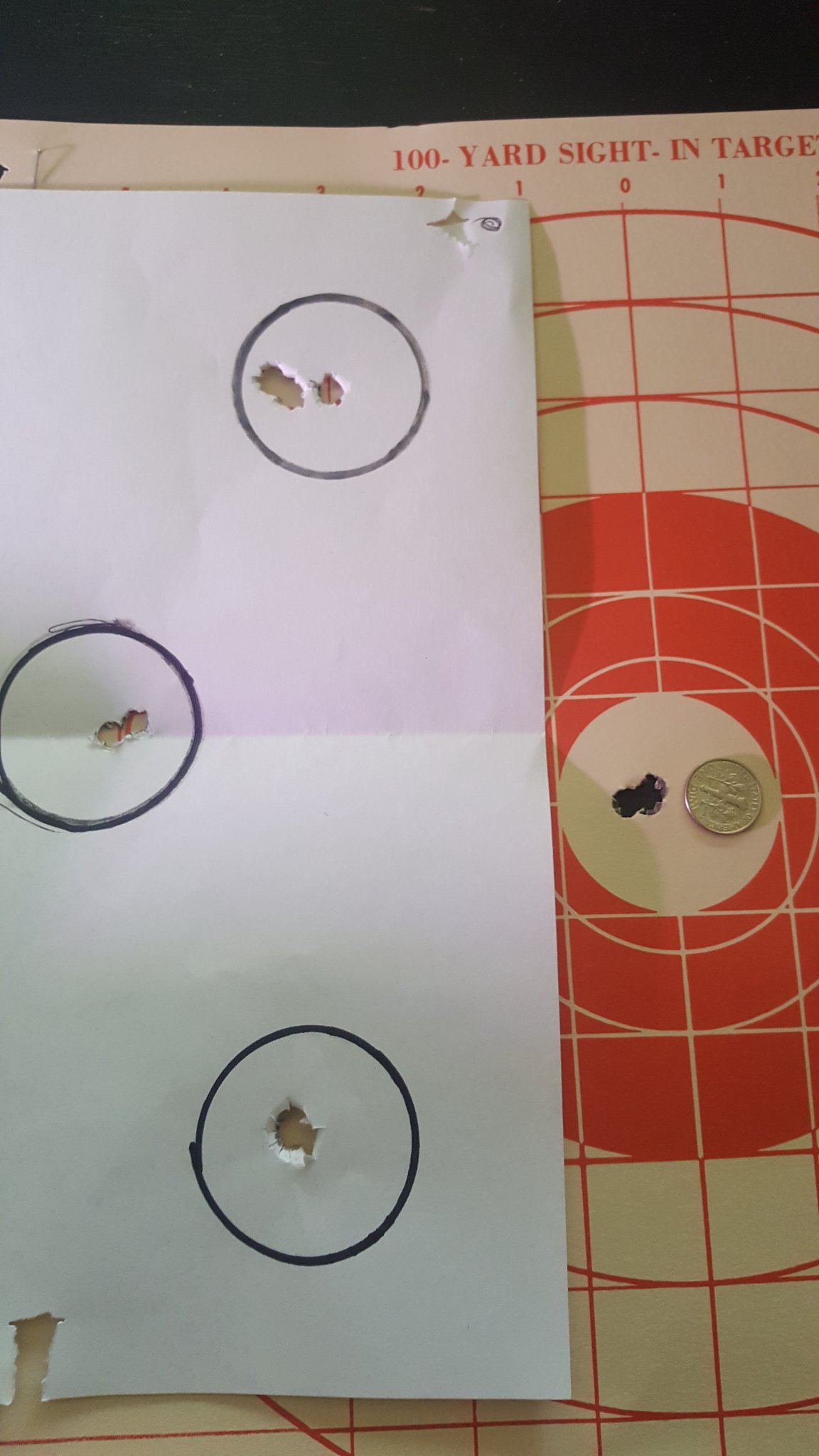

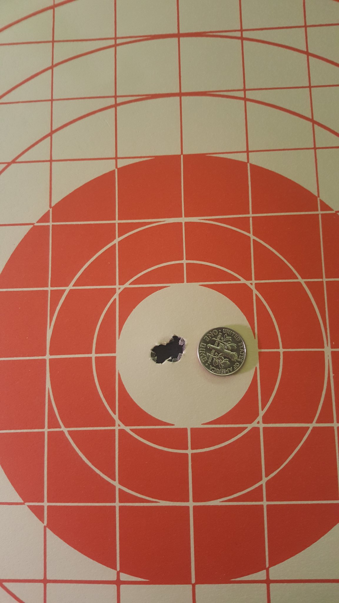

Just snagged one of these with a 24 inch barrel. Adjusted trigger down to 2#, mounted the Steiner 5-25 in a Spuhr mount and got to the range. Barrel now has 45 rounds on it. Load is 140gr ELD over 40gr H4350. Targets at 100m, 5ea. Pulled one on the top. I'm impressed so far.
