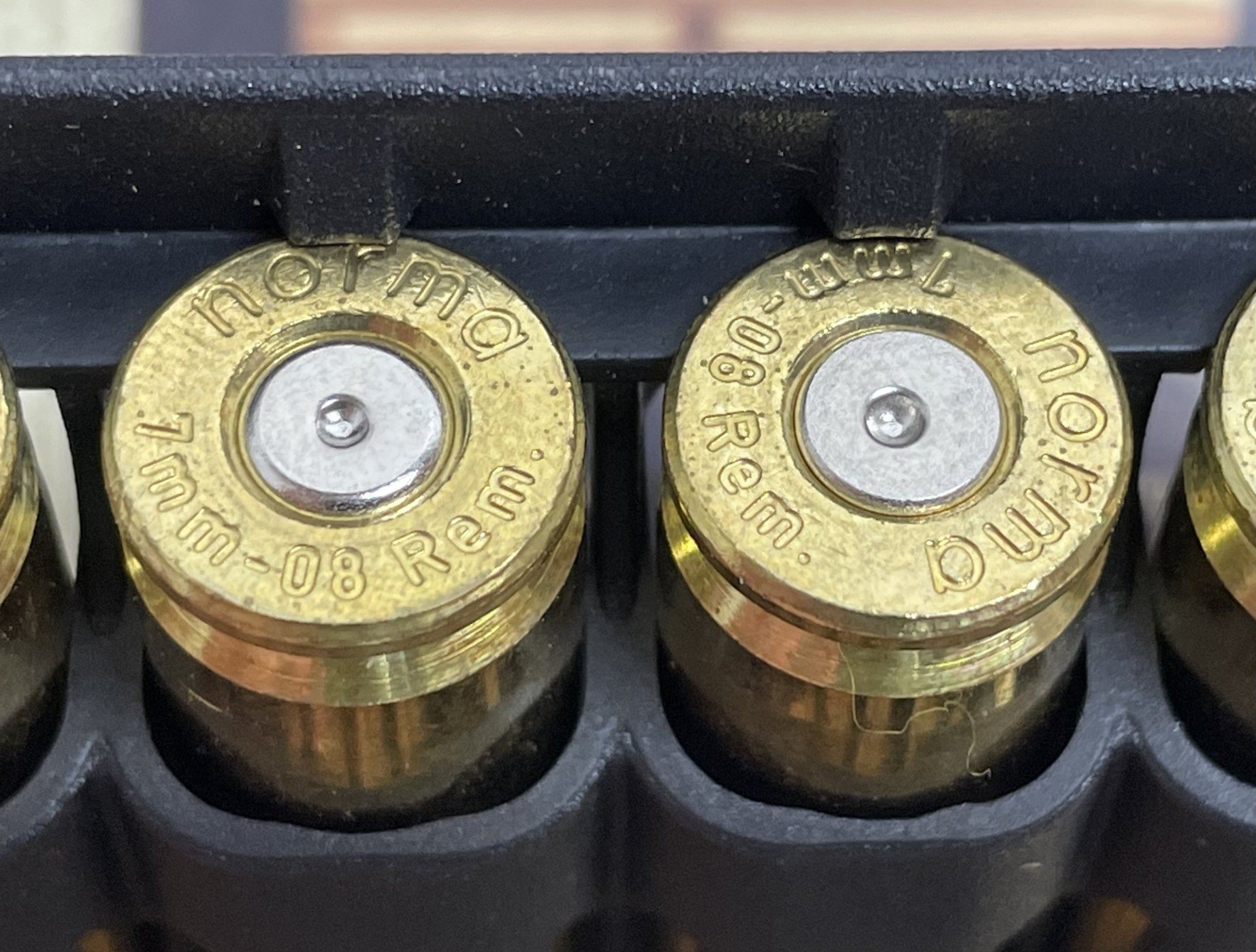

I am reloading my 7mm-08 won’t 119gr Absolute Hammer bullets which do not follow traditional load data. They require a faster burning powder and there’s very little info out there. So I’m looking for opinions on whether I am near the end of a “safe” reload. Essentially what I’ve done is loaded up in 0.2gr increments and evaluated velocity and then watched for ejector swipes and flattened primers. The round on the left is a factory once fired round. The round on the right is what I’m in question on. I know the primer is a bit flatter, would you guys deem this as getting on the hot side and discontinue pushing it further? I didn’t have heavy bolt lift.
Still looks ok in my opinion. What does the powder burn on the neck coming back to the shoulder look like? Does it come all the way to the shoulder?

it’s probably on the hotter side, but it does seem fine, I would be careful about going hotter and check each one closely when you fire it though

I respectfully disagree based on this picture alone. I don't know what the OPs goals with this round are but this casing could be pushed a bit harder. Caveat being if there are no other signs of pressure....... like a sticky bolt. I'd also like to see the powder burn.
I personally prefer a "medium" load but I do start out with a goal in velocity I would like to reach.

I am shooting suppressed too btw. Let me know if this isn’t exactly what you were wanting a pic of.

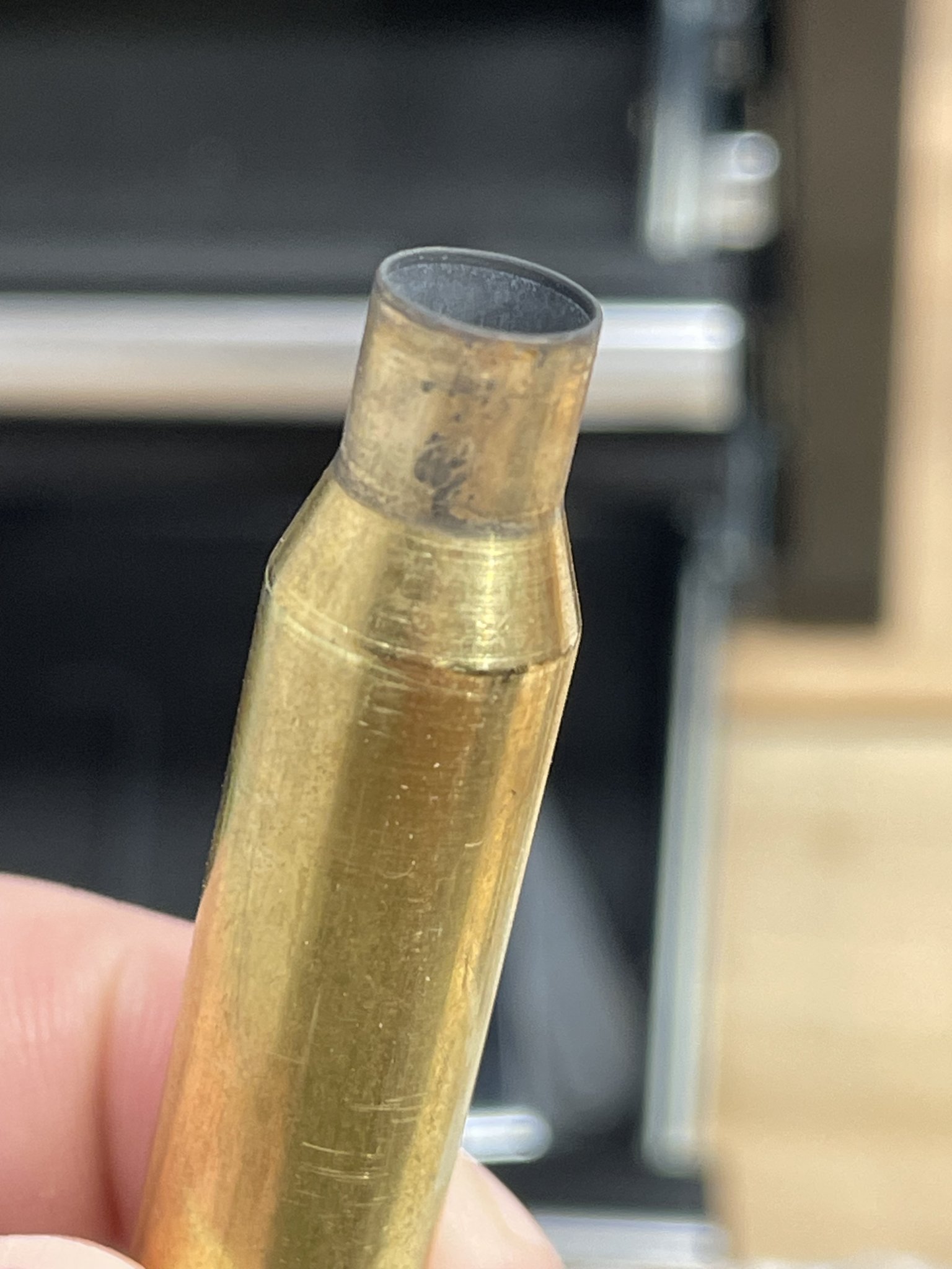

Looks like a light powder burn, if I see one at all, all the way back to the shoulder which is where I like to be near or just short of. What powder are you using? It looks to be burning extremely clean.

If it were me, I would continue on with that load development. There are no markings on the case head, the primer is a little flatter than the factory round but nowhere near what I would call a flattened primer. You stated you did not have a heavy bolt lift, so my opinion is that you have room for more experimentation. Stick with your .2gr increment and continue to watch for primer flattening, ejector swipes on the case head and heavy bolt lift.

That picture doesn't show abnormal pressure. It would be far easier if you told us your load, measured velocity, and barrel length. You can back into your pressure using a 120gr Barnes solid for load data. I'd hazard that powders with a burn rate close to H4895, or slightly faster, will be ideal.

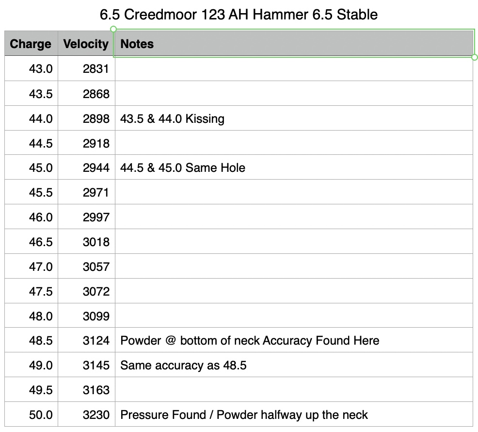

Maybe I can help you out. Different caliber but I bet you will have the same results. Below is a ladder I did on a 6.5 creedmoor with 123 Absolute Hunter Hammer's. You're correct they are a different beast to load and do not quite act normal. If you will note that for every 1 grain of increase you see about a 40 fps increase all the way through. This increase is directly proportionate to the powder. The AH bullets like faster burning powders. With slower powders you probably will never see pressure unless you have a very very long barrel. The pressure comes on these bullets when you hit the secondary explosion or ignition of powder as seen at 50.0 grains. Notice the dramatic increase. I never see any pressure exhibited characteristics until that point. You need to and have to recognize when loading these bullets the amount of FPS increase per grain of powder. Then you will be able to see and recognize the pressure. The bullet also seems less susceptible to seating depth, but more to accuracy comes on a particular powder charge. Also, giving a very very light crimp, like 1/8th turn, will increase the accuracy. Go figure. Anyways. I hope it helps. Also, most people shooting the 7mm-08 are shooting that bullet over 3,100 fps. Call Steve over at Hammer Bullets and he would be glad to help you I promise. Very nice guy. Just saw you had a 18" barrel. I'm betting you never see pressure unless you use an extremely fast powder.

Powder burn marks are a new one for me. What’s the chances you all have photos of the differences we should be seeing?

I'll try to take a picture for you tomorrow. It's late now and I have to get up early with a pretty full day but hopefully tomorrow evening I can get it for you. If I don't have a picture up by tomorrow, remind me
Maybe I can help you out. Different caliber but I bet you will have the same results. Below is a ladder I did on a 6.5 creedmoor with 123 Absolute Hunter Hammer's. You're correct they are a different beast to load and do not quite act normal. If you will note that for every 1 grain of increase you see about a 40 fps increase all the way through. This increase is directly proportionate to the powder. The AH bullets like faster burning powders. With slower powders you probably will never see pressure unless you have a very very long barrel. The pressure comes on these bullets when you hit the secondary explosion or ignition of powder as seen at 50.0 grains. Notice the dramatic increase. I never see any pressure exhibited characteristics until that point. You need to and have to recognize when loading these bullets the amount of FPS increase per grain of powder. Then you will be able to see and recognize the pressure. The bullet also seems less susceptible to seating depth, but more to accuracy comes on a particular powder charge. Also, giving a very very light crimp, like 1/8th turn, will increase the accuracy. Go figure. Anyways. I hope it helps. Also, most people shooting the 7mm-08 are shooting that bullet over 3,100 fps. Call Steve over at Hammer Bullets and he would be glad to help you I promise. Very nice guy. Just saw you had a 18" barrel. I'm betting you never see pressure unless you use an extremely fast powder.View attachment 8221608
Awesome information. That makes perfect sense
All of my brass is currently tumbled and clean. I'm not finding a peice here on my bench to take a good picture of to show you the kind of powder burn I like to see on the neck of my spend casings. I apologize
