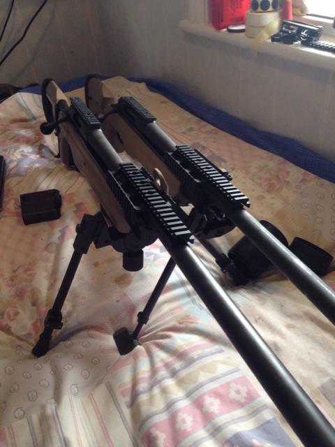

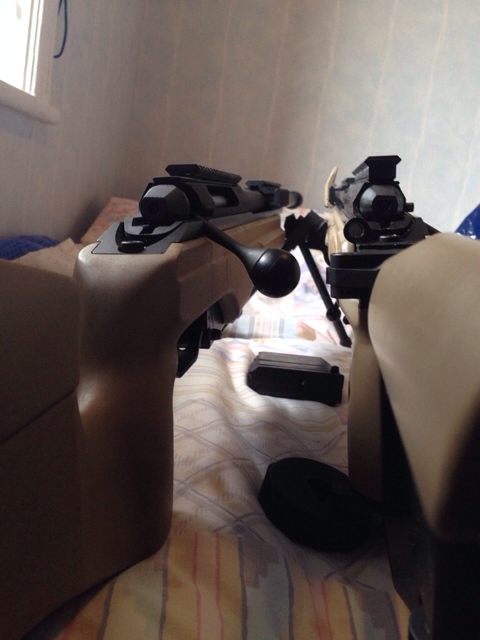

ImageUploadedByTapatalk1409329408.693818.jpgImageUploadedByTapatalk1409329428.060211.jpgImageUploadedByTapatalk1409329443.543122.jpg
Got it. :) :) :)
The 22 is the folder, 42 is fixed stock.
