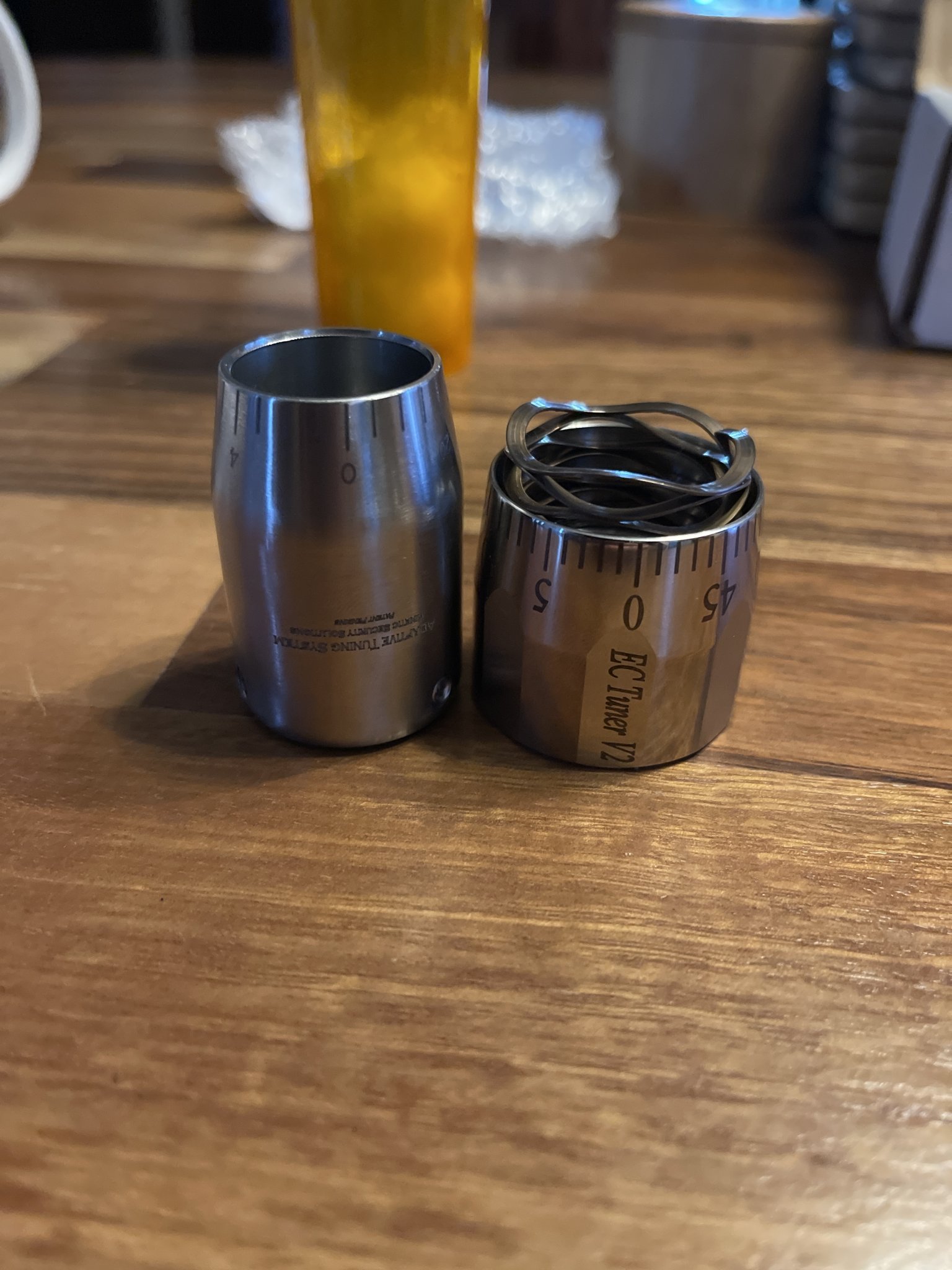

I would get it machined to have an ec tuner post Vudoo since they won't do the EC tuner machining.
Why? there are 8000 tuners out there there is zero reason to be stuck with EC.
I have an 18” Kukri and I wish I would have went 20” MTU.
I would also absolutely get it threaded you never know what you will end up doing with it.
I have an ATS on mine and it screws right in normal muzzle threads. Nothing special to machine.
The ATS mounts flush to the barrel and comes backwards where the EC mounts to the end , and after testing both, the EC outperformed the ATS on 2 of my rifles.

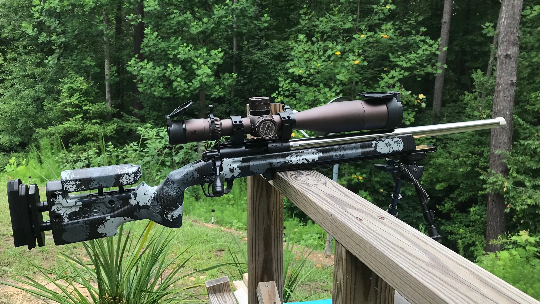

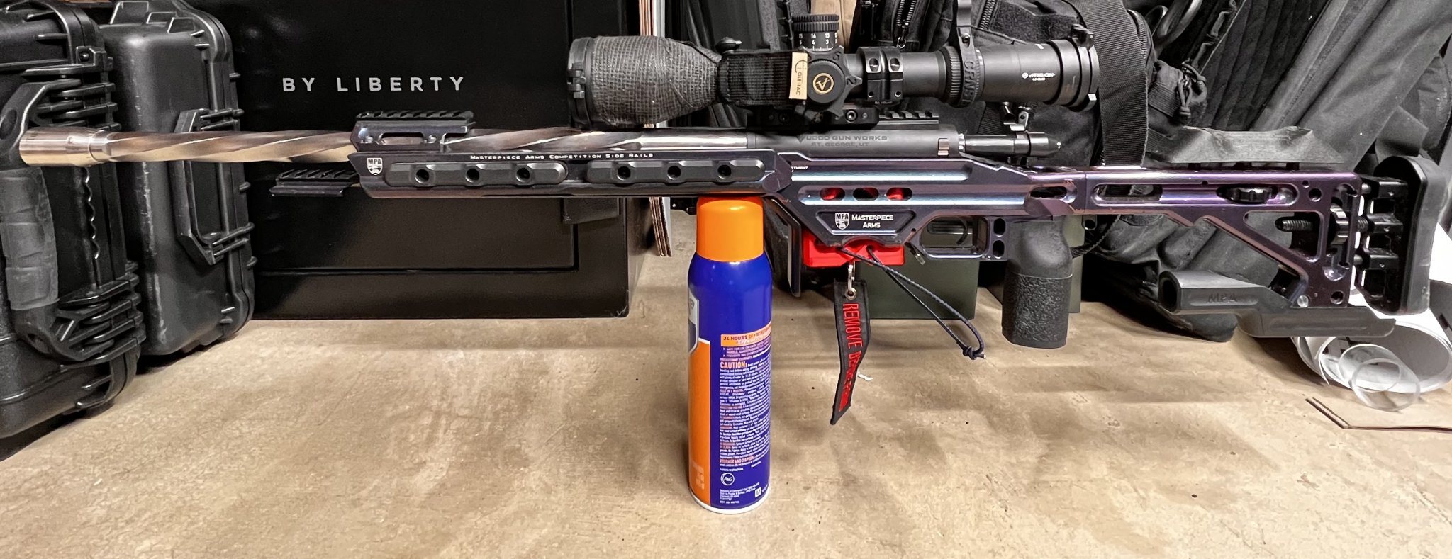

Digging all the balance photos so I’ll add mine
MPA Comp Chassis
Competition Side Rails
Internal / External Weight Kit
22" MTU Barrel
EC Tuner
Reactions: nikonNUT
That Ok?
I agree. I had an ATS tuner and I found that it didn't do as much tuning. Even the EC tuner, isn't as great as the Harrell's tuner, but it's better than the ATS.
