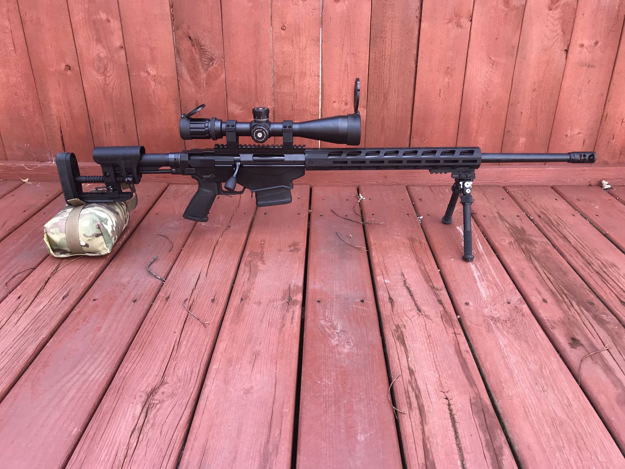

RPR GEN 2 6.5 Creedmoor arrived Friday. It’s been a rainy mess for about a week. So going to wait for the 60° weather this week to dry out and hit the range Wednesday. I still need to bore site and zero scope. Figured I’d just pull bolt out and look down bore at 25 yards to get in ball park then jump out to 100 yards.
New to precision rifles. Question I have is I’d like to zero at 100 yards so would I track first with maybe 3 shot group per corner of the box to help dial the scope in? Just stick to center of target? What are a few possibilities to zero in scope at 100 yards?
Thanks!
