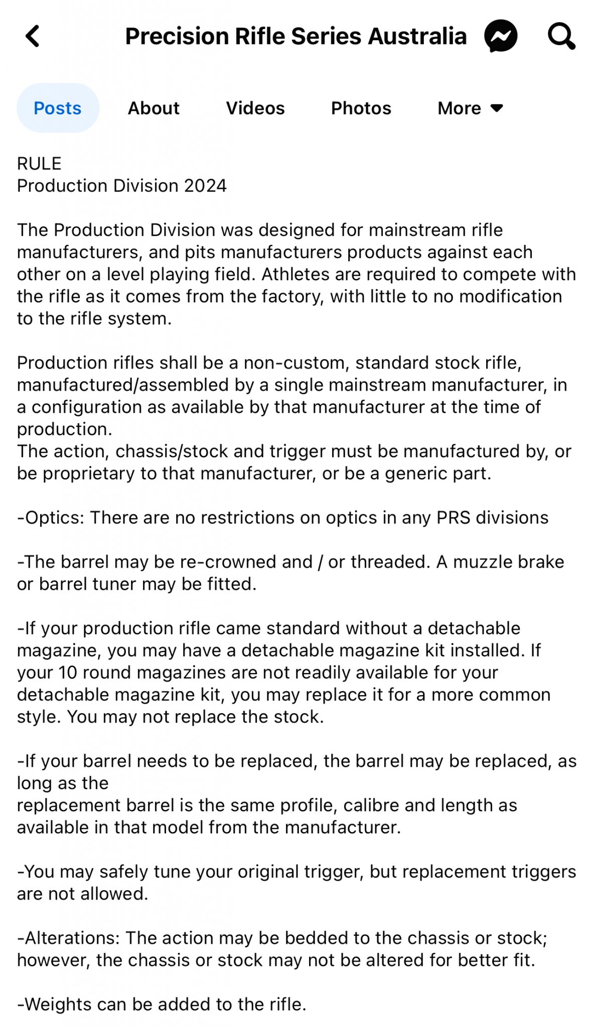

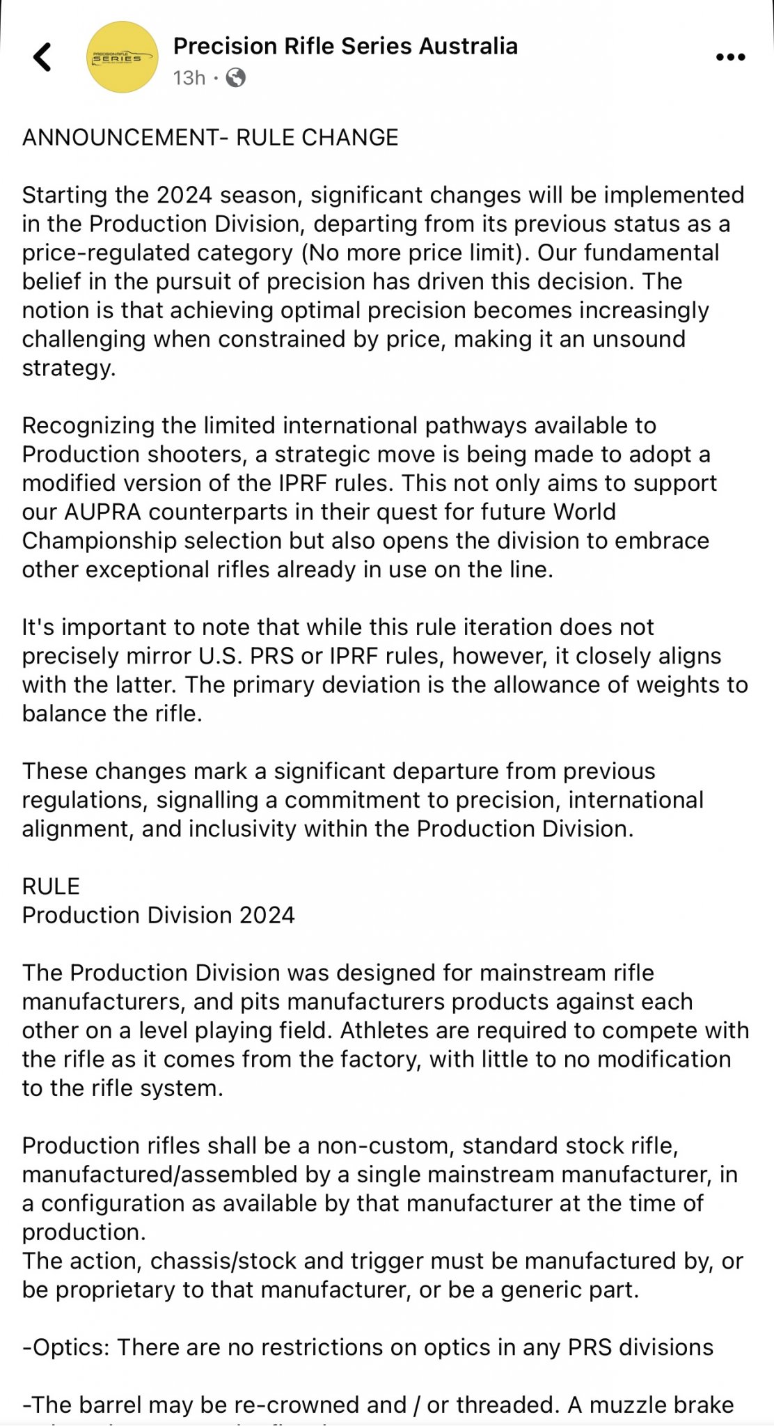

And where do we pick these arbitrary ass numbers of $3k for rifle and $2.5k for scope? Makes no sense. An ATX is more a production than the GAP PPR, but because it costs more it doesn’t count?
The new PRS AUS rules are a good start to a new Prod class.

The new PRS AUS rules are a good start to a new Prod class. View attachment 8344506View attachment 8344508
