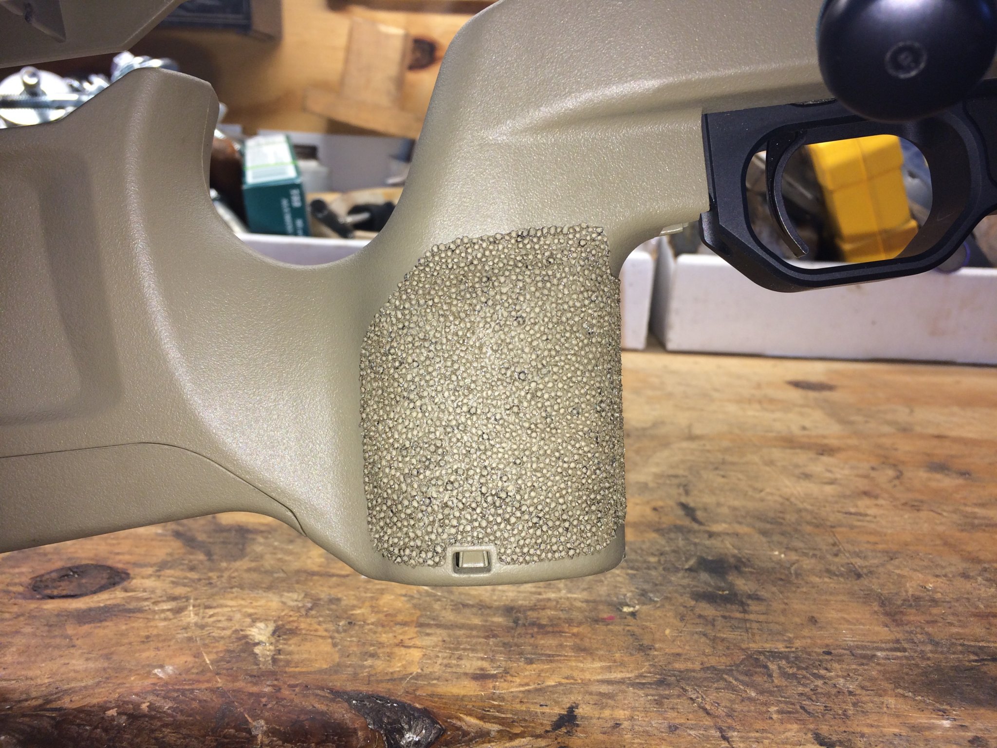

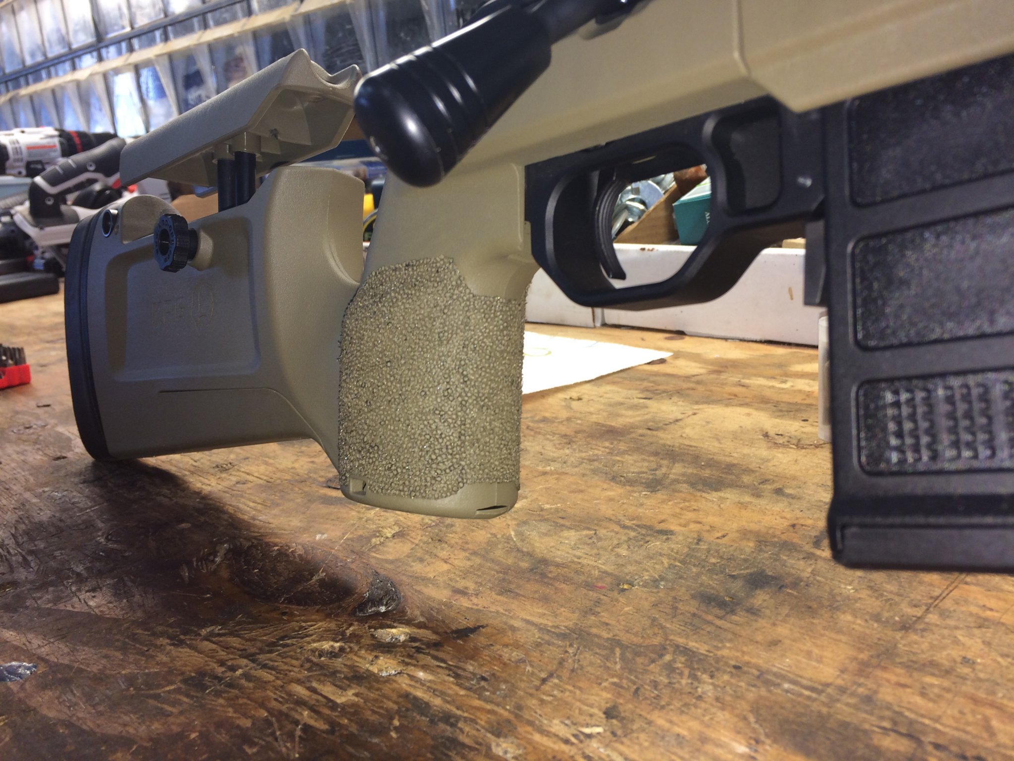

The only thing that I didn’t like about my bravo was the texture on the pistol grip. My hand would slide around on that thing like it was no bodies buisiness when I was sweating. The fix? I stippled it. No more slippage.
The few Bravos that I've been around, this was by far my biggest complaint as well. Good to know there is an easy fix. I liked my Manners pistol grip way more than the Bravo, but maybe the difference would be much less significant with something like this.
Reactions: Shankin McStaby
Stippling was super simple. Used a wood burner. No diff than stippling a Glock or M&P.
